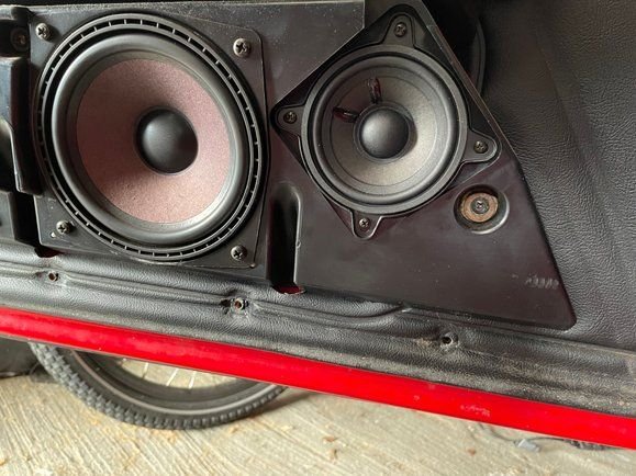

Sorry if this is redundant with other info deeper in the thread. I was able to find an exact fit 3” 4ohm speaker replacement for the midrange. Yes, I know it won’t be perfectly voice and level matched to the woofer and X-over, but it should be higher quality and sounds good enough to me over the wind noise. FaitalPRO 3FE22. Unfortunately, looks like they've about doubled in price since I bought mine.
2022_05_20_12_46_01_39cb97ea39cc3194d2eb1dff66953fc6c71544af_5afe18d5a35cfcd80ef7382a3c61c44e87707166.jpg
2022_05_20_12_46_01_39cb97ea39cc3194d2eb1dff66953fc6c71544af_5afe18d5a35cfcd80ef7382a3c61c44e87707166.jpg (62.6 KiB) Viewed 302 times
edit: also the woofer surrounds were refurbed with an amazon 5.25" kit like this one. Can't find my receipt to confirm the exact kit. Really very easy to do.
