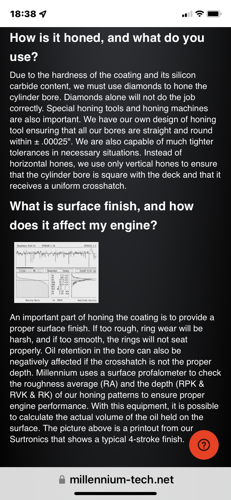

Honing tolerance for Nikasil 😎
https://www.millennium-tech.net/plating.php

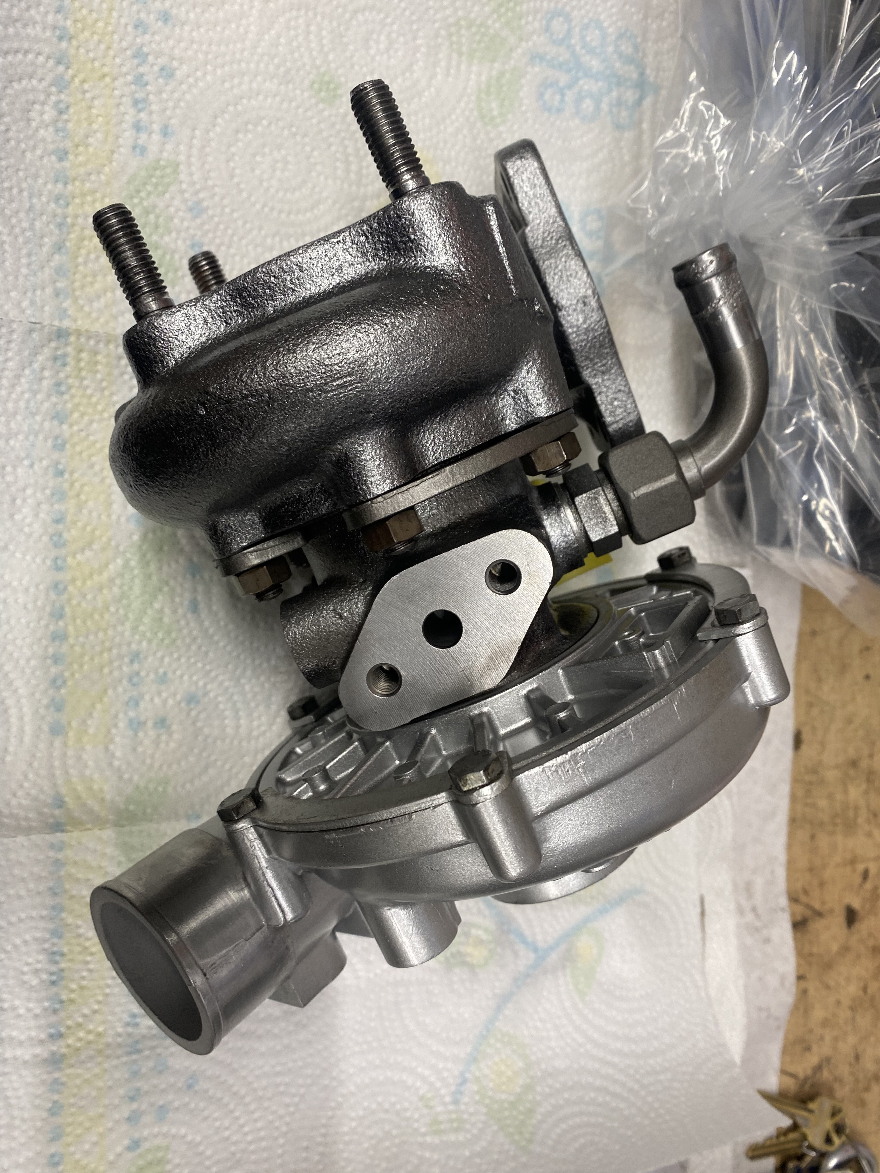

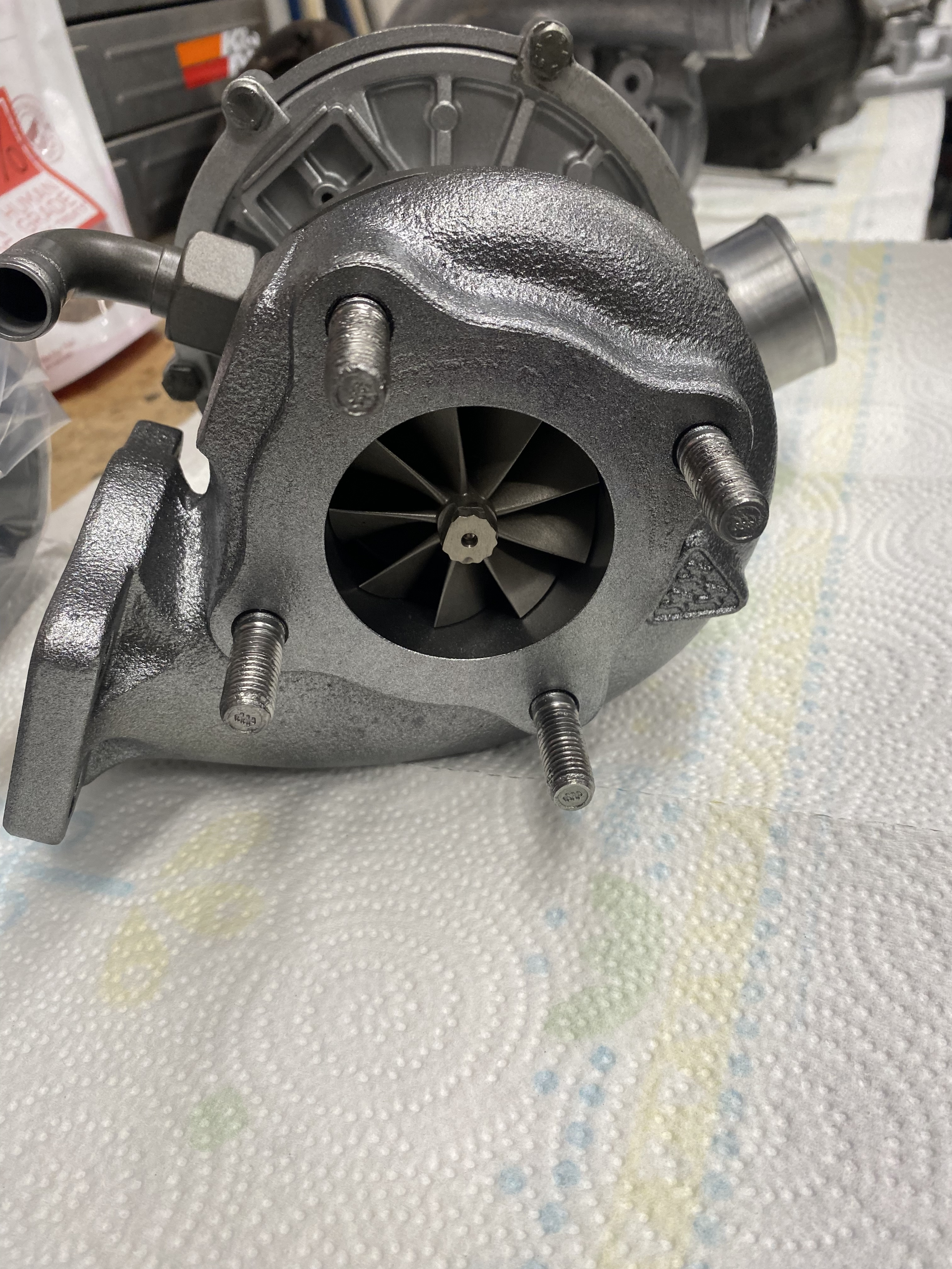

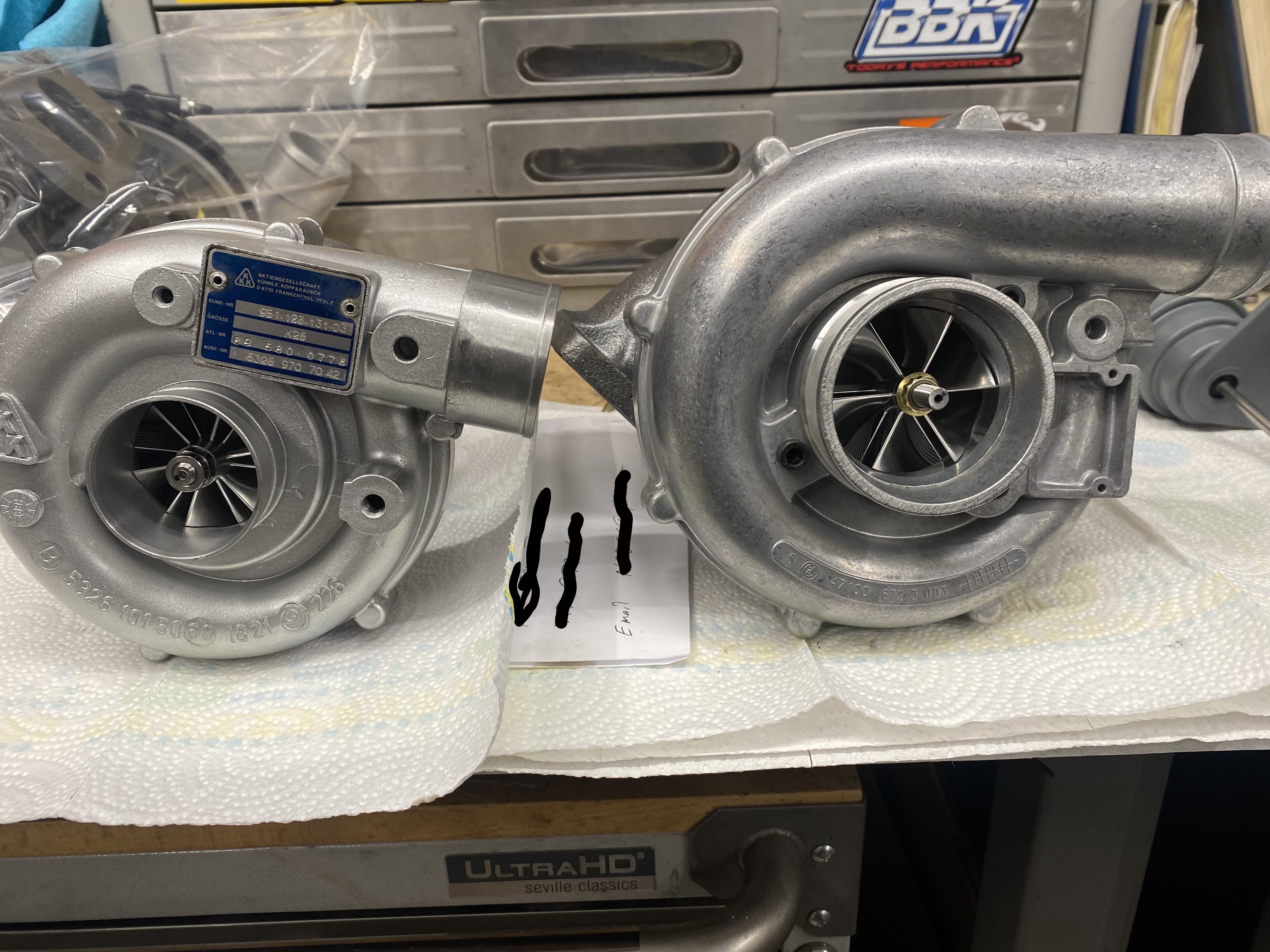

That said, every 951 rebuild thread eventually gets a "pictures from Charlie's shop" post, so here's mine!
Mine's the little guy :)
