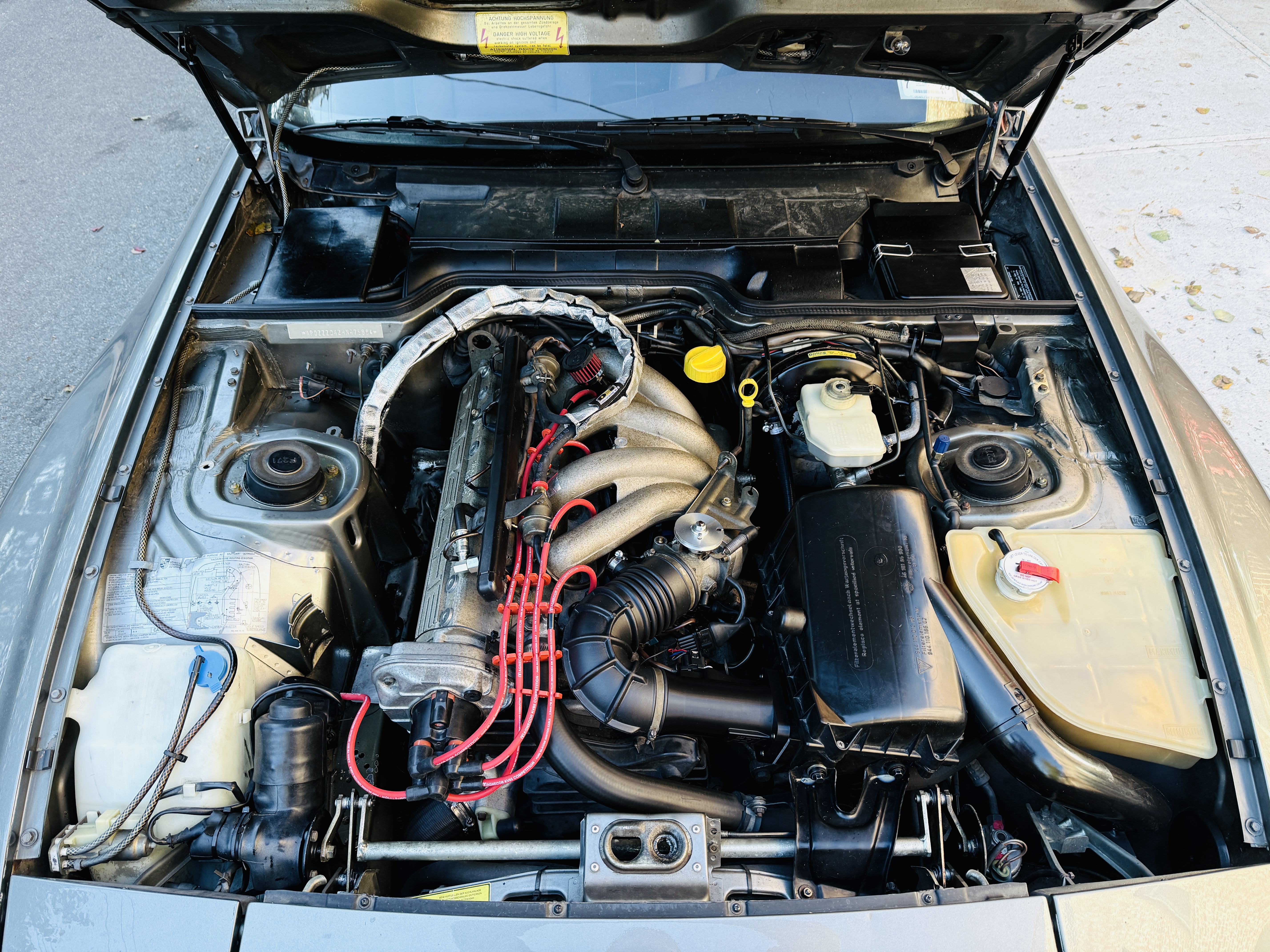

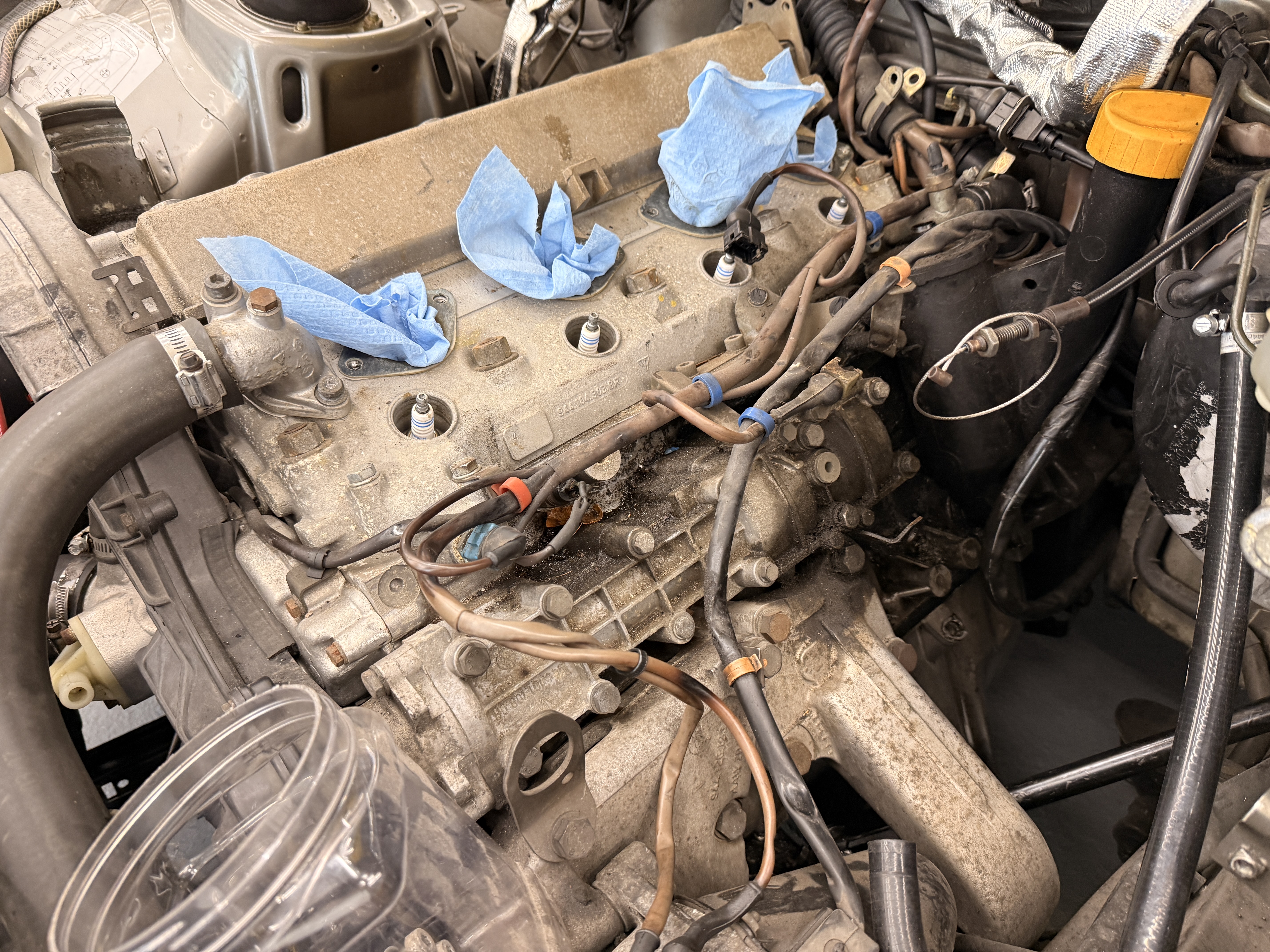

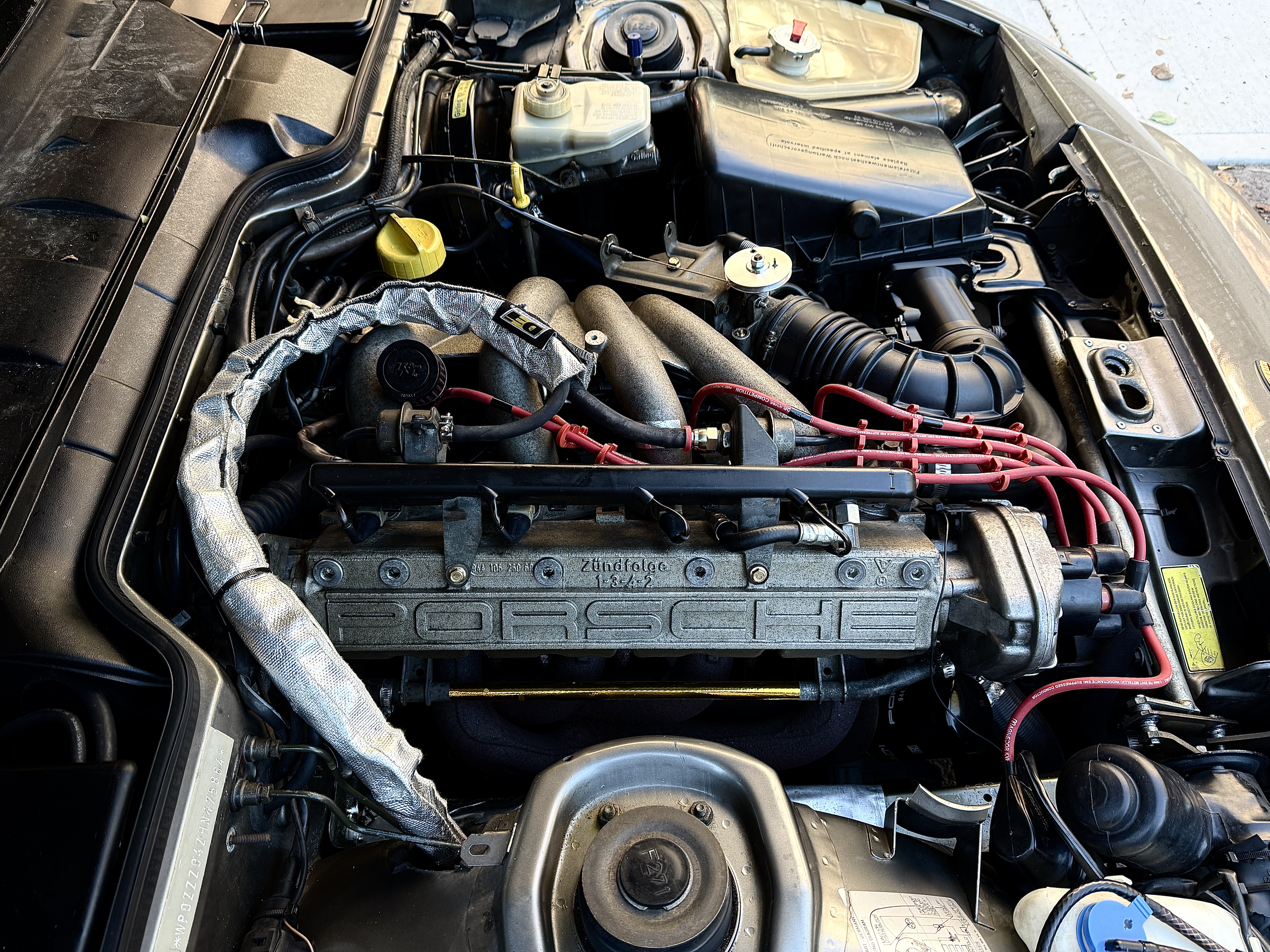

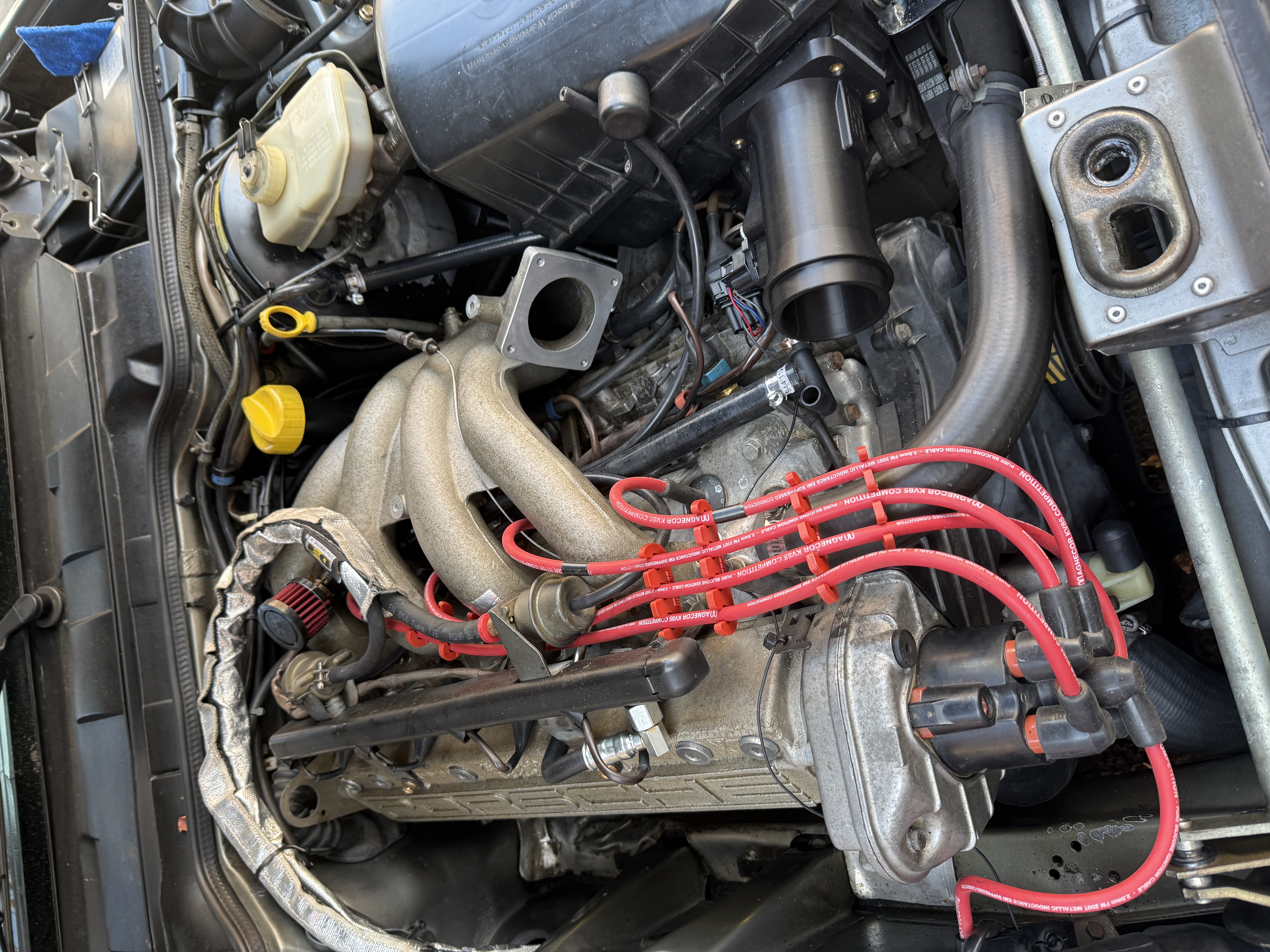

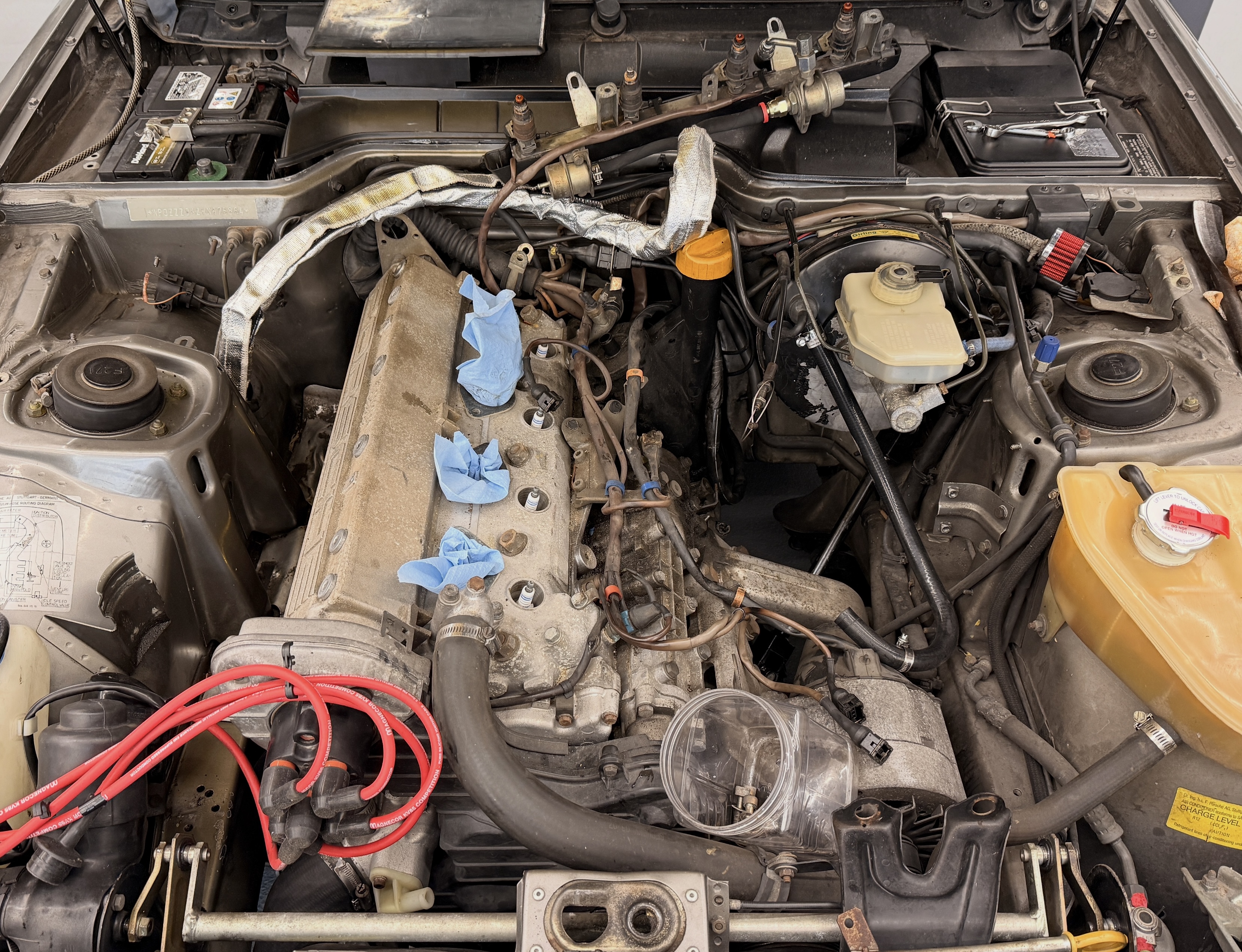

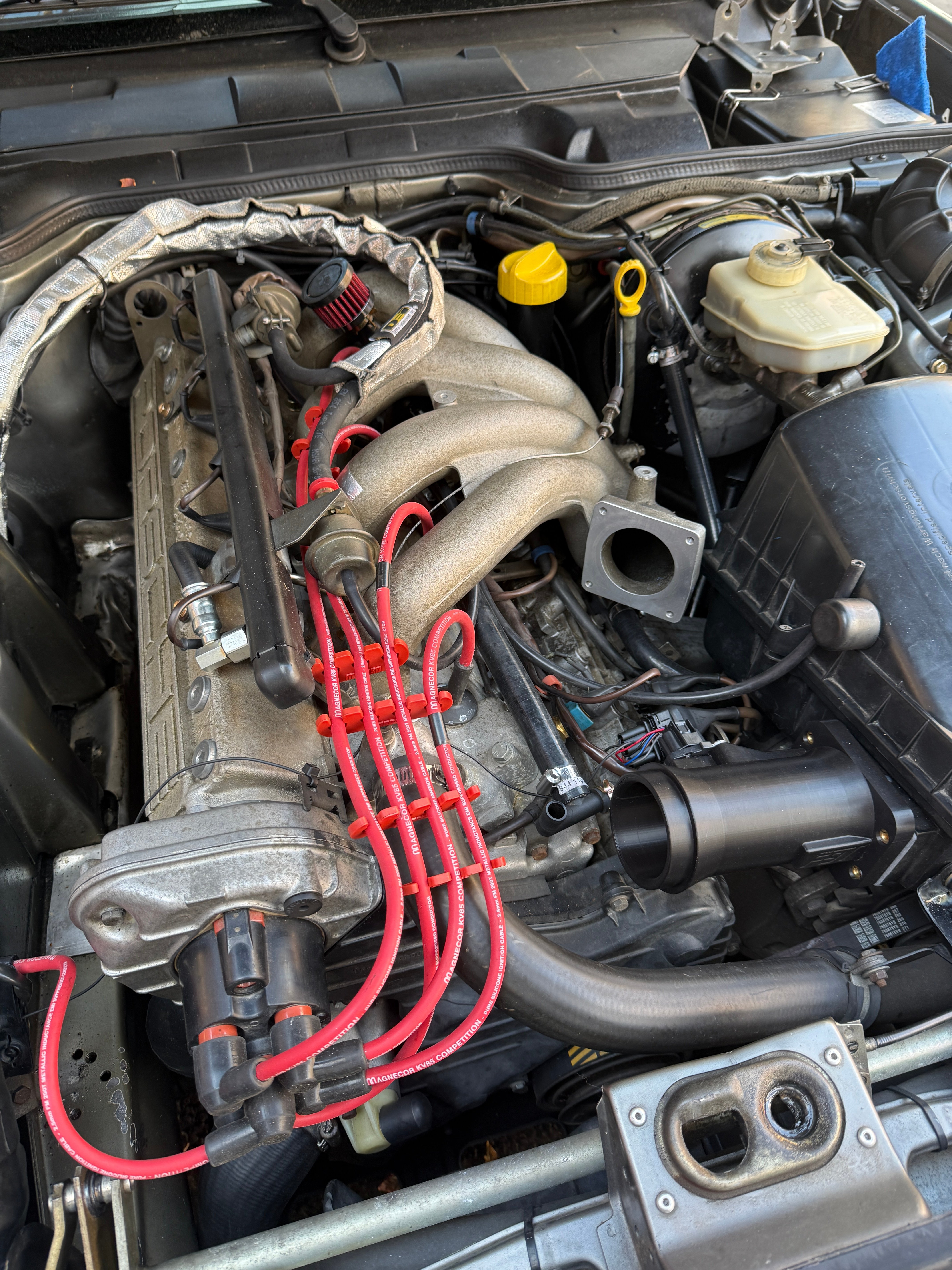

Might be worth just posting some detailed pictures of your engine bay and hose set up... Just in case something jumps out...

haha I thought the diagrams would help since the engine routing is hard to capture in a single photo.
Either way here are some recent photos:
and some photos from when I pulled the manifold back in September.
