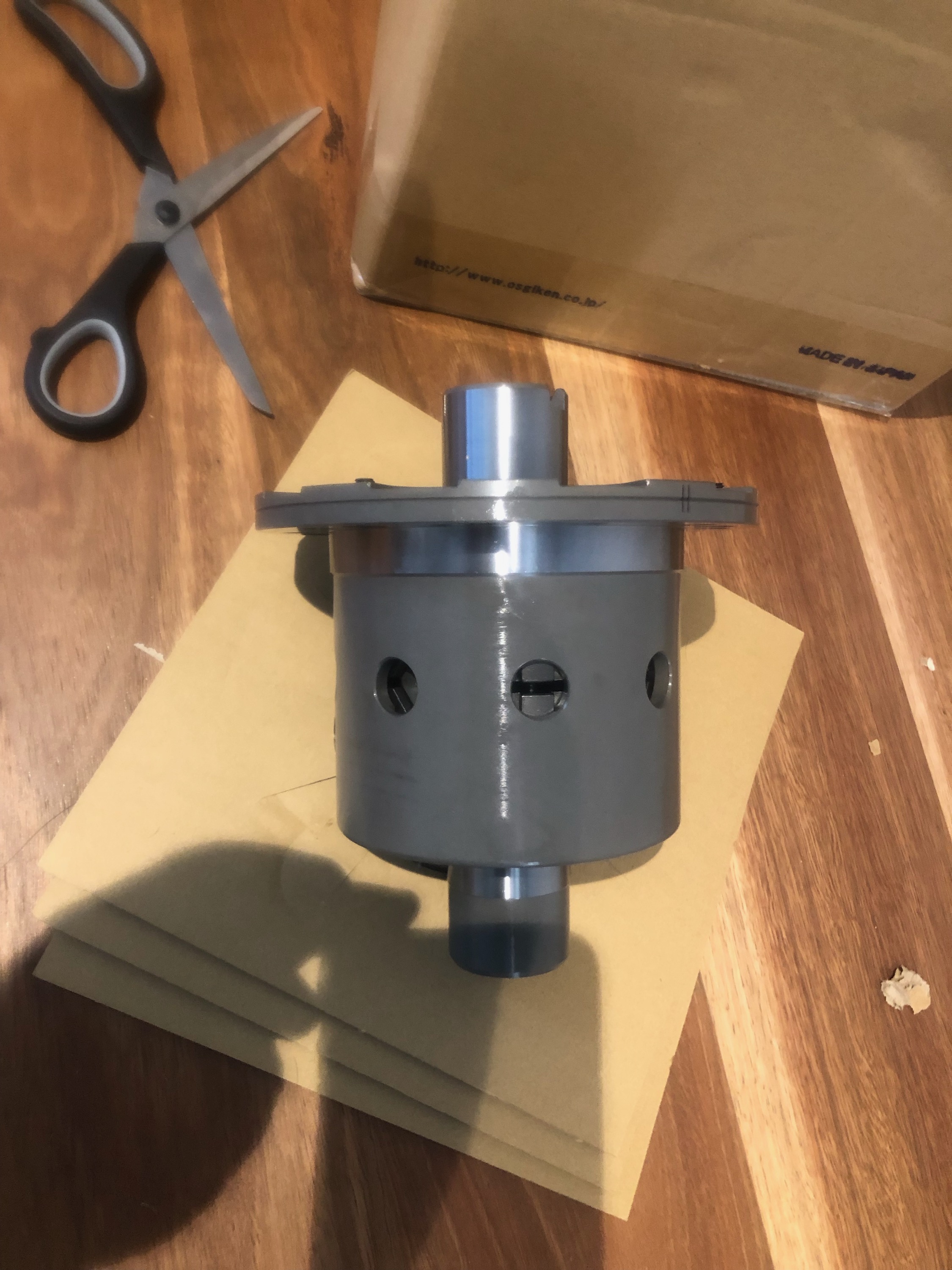

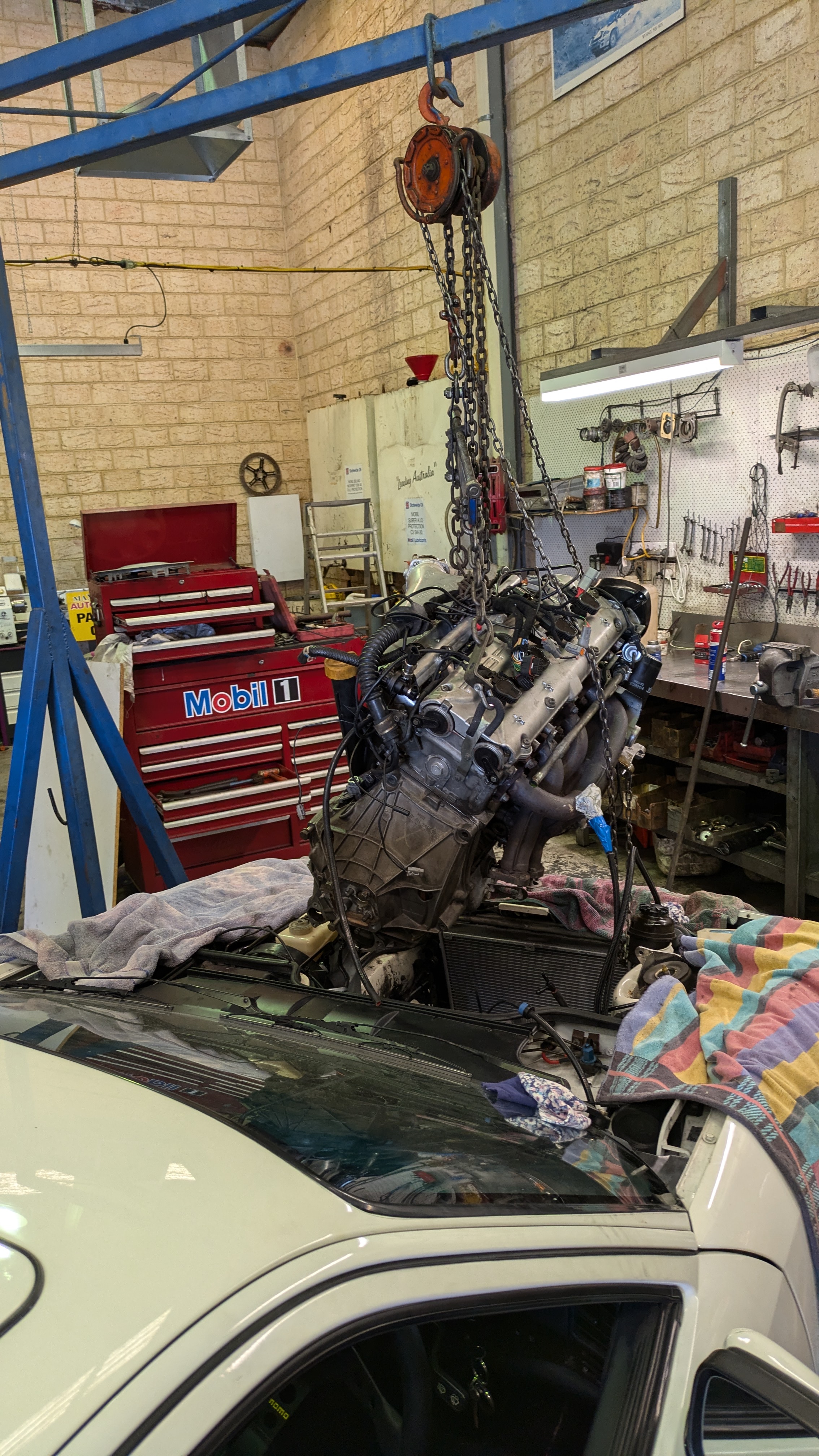

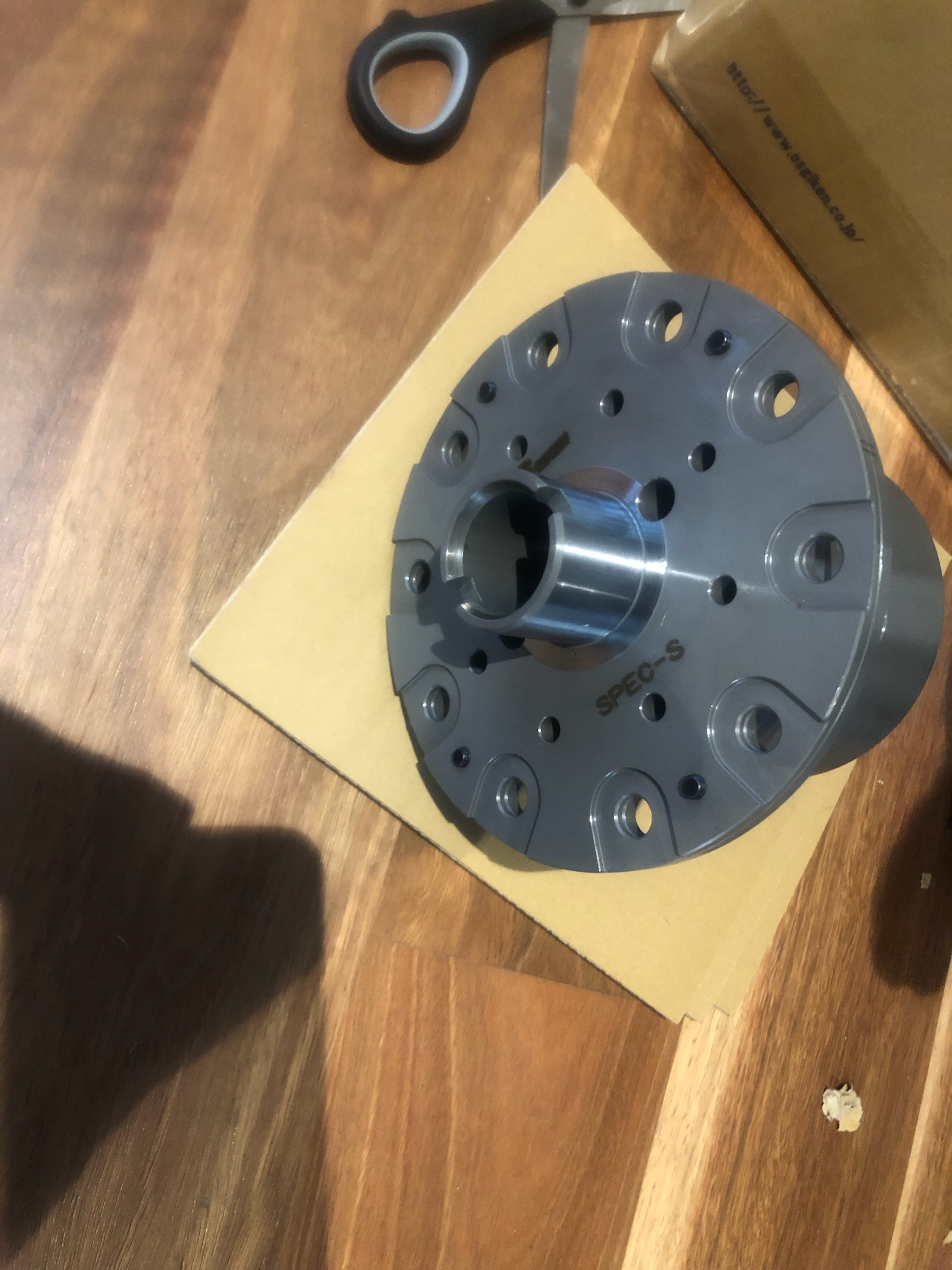

Transaxle is out and has been shipped off with the OS Giken LSD for a rebuild. Sean Buchanan has been really great to deal with, hopefully the pinion bearings and syncros/selectors are ok and its only the diff bearings that need attention.

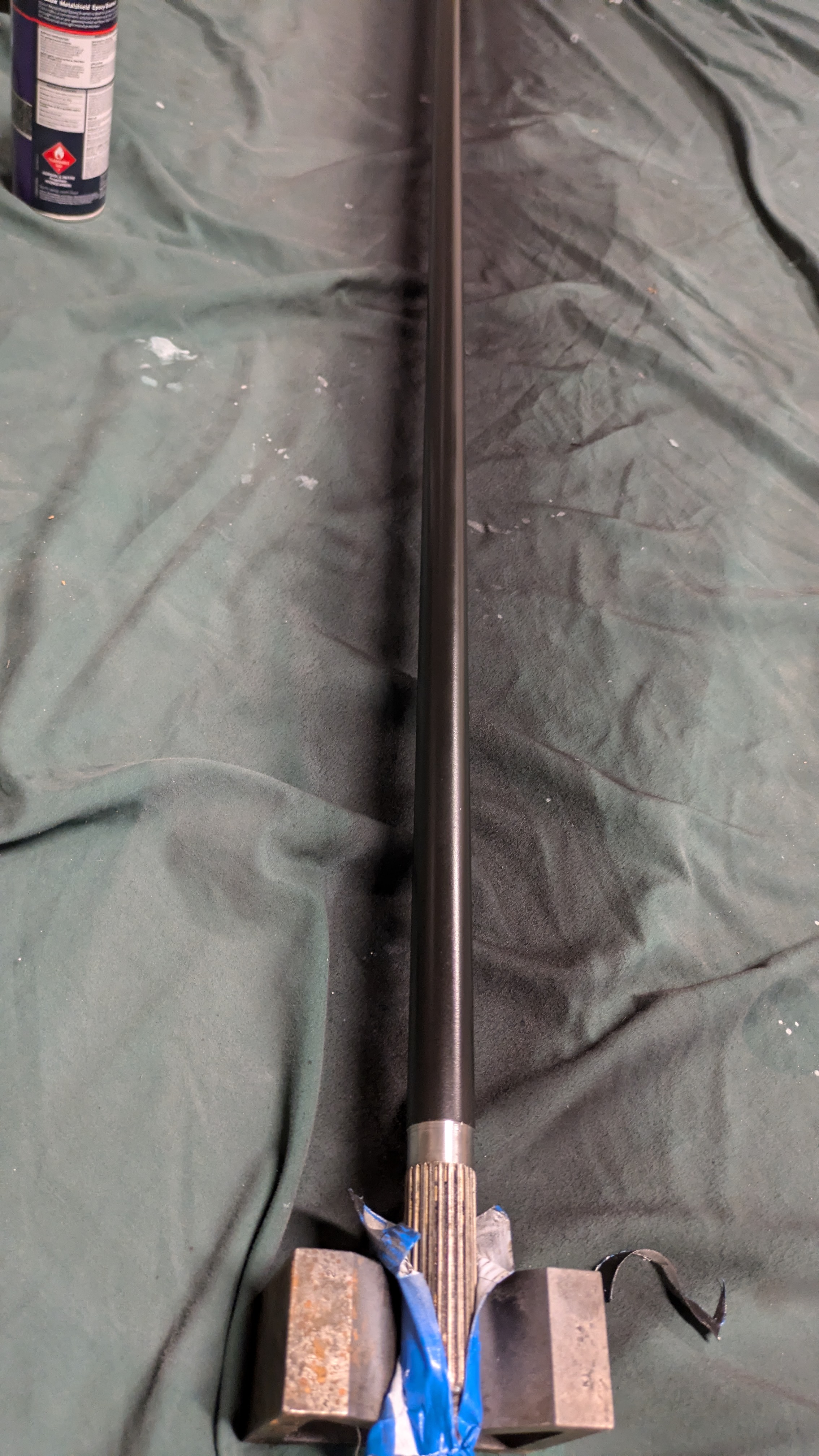

TT has been stripped and is getting sandblasted before getting some gussets welded in along the split. The bearings in there were probably ok but the front bearing moved quite easily while trying to remove the shaft so it wasn't far away from failing. The split was 2mm wider in the middle but we found some heavy duty Tilton hose clamps closed this up quite easily. Ill probably start a seperate post on the process we used to rebuild the S2 TT once I get it back from sandblasting.

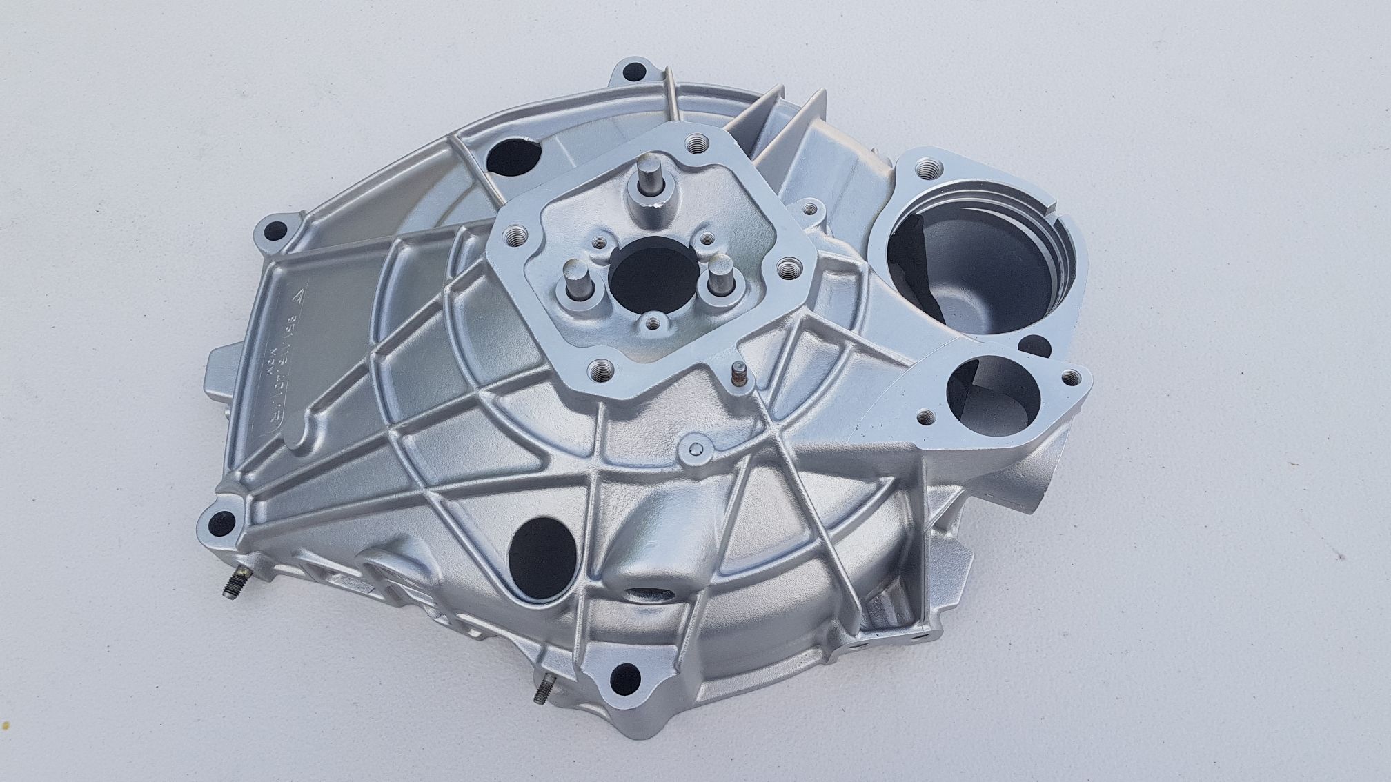

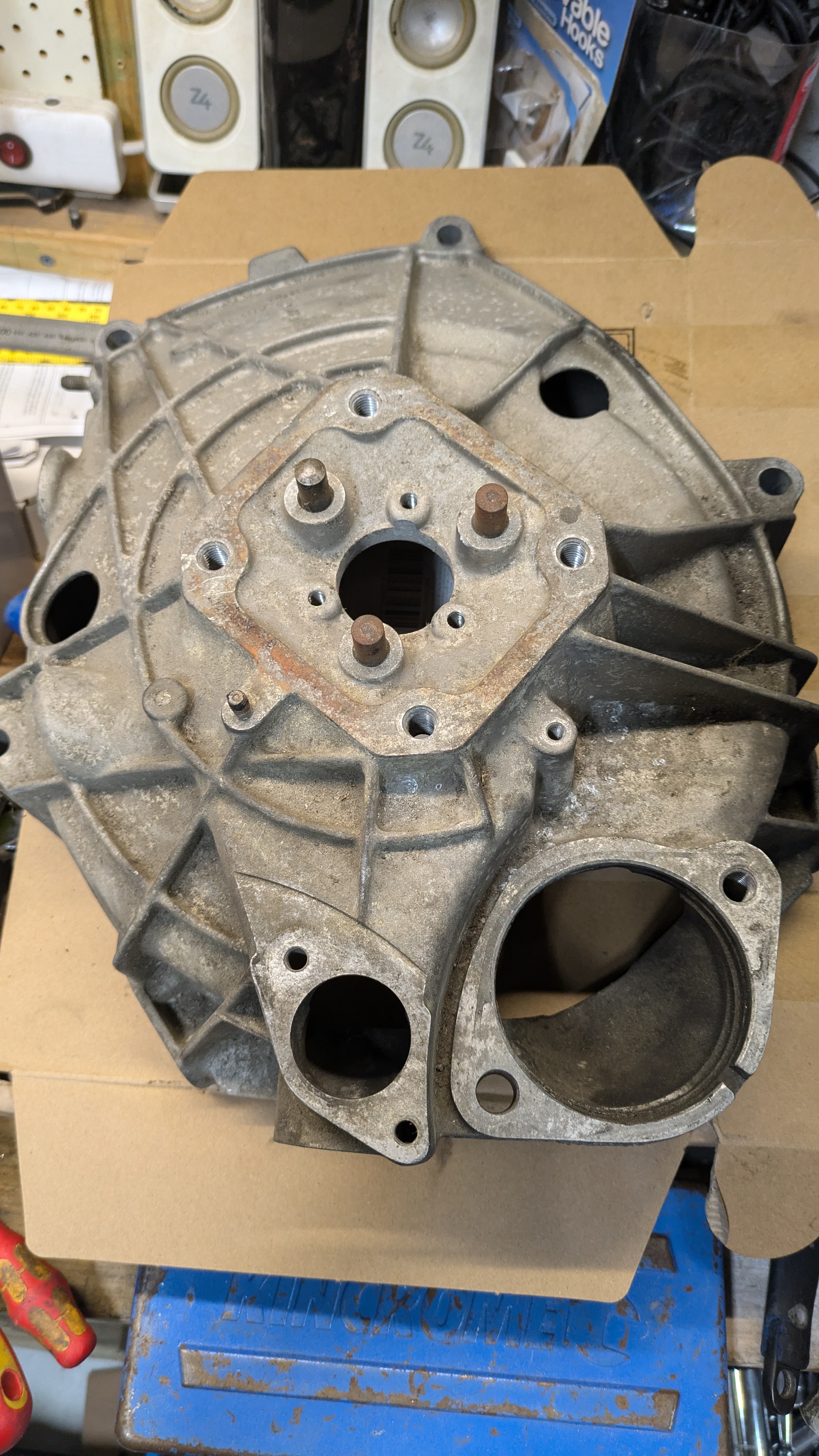

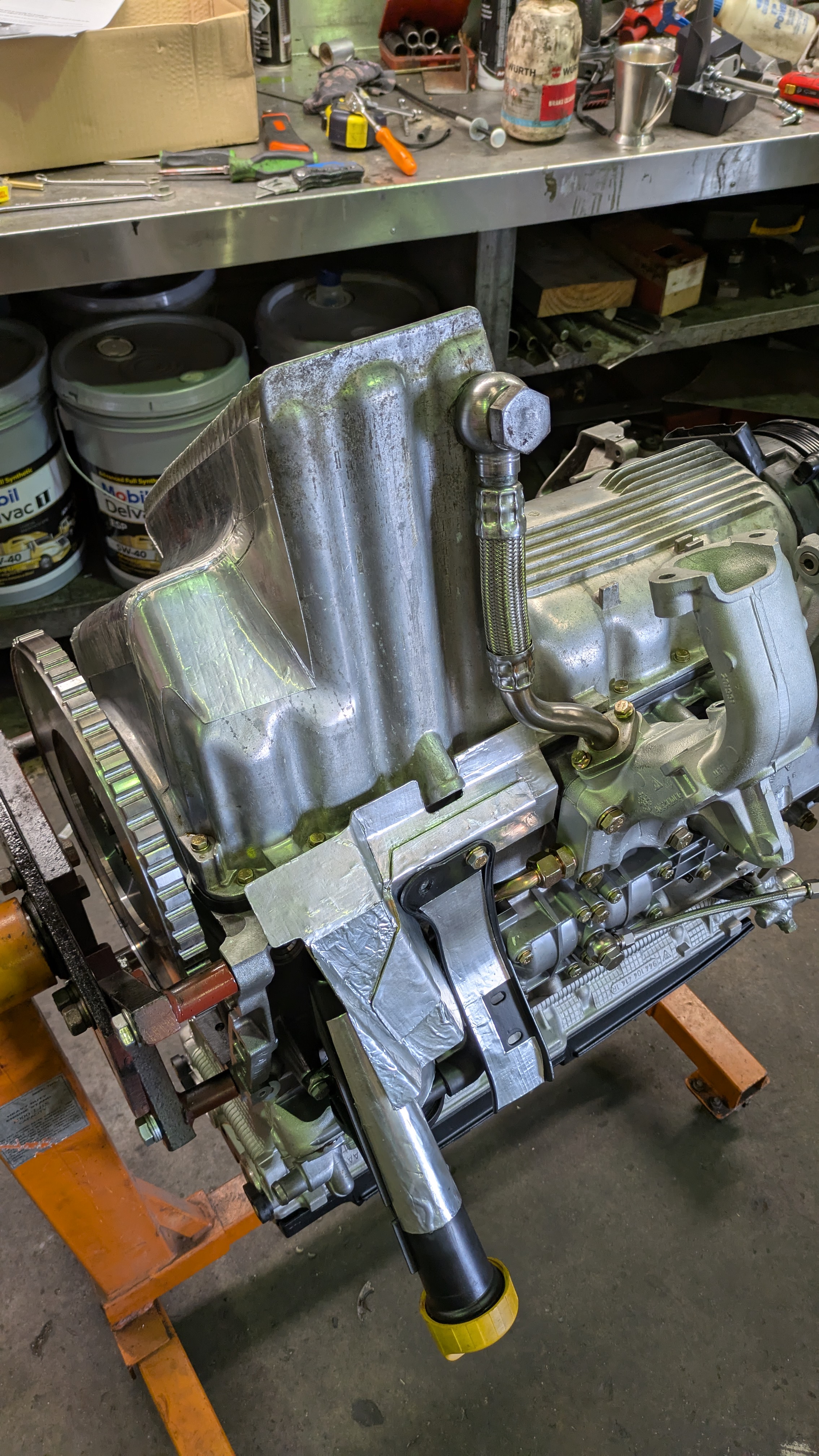

New bellhousing arrived and sent off for vapour blasting, the once I bought previously wasnt from a Turbo as advertised

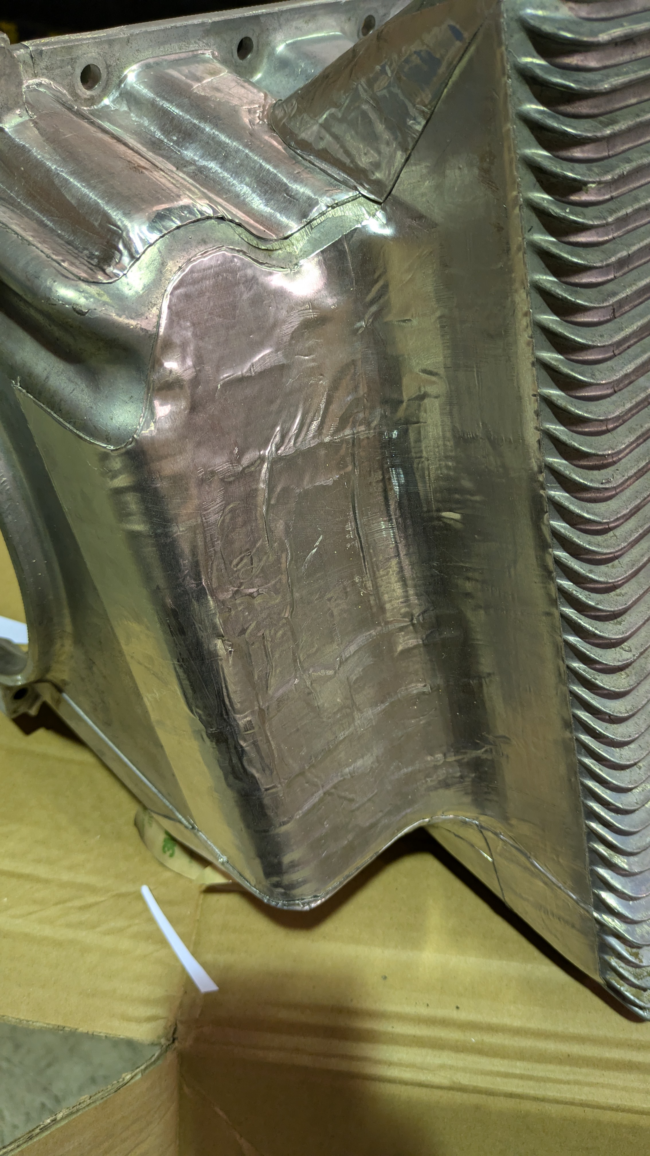

I went a bit wild with Zircoflex heat sheild this week. It doens like bending two ways at once which caused a few creases and lead to the need for some separate panels on the more complex curves.

Transaxle is done and about to make the 4000km journey home.

TT is ready for reassembly

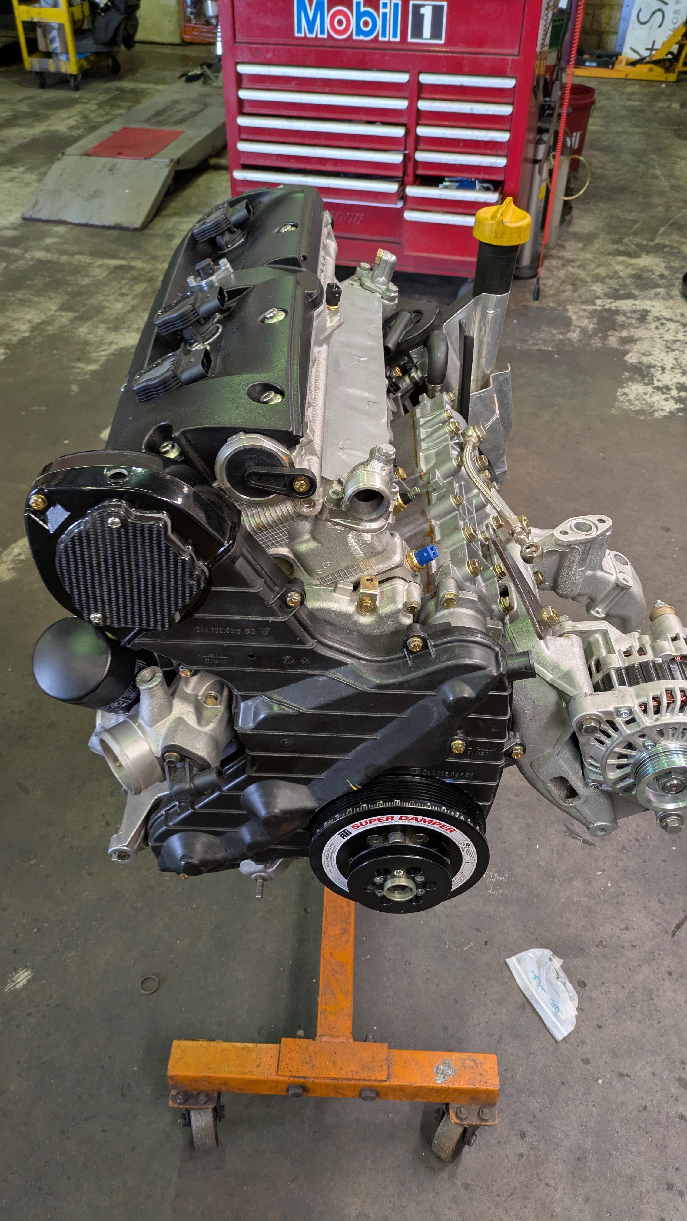

I have a rebuilt gearbox, TT ready to go, the motor will be finished once the plating is done but I'm hesitant to put it in until I have the crossover sorted, just in case the fabricator wants the motor to help mock everything up.

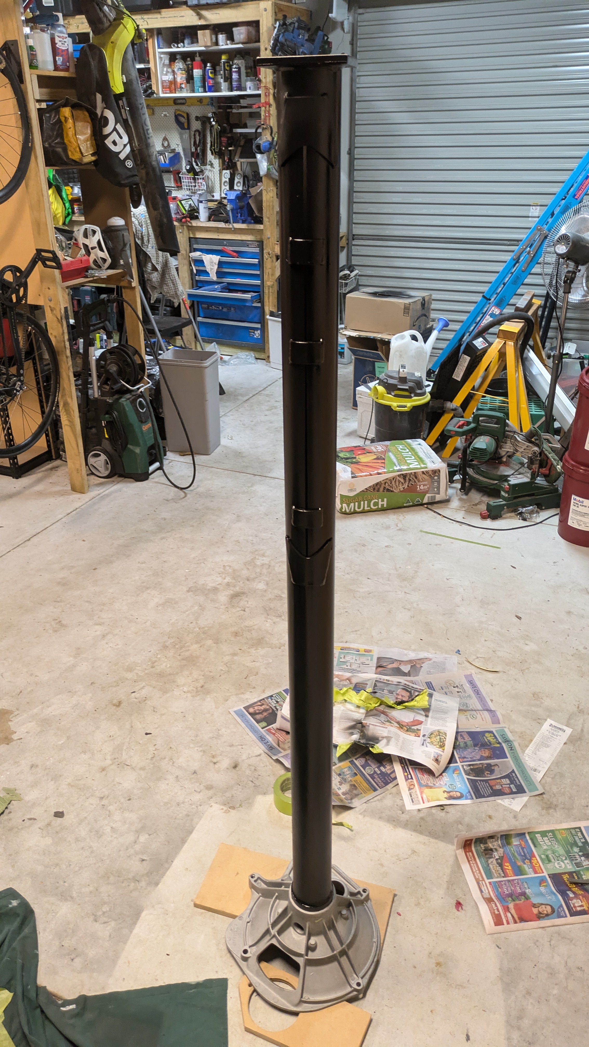

New oil pickup arrived (not sure I needed it but its cheap insurance) The sump is finally on and timing/balance belts all done. It took a little while to get our heads around timing the 968 cams but we got there in the end.
Rebuilt intermediate steering shaft arrived from JMG in the UK, added a little heat protection because these sit about 10mm from the headers in the RHD car. I didnt realise how much play mine had until the new one arrived.
