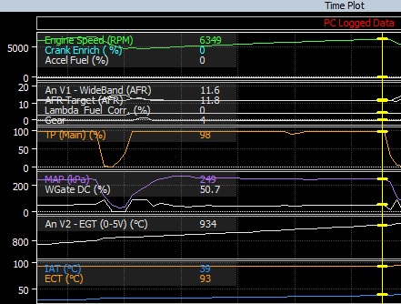

Been digging through older log files. Here is an instance where boost holds up to 23 psi (250 kPa) all the way beyond 6k rpm in 4th gear. Not sure what I was thinking with the turbo presumably running out of breathe, perhaps the car is doing that old 944T trick of making someone always crave for more.
Note : high IATs as that was in mid July during the heatwave. IIRC ambient temp that morning was above 25°C.

Nice, that's impressive it holds that to redline no problem. Duty cycle flat at 50% the whole time. I don't think 39C would be considered high in most peoples books. Especially a for a 951!
I think it already came up in this thread previously, but man, those EGT's would be quite concerning for me. Especially considering the life of the turbo! The rate at which it's climbing right through the 934C you show there is definitely not good. Maybe you could confirm that sensor/conditioner is still reading correctly or calibrated correctly? If that's real reading you might want to consider measuring your backpressure and begin investigating what you can do to reduce those temps.

They have always been liked that. They are just a little higher now when cruising than with the previous engine, but under load they actually climb up less quickly than with the 8V engine that was running at 18 psi. There is nothing to be done, and believe me, I have tried. That's just where they are with the probe in the cross over port.
Yes that turbo is proving great now that it can run in its comfort zone with pressures like 23 psi rather than 18 psi on the 8V engine. On that log it even spikes to 27 psi when reopening the throttle whilst entering 4th gear. I will try again to turn up the boost, not that the engine needs it but for the sake of science.
