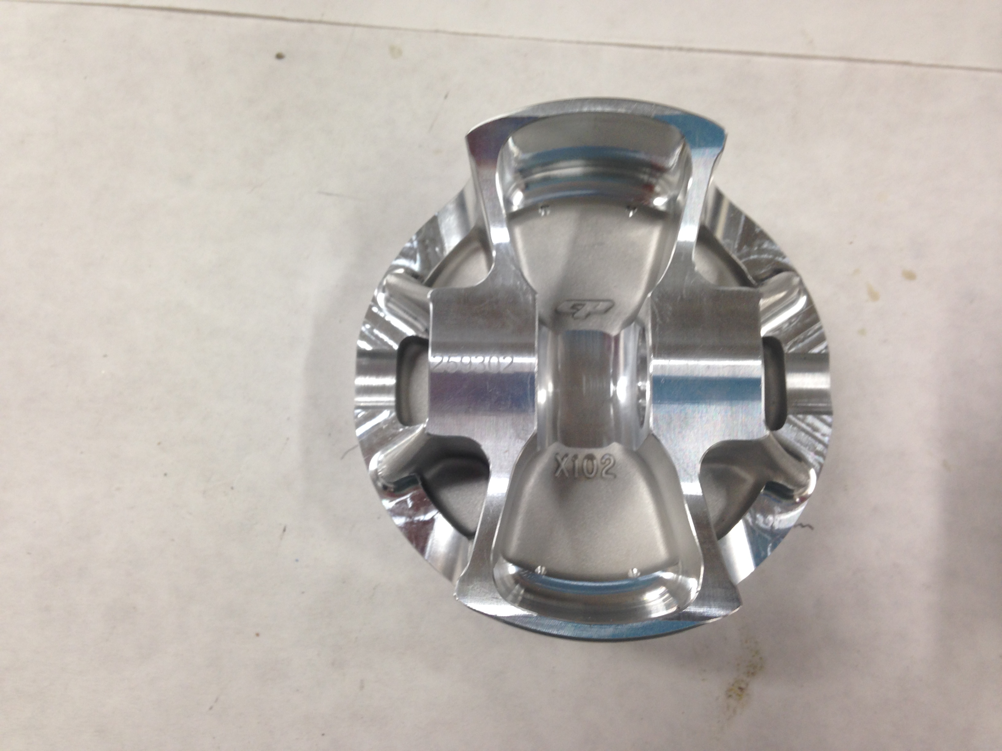

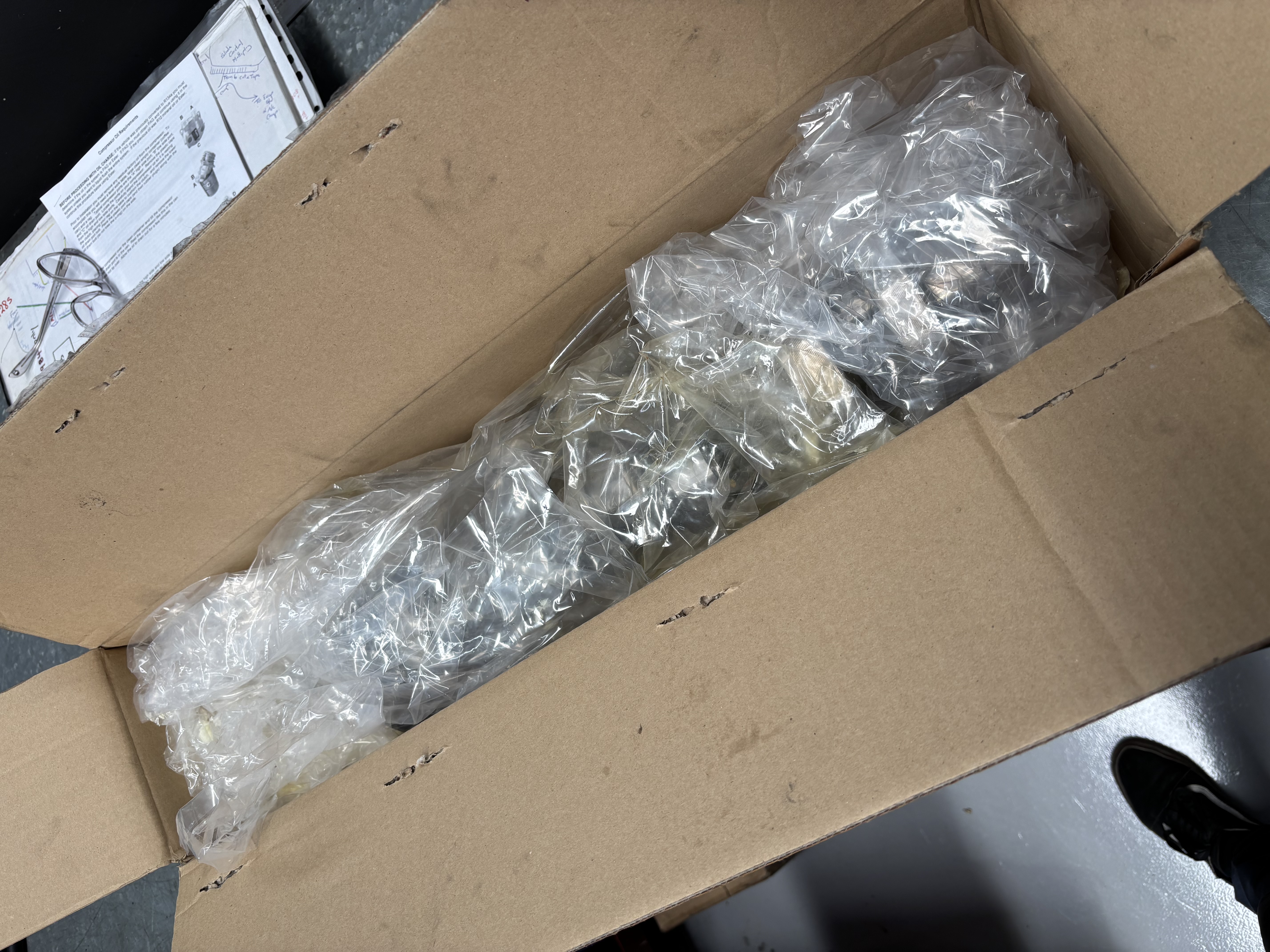

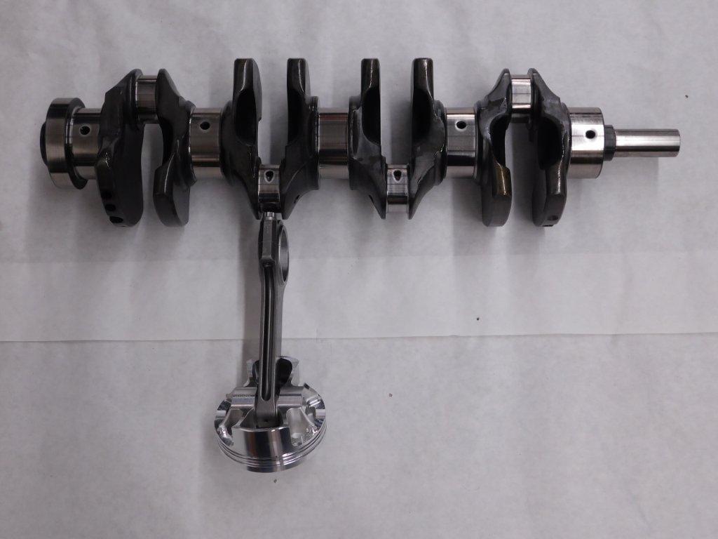

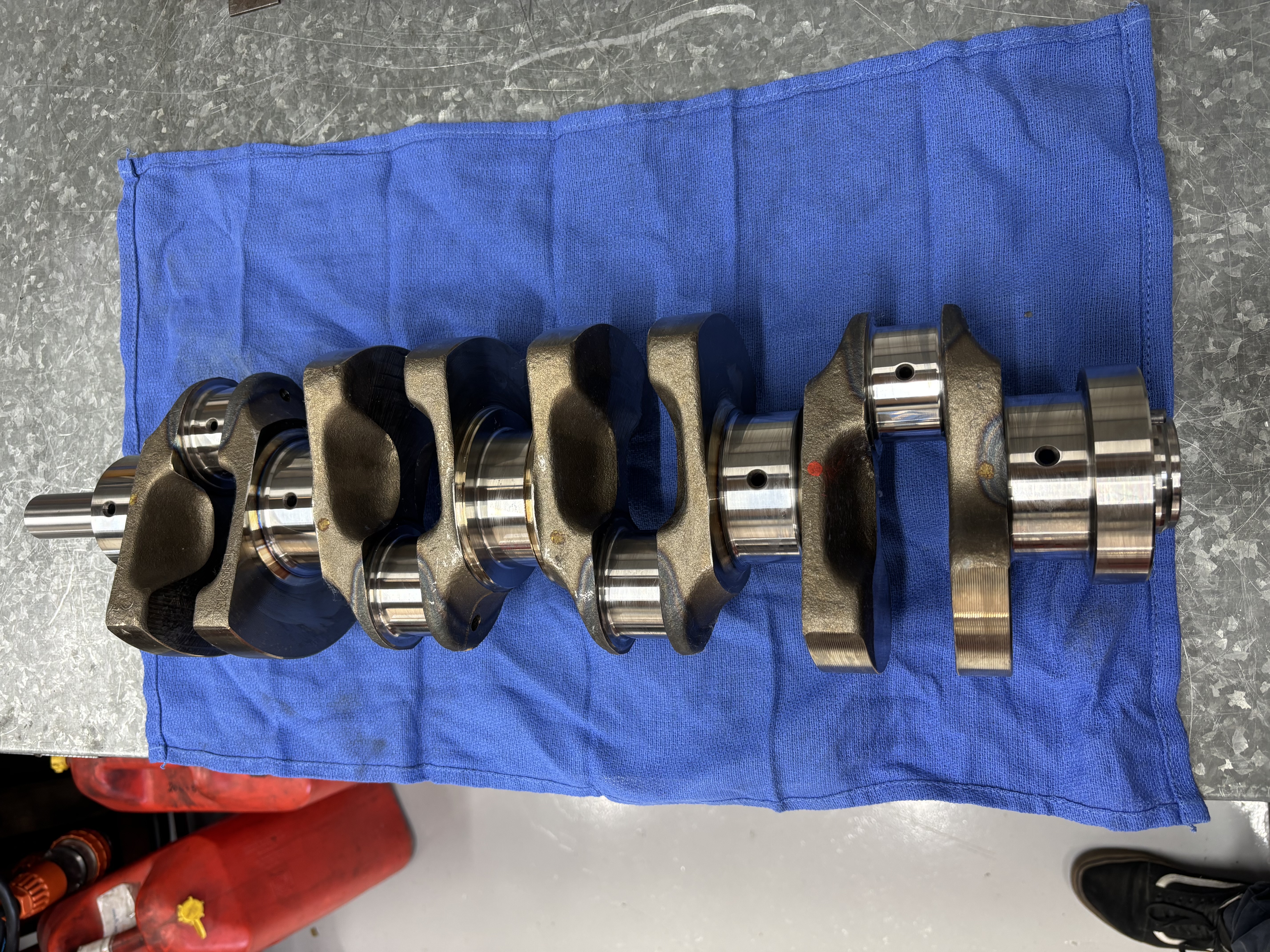

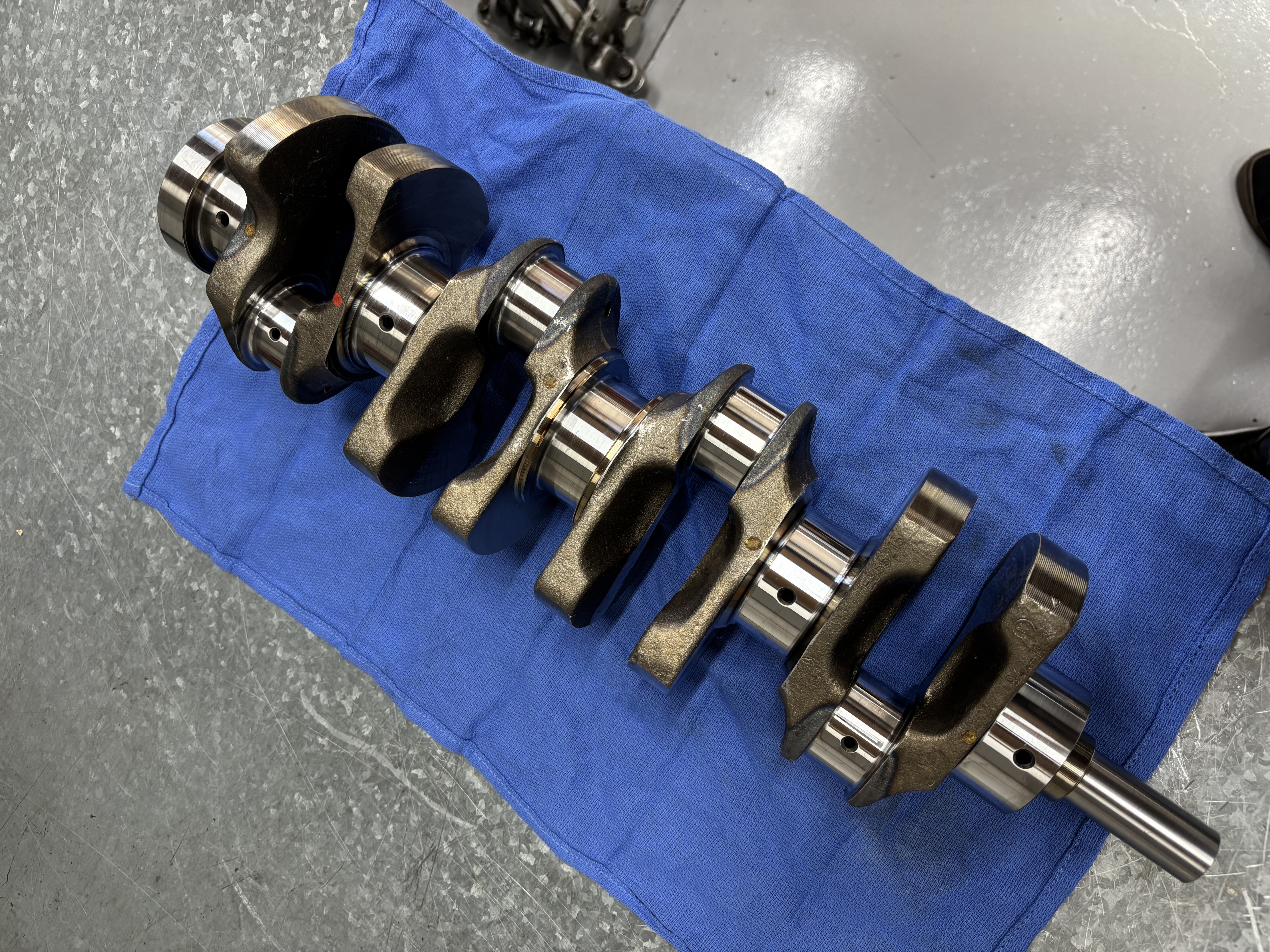

So this is what $5700 gets you these days. Ordered via Sean Buchanan and delivered from the factory in less than 2 weeks. Interestingly it's an S2 and not a 968 crank which haven't been available from the factory for some years. Wonder why that is? Apparently the 968 crank is a little lighter. Oh well...I'll just have to send this off to Lindsay Racing to knife edge... :mrgreen:

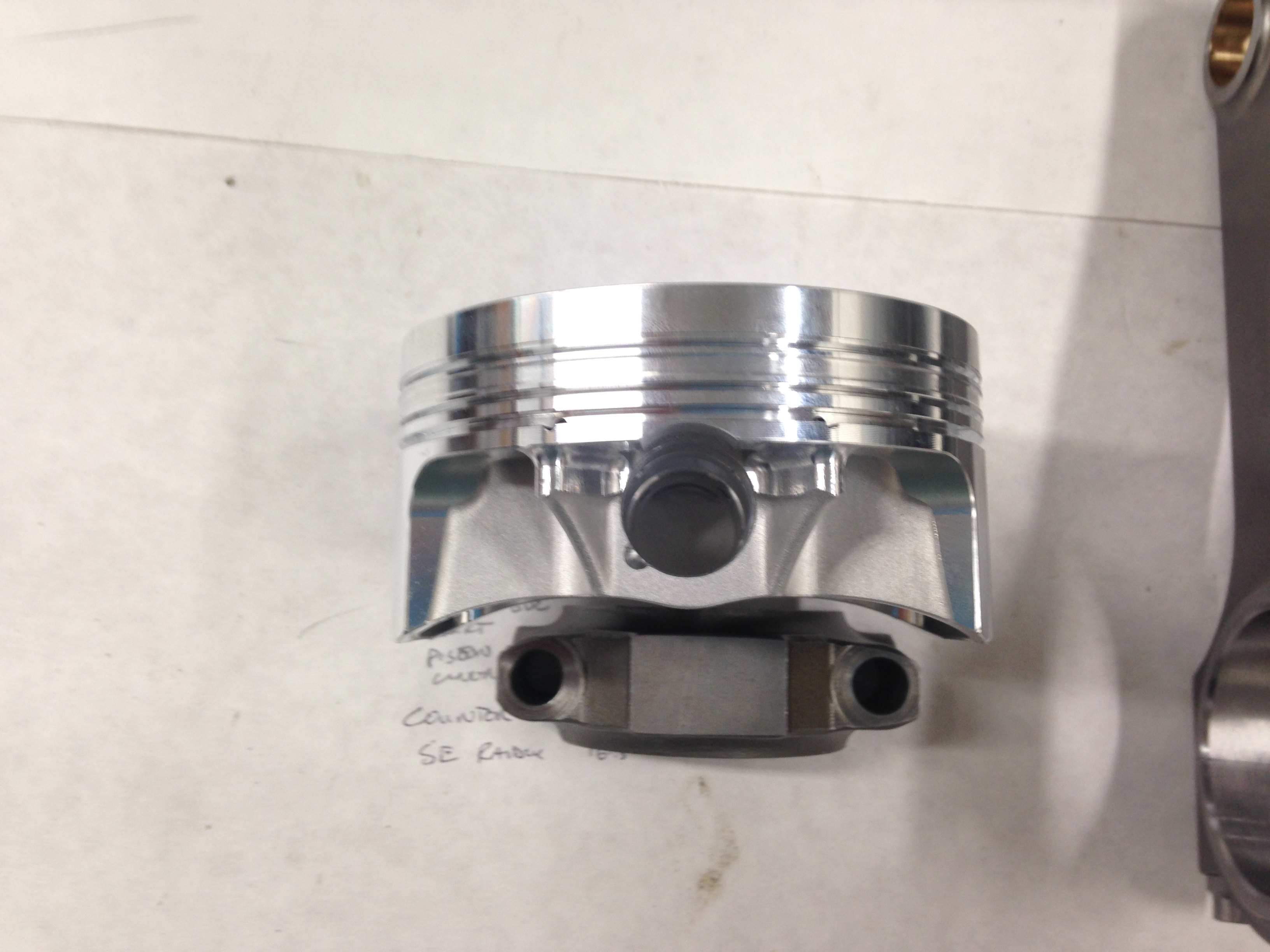

Next step will be measuring up and ordering new rods. Ordinarily one could just use standard length 3lt rods but I suspect the pin height is different with the custom CP pistons so we'll have to go custom again. Does anyone have any strong opinions on brand of rods. The previous ones were Carrillo but I have heard good things about Molnar at half the cost. Wossner perhaps? Thoughts?
New S2 Jan 2026 i.jpeg (4.63 MiB) Viewed 383 times
New S2 Jan 2026 ii.jpeg (6.25 MiB) Viewed 383 times
New S2 Jan 2026 iii.jpeg (6.49 MiB) Viewed 383 times
Porsche 944T assy.jpg (65.83 KiB) Viewed 383 times
CP piston 2.jpg (1.51 MiB) Viewed 383 times
CP piston 1.jpg (1.5 MiB) Viewed 383 times

Hopefully the pin height on your pistons allows use of some off the shelf rods. I suppose if the pin height is a tiny bit too low, you could get a little machined off the top of your pistons? Providing they have enough meat
