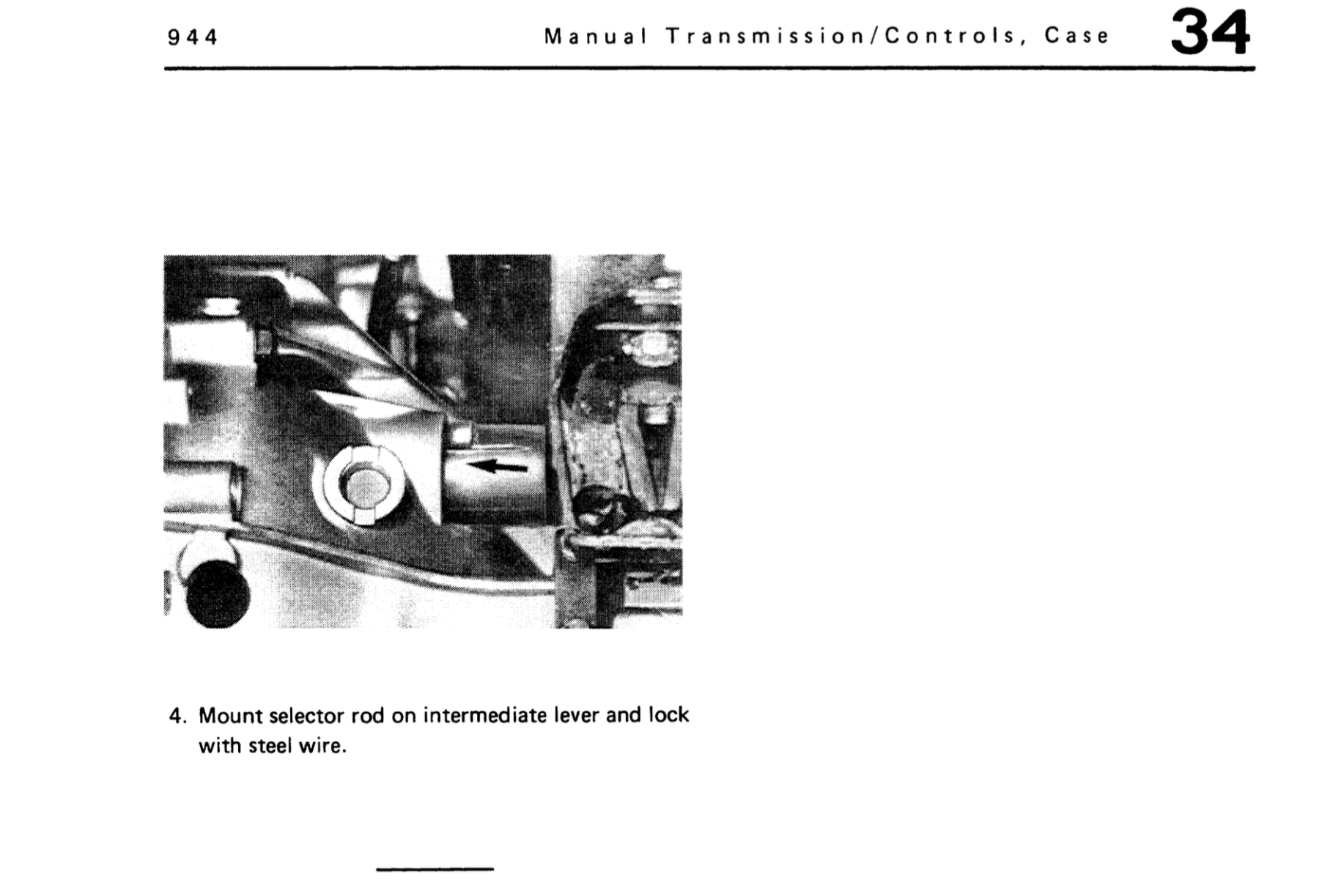

Tell me safety wire on the set bolt that holds linkage to the shift rod is not factory.
You're doing excellent work here.
However, I have some bad news...
Screenshot 2025-05-16 at 17.41.18.png (595.96 KiB) Viewed 617 times
The lock wire is indeed factory.

O875 wrote: Thu May 15, 2025 10:46 pm
Thanks! It has been a lot of work and I'm not done yet.
Never would have guessed that wire was stock! It did not get one back on it. Just locktite.
