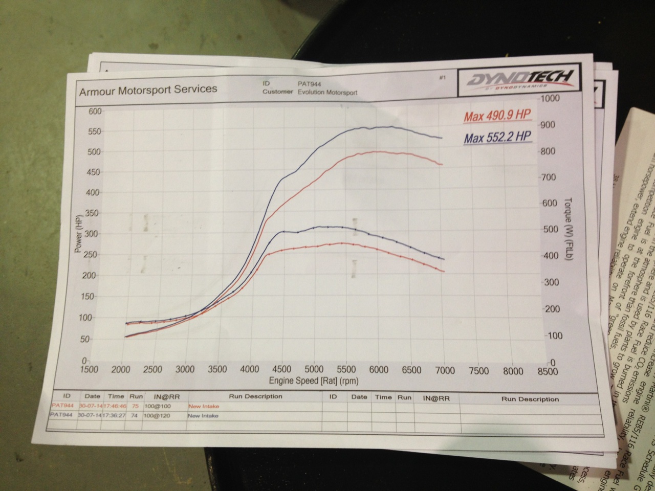

Well that clutch did hold more tq in the old 3.1 lt 8v motor. Never had any slip. Same with 25psi in that other 2.6lt 8v. Don't know why it was slipping at less power/tq this time. Perhaps some fire retardant got in there too? Will have to open it up and see what it looks like.
3.1 8v tq.jpg (292.72 KiB) Viewed 484 times
