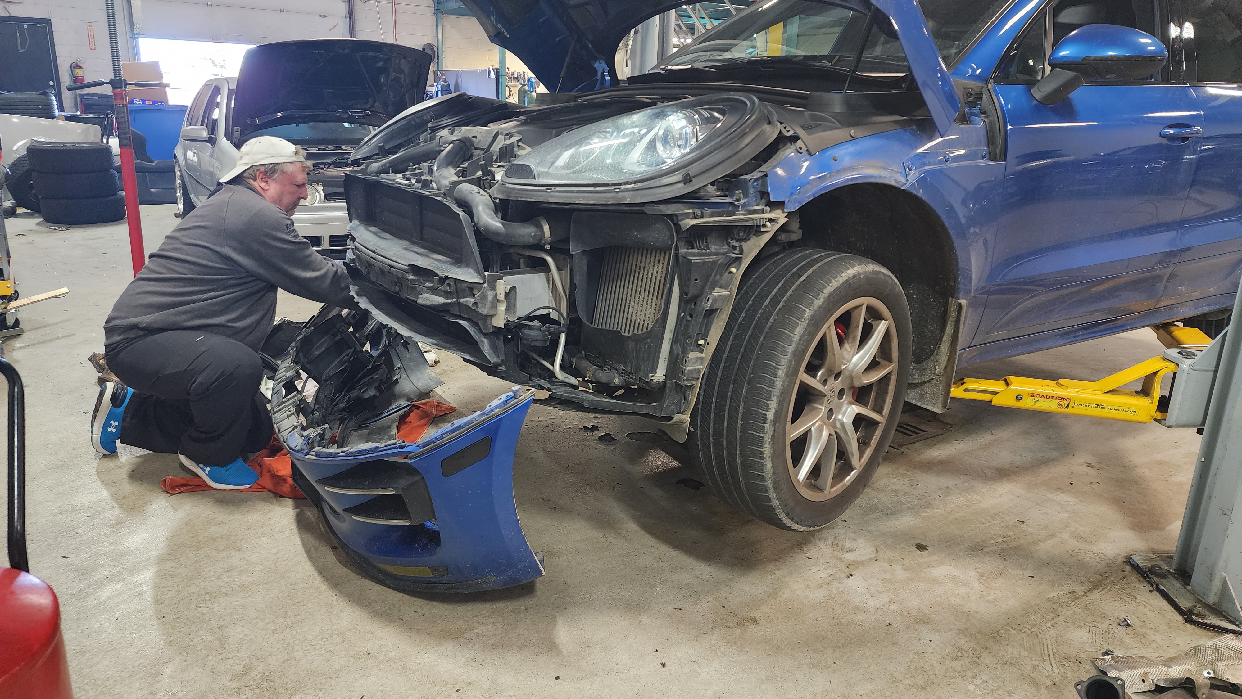

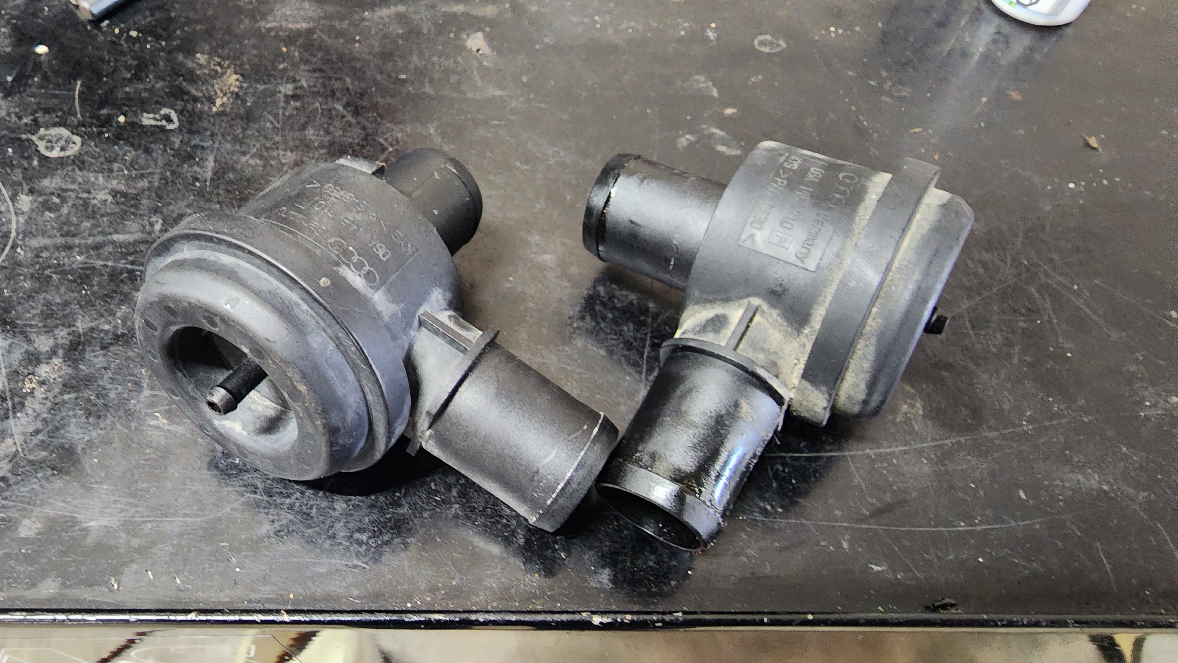

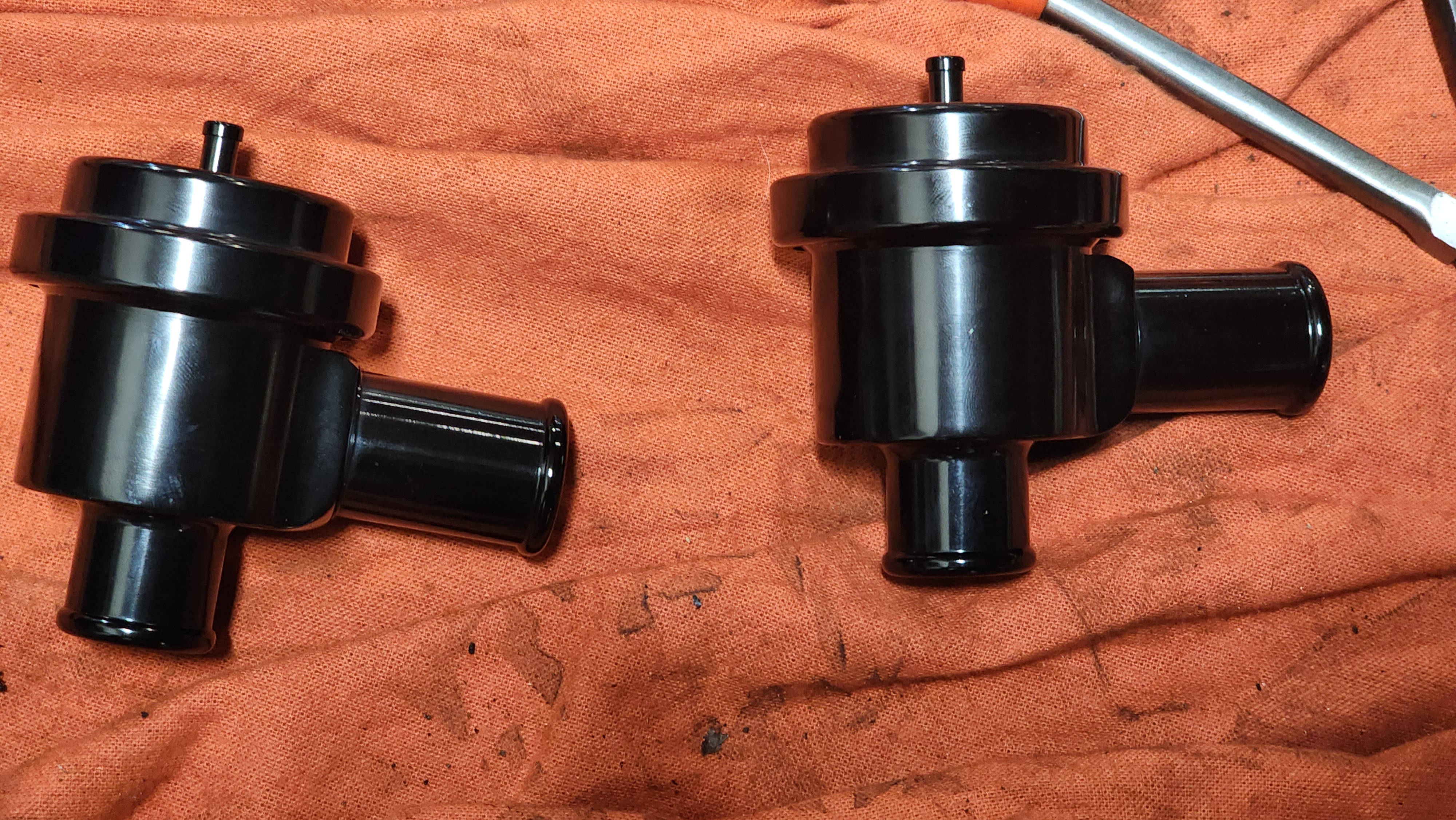

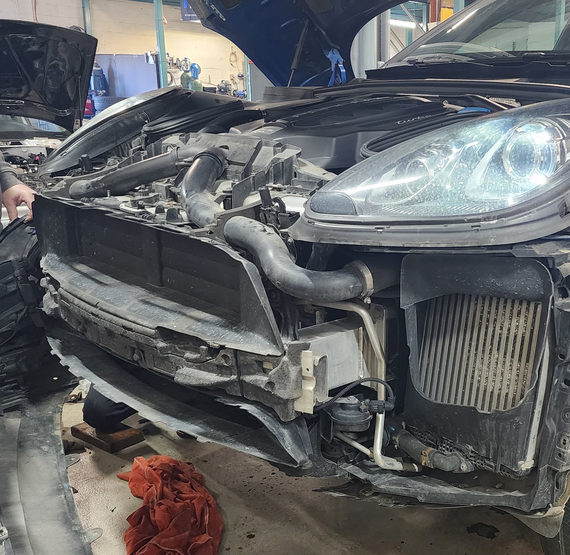

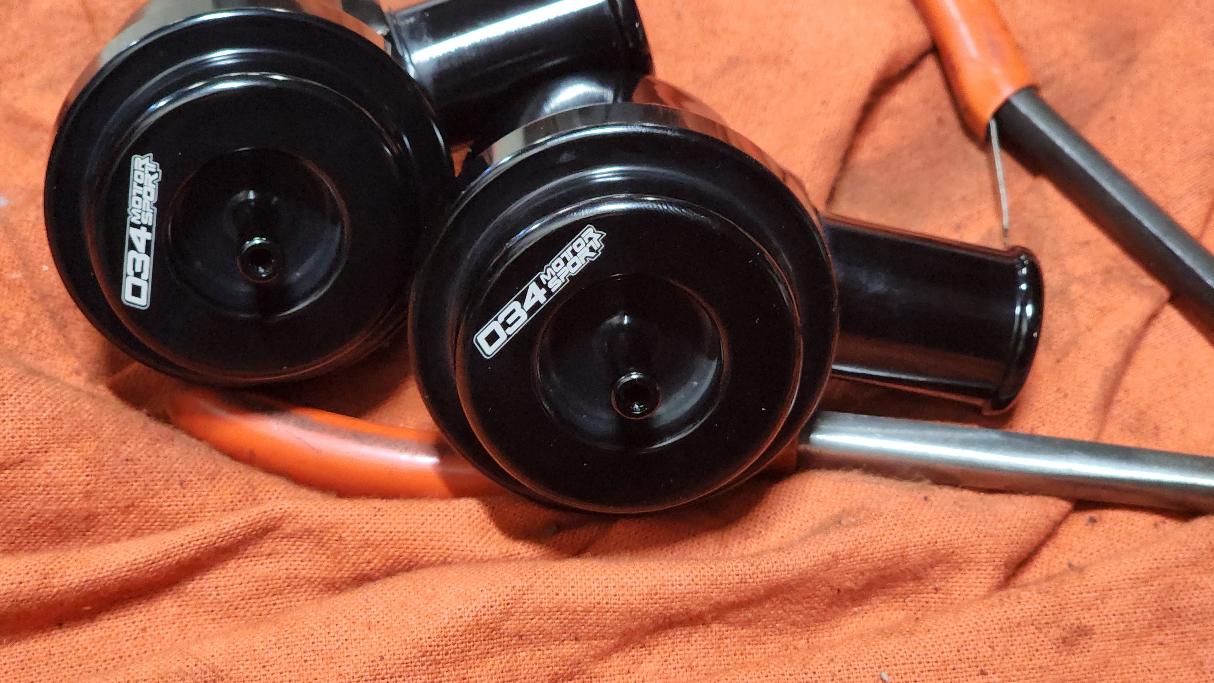

Sorry for disappearing everyone. It's been a busy few months at work.

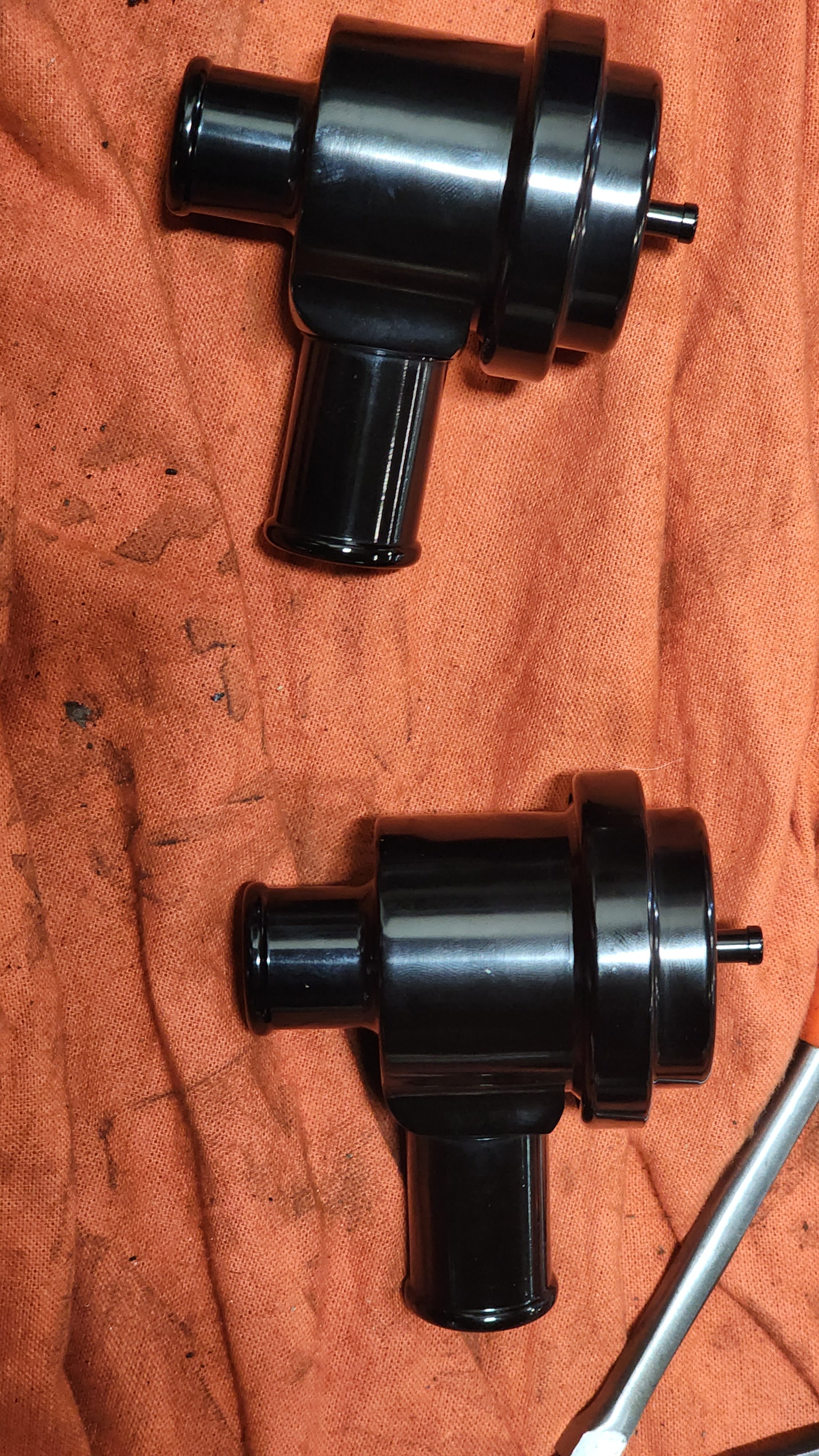

@Teddis & I installed 034 motorsport diverter valves as my stock ones had failed(car was only making 15psi of boost at WOT). Thanks to @GASBill for letting us use a hoist at his shop.

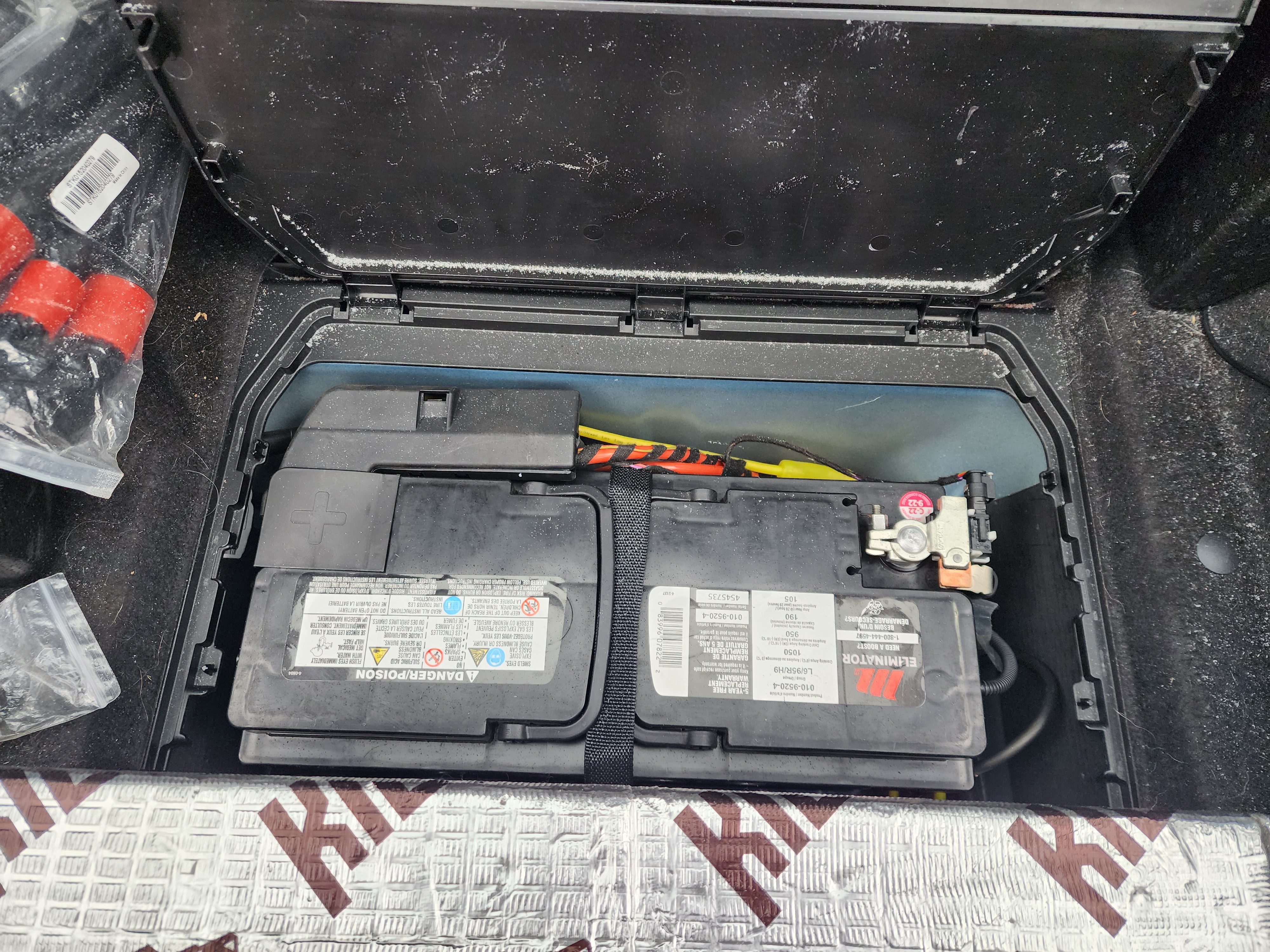

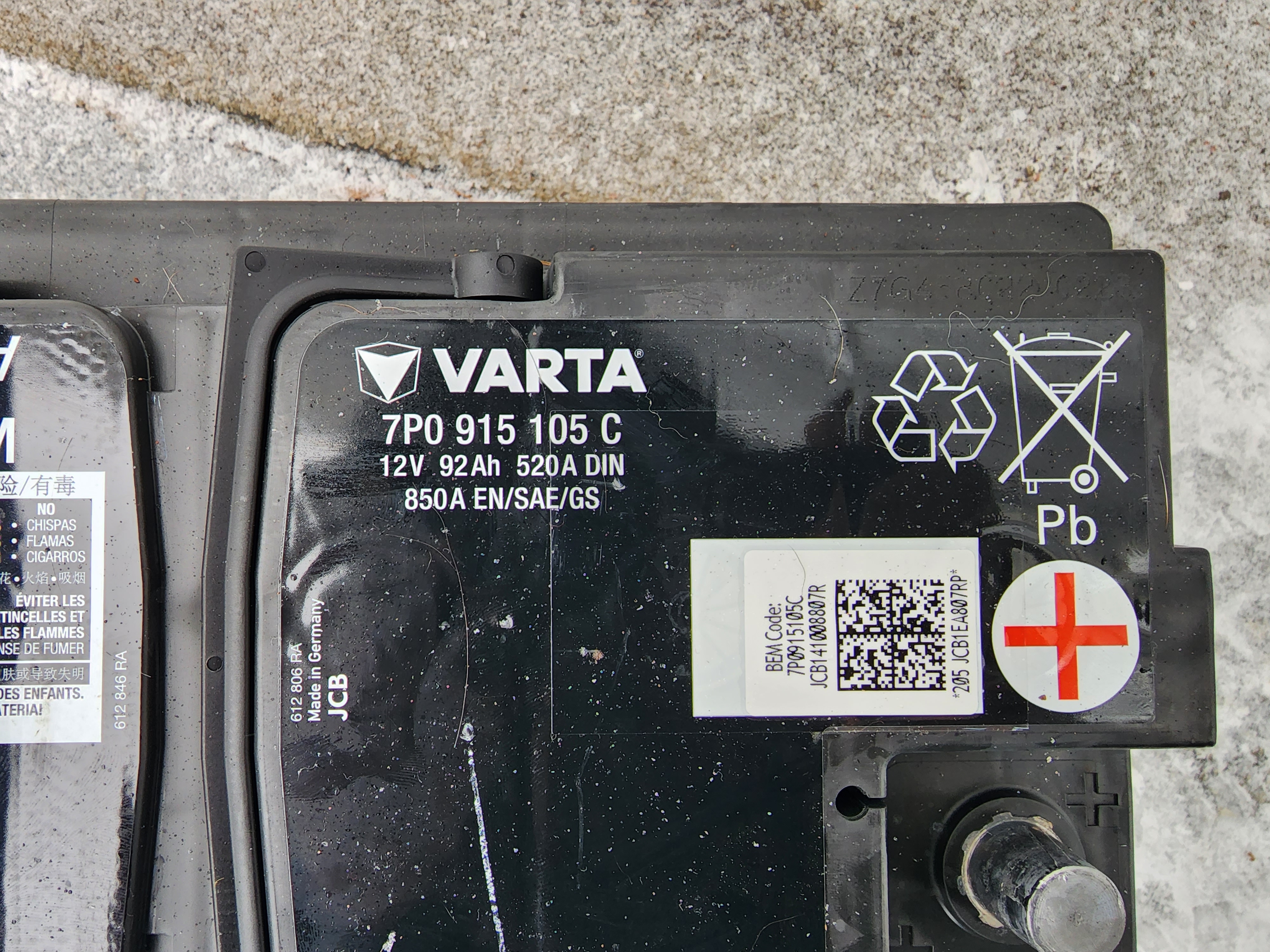

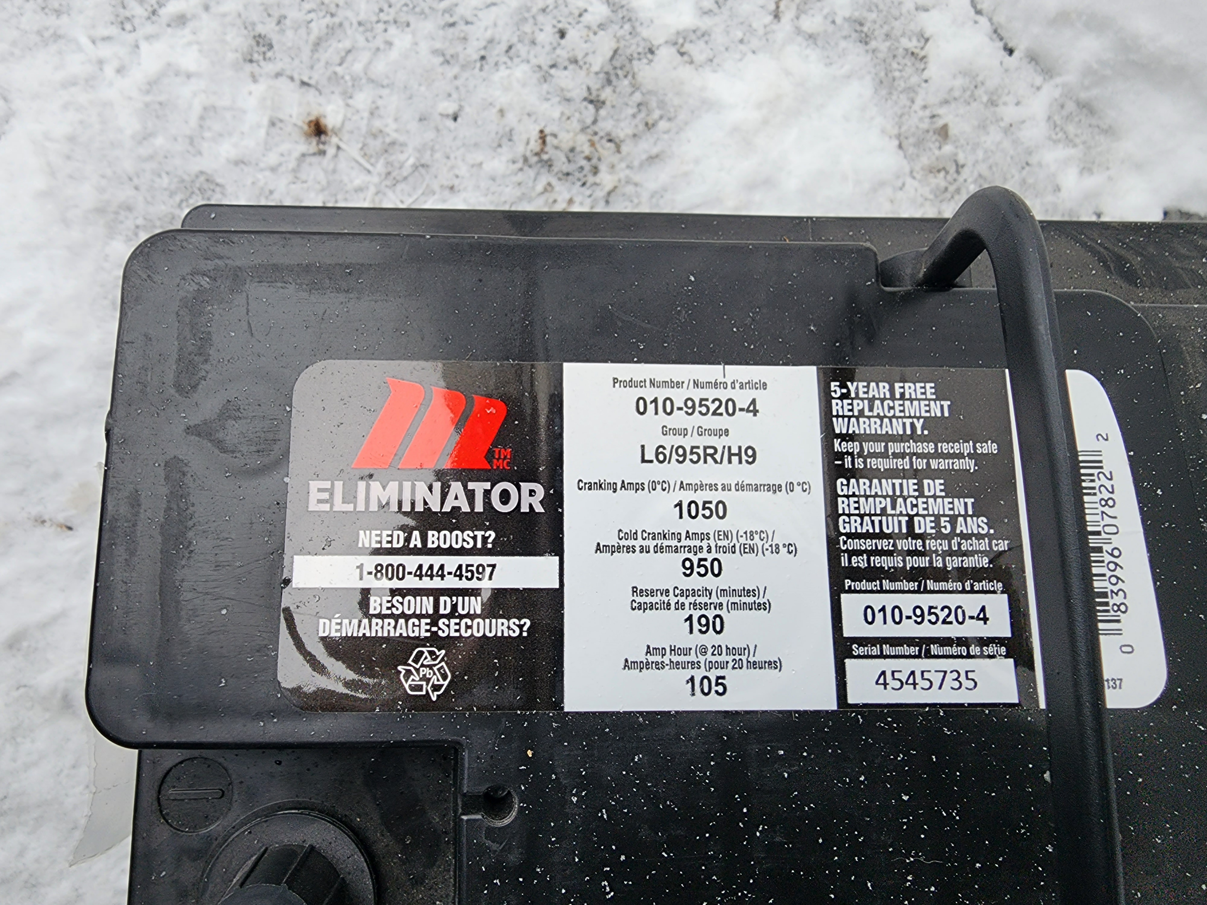

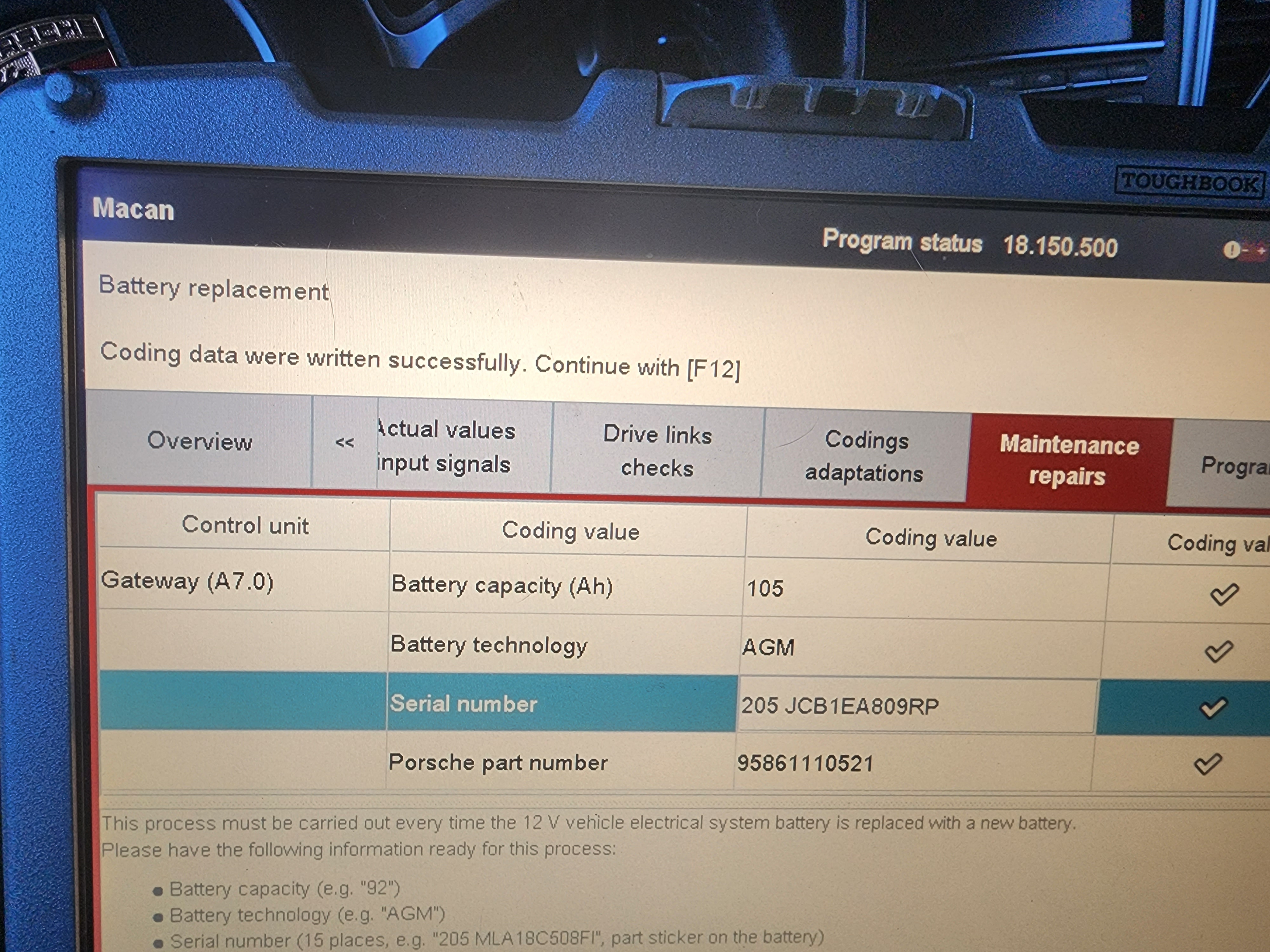

Replaced the 92AH on board battery with a 105AH. Thanks to @Teddis for coding advice & Big thanks to @santirx for hooking me up with his PIWIS 2.
