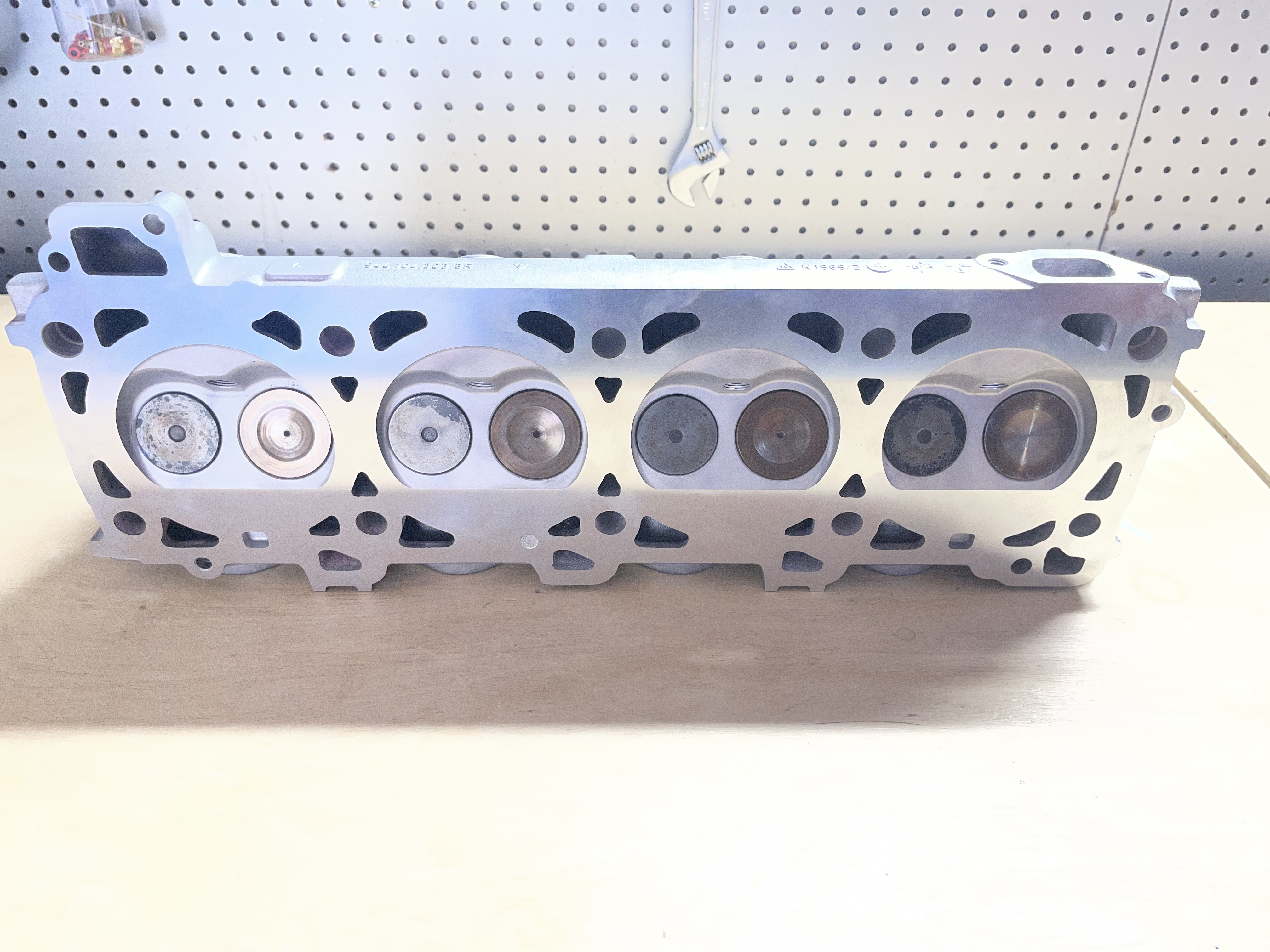

libarra82 wrote: Sun Mar 22, 2026 1:33 pm Head almost ready :)
All is well, just needed a new intake valve and seals.
How much did you shave the cylinder head?
Thank you. :wave:

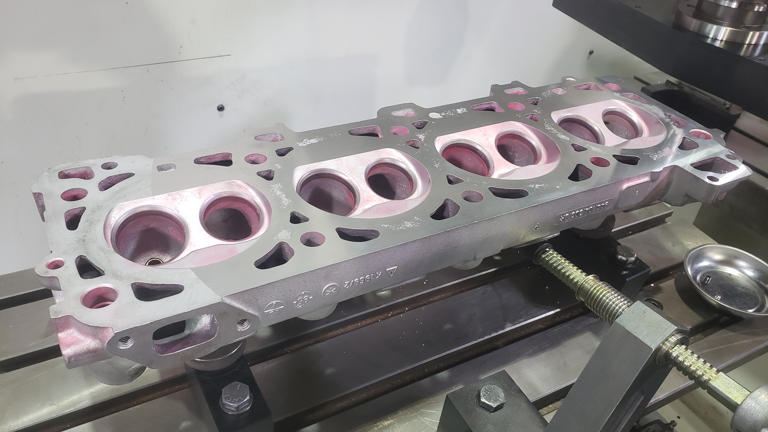

Not sure yet, head still at the machine shop. I don’t think much, though. Here’s a picture after the first pass, it already looked good. Hopefully I’ll get it back this week.

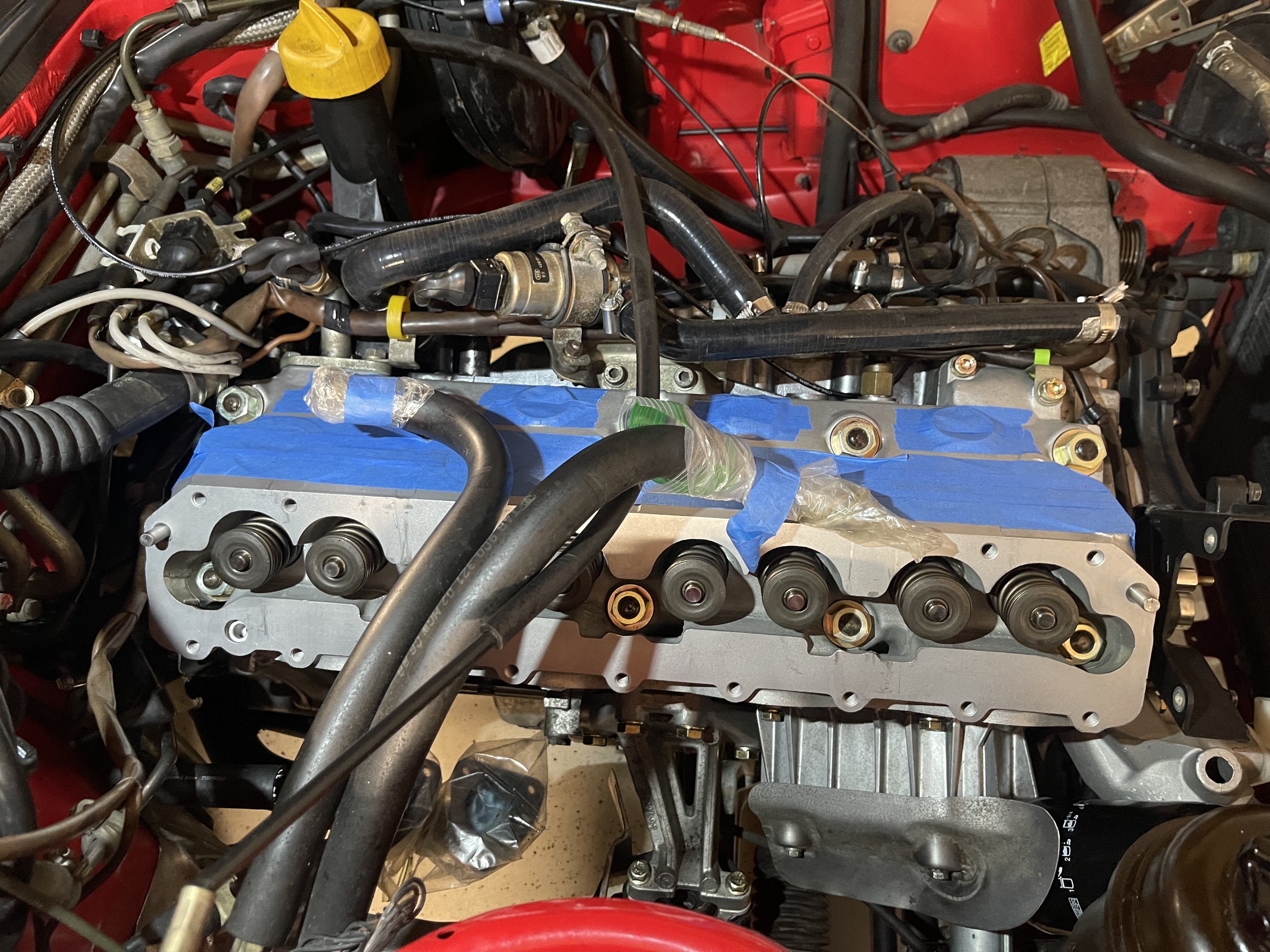

Been thanked: 12 times
The exhaust manifolds are installed. They were nearly as difficult to install as they were to remove. The fit was very tight with the new Allen-style bolts, and I had to slightly drill out the bolt holes in the manifolds to get everything to line up properly. If I were to do this again, I would pre-install the manifold and the rear coolant neck onto the head before installing it in the car. The rear coolant neck was also a challenge to install with the wiring and the air-oil separator in the way.

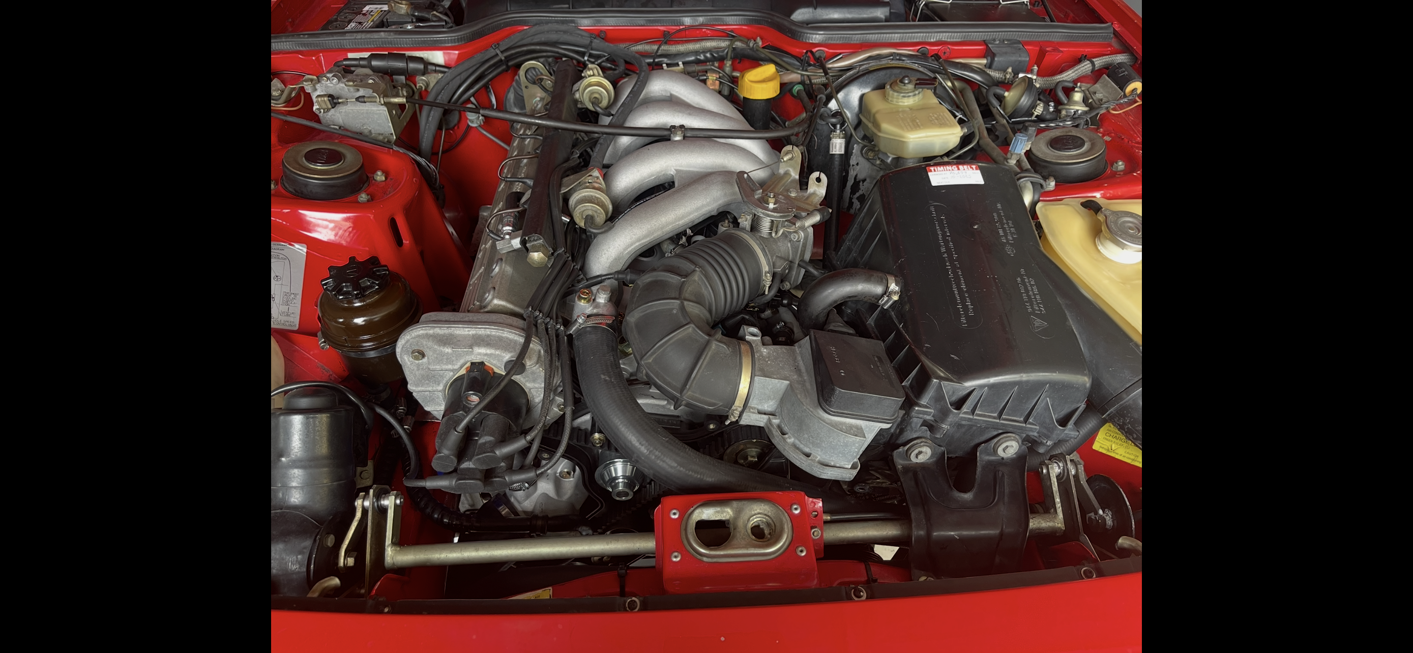

Finally done! Won’t be able to start it today unfortunately, battery completely drained.
