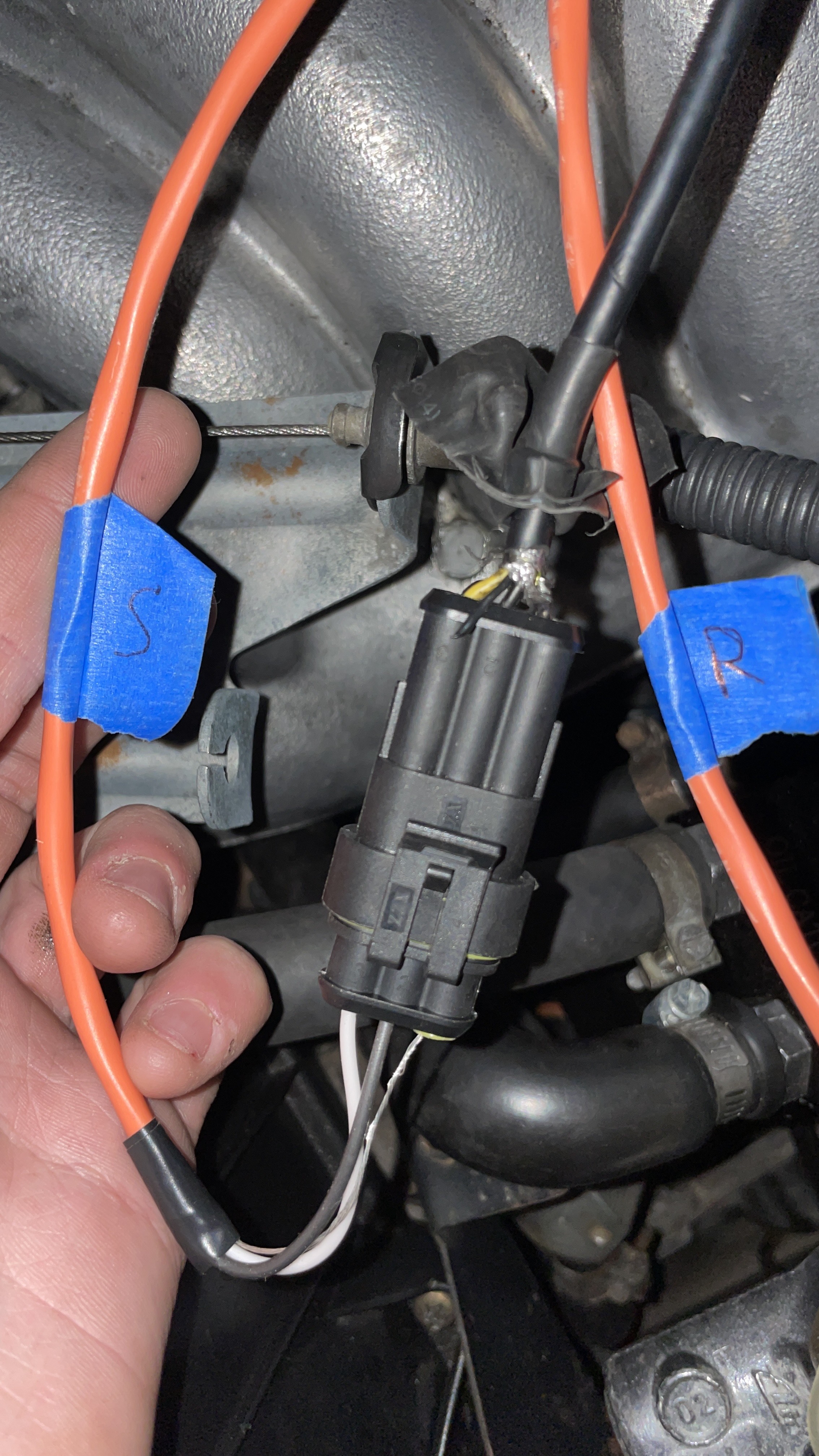

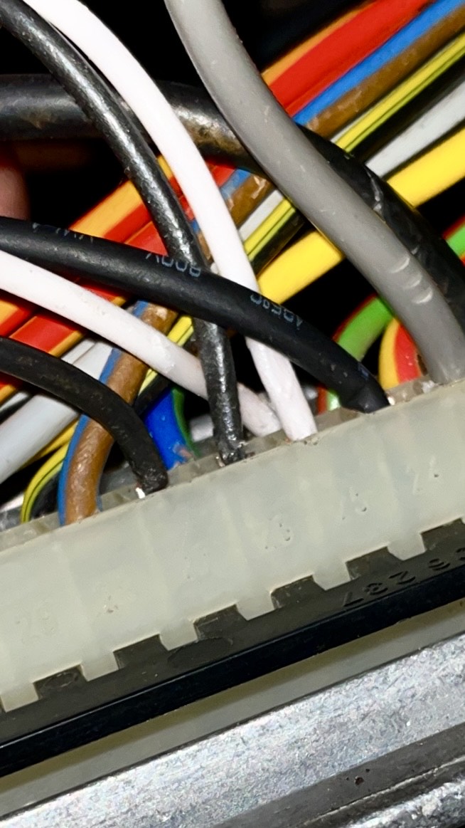

Heres a pic of my DME harness and the Aftermarket connectors i use for the Sensors. (I know it's not the OEM ones but i couldn't be bothered to buy the BOSCHE connectors when i did this 6 months ago.).
Heres the Speed Sensor

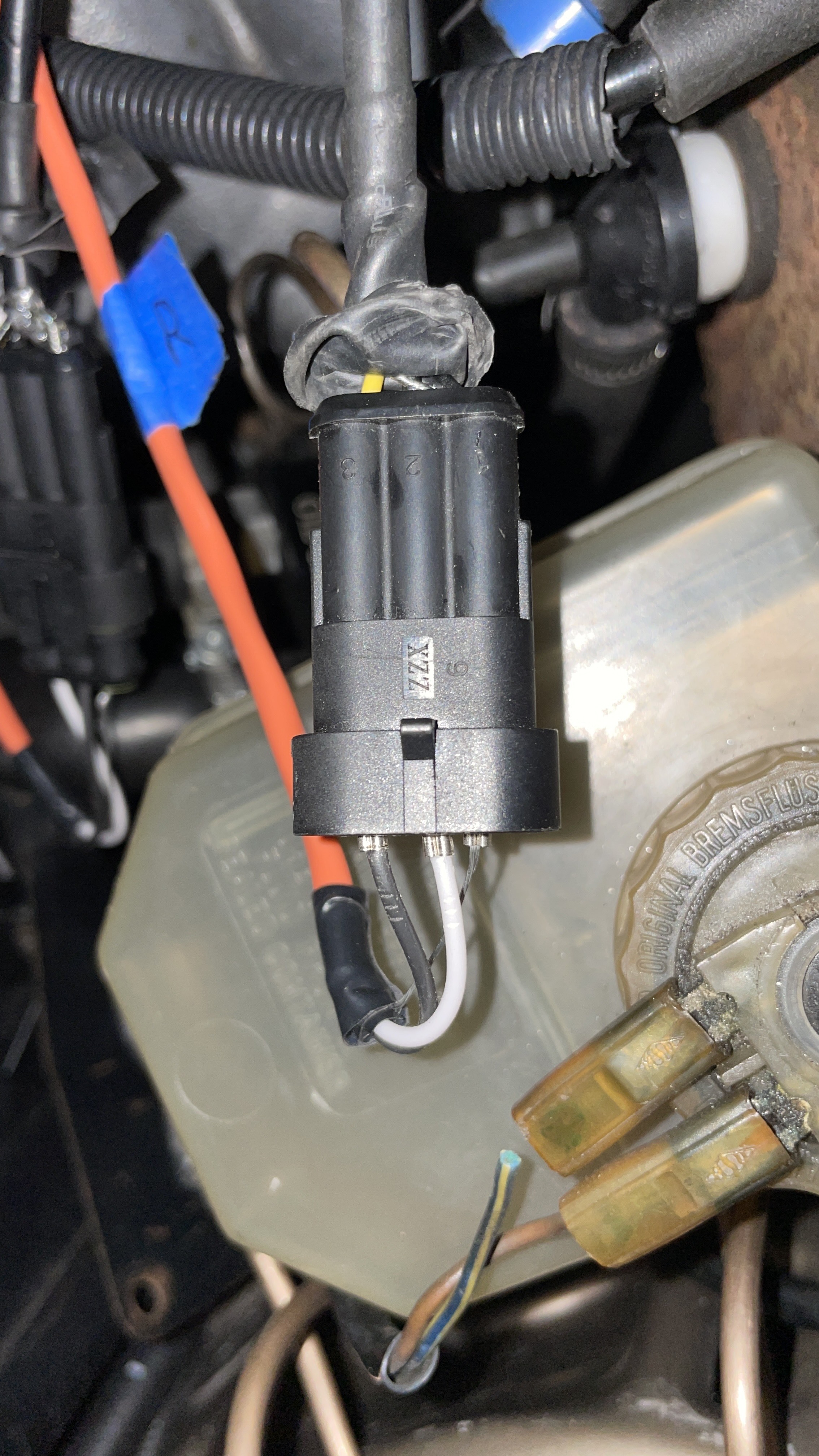

Heres the Ref Sensor REVERSED (This is after I got it running on all 4 today)
You'll notice how close the pins are on the ref sensor that's because i ran out of the housings and i just having the pins together for the test i did.
(Ignore the crusty brake level sender cable) :)

Awesome! Congrats. I saw that comment, but wasn't able to follow the scope enough to comment. A hundred Carpokes points goes to @944er !!! When I tested on the bench, I confirmed the only way for the slope to start down is to reverse the wires. Spinning the flywheel backwards didn't do it. What brand is the sensor? Are both sensors the same brand? Someone went through something kind of similar with brand new FAE sensors that were incorrectly wired and grounded the pulse to 0. Part of the issue is the aftermarket mfg try to cover a lot of cars with one part, and may not realize subtleties like polarity really can matter. Anyway -- awesome find and definitely one for the mental databank!

Here's a possibility maybe... The factory wiring diagrams show the colors of the wires in the factory engine harness. Yellow to 25 and black to 26 as you say. However, the speed and reference sensors are shipped as a sealed unit with no 'spec' for the wire colors inside. They could be purple and pink for all it mattered, as long as they terminate in the right spot on their original connector. Any chance you just assumed the colors matched up? From your report, seems pretty clear they don't. Did the sensors come with a factory style JPT connector and, if so, did you check to see which wires went to 25 and 26?
