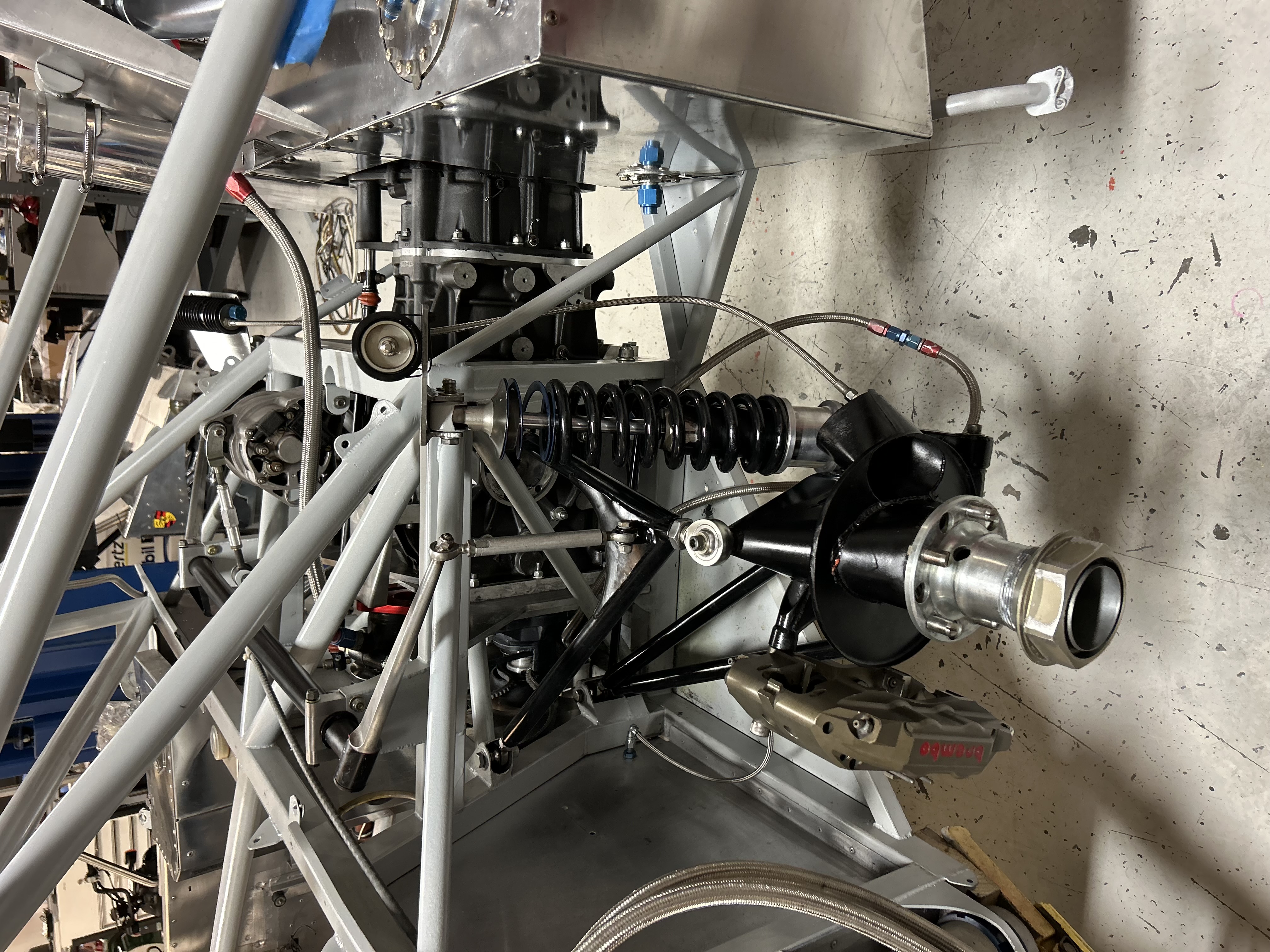

michaelmount123 wrote: Wed Feb 07, 2024 2:21 pm 72896029326__27F9FF21-CC6E-45B8-9008-BA076D51A1DD.JPEG72896033266__1AFF6D29-CAE9-4711-85A1-1CCD9A8BB5C5.JPEGIMG_4225.JPEGSuspension going back on, but still waiting for Penske to rebuild shocks. Interesting fabricated uprights, eh?
The Hewland trans shifting is all mechanical; no engine cut for shifts. I would always stab the clutch for upshifts, but all that's needed is a quick pause on the throttle and the next gear can be found. The clutch is needed for downshifts. Shifter and linkage by Fabcar are excellent.
That's an interesting GTR in New Zed! I recognize it from my old PCA race days here in the US. The engine is no longer a GTR, but clearly much of the car is. The car belonged to Dick Howe and was prepared by Eric Barrett.
Are those uprights from a 935 Michael? They look pretty bespoke.

No, they're not 935. My (educated) guess is they are Fabcar pieces fabricated in house. Fabcar would fabricate these since they didn't have Porsche's resources to cast uprights out of aluminum like on the 935 front corners.

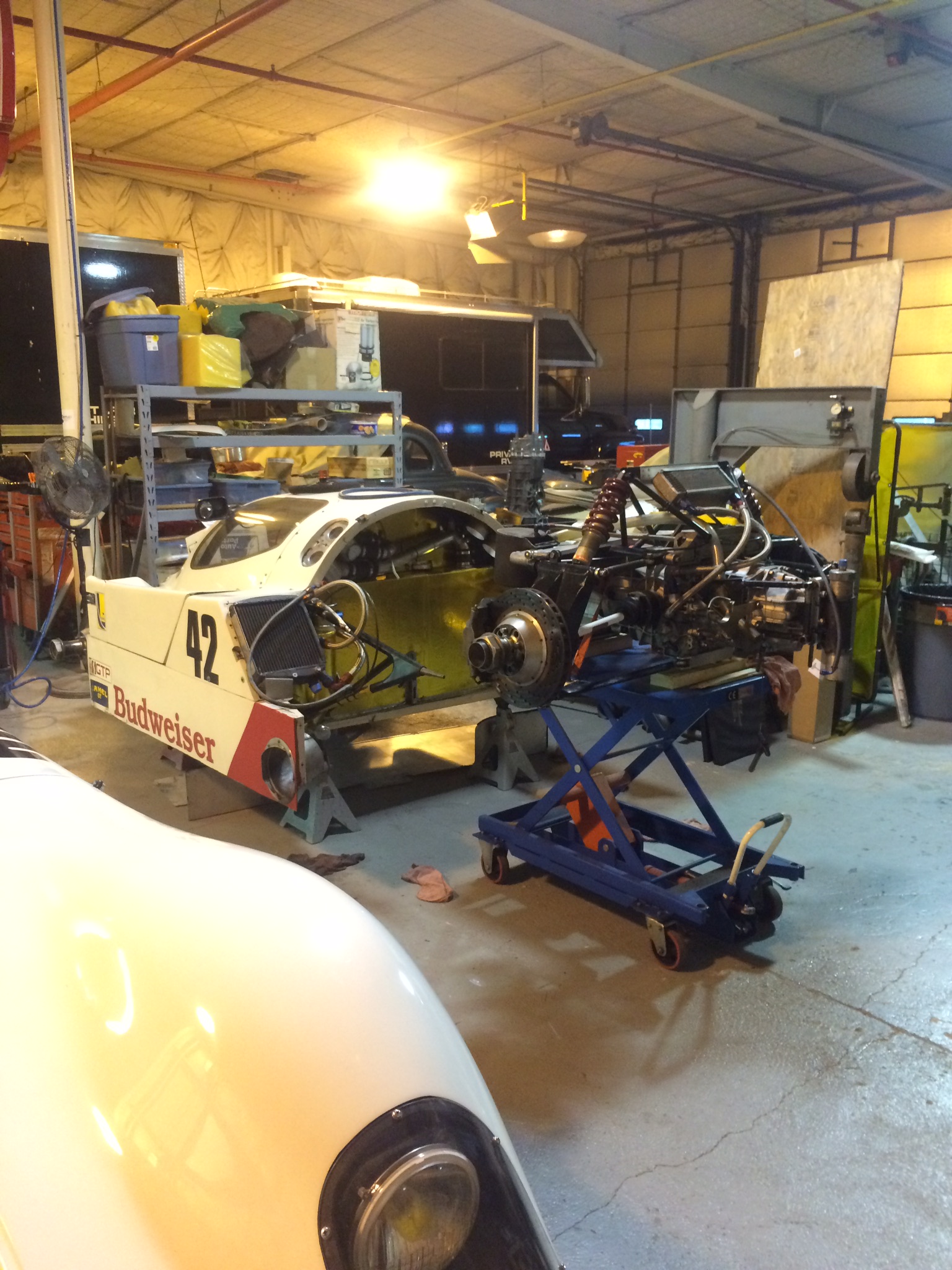

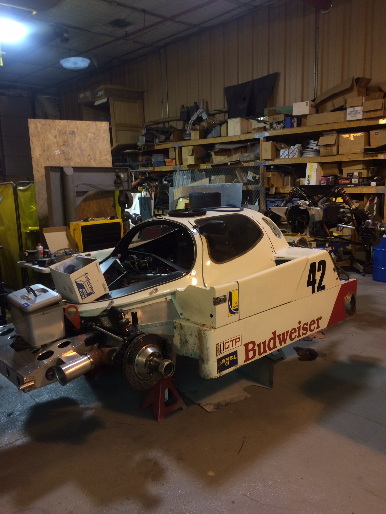

They do look similar in design/build to uprights on the Fabcar built 962 we maintained at the shop I worked at during college.
Can kinda see them in the poor quality pictures below (nick named the fat lady as she was quite a pig compared to the 910 and RSK we also maintained):
