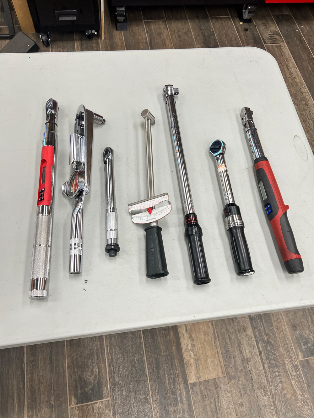

So I've been working on a project to give people another option for tensioning their belts. :) For people who don't have the factory or Arnnworx tool, and don't have any kind of feel from how tight to set the belt, I wanted to come up with something to help. It's not a true alternative to those precision tools, but rather a handy aid for those who would otherwise be winging it. The one calibrated tool most people do have is a torque wrench, so I set out to create a tool that relies on the torque wrench to measure the tension of the belt. I also set it up to be an easy 3D print that can be done on any home 3D printer in just about any plastic (the screws add mechanical strength where needed). I've tried 4 different torque wrenches so far, including the brand new $18 HF wrench in the video below, and I surprised myself how accurate it seems to be with all the wrenches.... I'm still calibrating and fine-tuning the model, and hope to post it in the next day or two, but see below for a sneak peek. :)

That a nicely designed, simple tool Tom and I can see how it should deliver consistent results. You should also try it with an old style beam torque wrench as that could be even more accurate having a nice linear build up of torque without the click back at the final torque value. Well done!
Re: Timing Belt Tension Poll....
Posted: Fri Jul 01, 2022 10:15 am
355 wrote: Fri Jul 01, 2022 6:42 am That a nicely designed. simple tool Tom and I can see how it should deliver consistent results. You should also try it with an old style beam torque wrench as that could be even more accurate having a nice linear build up of torque without the click back at the final torque value. Well done!
Thanks! Since this is a 'budget' tool, I went out and bought the 1/4" inch-pound torque wrench at Harbor Freight for $18.99 and was using that in the video. I just wanted to make sure that the tool worked for people who don't have fancy torque wrenches. But you're right, beam style would be good for that too and, like digital torque wrenches, work well because you can see the torque as it builds, as you say. I initially thought the click types wouldn't work so well, but they actually do fine. The tool was surprising accurate across all the wrenches I own -- even ones the old ones that are probably out of calibration and the big ones technically not accurate at such a low force. Every one of these wrenches were clearly off the marks at 7 ft lbs (84 inch pounds) when I set the tension to 2 or lower or 5 and higher. I wouldn't say it can accurately tell the difference between 2.7 and 2.8 on the 9201, but I'd argue the factory tool offers a false sense of precision anyway, insofar as the number will fluctuate a lot depending on how far you turned back the motor, how much you've moved and tested the belt in the same location, etc. At any rate, I tried all of these....

Needless to say, I like torque wrenches. :) I've had a few of them calibrated a few years ago (and they were predictably way off). The snap-on dial wrench is for engine assembly and gets calibrated before engine builds. :) My go-to is the Snap-On digital wrench for everyday wrenching.
