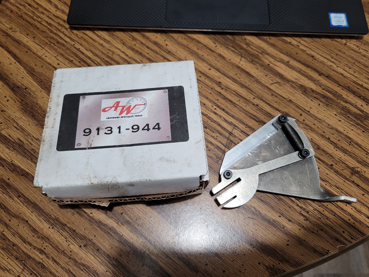

Arnnworx has a really basic cheap one?
johnb
Posts: 321
Joined: Thu Jul 08, 2021 5:57 am
Has thanked: 110 times
Been thanked: 78 times
Tom wrote: Sat Jun 11, 2022 2:16 pm
johnb wrote: Sat Jun 11, 2022 2:15 pm They're not completely exclusive, since I always test by hand as well, but I mostly rely on the arnnworx tool. (The good one that replicates the factory one, not the really basic cheap one).
Yeah here it is. I'm not sure if they still make it, and I definitely can't remember how to use it:
In any case it's not that good (but better than nothing).

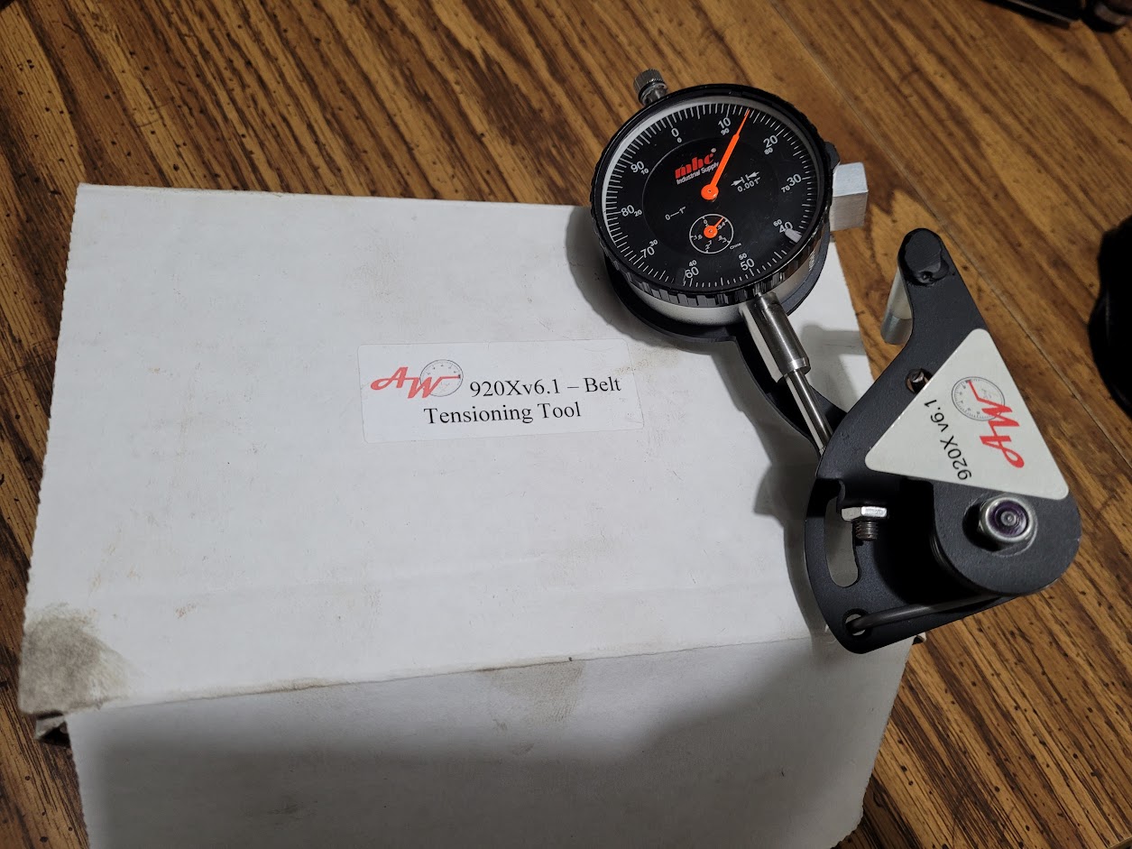

And here's the legit one if anyone's wondering what that looks like:

I had never heard of that cheap Arnworx tool before. Hard to even imagine how that works!

Spring44 wrote: Sat Jun 11, 2022 10:30 pm I had never heard of that cheap Arnworx tool before. Hard to even imagine how that works!
You put one of the slots over the belt (there's one slot for the timing belt, one for the balance shaft belt). Then you use the tool to twist the belt, and the idea is that it measures the force required to twist the belt a certain amount. But I can't remember the exact details now.

I voted for the Arnnworx tool, since I bought one to make sure everything is OK, but I actually just rely on the tensioner to do its job.
So, I sort of cheated on the reply.
I'm a little surprised that the 9201 tool sees as much use as it does in the poll, so far. I've always thought those things were about as rare as hen's teeth.

Zirconocene wrote: Mon Jun 13, 2022 1:31 pm I voted for the Arnnworx tool, since I bought one to make sure everything is OK, but I actually just rely on the tensioner to do its job.
Cheers
My spring tensioner thing consistently tensions the belt under the factory spec -- like 2 to 2.5 on the 9201. I always have to give it a little nudge to get it up to spec. I suspect the 9201 has a higher rate here in part because we have a lot of long-time 944 diehards here. Results might look much different on elsewhere? I have an idea I'm playing with to help people get the belt tensioned to spec (or very close) without a 9201 or Arnnworx tool, so was asking just to get a sense of who is using what....

I bought my 9201 back in the late1980-1990 period when there were no other alternatives that I knew of. It cost just north of $400 then, and it paid for itself on the first belt change that I did with it. It was pretty pricy at the time, but was not that much compared to the $1300 belt/water pump replacement cost at the dealer. I think that my purchase of the flywheel lock, the pin wrench and the offset spanner wrench added a couple of hundred more to that cost as well.
I think that I have seen the 9201 gauge going for as much as $1200 online recently but if you adjust that cost for the time-value of money, it may not be that much higher than what I paid for mine 30+ years ago.
I'd do it again though. Considering the consequences of an erroneous tensioning, using a seat-of-the-pants guess like twisting the belt just gives me the willies! Mine is an '84, so no automatic tensioner for me!
