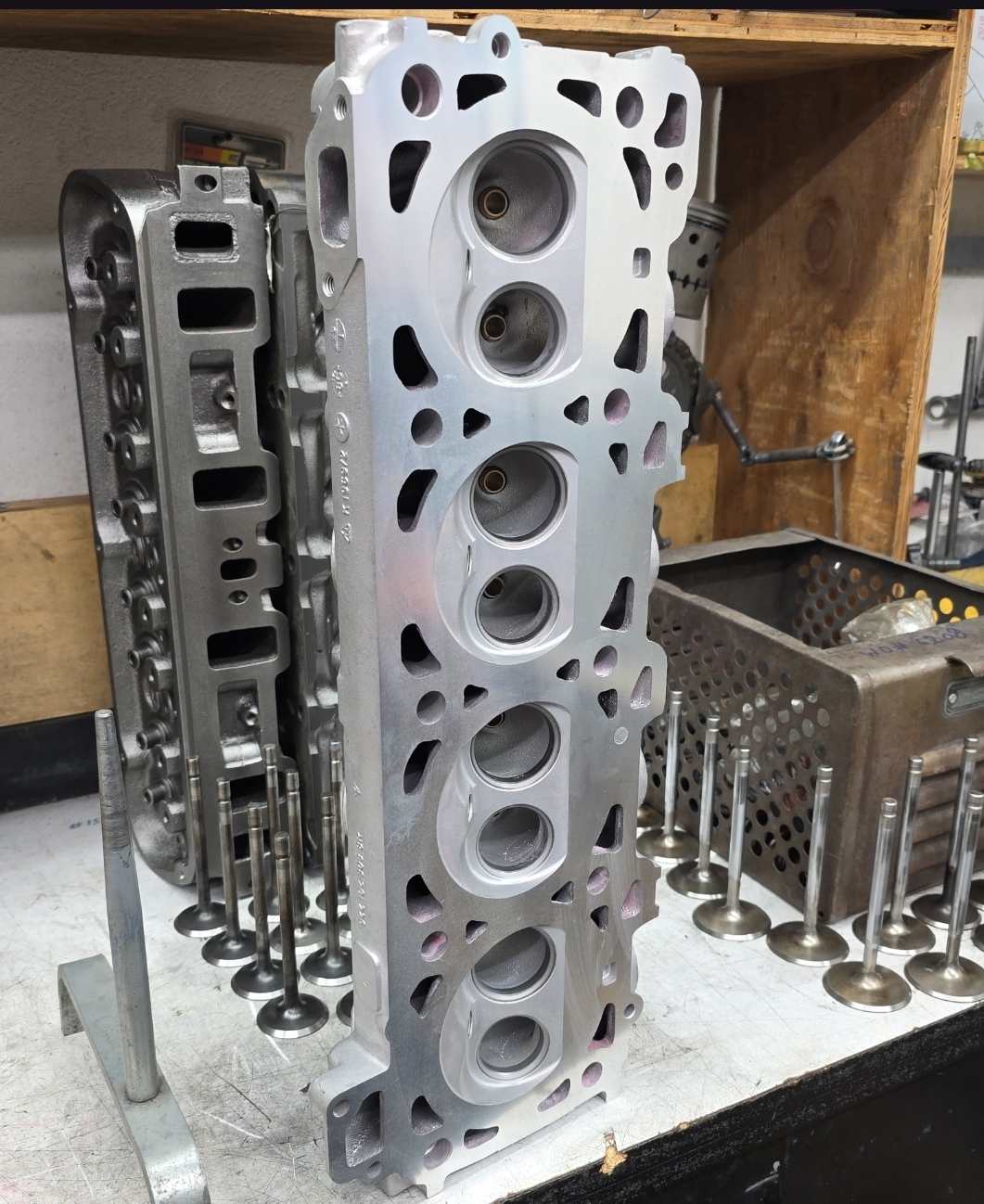

Head almost ready :)
All is well, just needed a new intake valve and seals.

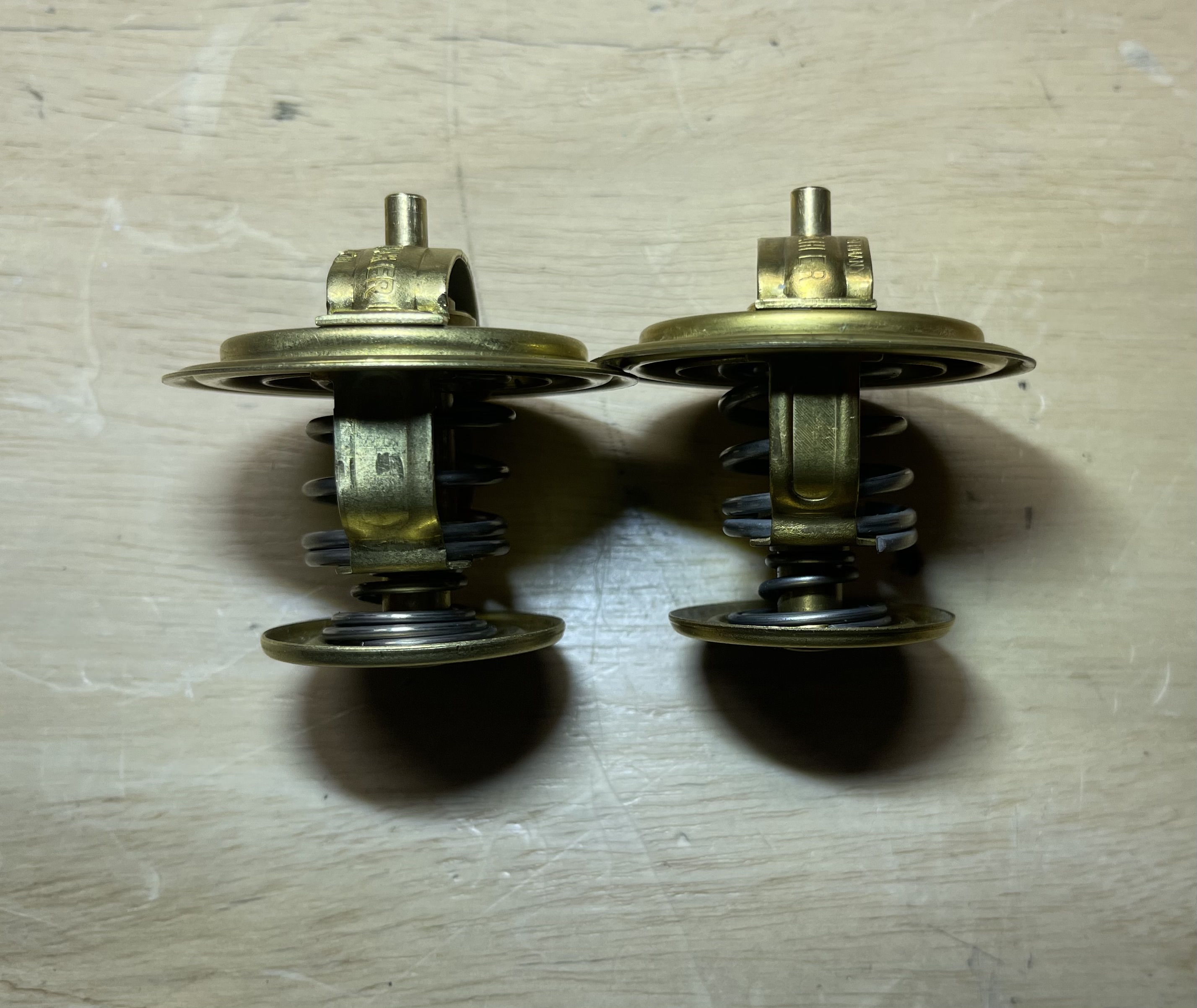

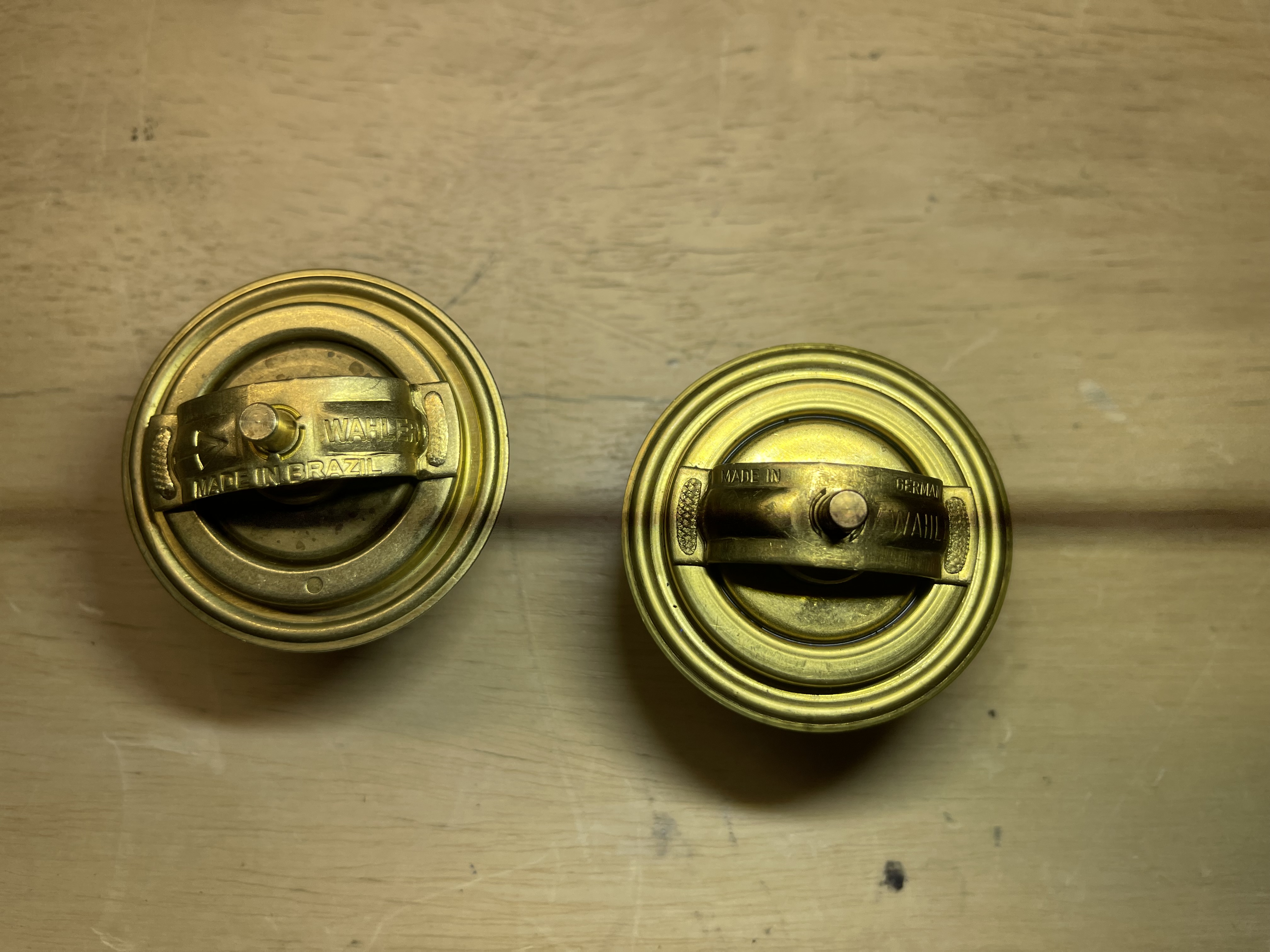

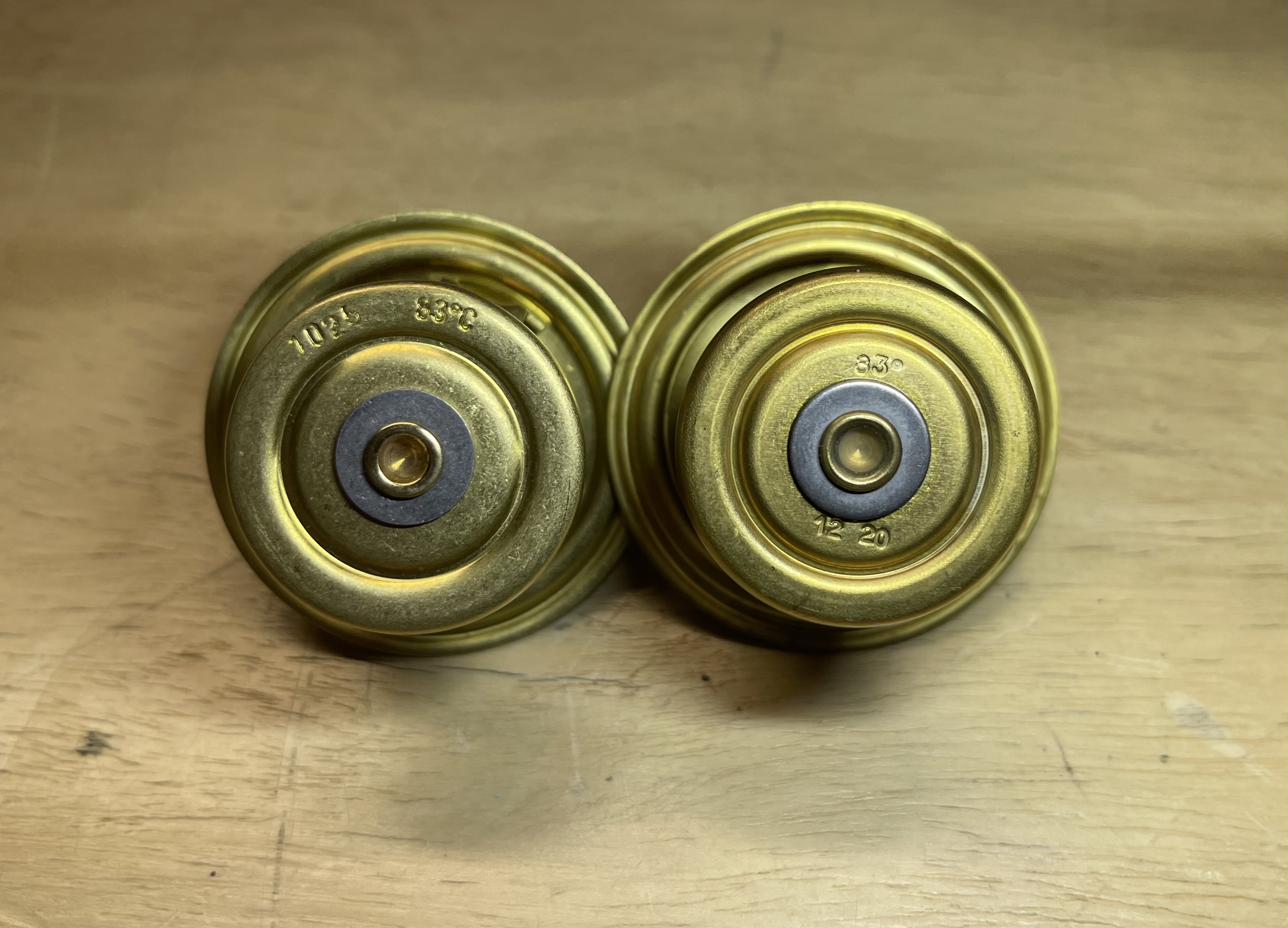

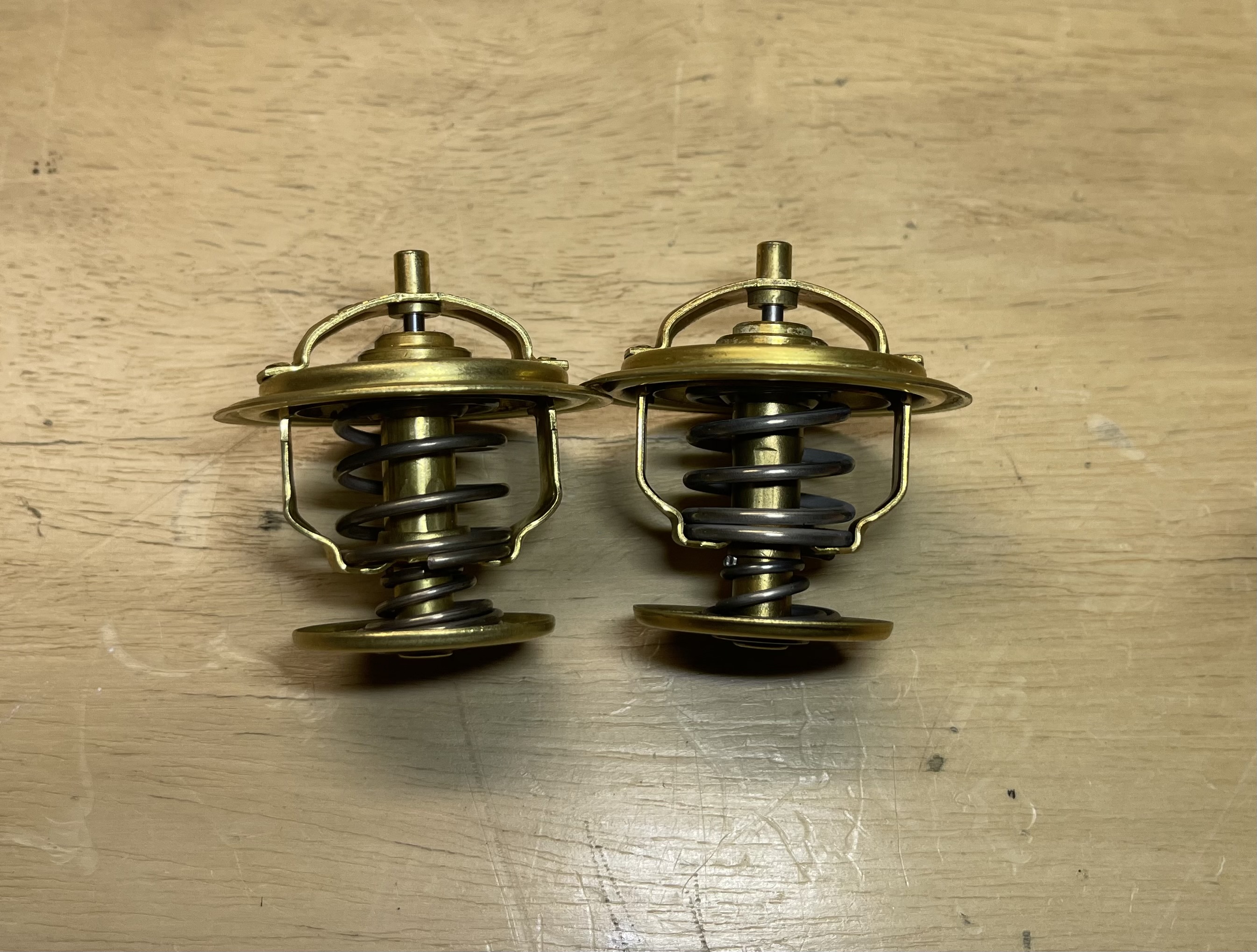

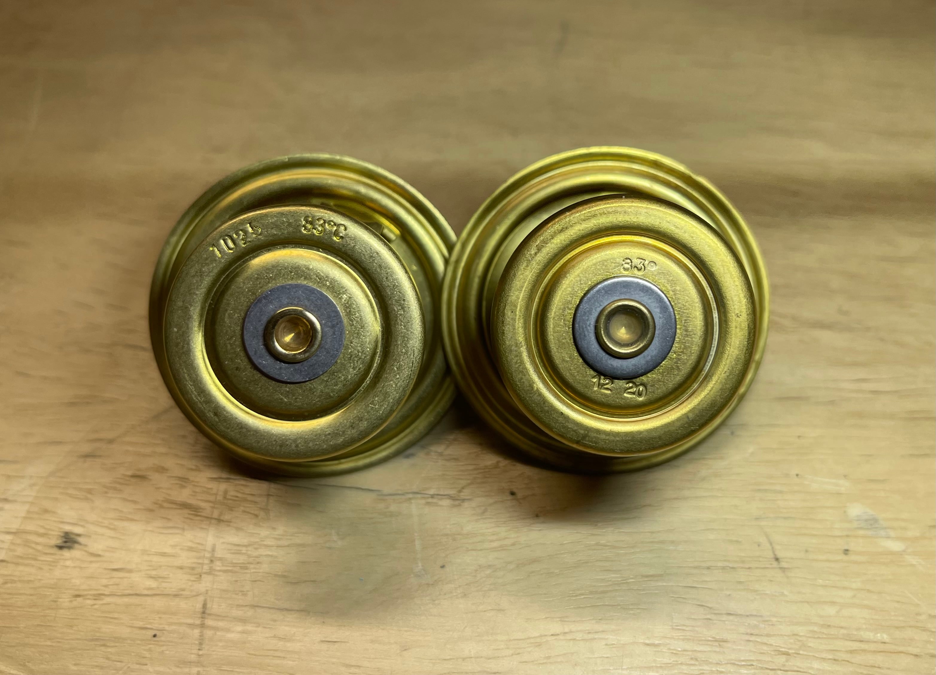

I have two thermostats made by Wahler, one OEM purchased from my local porsche dealer with about 200 miles on it, and one brand new aftermarket version. They’re essentially identical in design, but there are some noticeable differences, so I decided to compare them.
The OEM thermostat is manufactured in Germany and has a richer brass color. The stamping is cleaner, the springs appear visibly thicker, and it takes more effort to press down and open.
The aftermarket unit is made in Brazil. It feels a bit flimsier even though the weight is similar. It also has some minor staining and small nicks despite being new out of the box. It opens with noticeably less force compared to the OEM.
It makes me wonder: is there an advantage to the OEM’s stiffer springs over the aftermarket version?
Aftermarket on the Left, Porsche Right

I would use the OEM
For kicks, suspend each in water with a thermometer and bring to temp to see when each opens

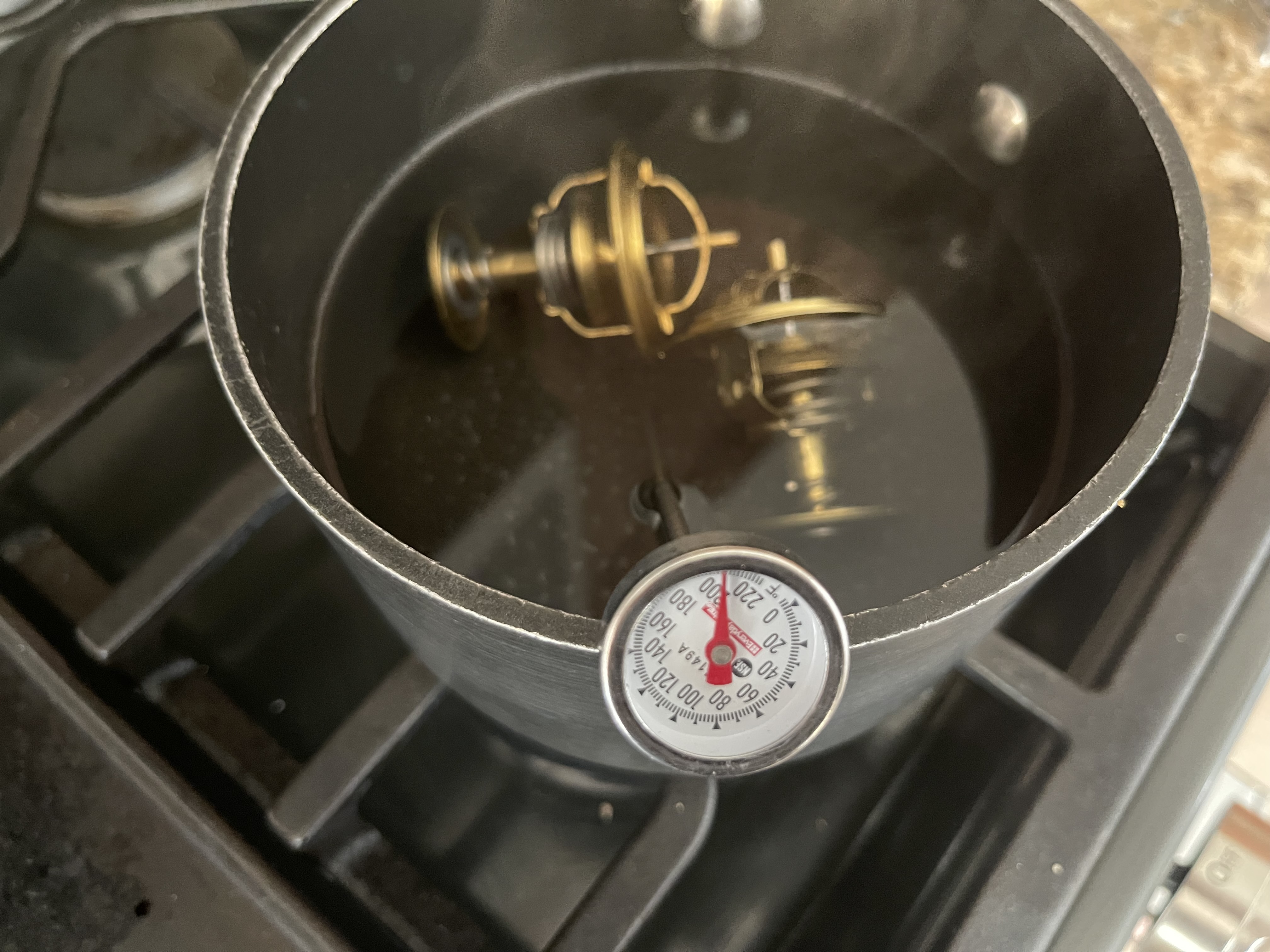

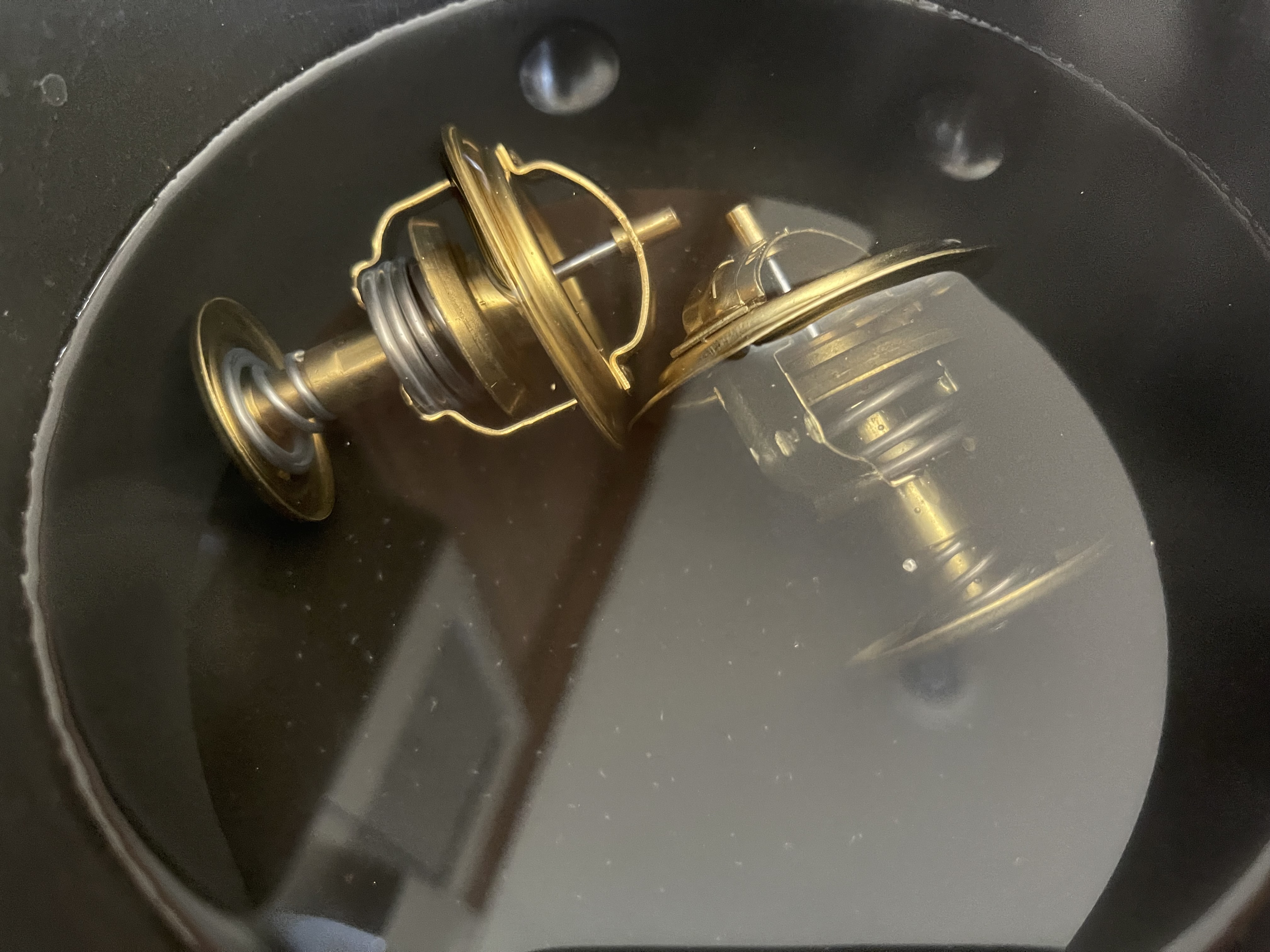

My test wasn’t the most scientific, but it should serve as a good reference point. I submerged both in hot water and observed their performance. As expected, the Porsche performed better, it opened and closed more quickly and had a larger, more even opening.
Edit: I believe they started opening and closing at the same temp. OEM opened and closed almost instant, aftermarket was gradual, took a minute or so to fully open and close after the OEM.
Porsche
Open: 210f
Close: 170f
Aftermarket:
Open: 220f
Close: 160f
Porsche top, aftermarket bottom

Sometimes it's worth ordering from the dealer
