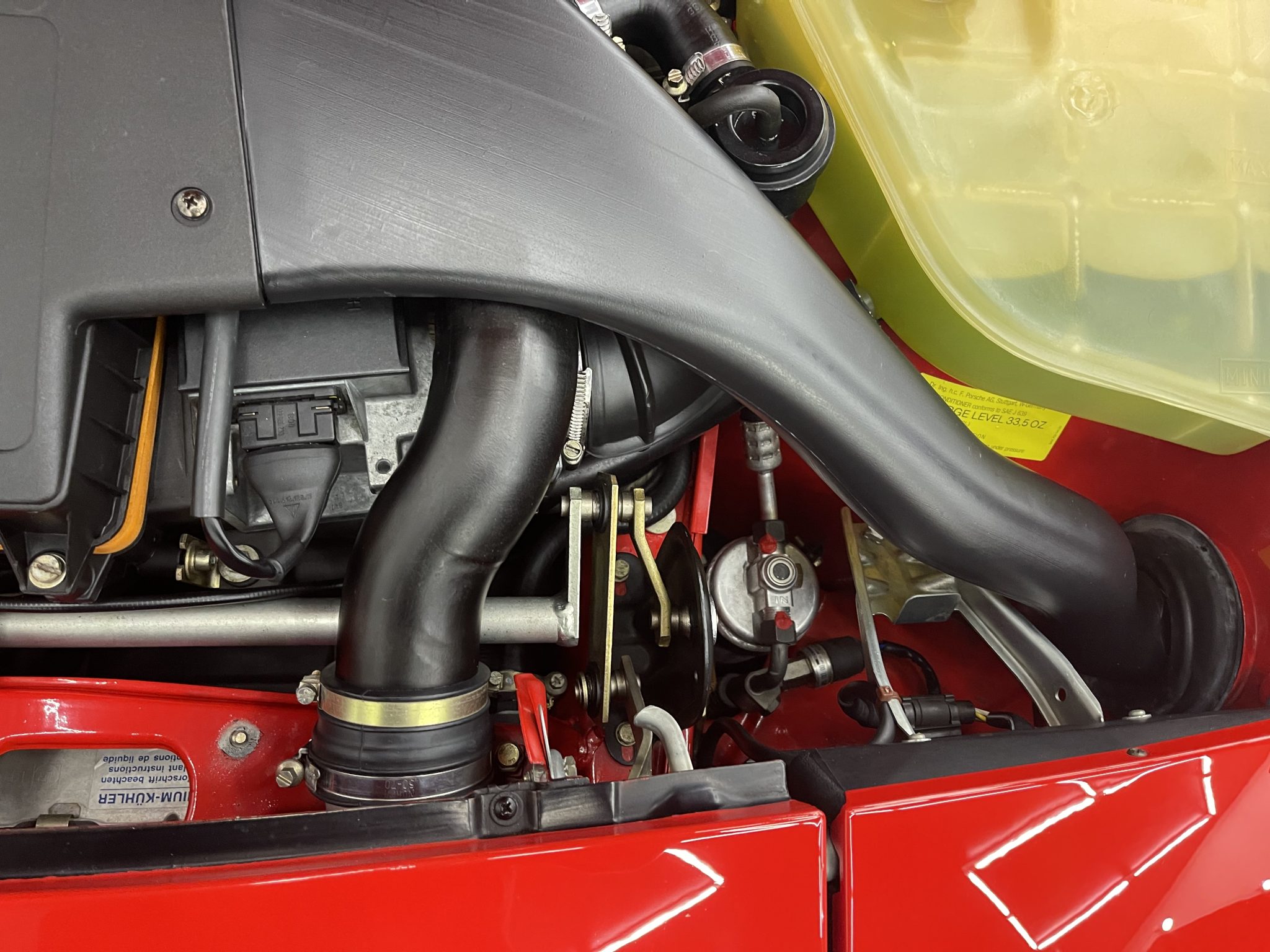

Regarding your AFM pvc sleeve dilemma...
I sometimes go to BAT and look at engine bay pics of very low mileage cars to get an idea of how some of the original wiring and vacuum line routes may have been done.
This is from a 3,100mile '89 Turbo.
Cheers

Gaspowered wrote: Thu Feb 05, 2026 10:38 am Regarding your AFM pvc sleeve dilemma...
I sometimes go to BAT and look at engine bay pics of very low mileage cars to get an idea of how some of the original wiring and vacuum line routes may have been originally done.
Cheers
Well my goodness. I can't believe I didn't think of that! For some reason, I just didn't think there was enough room between the top of the AFM and the airbox snorkel. I wonder if the factory put a plastic grommet somewhere on the AFM to hold the harness in place. I GREATLY appreciate you posting this!!!

Gaspowered
Posts: 157
Location: OK
Has thanked: 296 times
Been thanked: 83 times
I reference the low mileage car pictures for quite a few things i.e., to see if I might have undercarriage clips missing, bolts, interior screw caps, etc.
Glad it helped.
