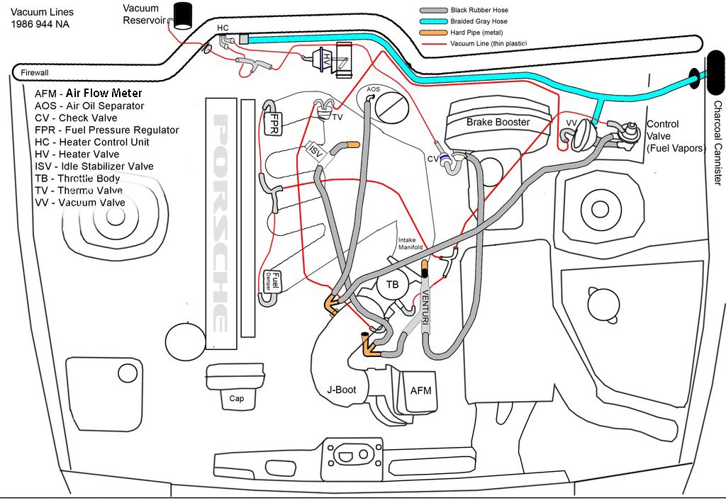

Man, I am struggling with the vac line kit from 944online. All of my hoses under the intake were one step from dust or just gone so I don't have a good reference. If work would quit kicking my tail that would be nice too. The glory and curse of being a good at your job 😆
Time to hit YouTube and Clark's.

stoneguy
Posts: 34
Joined: Sat Jul 09, 2022 4:42 pm
Location: Boston area
Been thanked: 23 times
944 vac2.jpg (211.97 KiB) Viewed 2480 times

Tom, I was looking at those last night and a little confused before I realized it was for a turbo.
Stoneguy, Thanks!!
My Thermovalve is broke. Any reason not to just skip over it and connect the vacuum valve straight to the intake? Seems to only vent when it's hot and pulling vaccum. Constant vent when running should be fine, right?
I see a lot of talk about the venturi delete. Mine is all cleaned up and re-sealed, so I planned to re-use it. Reading over on rennlist guys say it's not necessary. Thoughts? It's an odd setup for sure.

Thermovalve removal might cause cold start problems as it will lean out the normally enriched mixture. Also, I can't imagine Porsche adding cost (the venturi) if it was unnecessary to meet a performance, emissions, or safety target.

944er wrote: Wed Apr 23, 2025 8:10 am Thermovalve removal might cause cold start problems as it will lean out the normally enriched mixture. Also, I can't imagine Porsche adding cost (the venturi) if it was unnecessary to meet a performance, emissions, or safety target.
The Venturi is not on the later turbos - I used the 944online Venturi delete and everything seems ok initially.
At least on the turbo, the factory ended up deleting the Venturi in the later years, effectively starting the Venturi-delete trend. I removed it from my turbo and have never noticed a difference, and my CA smog test numbers tend to be freakishly low. :) Folklore says the Venturi was added to generate a modicum of vacuum for the HVAC system during open throttle driving, although the vacuum reservoir would seem capable of that, so I dunno. Can't say I've ever tried turning on the A/C during a WOT pull. :wtf: No experience with the n/a Venturi delete though...
Fun fact, the Venturi was coined after the Italian physicist who discovered the Venturi Effect, Giovanni Battista Venturi :thumbup:
Personally, I'd keep the thermo valve. Probably won't move the needle either way, but they don't cost much so not sure I'd add another variable into the mix.

944er I figure they did it for a reason too, but then like Tom said, it didn't exist in later years. By the way you have a new subscriber. Excellent videos! I have the venturi cleaned up and ready to reinstall so I'll use it for now at least. I just happened to have the correct plug for the thermovalve already. So that's bypassed. Mostly because I'm impatient and want to get this back in running form ASAP 😊
Whalenlg thanks for the input! It will probably deleted in the future.
