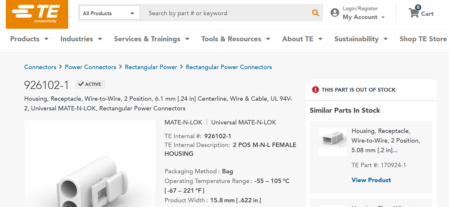

I found the plug, but no distributors currently have stock. It may be out of production now. If there is enough interest, I may be able to have a mold made by the same outfit that shipped me 3000 firewall battery cable grommets made of silicone according to my own CAD model. My grommets should arrive in the next month (sea freight). The company I'm working with for molded parts is proving to be very capable and fair in pricing.
I downloaded the CAD model for this part and am going to open it in Solidworks in a bit to have a look and maybe send off for a quote.

JamesM wrote: Mon Nov 11, 2024 4:53 am Look at the porsche pet diagram, they have all the plugs and pins there. If not for some reason it looks like a standard molex plug so go on digikey or whatever your equivalent is and find it.
It is TE (Tyco): https://www.te.com/en/product-926102-1.html

The link you sent Te has it still listed as an active product, my guess is that is it infrequently used so they run small infrequent batches of the product. you could call or check with digikey or other distributors on the lead times. Also according to their site, online components has over 18,000 in stock unfortunately with a minimum order quantity of 500

They will want a giant order if none are already in the works. I've been down that road before.

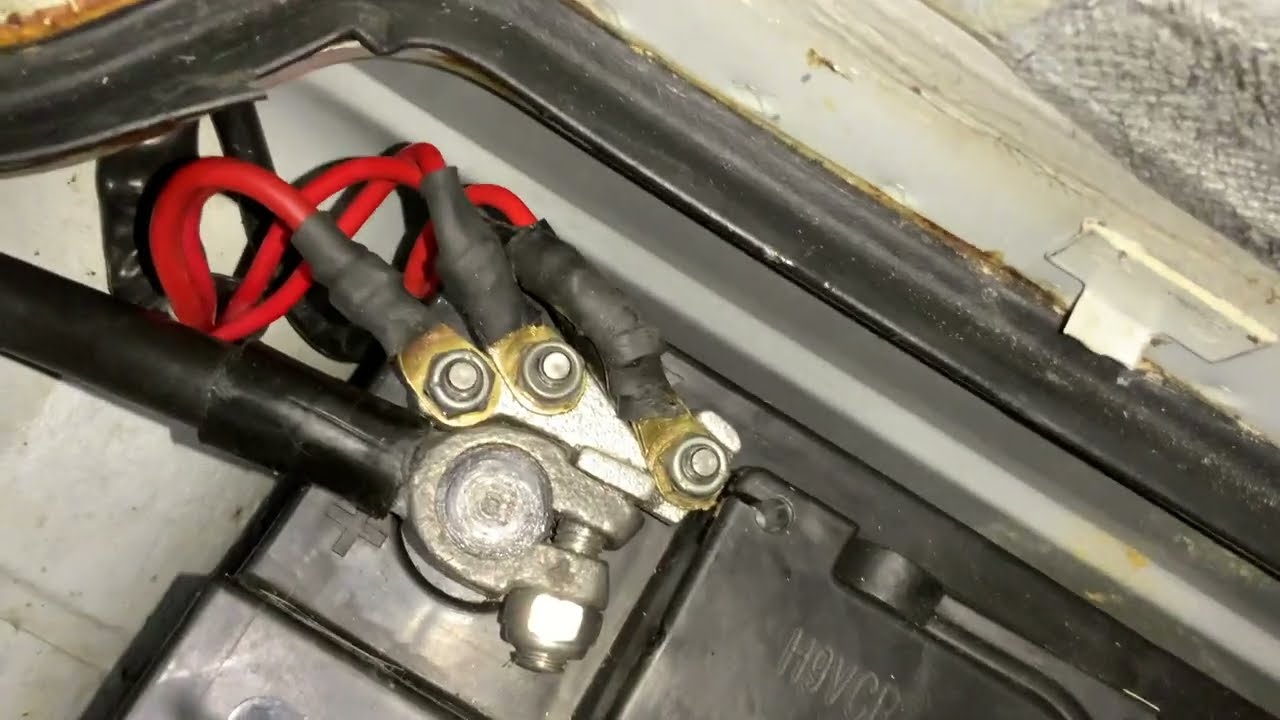

While were on the subject of battery cables, I was going to use solder terminals but couldn't find any like the stock positive with the extra tie ins for the accessories and then I found this 928-611-085-00 which would allow me to still use a solder terminal rather then the military style.Image

JamesM wrote: Mon Nov 11, 2024 5:56 am The link you sent Te has it still listed as an active product, my guess is that is it infrequently used so they run small infrequent batches of the product. you could call or check with digikey or other distributors on the lead times. Also according to their site, online components has over 18,000 in stock unfortunately with a minimum order quantity of 500
TE aggregates all distributors and reports stock.

Oops, I was on a different page, clicked on the female connector. I see what your saying now. still says active at the top of the page but it could be out of date

JamesM wrote: Mon Nov 11, 2024 6:10 am While were on the subject of battery cables, I was going to use solder terminals but couldn't find any like the stock positive with the extra tie ins for the accessories and then I found this 928-611-085-00 which would allow me to still use a solder terminal rather then the military style.Image
I'll stick with military terminals and my bus bars. One of many advantages of military terminals is that the firewall grommet can be replaced without disconnecting the cables at the block and starter. That is impossible with the stock terminal or that add-on. Another difference - try finding a terminal boot for that mess.
