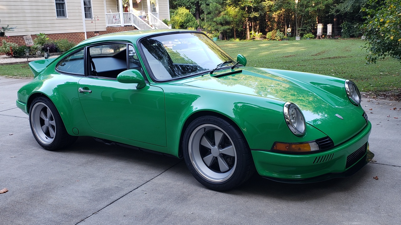

Thanks! That explains it. Lighting when the picture is taken plays a role too, so it helps to know that it's still Viper Green. It's looking good!
