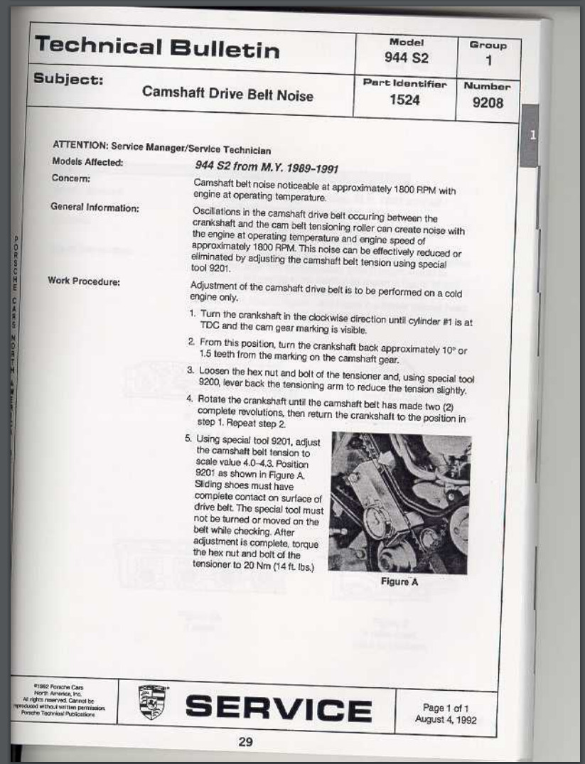

For those with 944 S2 TSB #9208 was issued in 1992 to address "Camshaft Drive Belt Noise," which can be an issue in the 1800 rpm range. It recommends tensioning the belt using the 9201 tool to a scale value of 4.0-4.3.

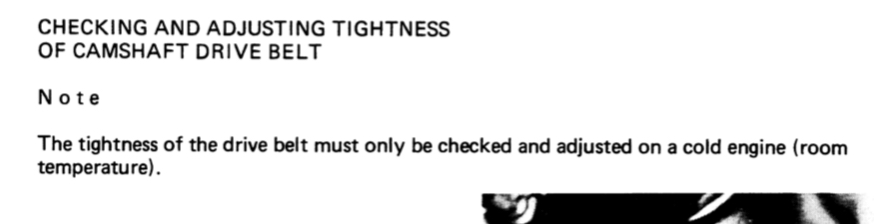

AFAIK none of the fancy tools figure in the engine expansion, when it heats up. The cam belt gets tighter, and knocks out the waterpump bearing prematurely. That's why I back off the cam belt tensioner, until I can just turn the waterpump pulley by hand. It's never going to jump when cold, and as soon as the engine heats up, the belt gets tighter. Changing the waterpump every 2nd belt change is nonsense really.
I would assume, at least with the 9201, that this is taken into account based on the FSM stating that tensioning should only be done on a cold engine.

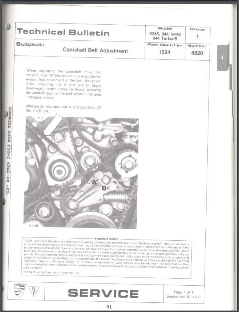

I grew up working on airplanes before I ever knew what a Porsche was, so I have that mentality. If something is not correct to spec I will correct it. Today I messed with my Arnnworx tool and found that my timing belt was out of whack by about 15% on the loose side, even after following the Porsche method to re-tension a timing belt after those break in miles. I attached a picture of TSB 8820 which detailed that process. Maybe back in the 80's these worked fine as automatic tensioners, but I am not going to trust one. Laziness is not worth the price of a new cylinder head, especially on a 16 valve engine.
TSB 8820.png (499.05 KiB) Viewed 2022 times
Latitude48 wrote: Mon Jun 20, 2022 11:27 am For those with 944 S2 TSB #9208 was issued in 1992 to address "Camshaft Drive Belt Noise," which can be an issue in the 1800 rpm range. It recommends tensioning the belt using the 9201 tool to a scale value of 4.0-4.3.
On another note, I'm curious what tensioning mileage intervals most people follow after the installation of new belts, and for the interval between changes. In the past I've used 2500 miles for the first recheck goal after installation of new belts, then each 15,000 miles, thereafter, give or take.
I have been trying to fight a whining noise on my S2, I wonder if this might be what happened. I run a 4yr/45k mile interval on the TB & BSB, water pump replaced every other belt/10yrs. Attached a copy of TSB 9208 for future reference.
