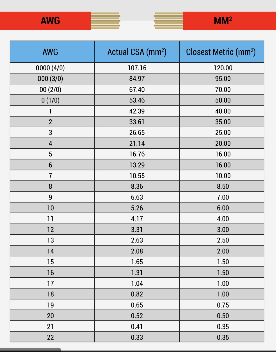

Factory wires are metric and these are AWG, so you'd need to pick the closest. Most of the 944 engine harness wires are 1mm^2, so right between 16 and 18 gauge. The factory wire insulation is also pretty thin compared to the GXL I use on my stuff. An 18 gauge GXL wire, for example, is thicker overall than the 1mm harness wires, even though the actual copper inside is a little smaller. It would get extra bulky if you did the whole harness that way. TXL wire has thinner insulation, though I don't have any handy to compare to the factory wire....

I used 22AWG for branches to sensors and 18AWG for injector/coil power wires. I just matched what Link used for sensors, and did the math to calculate peak current potential to size power wires accordingly with a little safety margin.
I used TXL wire from both 4rcustoms and Prowire. I didn't really see a need to run the Tefzel, but it is good wire if you want to spend the extra money (All things considered, it isn't that much more expensive). I also sheathed my entire harness in Raychem DR-25.
FWIW, I didn't notice a huge difference in sheathing wall thickness between the existing harness wires from Link and the TXL I bought, but I don't have any OE wire handy to compare either. If you're curious, I can dig something out and mic it.

I had trouble finding all the right combinations I needed from the 4Customs site, so I ended up ordering most of my wire from Sherco Auto. I didn't use TXL or GXL; I used their marine grade wire. From everything that I read prior to starting to make my engine harness, the metric equivalent comes out right about 17 AWG; good luck finding that! I also went with mostly 18g, but up to 16 and some 14 for the thick ground bundles.

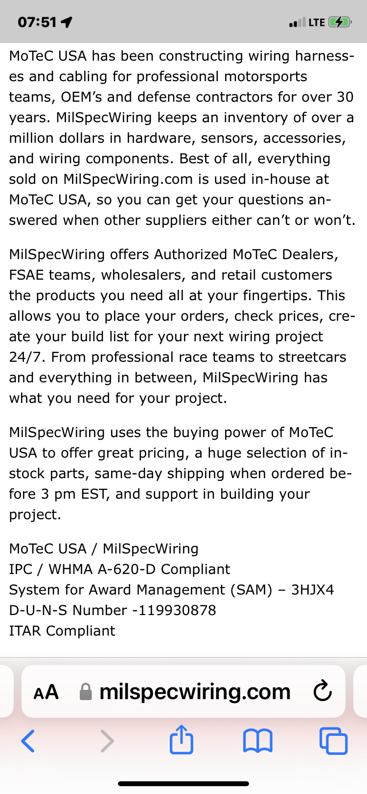

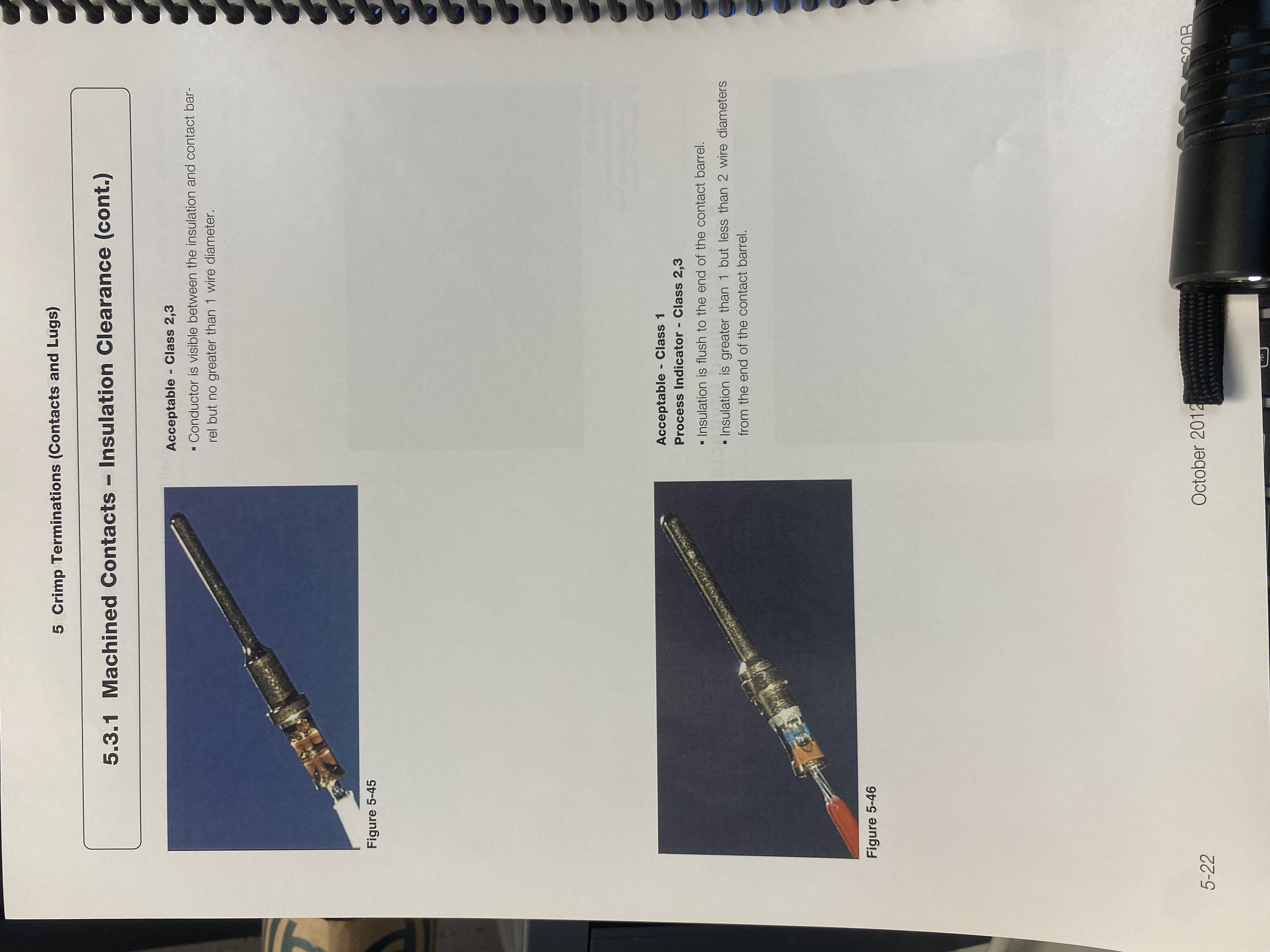

Just food for thought when choosing a vendor.
Look what certifications they have to avoid counterfeit stuff or garbage made in China.
I forgot about some of the info posted on this Junior Timer thread when I posted my Bosch boot harness thread.
ISO standards
Big indicator for me is ITAR
A vendor that has ITAR certification is not going to risk loosing this certification selling garbage products.

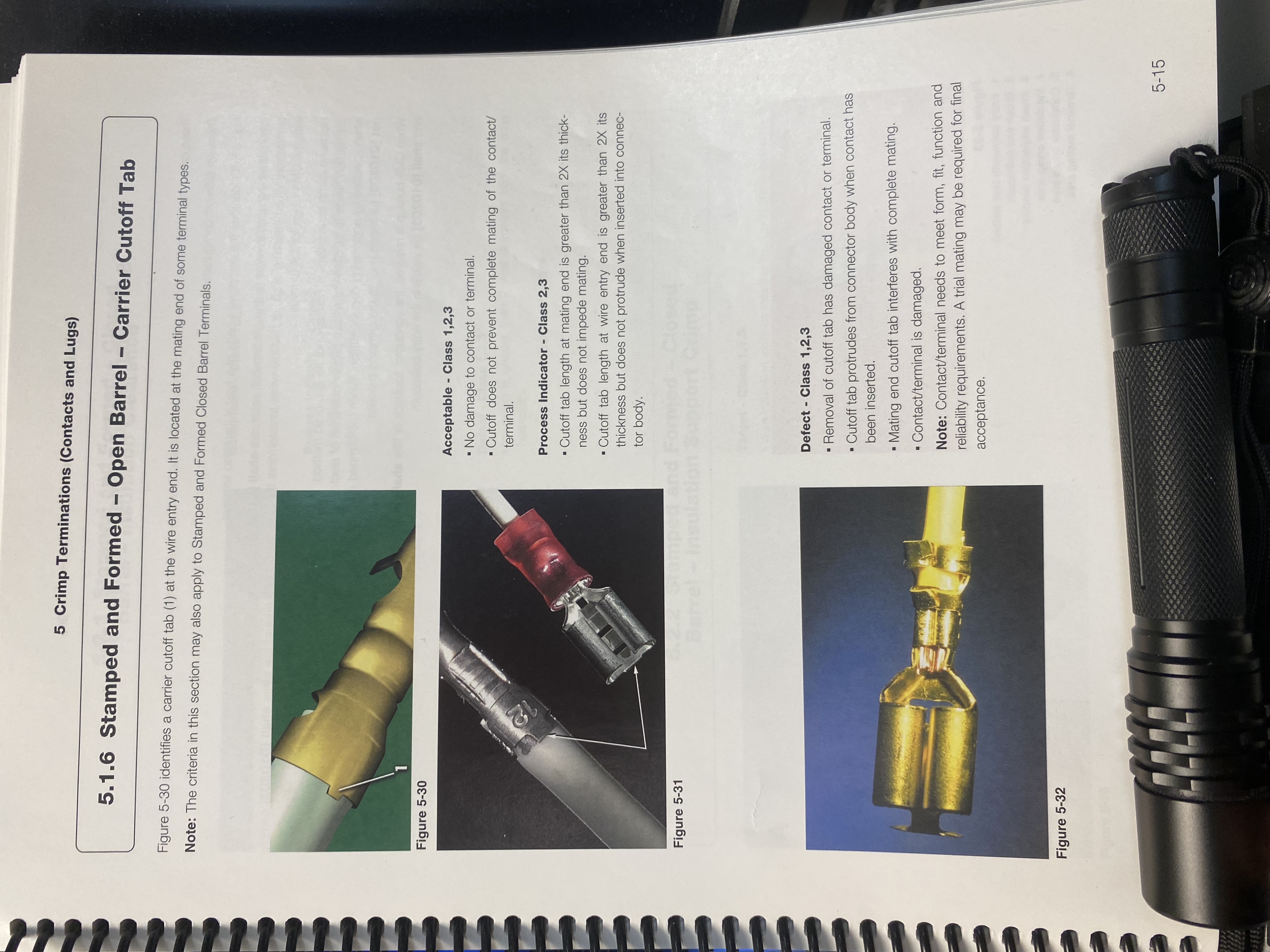

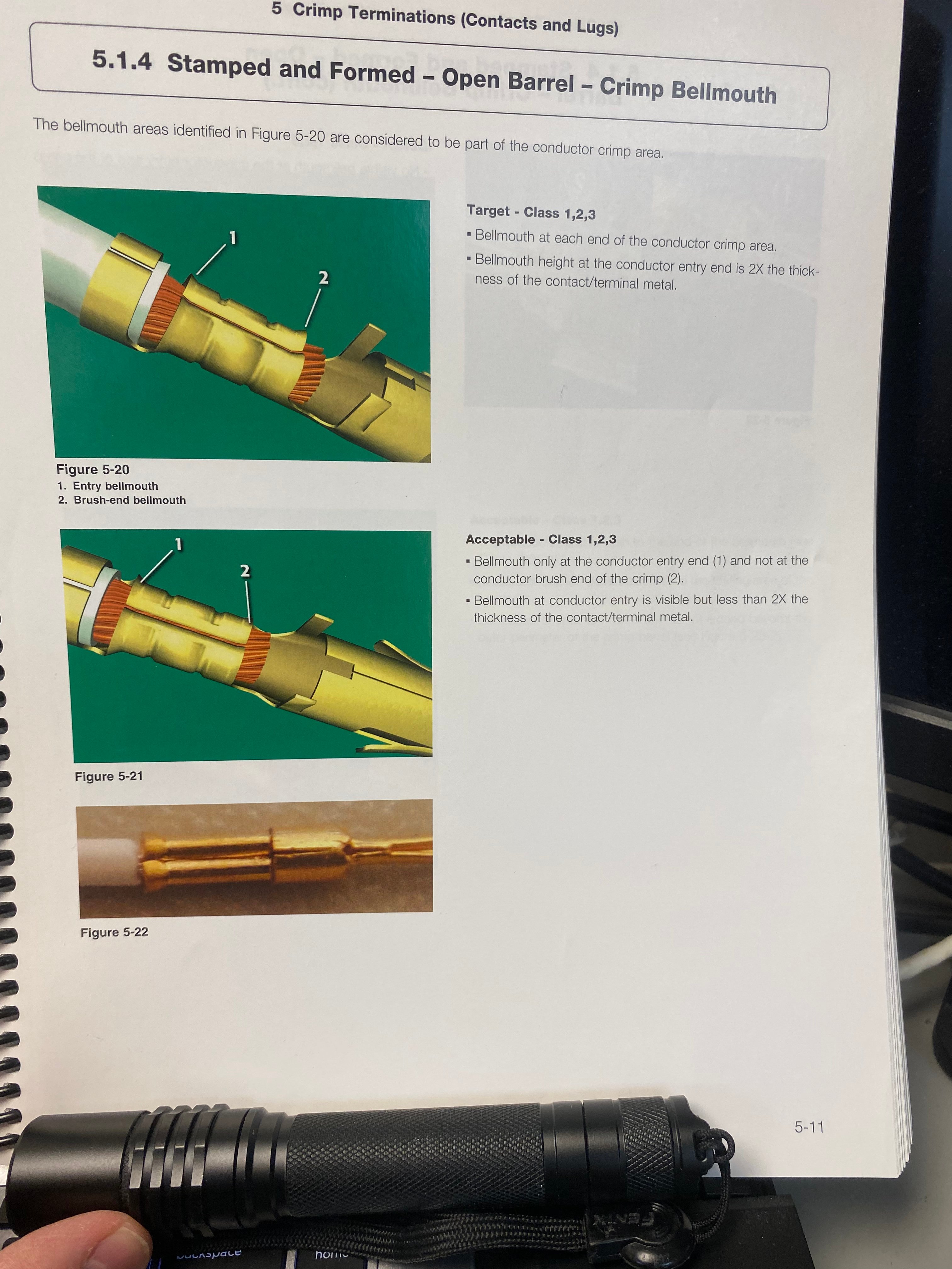

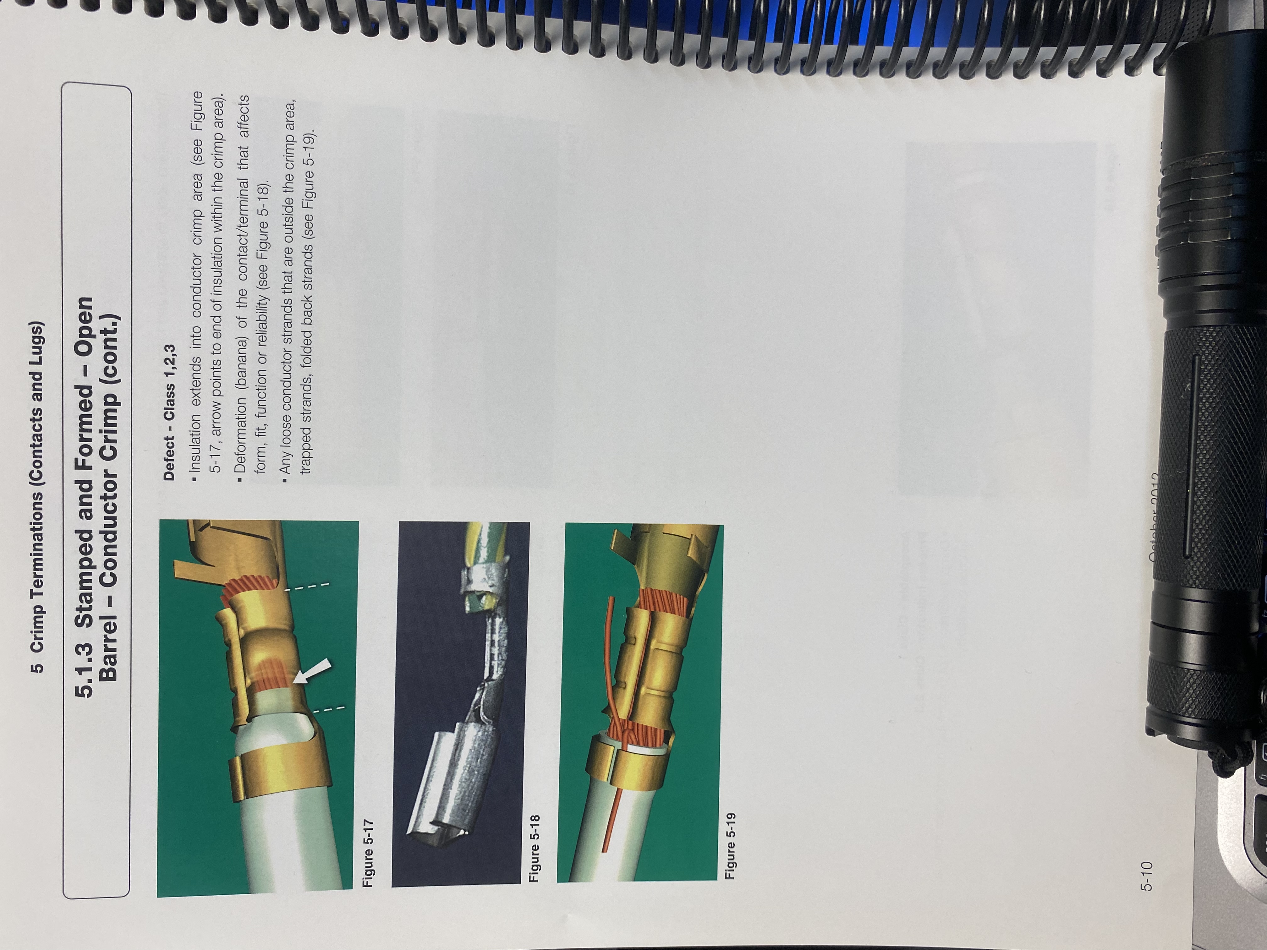

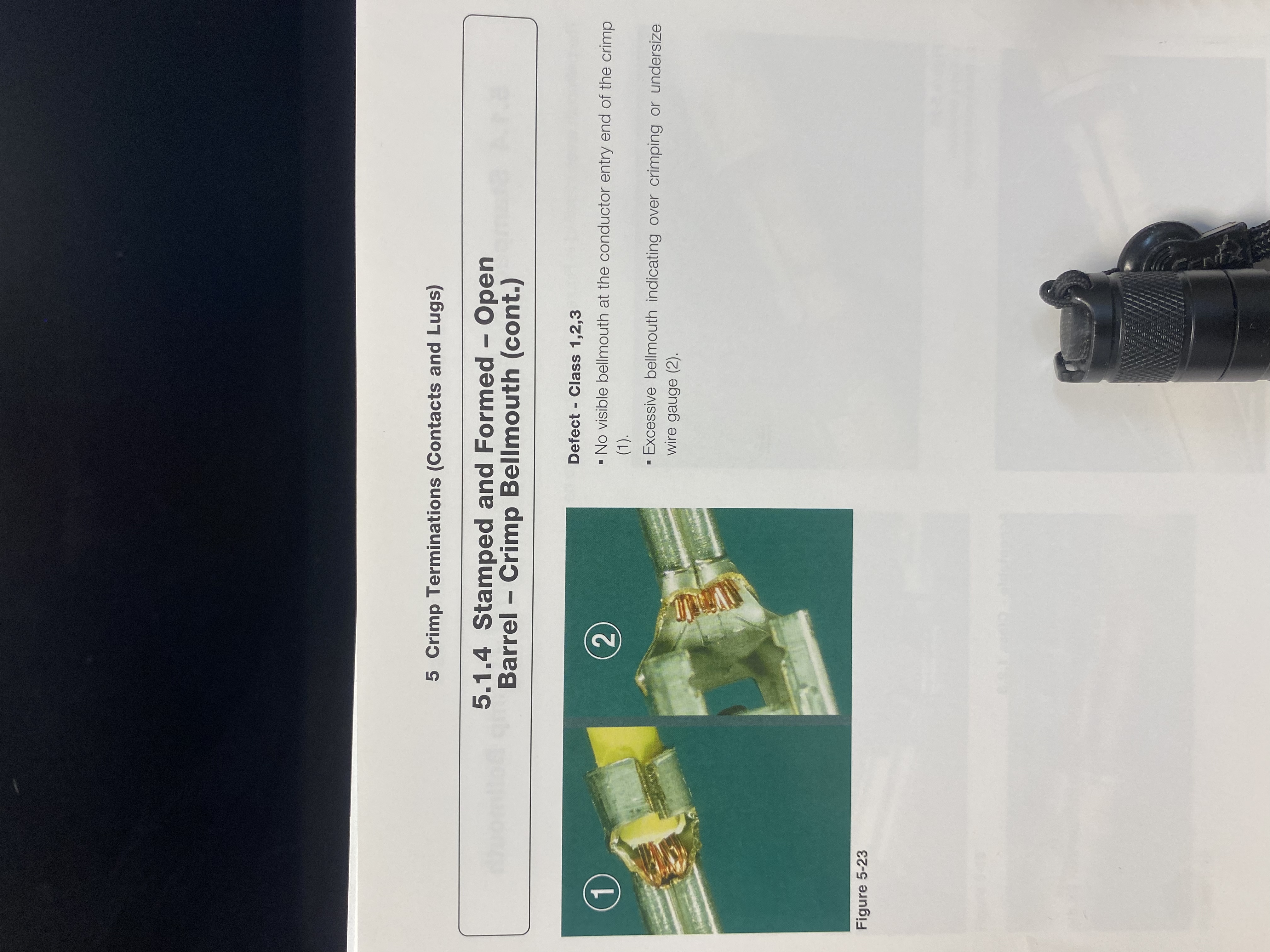

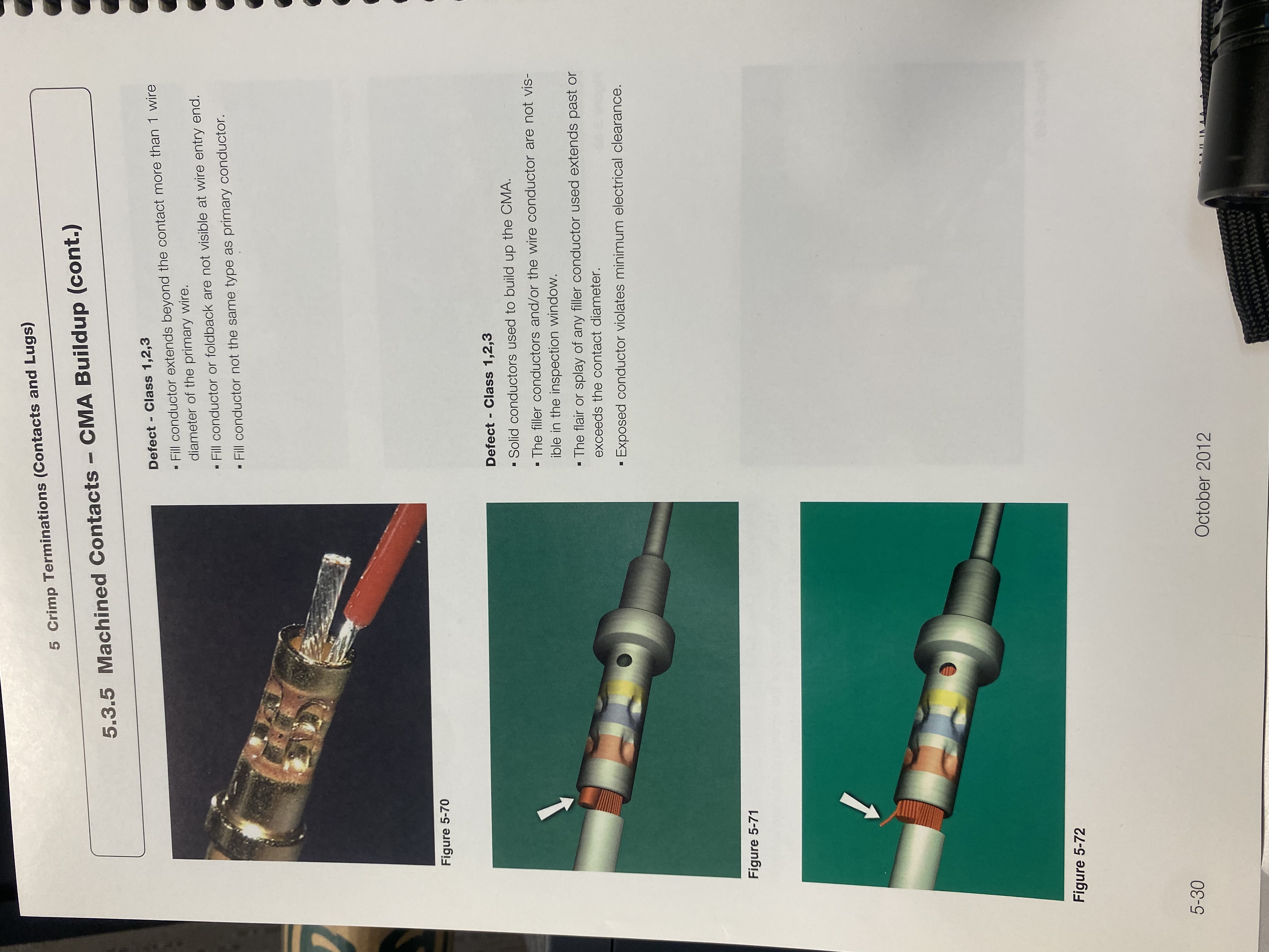

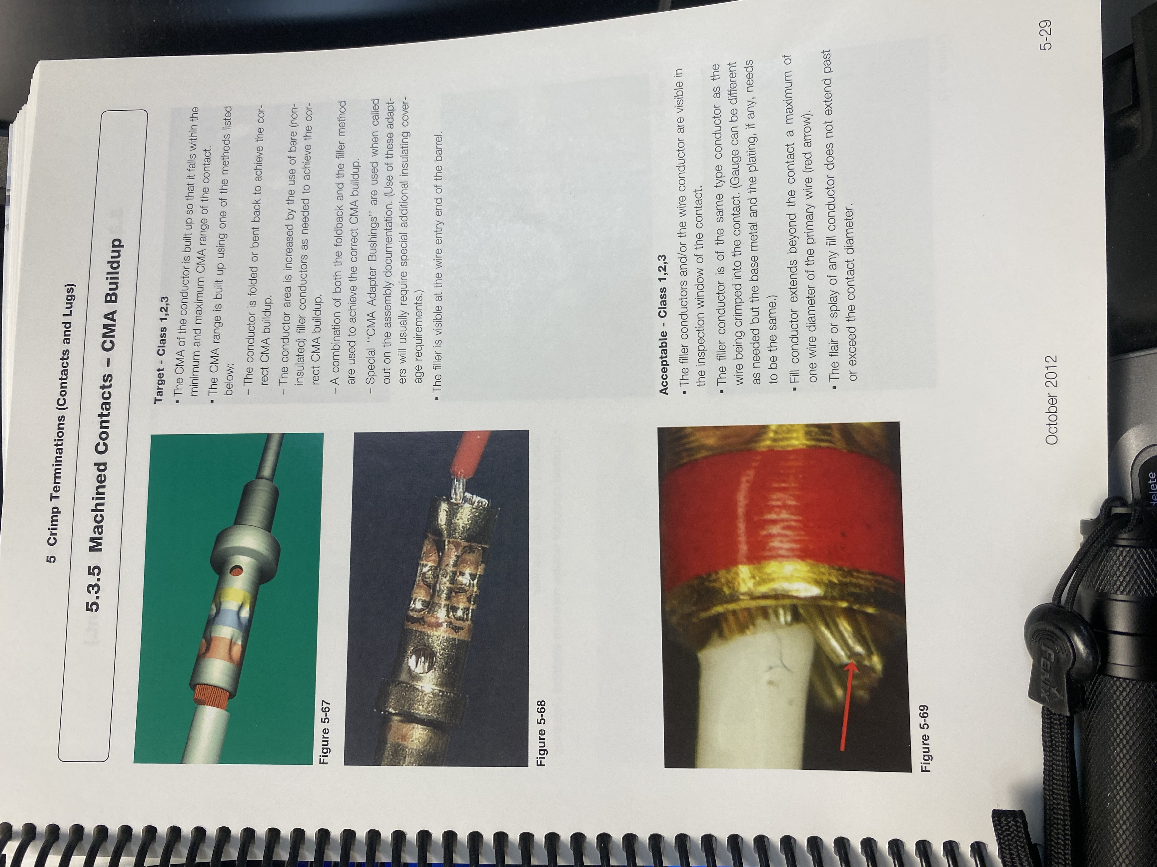

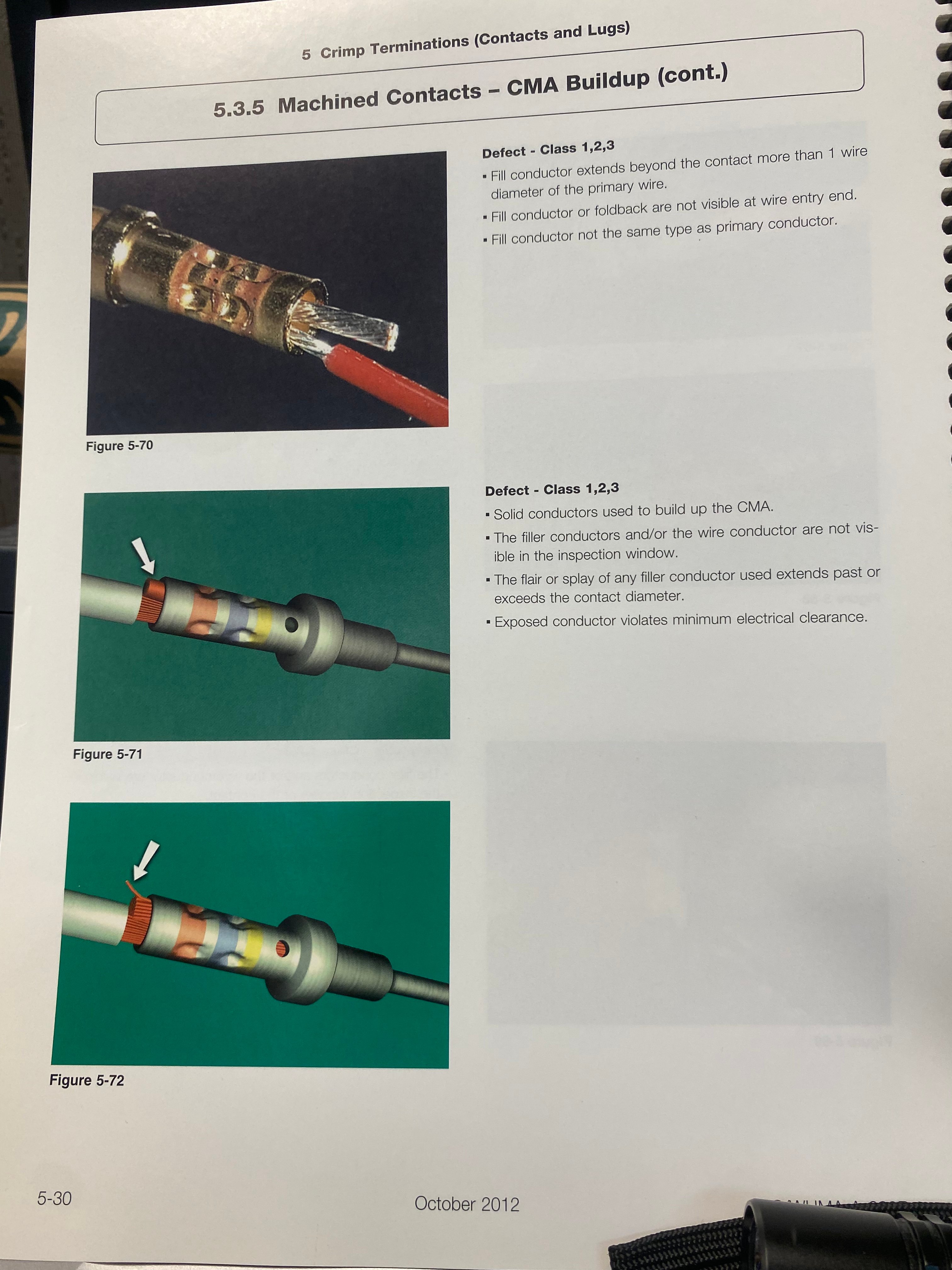

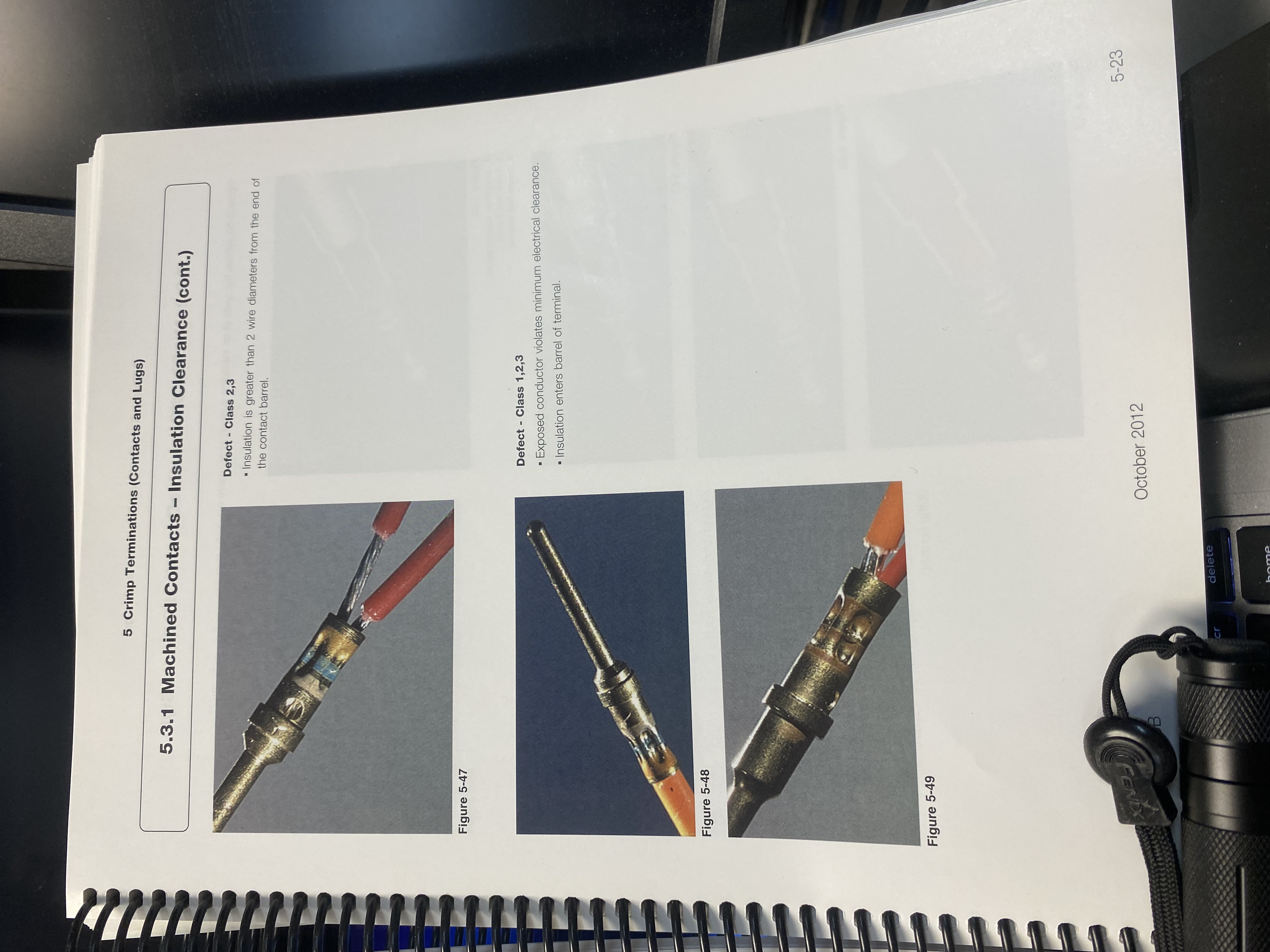

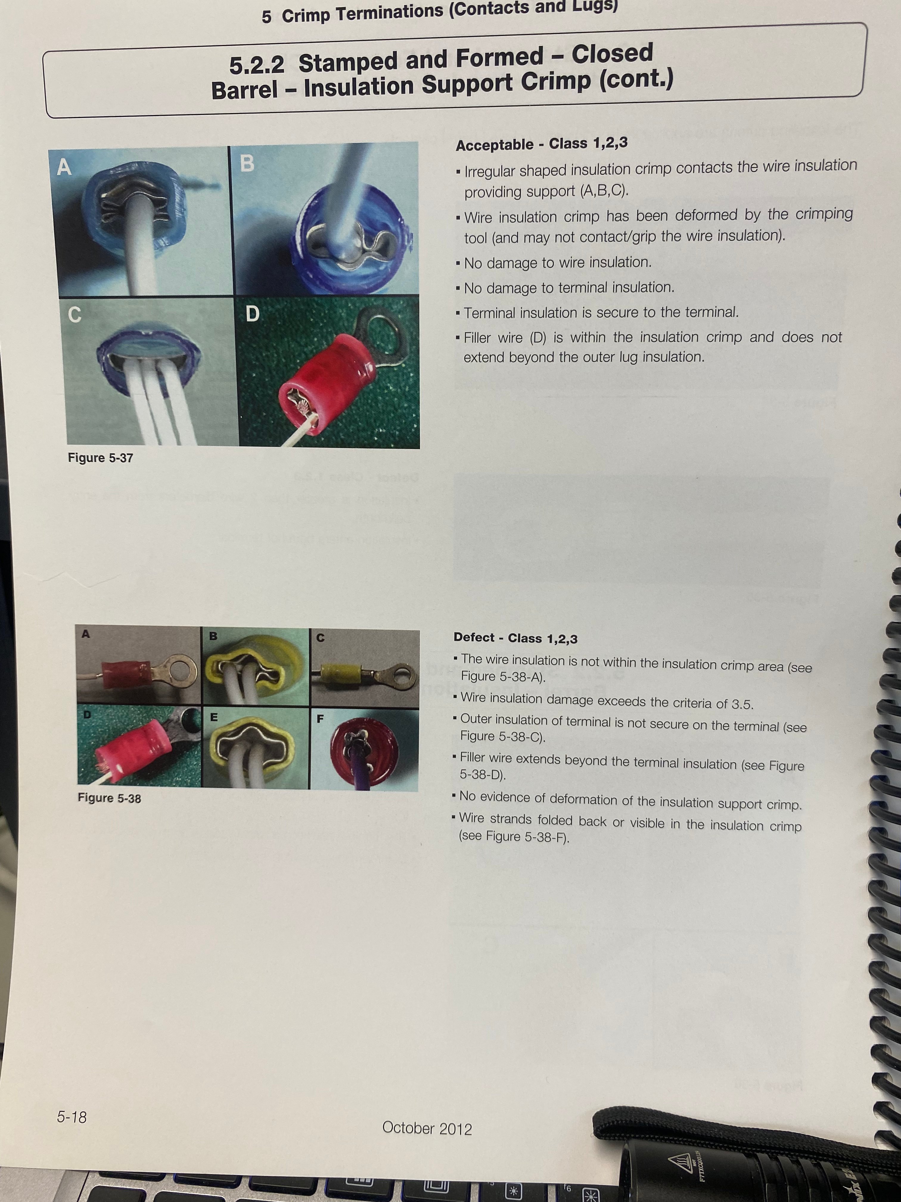

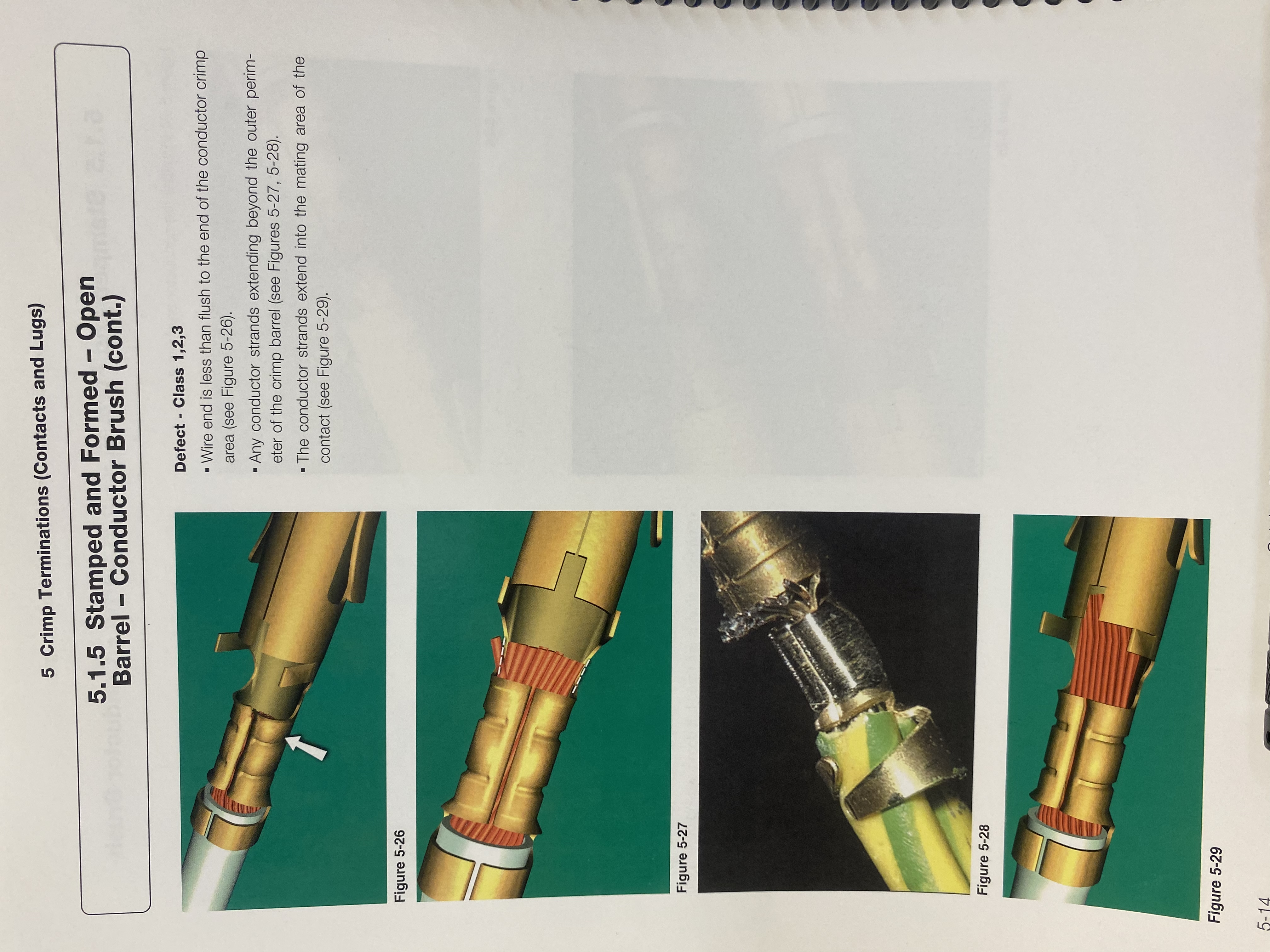

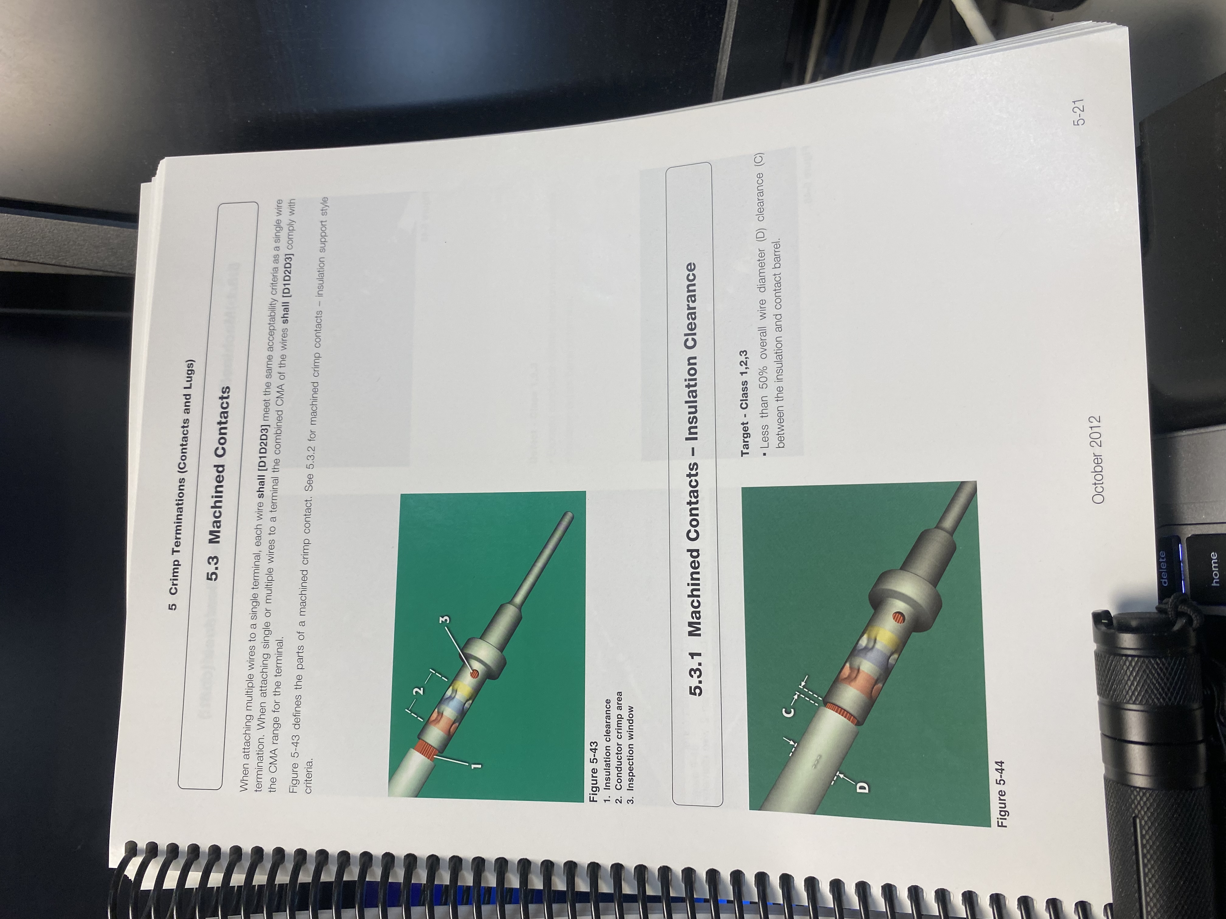

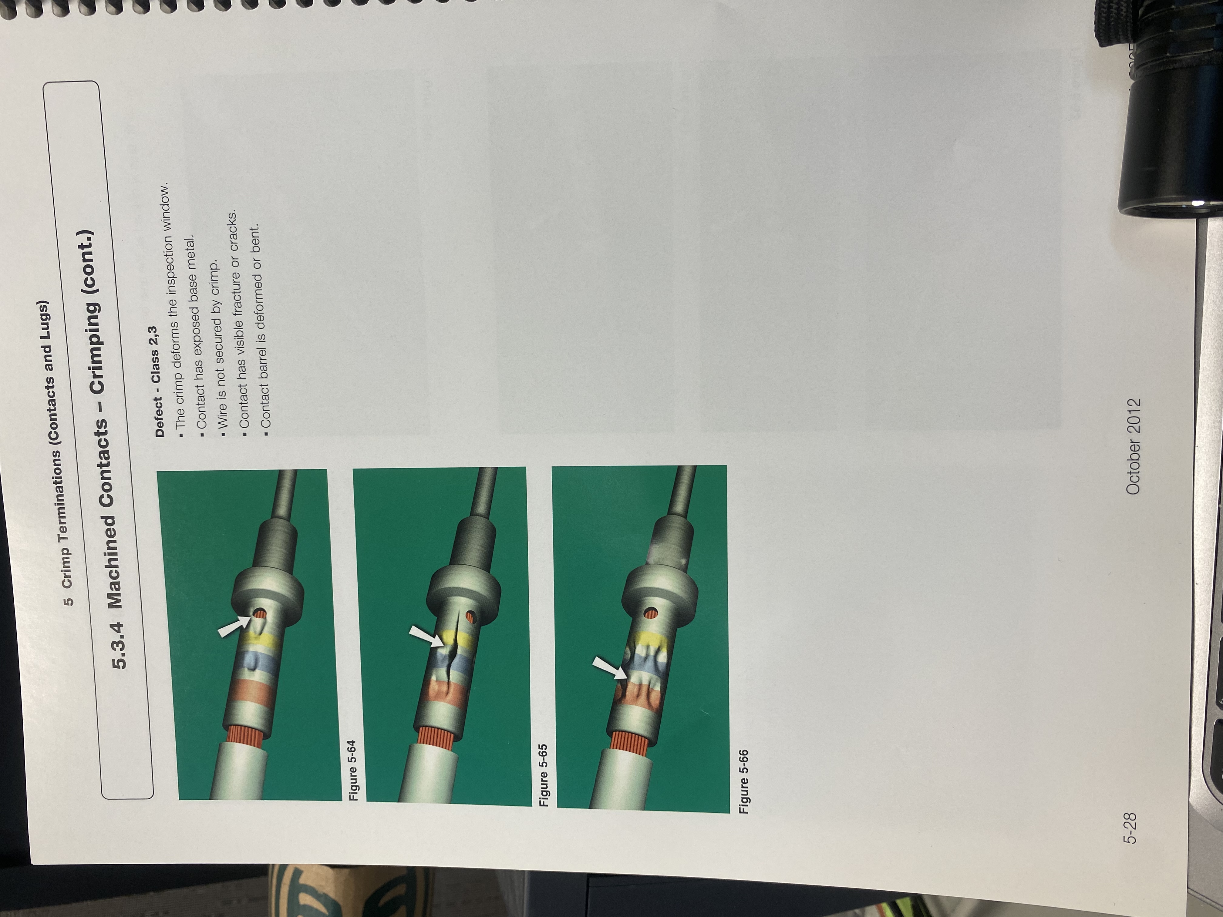

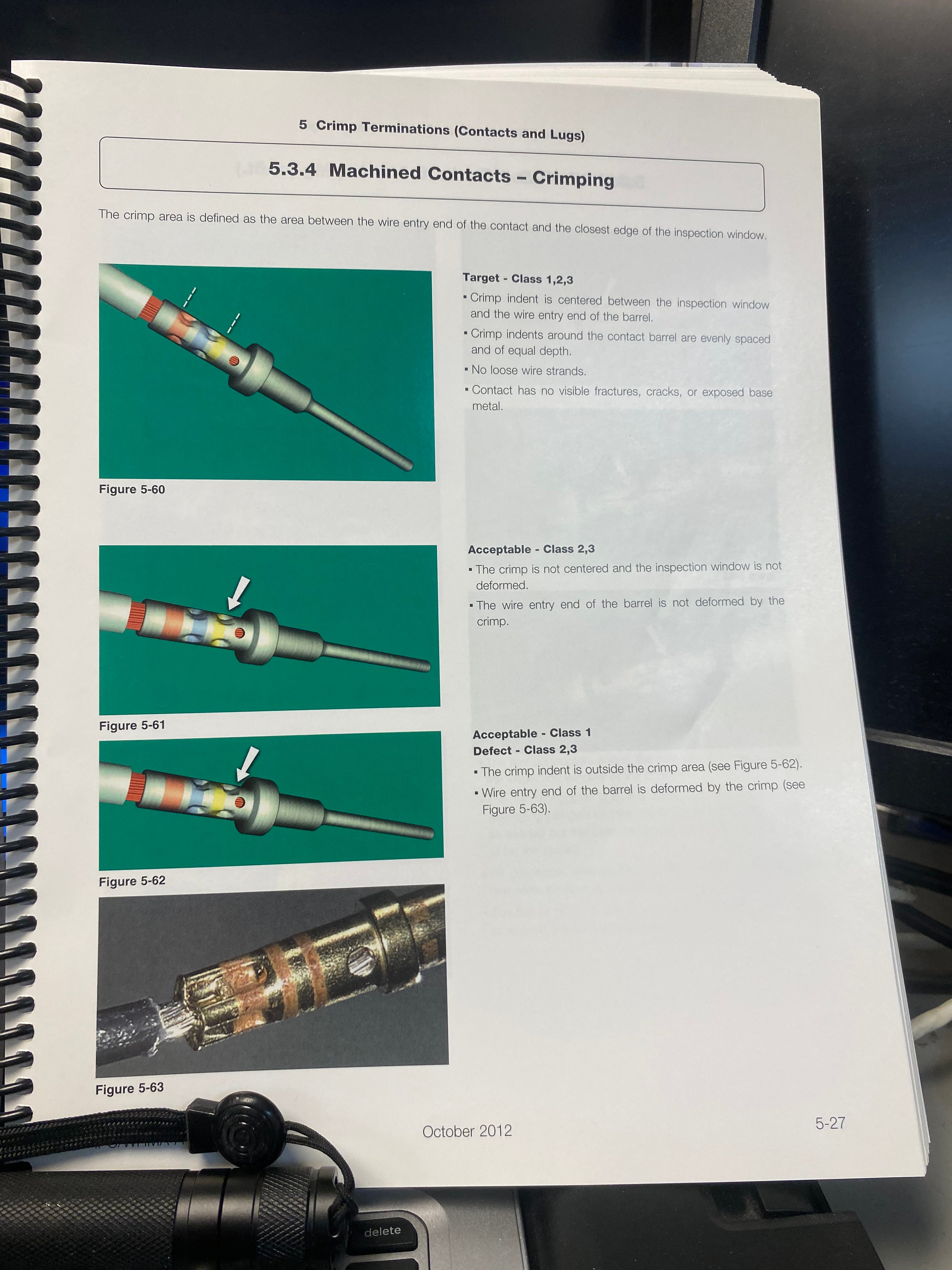

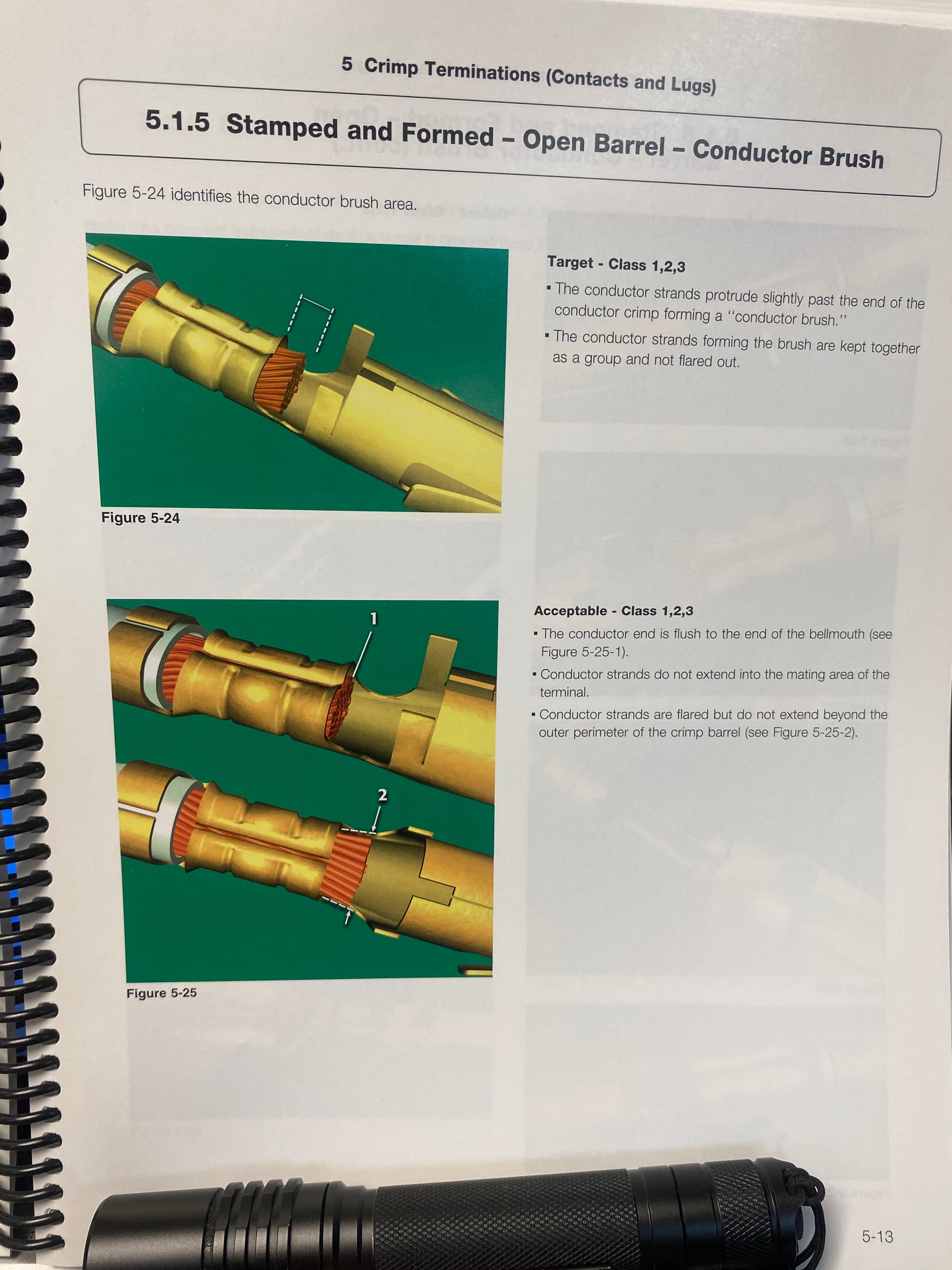

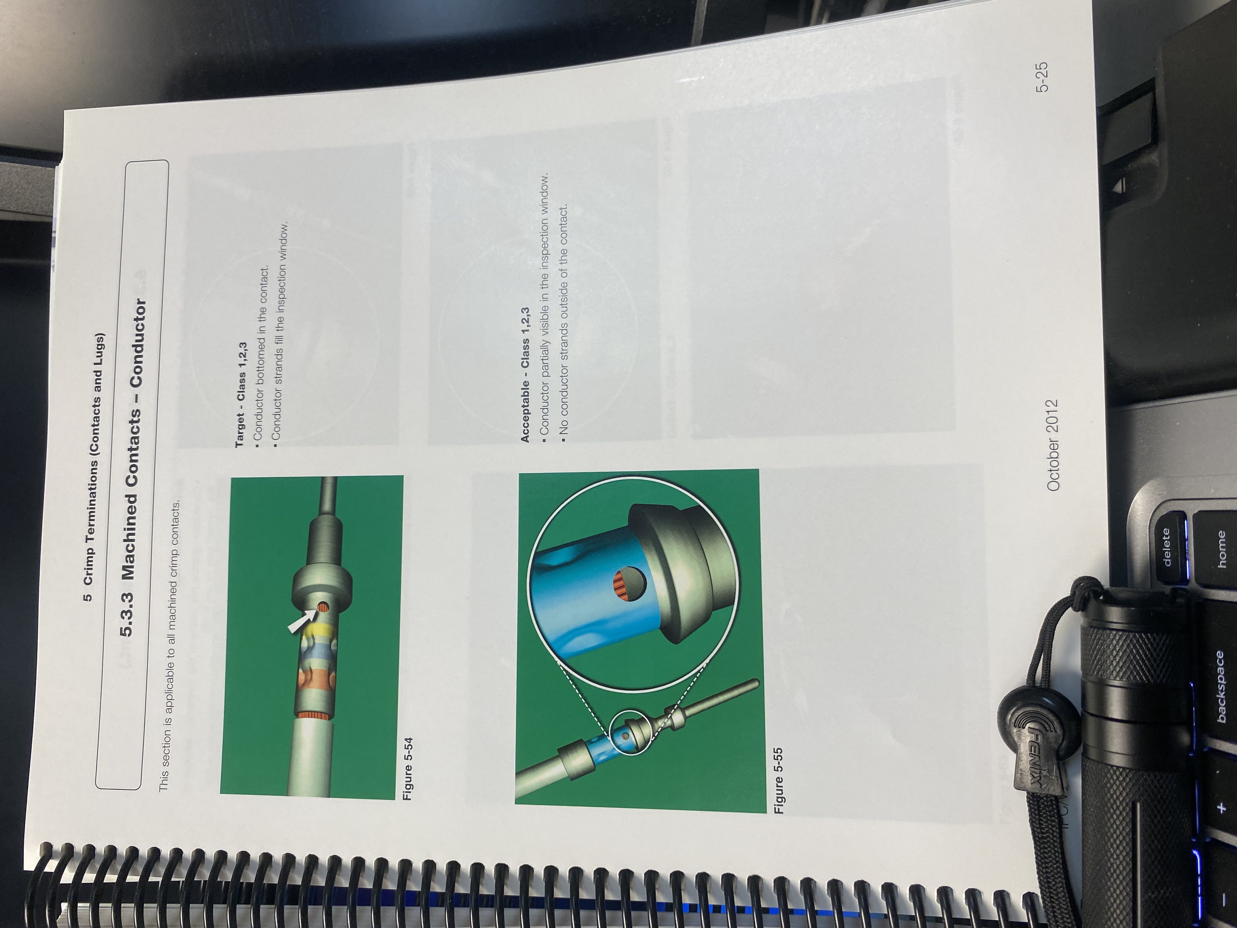

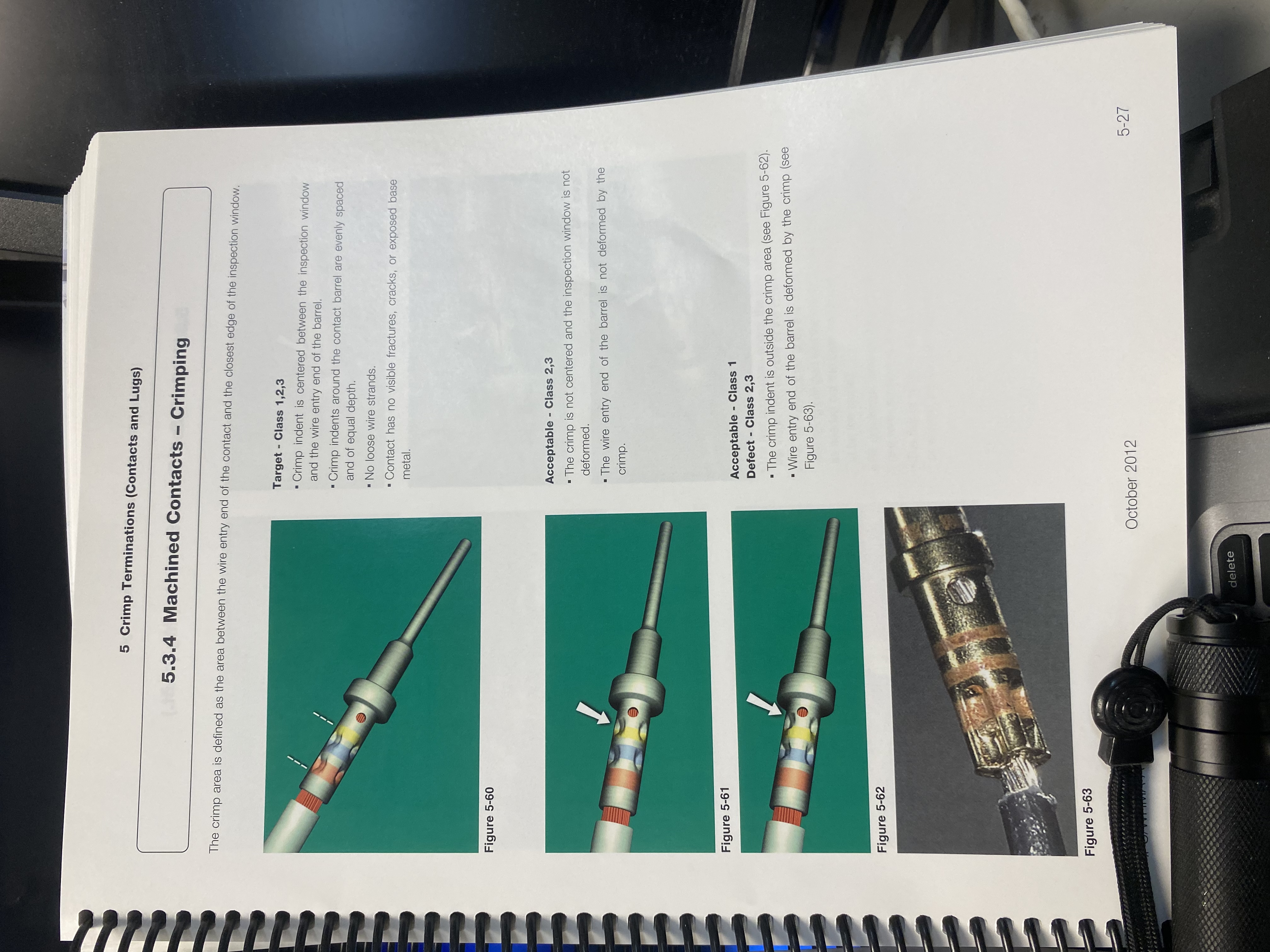

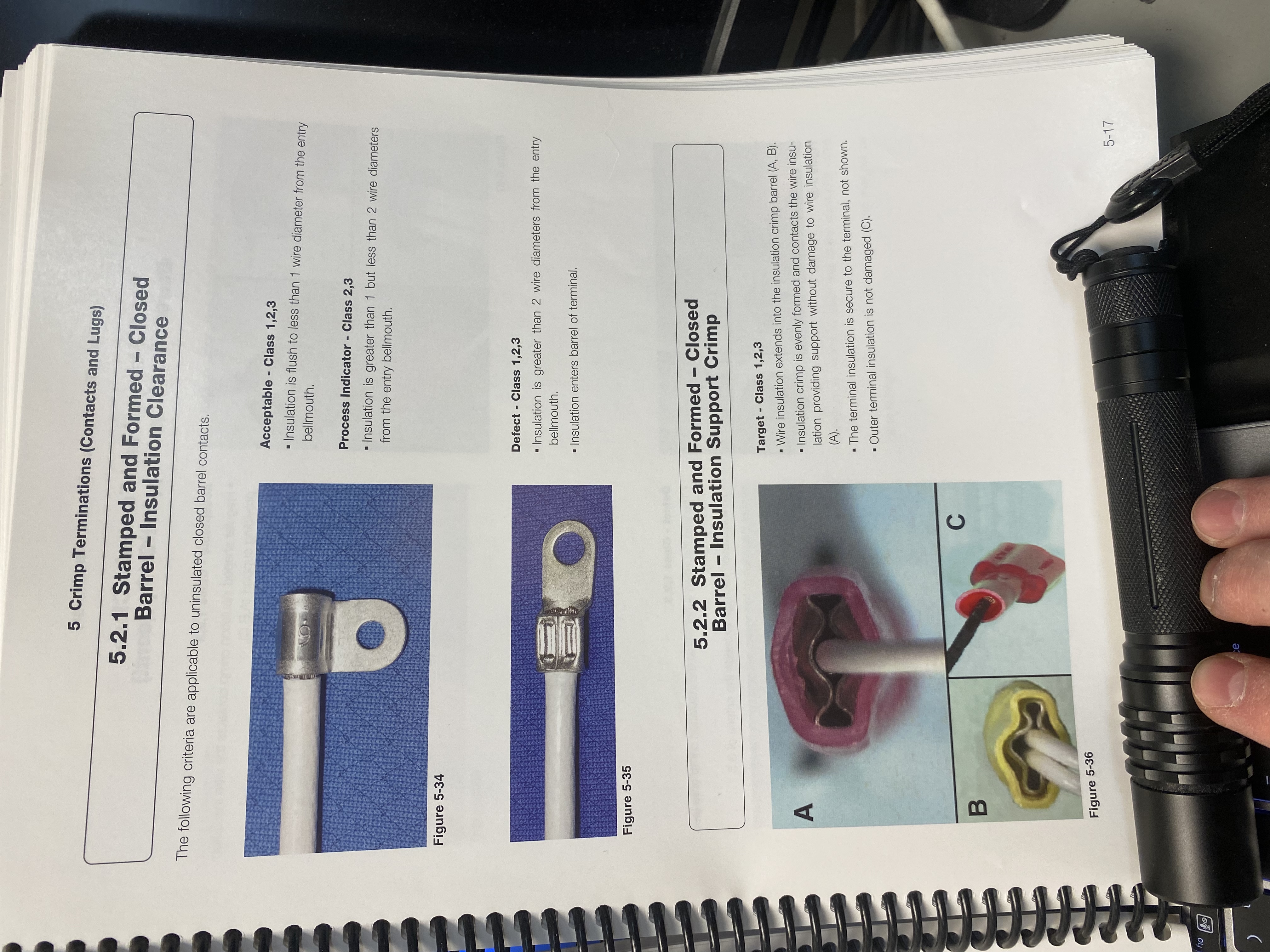

Check out the pics of my flashlight 🫢
It’s a pretty good light source working on cars.
