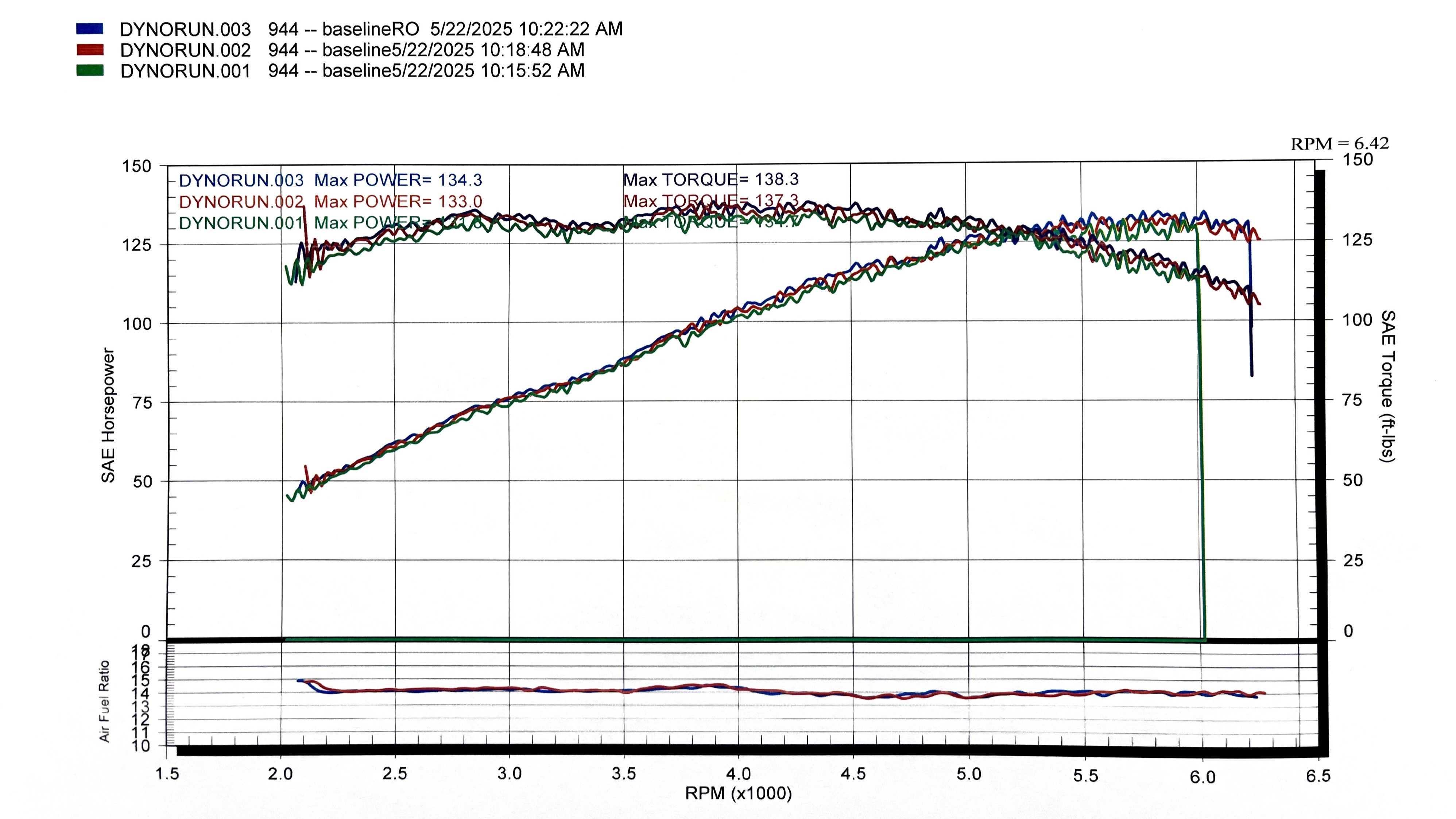

You can play around with the FQS to add or remove fuel, but the changes are minor. It’ll be difficult to really sense what’s going on without wideband O2 readings.
Here’s a dyno sheet from a 1988 NA with the factory AFM and the FQS at 0. You can see at wide open throttle, it runs close to stoichiometric air/fuel ratio (14.7:1), which is good for efficiency and fuel economy. You’ll typically get more power from a 12.5:1 or 13:1 ratio. We bumped the FQS up to +6% fuel and it added about 1.5HP, so technically more performance on paper, but not the kind of numbers you’ll feel behind the wheel.
The factory airbox is already setup as a cool air intake with ample volume available within the housing. The bottleneck is the AFM, so adding a cone-style filter won’t offer a noticeable improvement.
