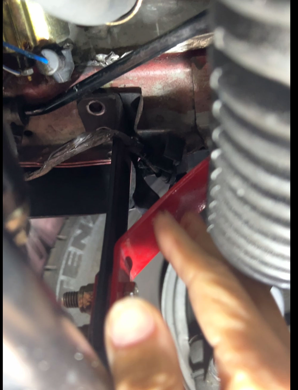

Tom wrote: Mon Dec 29, 2025 7:24 am This is why it takes me so long to fix anything... As I worked to get to the oil filter console, I was horrified to see rust on this little bracket that holds the brake sensor wire clip up where the sway bar bracket mounts. So ended up blasting and powder coating both sides. So satisfying :wtf:
I'm missing this bracket or don't remember ever seeing it. Where exactly does it mount? Is there one on both sides of the car?
Thanks!
'87 951
#32
Posts: 9095
Been thanked: 4080 times
951tom wrote: Wed Dec 31, 2025 8:38 am
Thanks!
'87 951
Can't say I remember it being there either. It's sandwiched between the frame and the main front sway bar mounting bracket -- one on each side. It's sole purpose seems to be to hold the clip for the brake wear sensor harness.

I am not sure all cars had these brackets. I don't think I have seen a later car (89+) with them.
'90 944 turbo
#34
Posts: 9095
Thom wrote: Thu Jan 01, 2026 4:13 am I am not sure all cars had these brackets. I don't think I have seen a later car (89+) with them.
It's kind of a silly bracket. Hard to believe they could not have found an existing place to install a plastic harness clip...

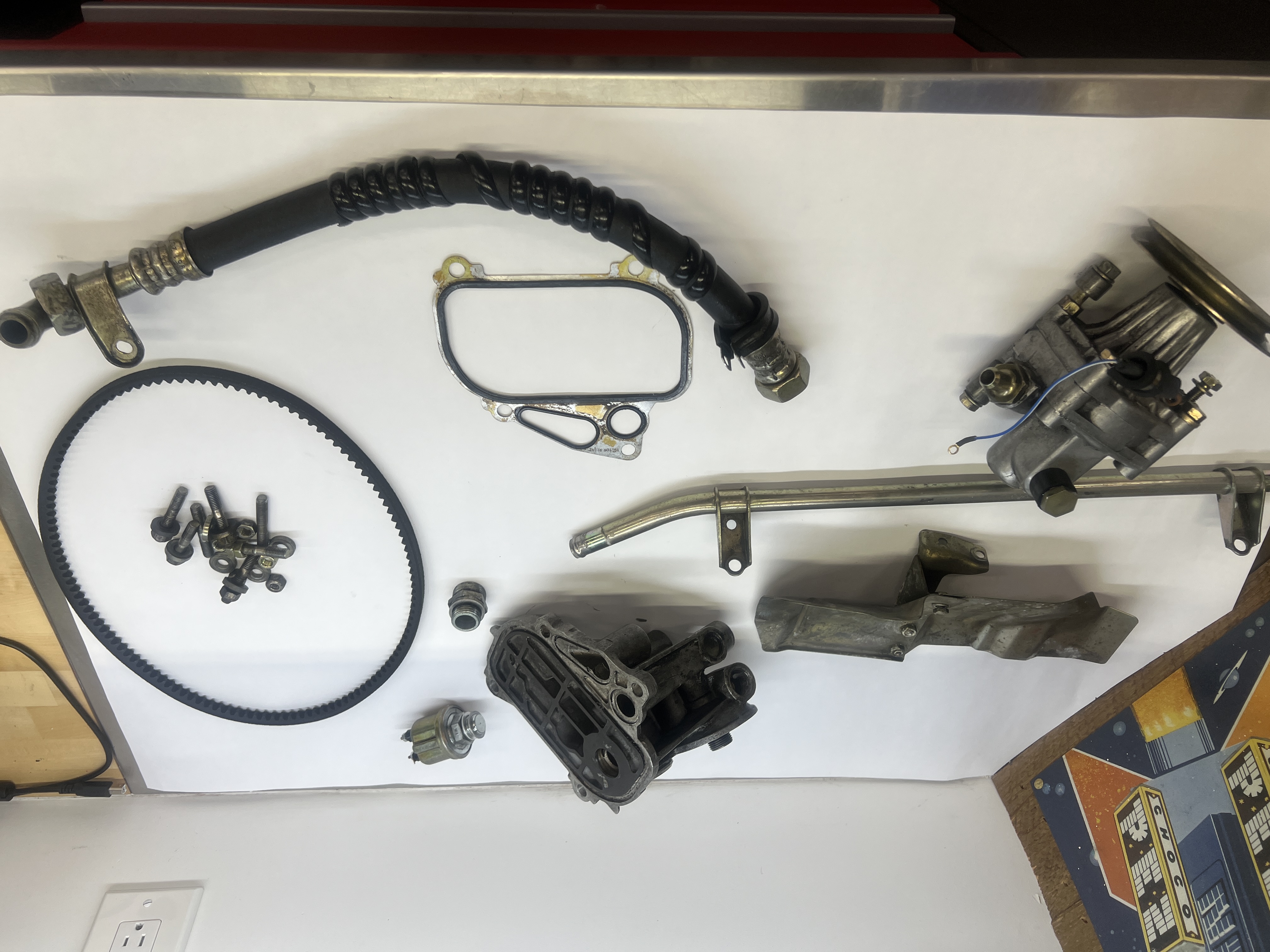

Got the oil filter console off today. What an epic pain and mess. I could not for the life of me undo the upper oil fitting on the console. In my own 20+-year-old instructions for doing this job, I apparently cut it off last time I did this. A quick check showed the hose is now about $400, so I wasn't eager to cut it this time. Instead, I opted to pull the headers off and remove the console from the top (after going through all the work to take it from the bottom :shock: ). Taking the headers off gave me room to get at the oil line fitting with huge 32 and 27mm wrenches, which finally allowed me to get the console out. No obvious signs of Dexcool damage like the pictures I've seen on the Internet, though the rubber on the gasket was clearly showing its age. This was a Victor Reins gasket, making me wonder if it's worth springing for a real PCNA replacement this time. On the other hand, if the new one lasts as long as the old one, I'll be 80 by the time it leaks, and probably not fixing it myself... These parts have been on the motor since installed in 2008, and have clearly lost their new-motor look. :wtf: More grease and grime than I expected.
leak point.jpeg (1.07 MiB) Viewed 448 times
Based on where the leak was and the look of this rubber worn away, I'd say this was the leak point...
Sway bar and headers came off too. Lots to put back together, once parts arrive anyway.
In the meantime, everything needs to be cleaned. A lot...

Tom, thanks for posting that picture. Interesting as I've never seen that one before.

Sorry, I should have been clearer. I've never seen that bracket holding the brake sensor wire clip.

Still waiting on parts, so have been busy cleaning parts in the meantime. I'll post these parts in the 3D printing section soon. The oil filter cover might be useful just to keep debris out of the engine any time the filter is off while working on the motor. The big flat block-off plate (and gasket) can likewise be bolted to the block to clean it without getting debris and cleaning solution in the engine....
