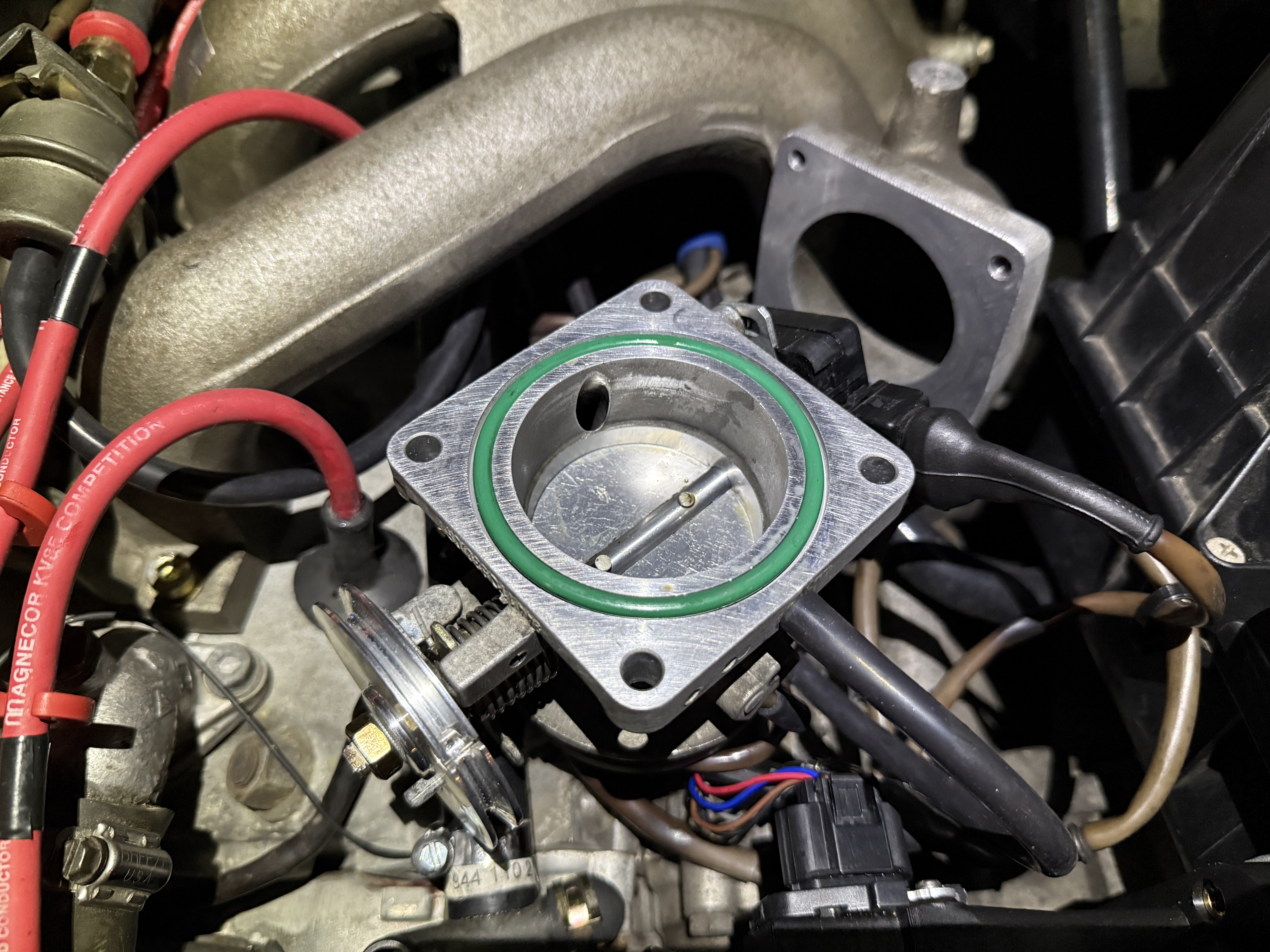

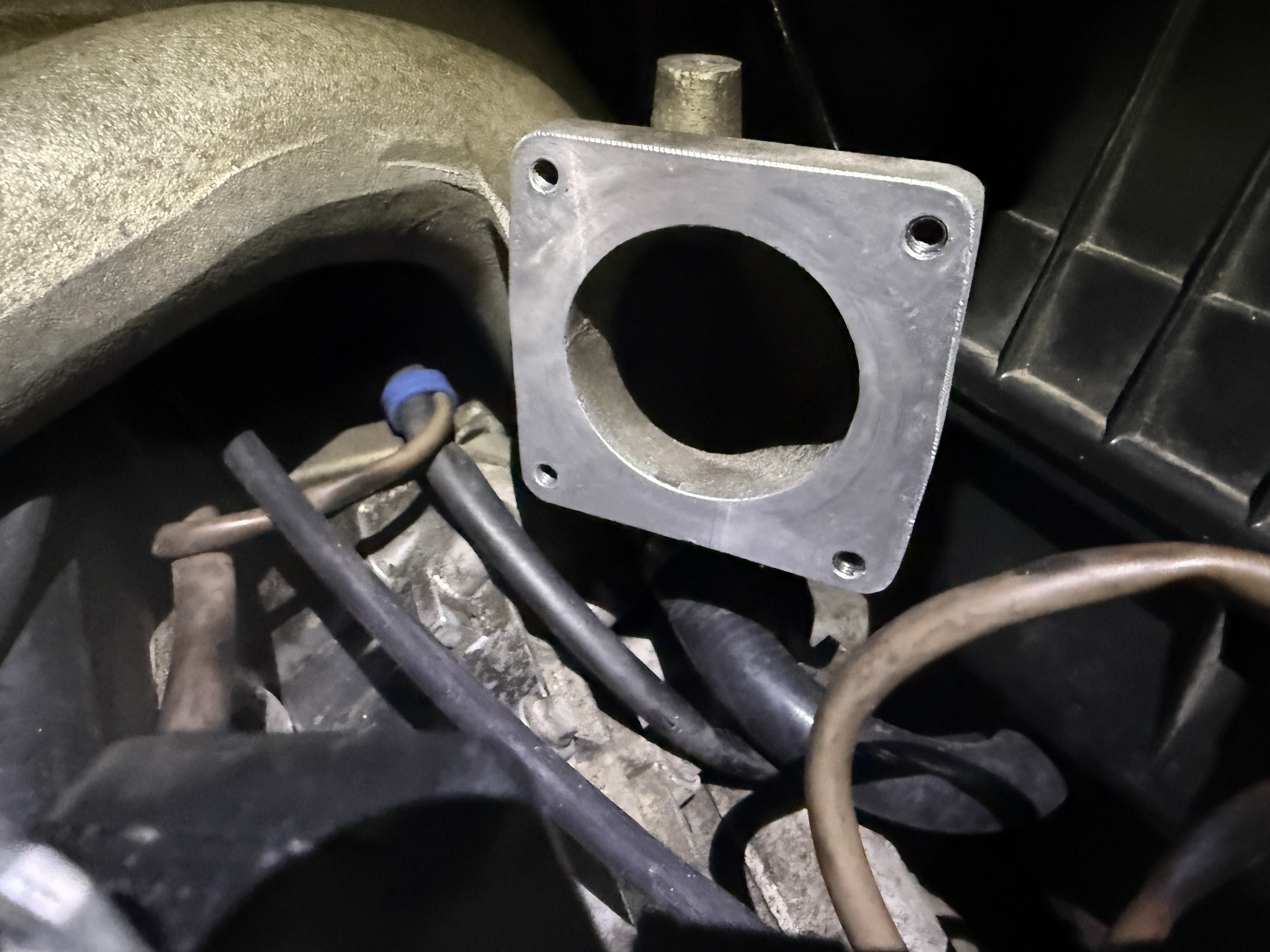

- I pulled the TB again... Seal does not look pinched, no bolts were loose. (photo)
- I swapped to another TPS that I have. No change, 1400 idle.

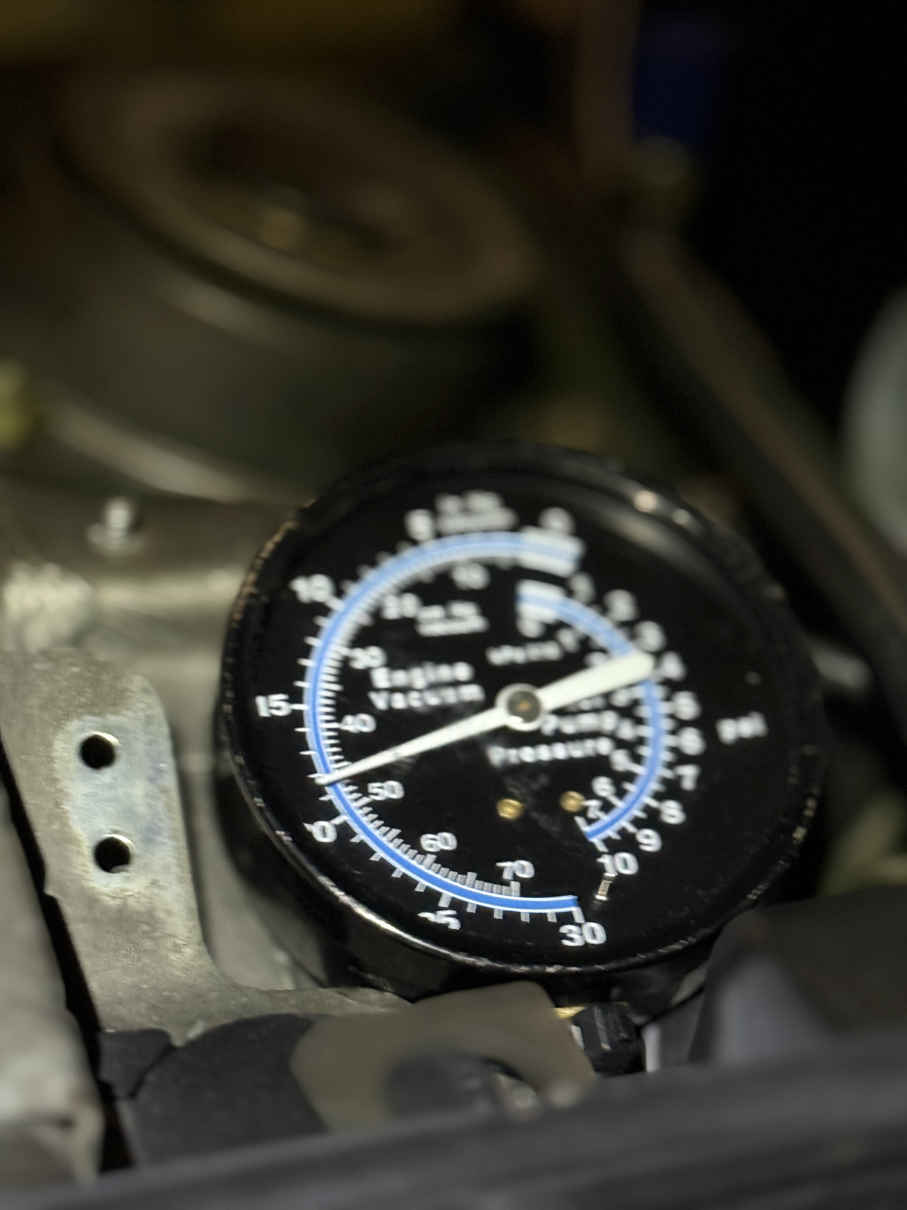

- Put a vac gauge on it... 18-19
Somehow I introduced a-lot air since changing my o-ring.
That would suggest the engine management system is trying to reduce the rpms, which would suggest a leak (or bad ISV/ISV driver/ISV wiring). As a test, can you pull a hose off the ISV circuit (wherever convenient) and block both sides with your hand or a plastic baggie or the like? Or smoke test it and see if there is an external leak somewhere...
