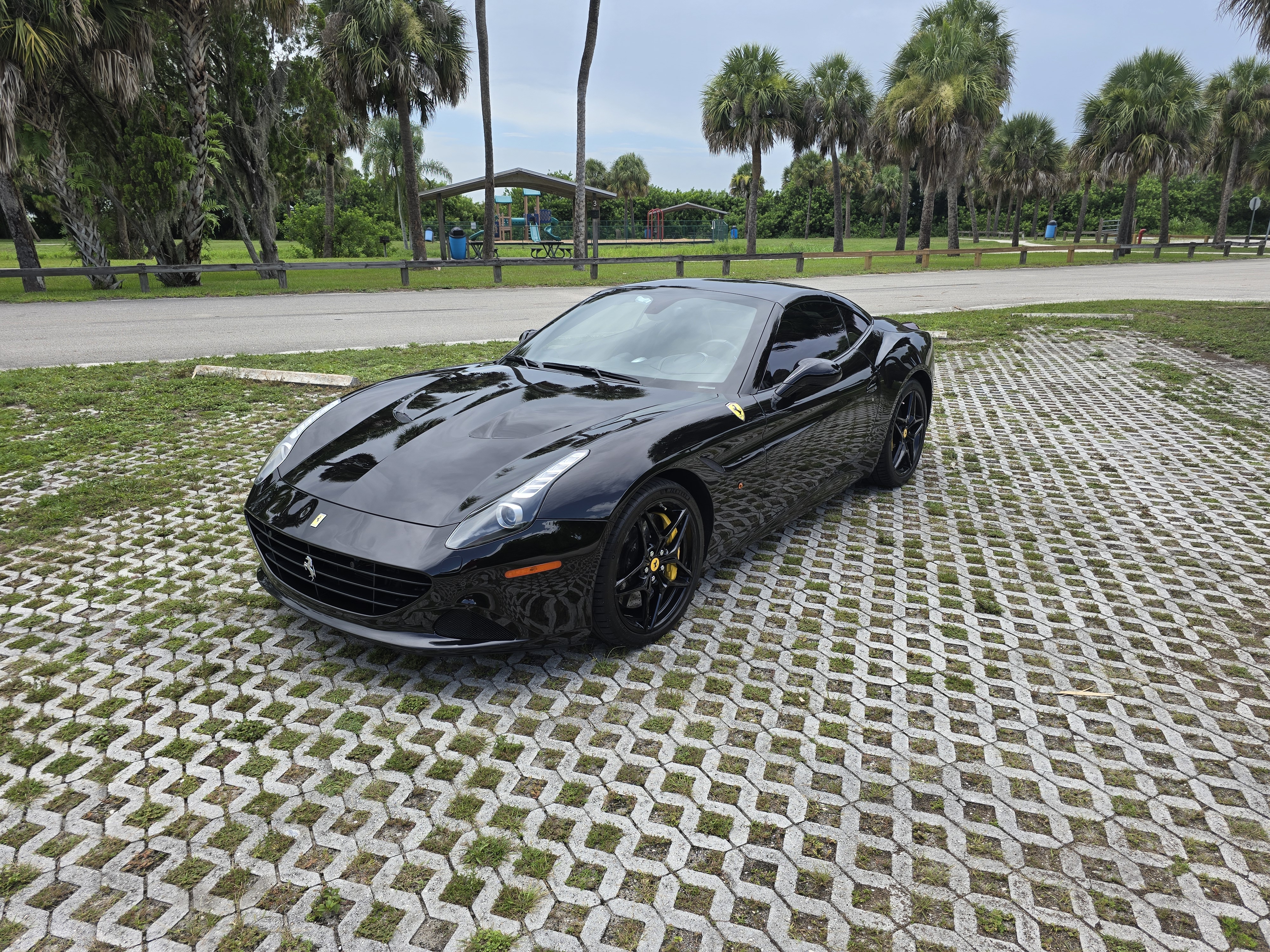

Thoughts after a week.
Maranello rolls off the tongue better than Zuffenhausen.
The California T is not a Boxster. And I didn't buy it to compete. I can tell that the Cali T is heavier and has the engine in the front. It is a very capable GT car. Steering on the Ferrari is a little quicker, but not an issue. The brakes, big carbon ceramics, right now are not calibrated with my right foot. Acceleration is very good! Interior space is a little bit more than the Boxster. Everything is close at hand, but in a different thought process than the Boxster. I am getting used to everything on the steering wheel, not sure I necessarily agree. I have been using the paddle shifters in manual mode. I am slowly getting used to this. I have tried to find a clutch pedal or shifter knob a few times. The retractable hardtop is a piece of grand theater. With the top up it's very coupe. I will need to hard wire the radar detector. And I am researching what to do with the infotainment system.
My plan is drive this thing. Will try and get to the Smokies in the fall. It's pretty neat to find a Ferrari in the garage.
- 20250630_140934.jpg (6.47 MiB) Viewed 1105 times
