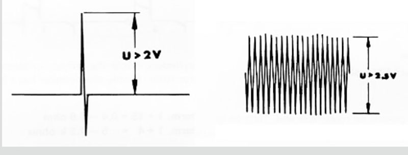

I have tach bounce but no start. When checking the wave form on a Scope its not square but that could be my inexperience with using the scope.

Sorry, I missed this the first time around. The raw waveforms for the speed and ref sensors are not square. They should look like this (ref on left, speed on right).
Tach bounce is usually a pretty good indication, but if you want to post what you are seeing on the scope, we can tell you if it looks right. The injector wires are a very similar source of no-start. If one connector shorts out inside (as they are known to do), none of the injectors fire. Rattle the harness as you crank and see if it comes to life. Does the boost gauge go to 1 when the ignition is on before cranking? If not, your DME/KLR might not be getting power due to a bad DME relay (which is probably the #1 cause of no starts on these cars). I'd also check for fuel and spark to see if that gives clues. If it cranks with tach bounce but with no sputtering, backfiring or other signs of life, other possibilities include a bad KLR (bypass to test), bad alarm system (bypass to test), bad ignition switch, and bad DME. If it does sputter or backfire, other otherwise 'try' to catch, then you are heading down a different path -- timing belt alignment, AFR issues from leaks/sensors, ignition component failures, etc.
