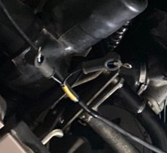

@Tom My car has always had little rubber covers over the connections for the oil pressure sensor. I carried them over to the harness I build, but as far as I can remember they have always been there.

Right, mine too. My question was about the water temp sensor up top with the spade connectors. The Kroon harness comes with the same boots on those wires, which I don't "think" the factory harness had. I think the factory harness just has wires with spade connectors for the temp sensor, no boots. Right?Darwin wrote: Thu Jan 02, 2025 5:40 pm @Tom My car has always had little rubber covers over the connections for the oil pressure sensor. I carried them over to the harness I build, but as far as I can remember they have always been there.sensor covers.jpg

Ooooooh sorry I misunderstood. No mine had no boot there, either. Just the space connector going onto the terminal fully exposed.Tom wrote: Thu Jan 02, 2025 6:35 pmRight, mine too. My question was about the water temp sensor up top with the spade connectors. The Kroon harness comes with the same boots on those wires, which I don't "think" the factory harness had. I think the factory harness just has wires with spade connectors for the temp sensor, no boots. Right?Darwin wrote: Thu Jan 02, 2025 5:40 pm @Tom My car has always had little rubber covers over the connections for the oil pressure sensor. I carried them over to the harness I build, but as far as I can remember they have always been there.sensor covers.jpg

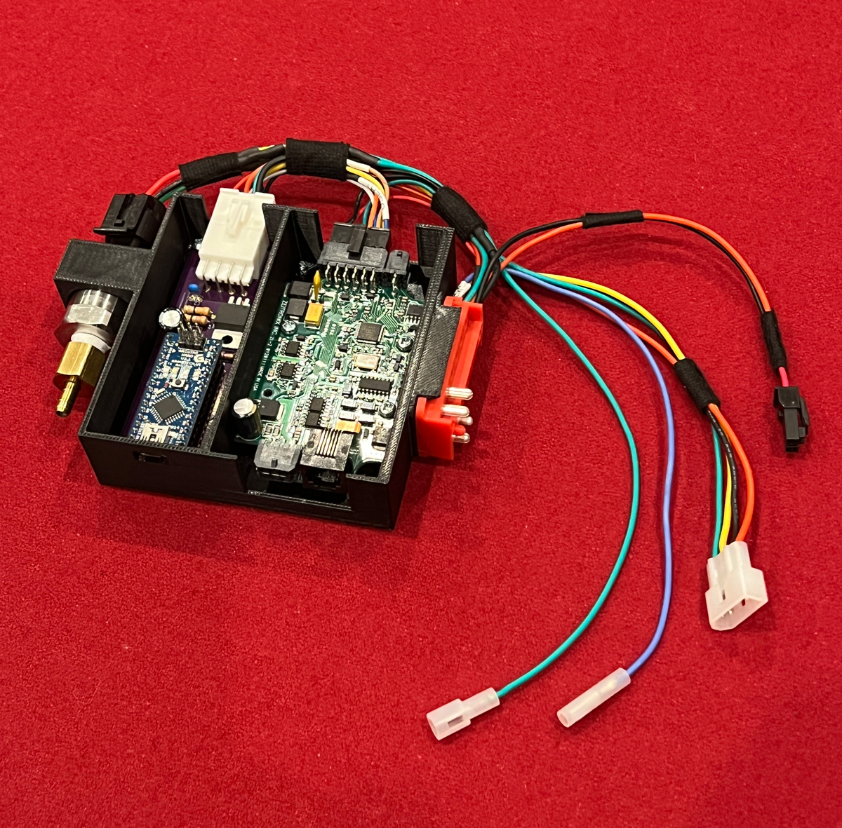

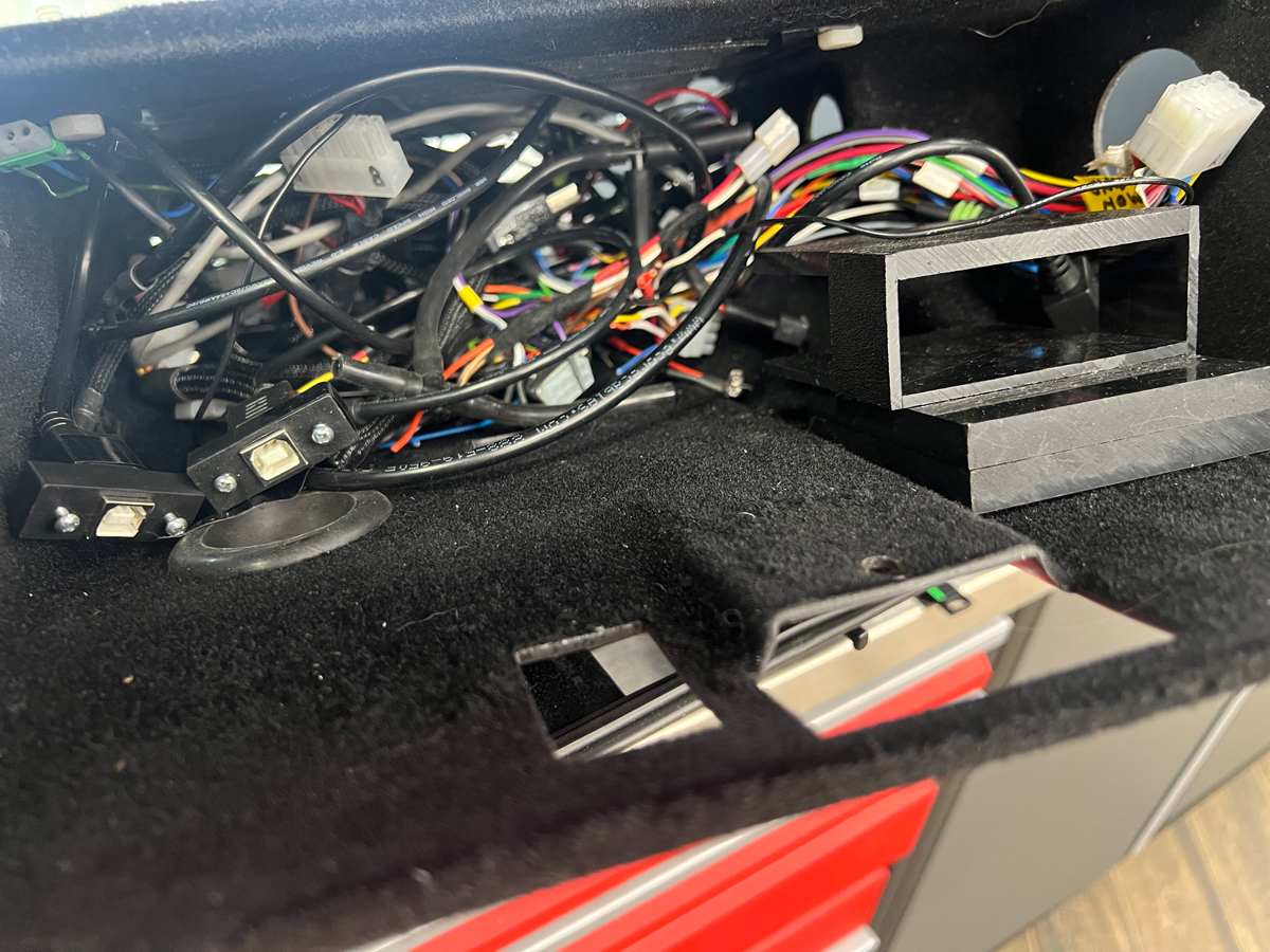

As part of my overall wiring upgrade, featuring the Kroon harness, I wanted to get rid of the endless aftermarket and DIY electronics I've added over the years. I'm going to burn my own chip, so I could nix a lot of the stuff related to engine management. It had become such a mess over the years, with intermittent attempts to clean things up, I decided to make wholesale changes and make it as tidy as possible. Here is my solution -- a custom made enclosure for a few essential items, with the least messy wiring I could muster. The factory diagnostic plug connects to the Kostal connector and supplies all the signals needed, including power for my boost controller, LEDs for the knock monitor, etc.
This is a zeitronix zt2, custom knock monitor, zeitronix map sensor, and an integrated Kostal connector. The best part is I didn't need to cut or tap a single wire in the new harness.
Shown without the cover to make it look cooler.
And here is all the stuff I yanked out of the car!!!!
