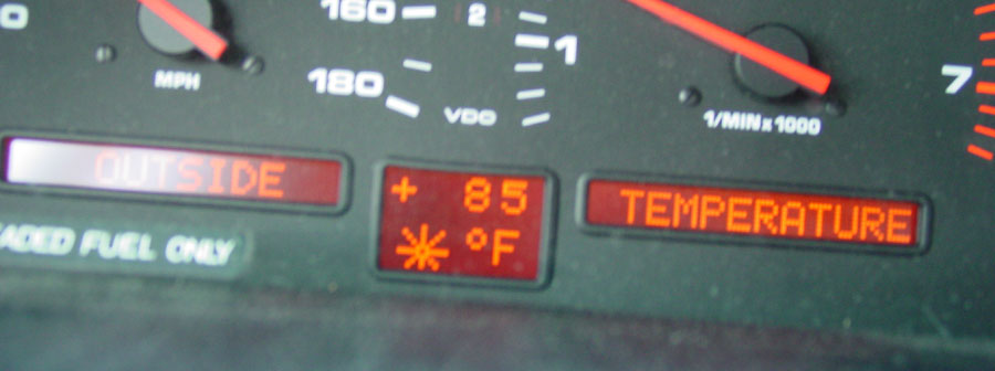

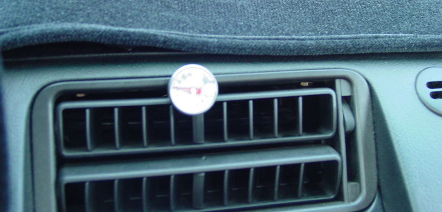

- Ambient Temp --
- Dash temp Small.jpg (60.33 KiB) Viewed 1023 times

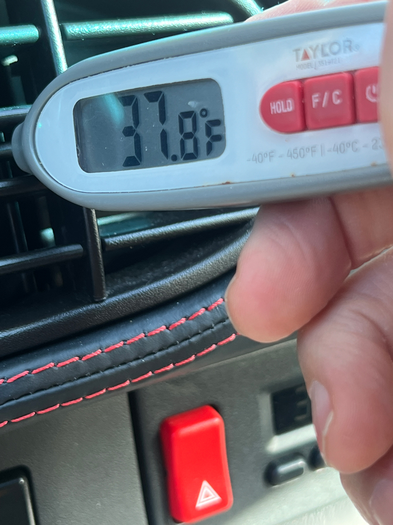

It cooled down to an even 100F today here at CP headquarters, after a high of 107F earlier in the week. Pretty crazy, but I took the opportunity to check the 944 a/c and was pleased to see it still brings the vent temps down to about 38F, then starts cycling the compressor to keep in that 38-40F range. Not sure if that's the high pressure switch or the freeze-over switch, but I figure if it gets the car uncomfortably cold on a 100 degree day, I'll call it a success and move on. The eBay condenser works!

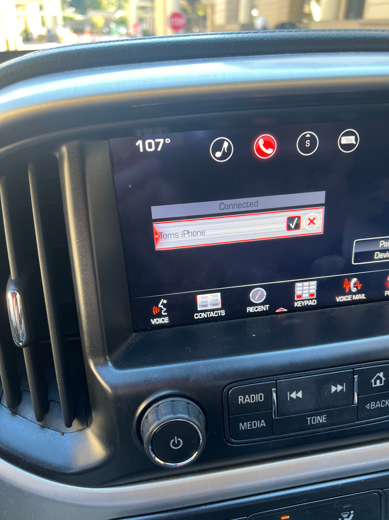

Here's a shot from my truck on Tuesday or Wednesday this week. This was out driving around, not heat soaked in a parking lot. 107F in October.

If you are getting that 37º vent temp at your typical driving conditions and 100º ambient, you have done a very fine job.
For those playing along at home, California is subject to fall weather phenomena where a high-pressure zone parks over the southwest states east, and the winds blow hot and dry off the deserts. The 'dry' (low relative humidity) ambient condition seriously reduces the load on the AC system when the dew point is below the mid-30's evaporator surface temps. A pretty massive amount of heat is needed to transit water from liquid to vapor state (see: latent heat of evaporation in your high school science books), and a similar amount of heat needs to be transferred out to cause the change back to liquid on the evaporator. For folks in humid places with heat along for the ride, there's a comfort factor making the cabin air feel cooler when the water is condensed out, somewhat offsetting the loss of that capacity to the state conversion part. But with all that capacity spent on condensing the water vapor, there's less to actually reduce the sensible heat in the air flowing through.
Condensed if you will, don't expect to get the same vent temps as Tom is enjoying if you have humidity to contend with, even if your system is performing at design capacity.

According to the interweb, it was 102.2F ambient with humidity of 22.11% and a dew point of 53.6F yesterday afternoon around the time I checked the a/c. To your point, I think that qualifies as 'dry' weather. I do remember my days in South Florida where even a glass of tap water would sweat. No idea what the vent temps were, but turning on the a/c in a car was like turning on a faucet at the condensation drain. Even if the vent temps were 20 degrees higher, the dehumidifying effect of the a/c made all the difference in the world. Humid heat is tough on a California guy.dr bob wrote: Mon Oct 07, 2024 9:57 am If you are getting that 37º vent temp at your typical driving conditions and 100º ambient, you have done a very fine job.
