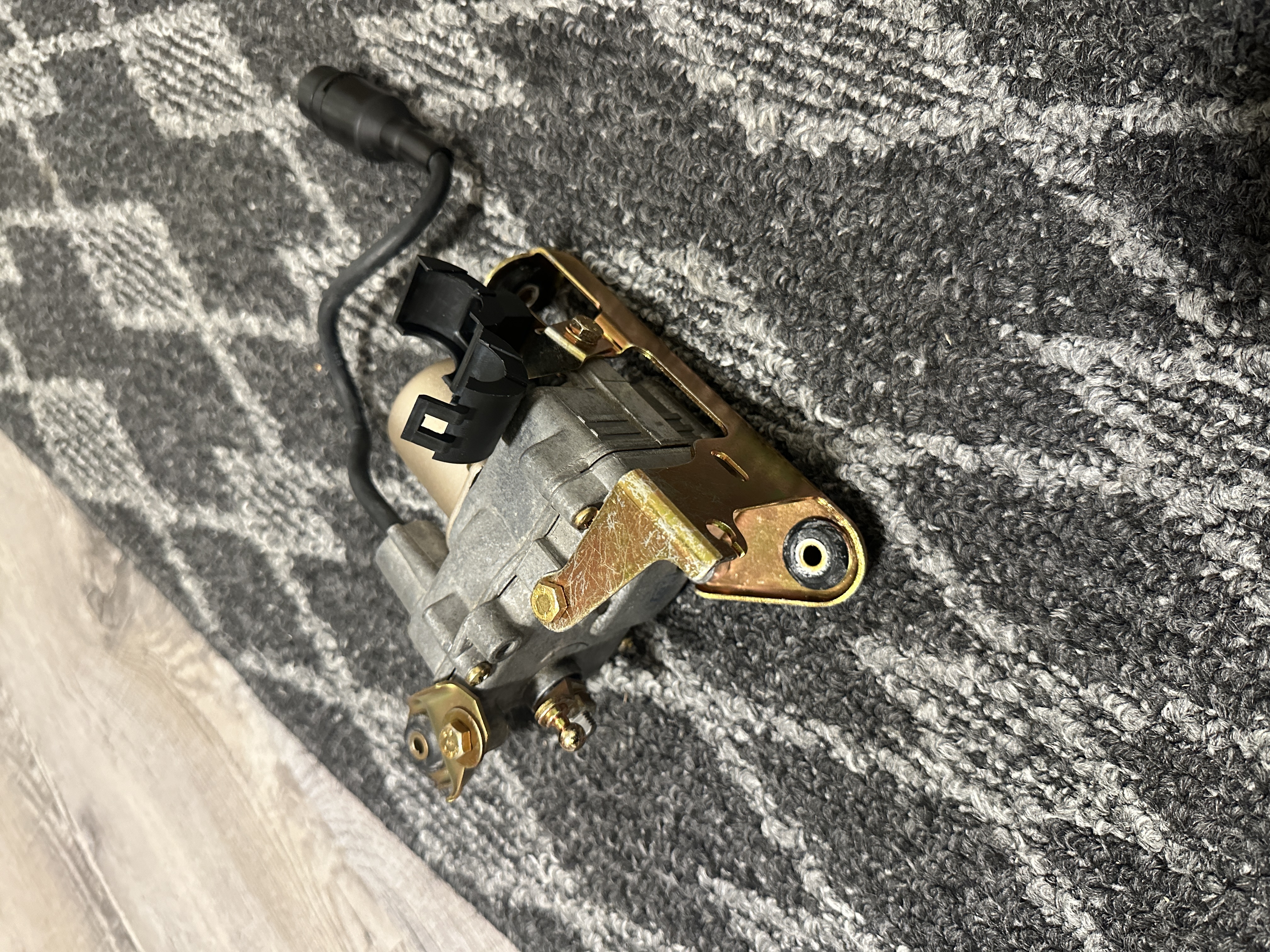

The slow drip-drip-drip of progress continues.
I freshened up the cosmetics of the cruise control unit with re-plated hardware and new isolation bushings.
I will leave the connection of the cable to the unit until after the motor is in.
Fiddled around with a few more vacuum lines and the engine room is getting close to ready for the engine installation.

500 wrote: Mon Mar 04, 2024 11:03 am The slow drip-drip-drip of progress continues.
Do you re-plate yourself? I tried the "DIY" Zinc and Yellow Chromate plating myself using various online tutorials, but I could never get the chromate to stick to the zinc plating. Plus, I really didn't like tying up valuable work bench space for a chemistry set.

by 500
I did look into "home" plating, and I decided against it, as it seemed very difficult to be able to get good results.
I am fortunate that there is a plating company about 45 minutes away that will take small jobs (they are an industrial outfit).
They are quite professional, they do a post-bake for hydrogen embrittlement and give me the paperwork. I seem to end up going there about once a year. They are a very old-school feeling plant, and their website has a "1995" feel, but I really like them. For anyone in the Toronto area, they are M&M Plating: http://www.mmplating.com/
In the past their website has sometimes been down for extended periods, but they are in business. My most recent batch of parts was done this past January.

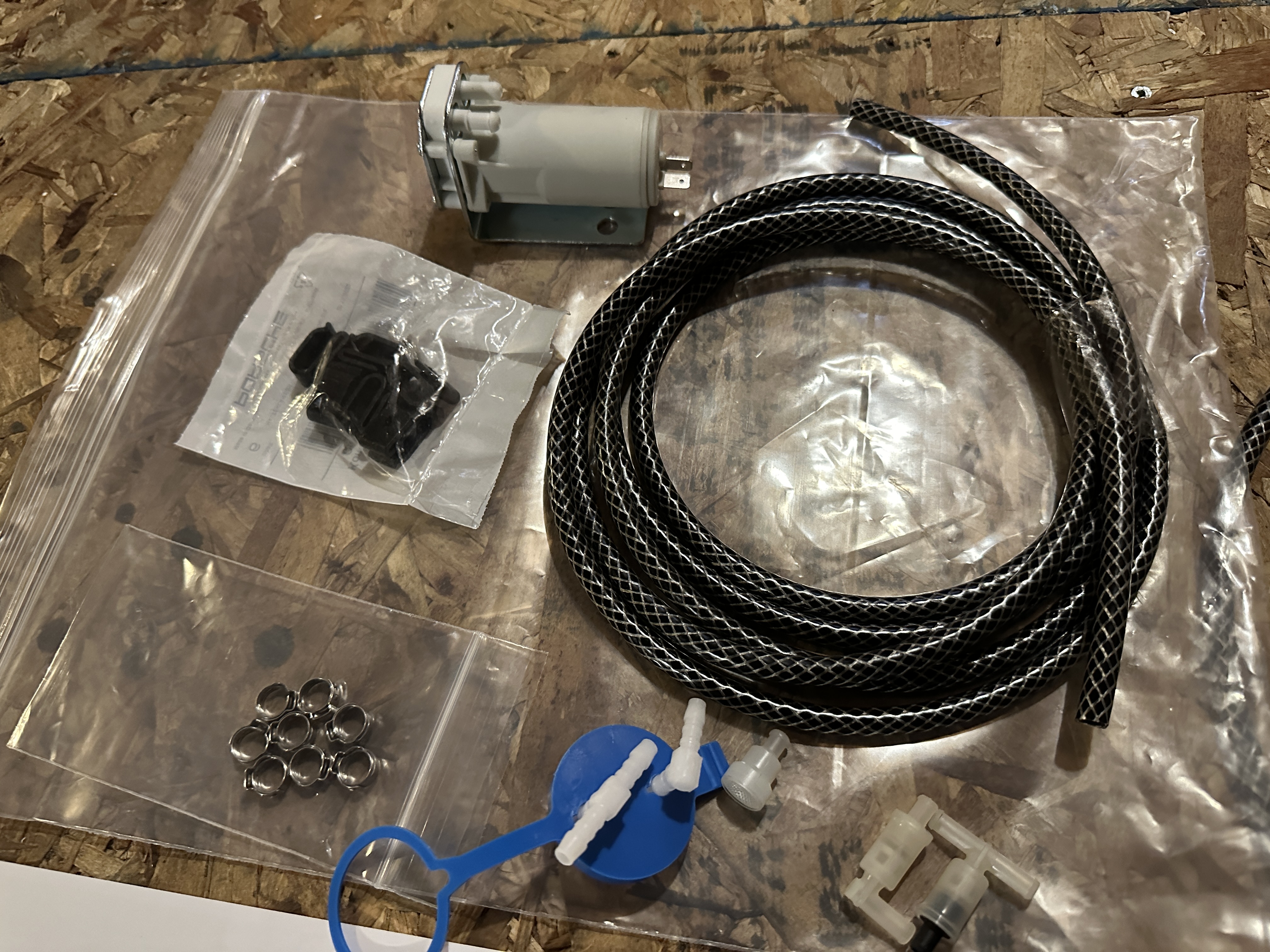

I reassembled the manual steering rack components that had been painted. Although it was greased from the factory (it is a brand-new rack) I went ahead and purchased a small tube of the correct grease from a VW dealership and went over everything, just to make sure.
The windshield washer system had been messed around with a fair bit in this car’s prior life. The passenger-side check valve was connected the wrong way (with plastic zip ties), the pump was a different style to OEM that was just zip-tied loosely in place, and the return tube going into the tank had been plugged shut with a bolt.
To remedy all that, a repair kit and extra hose was purchased from 944online. The pump is an aftermarket URO item, which seems to have mixed reviews, but hopefully it will be fine for a decent while.
Tested the original jets with a syringe and they seemed fine, so went ahead and installed and clamped in all the lines. It looks complete and correct; however, I still have to connect the heating wires and under-hood light. It seems I de-pinned all five wires from the female housing of the inline 6 pole connector that goes in the hood, but have no idea what I did with that housing. Fortunately, they are still available, so I have one on order.

500 wrote: Mon Mar 11, 2024 9:08 am This week’s list of odd jobs completed:
In between, I was also able to install the AC condenser air ducting as well as new hood insulation pads.
Finally, popped the wheel well lines back in. Quite pleased with how they look actually.
I'm going through the same issues with the windshield washer system in my 87 S. I installed the same kit from 944online, found (what I think) was a good set of squirters from ebay. Hooked it all up and.......nothing. Pump seems to work, but I have a feeling either the squirters are wrong or one of the check valves is stuck or backwards. Now I get to cut off all those Oetiker clamps again and see where the flow stops.
