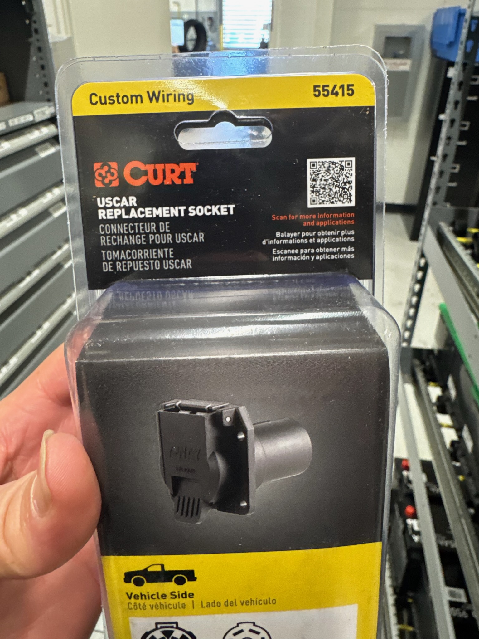

New member here. Glad to find this. Are the mounts available now? How can I get one? New 2025 Cayenne GTS was amazed/disappointed at 2 things. Seeing the sheet metal screws in bumper. The vehicle came with tow package but only a wiring harness. Leaving it up to buyer to find and install the socket without telling buyer. Imagine surprise if you pull up to trailer you are dead in the water. In manual it states a 7 pin socket is there but it is not. Found a thread on subject seems VW common practice across all brands, so I found one to buy and install.

I had this same issue. Even more challenging to figure out having never done any towing. I ordered the Pollak #11893. It worked. In a pinch initially grabbed one from Autozone but I was only able to mount with one screw. What a pain all this was.

Regarding the missing trailer harness for our Cayenne and other Porsches, you are both correct that Porsche does not include them on any new builds anymore. But it goes deeper than that. Porsche (the company) does not even furnish the part for their dealers' parts departments and/or customers anymore, a situation that left many in the dark, especially dealerships.
So, the secret sauce (as I was told) that our parts dept has shared with other dealers is to use the Curt socket, part # 55415.
This is the identical part that Porsche was getting from Curt and re-branding as the Porsche part but with (I think) a PA in front of the regular Curt part number. (PA-55415). It fits the mounting bracket of the Porsche perfectly.
Pic from my dealer's parts mgr:

Much appreciated everyone! Got the Curt socket on Amazon and it worked fine, all bolts aligned and fit the harness perfectly. Also found VW on line parts sells the Pollok socket unit. Same Pollock socket is also available on Amazon but longer lead times. Going to order the tag bracket.
