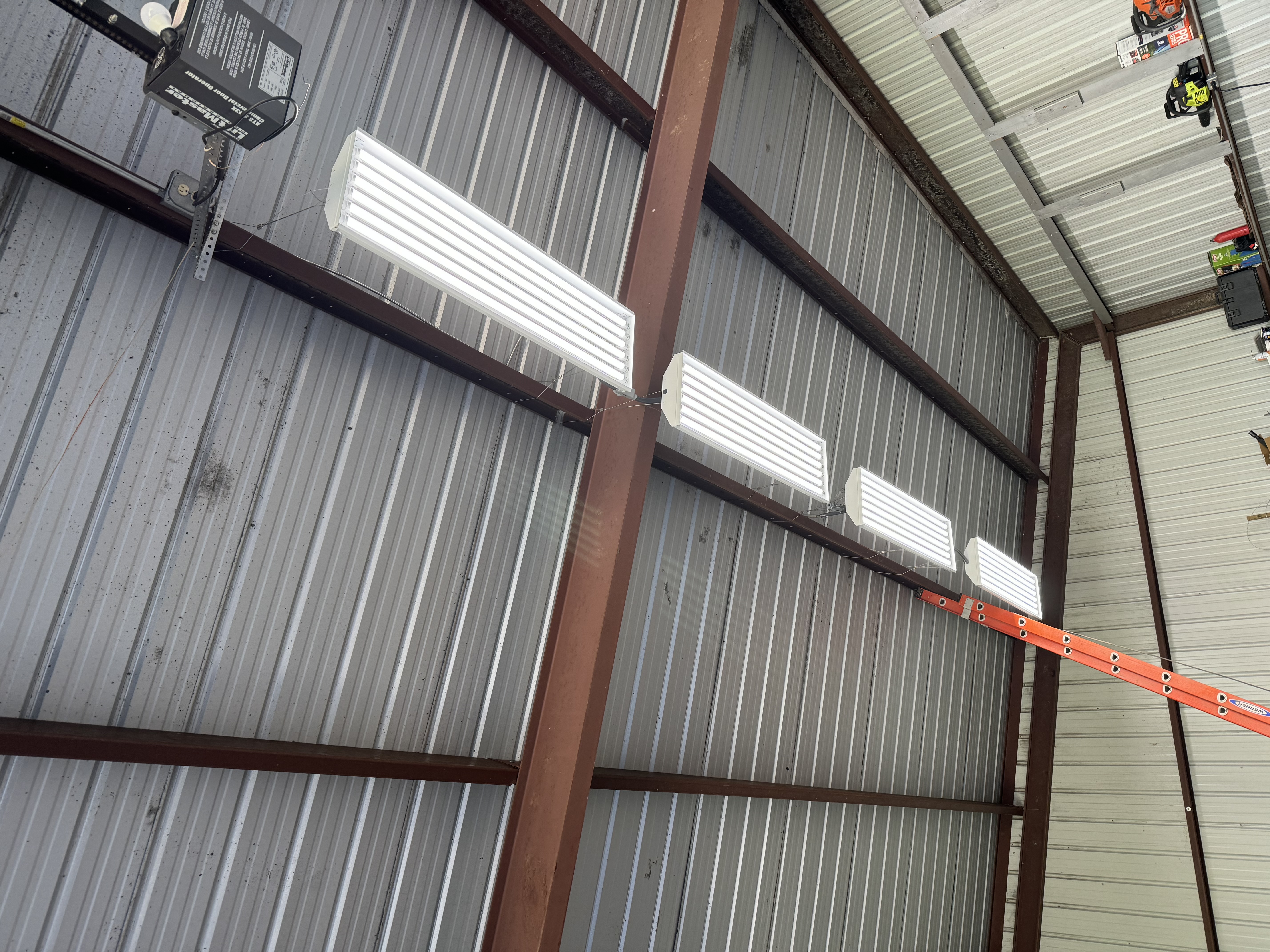

One row down.
- IMG_0988.jpeg (5.11 MiB) Viewed 708 times

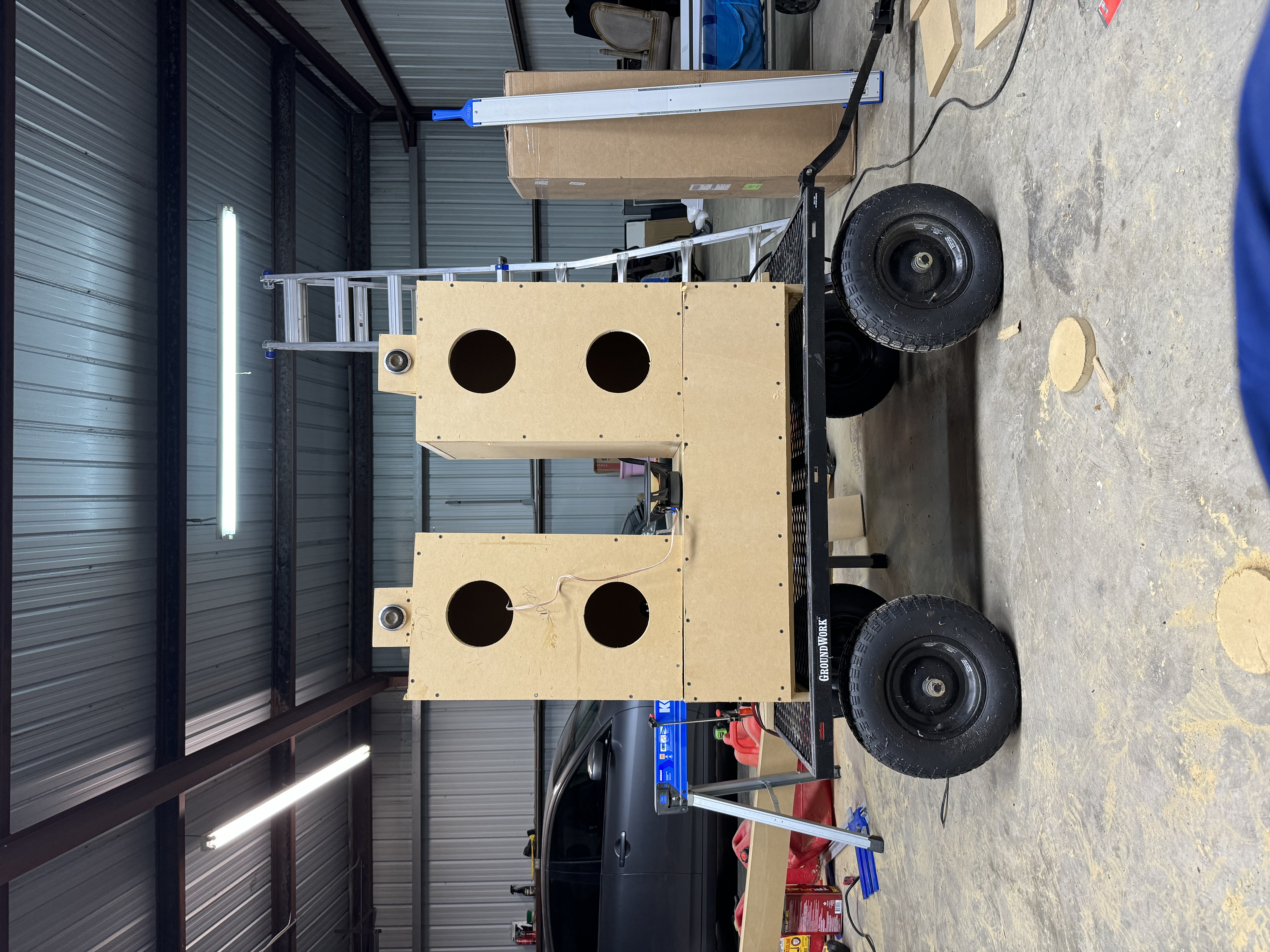

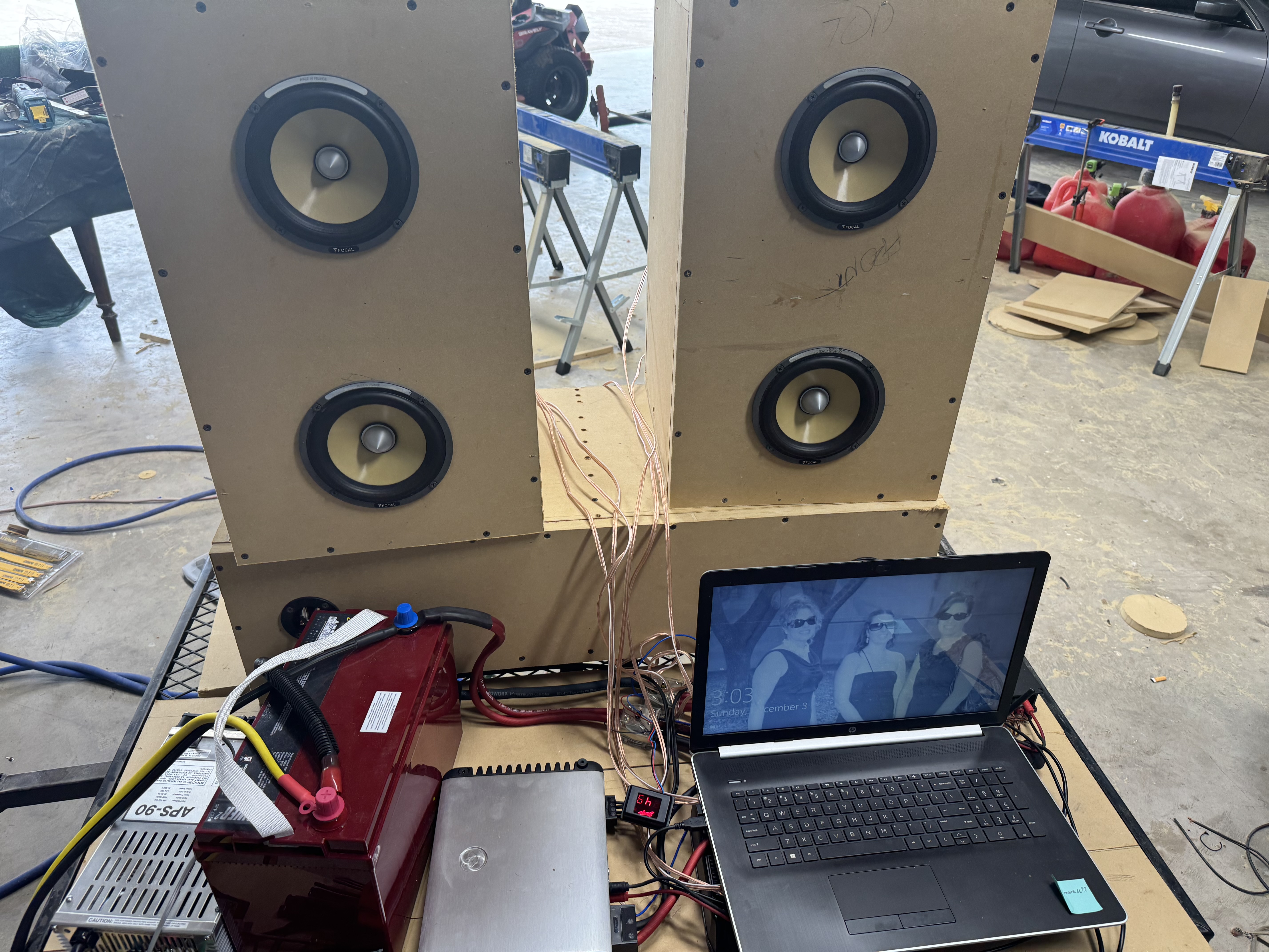

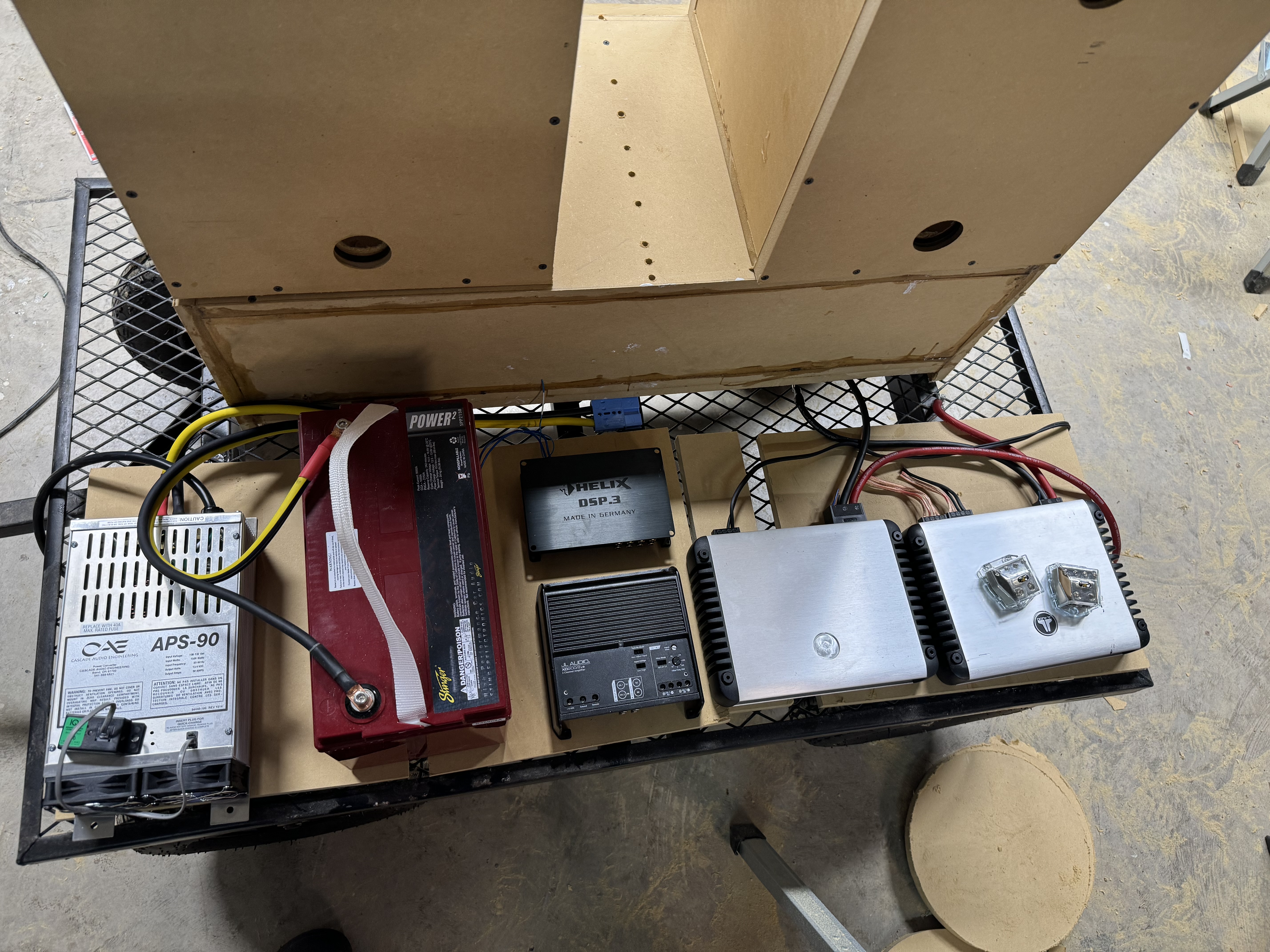

I couldn’t resist and started another project even though I only had one row in. I call it the boom buggy. A 2000 watt Bluetooth speaker
- IMG_1013.jpeg (4.93 MiB) Viewed 651 times
- IMG_1014.jpeg (5.22 MiB) Viewed 651 times
