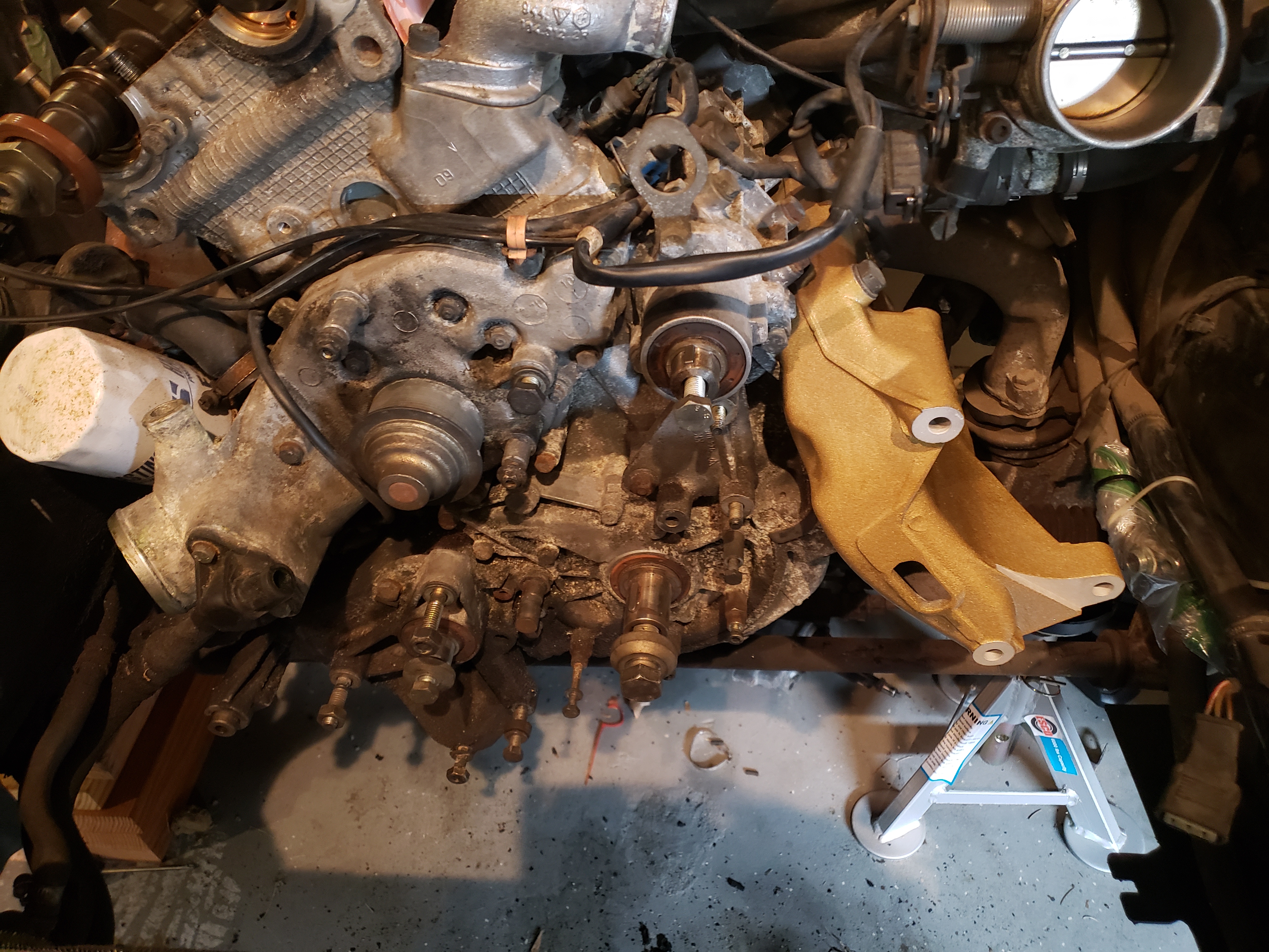

Picture of the engine bay. No real reason to include this apart from general orientation.

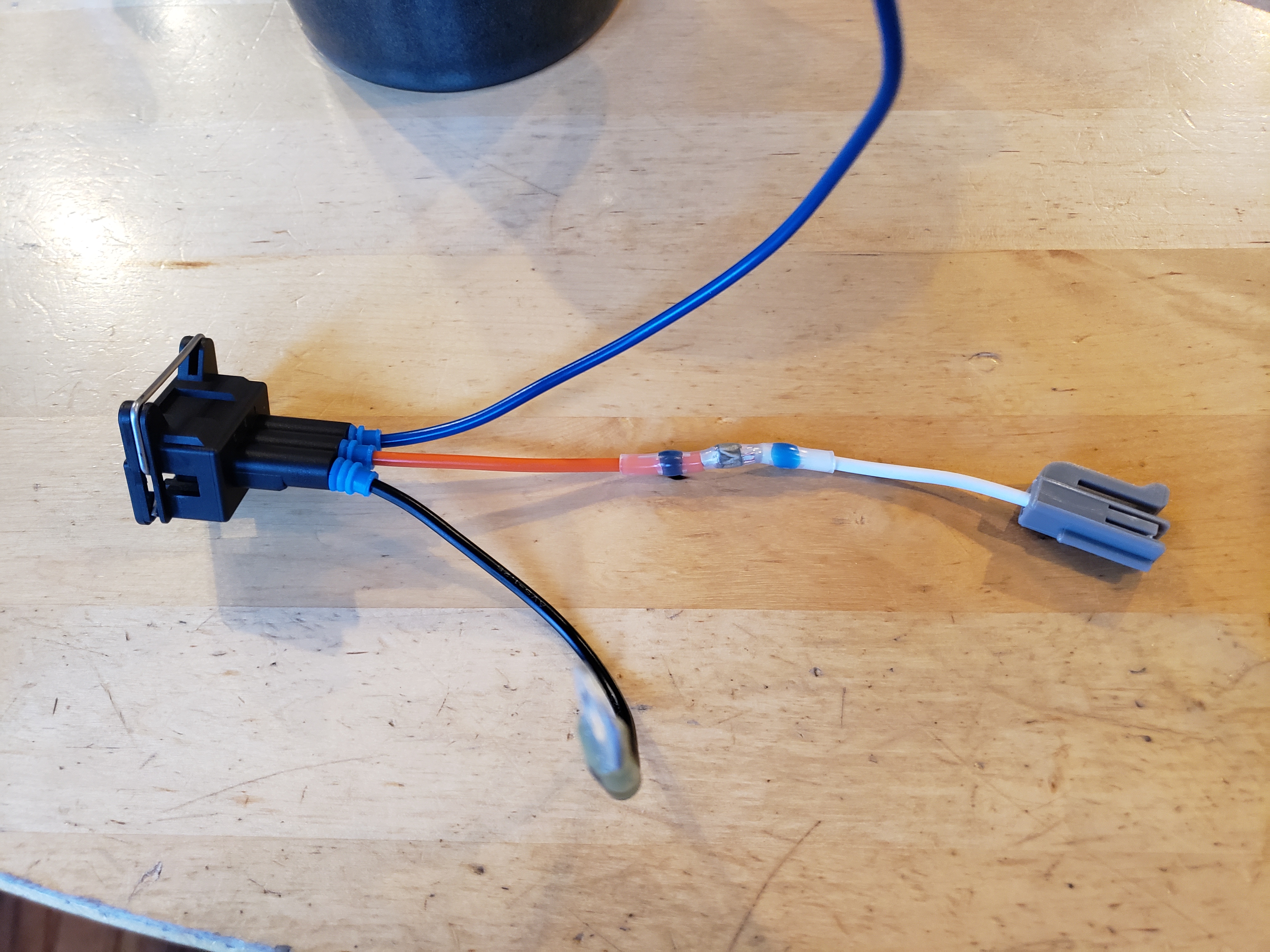

This is the plug on the LRC (?) voltage regulator. Unlike what's called for on the V8 of the 928, the inline 4 of these cars can probably do well to use the compensation. This is a very different connection than on the other version.
This and the next shot are just to try and show that the little raised ridge on the male plug of the regulator does not work with the female connector which seems to be called out in the places I found. I took 2 shots because it's a black female connector and the lighting was not good enough to show that there's no slot molded into the part.
I filed off the ridge on the top of the male connector. The female part of the plug is still held securely by the ears on the side of the male plug and the locking mechanism of the female connector.
I tried to use some nice wire seals to get things really waterproof but even with the thinnest seals I had on hand, they didn't quite seat themselves fully. There's room for improvement here.
This is the connector I used to attach to the (I don't remember what the name of this plug is for the alternator).

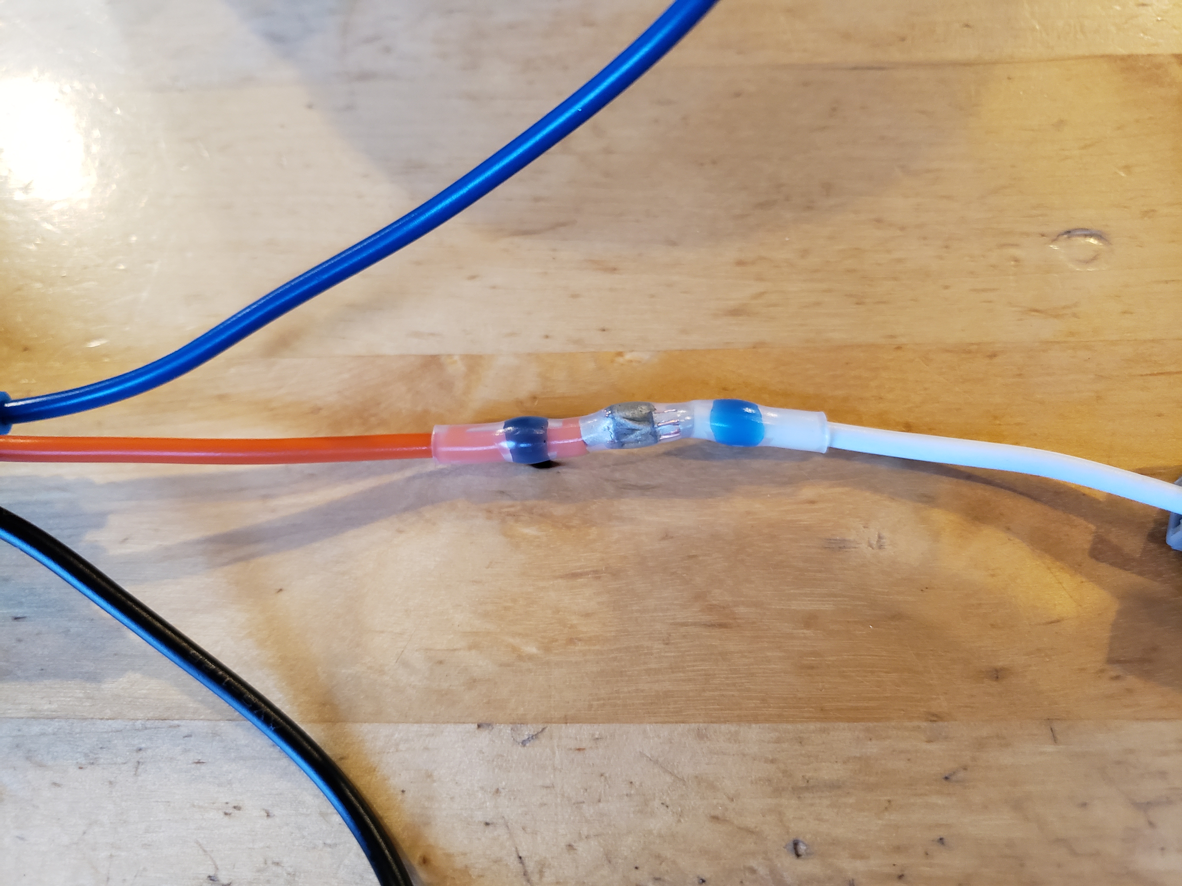

Next and final round of pictures.
Hard to see on the black wire but there's a ring terminal on there. The blue wire ended up getting a WeatherPack single pole connector (that's more clear later).
I changed the blue wire on the stock harness to a WeatherPack single connector. Here it is before insertion in the housing.
Here's the new connection, ready for the alternator.
This is how everything connects/bolts up on the alternator. You can also clearly see the model of the alternator. I was able to find this at the time for about $120, shipped.

Here it is on the stock bracket. I ran into issues with my AC compressor (it is seized) so I had to go to an AC delete bracket, which you can see later.
Things must have been just a little tight, so it looks like I filed down the slightly raised area on the alternator. I'm pretty sure I just made it flush to the rest of the ear.
As outlined in the procedure on RL you have to "build up" the rear of the ear with some washers due to protrusion of the sleeve. This shows you why.
Here's where I left things back in PA. You can see that the mounting bracket has been changed to compensate for a seized AC unit that won't be connected for a while. I also added some split loom protection to the wiring connections on the back of the alternator.
