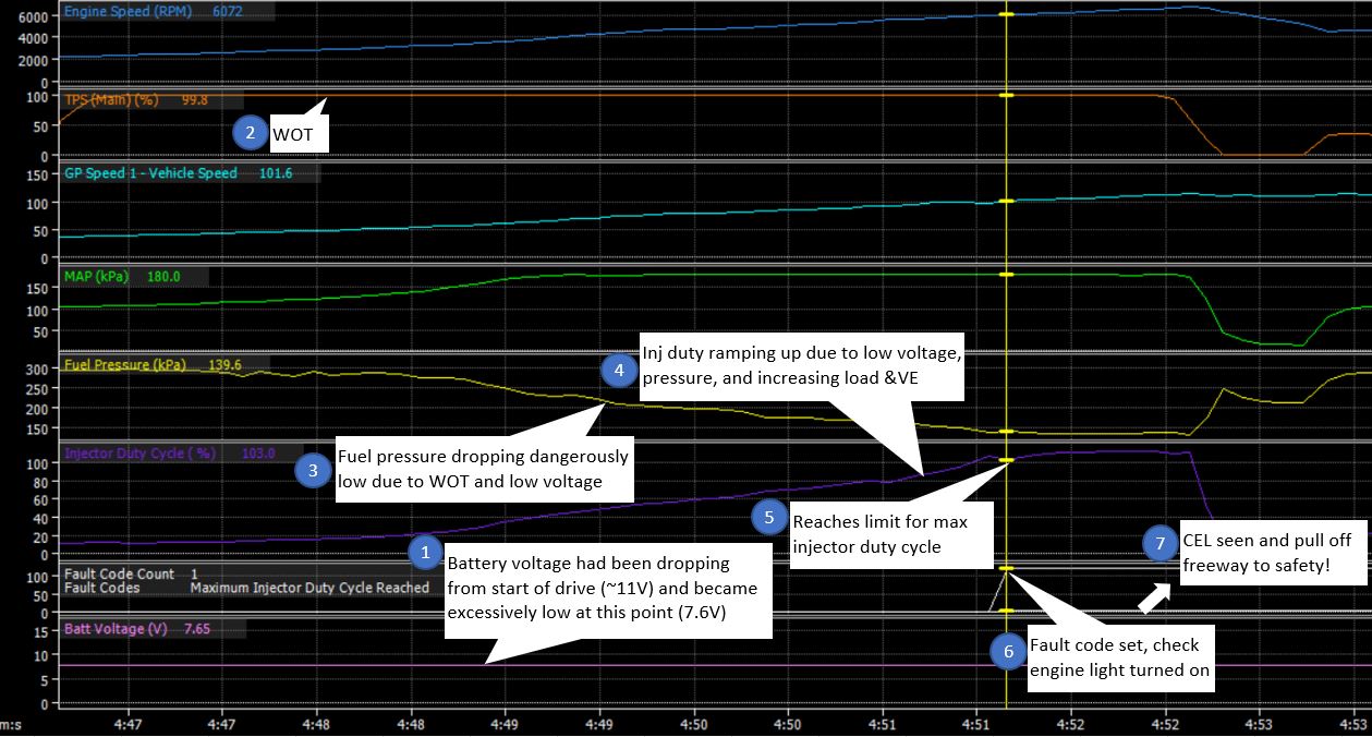

Lastly, loosely related but I was conceitedly happy to see that my check engine light solution with my standalone ECU played a big part in me not being left stranded on the side of the freeway when my battery finally did die from lack of charging….
My steering wheel/seating position blocks my view of the voltage meter on the dash, so I didn't see/wasn't paying attention to it while my battery was dying. While doing some road tuning I had decided to head towards the freeway for some higher speed and higher load driving. While on the freeway as my battery was dying, voltage was dropping so low that the fuel pump could not maintain adequate pressure under load. It dropped low enough that my injector duty cycle climbed through the roof, due to the way the injector pulse width calculation uses dead time (function of voltage), pressure, load, and VE. Once duty reached the threshold for max, triggering a fault code, my check engine light came on as designed. I immediately saw the light pop up and took the approaching exit to find a place to pull over and read the code/debug what was going on. As I was taking the exit the voltage dropped low enough for the ECU to go offline and kill the engine. So I coasted to a gas station right off of the exit. Luckily it was all down hill and I didn't hit the light at the exit ramp intersection…
Had I not had the check engine light, my idiot self would not have ever seen the idiot light on the voltage meter and would have continued driving. If I had, I would have missed that exit and my car would have died while on the freeway, which would have been way more dangerous, less convenient and in general a much larger pain in the a$$. So I was super happy that I had the check engine light wired up and configured!!

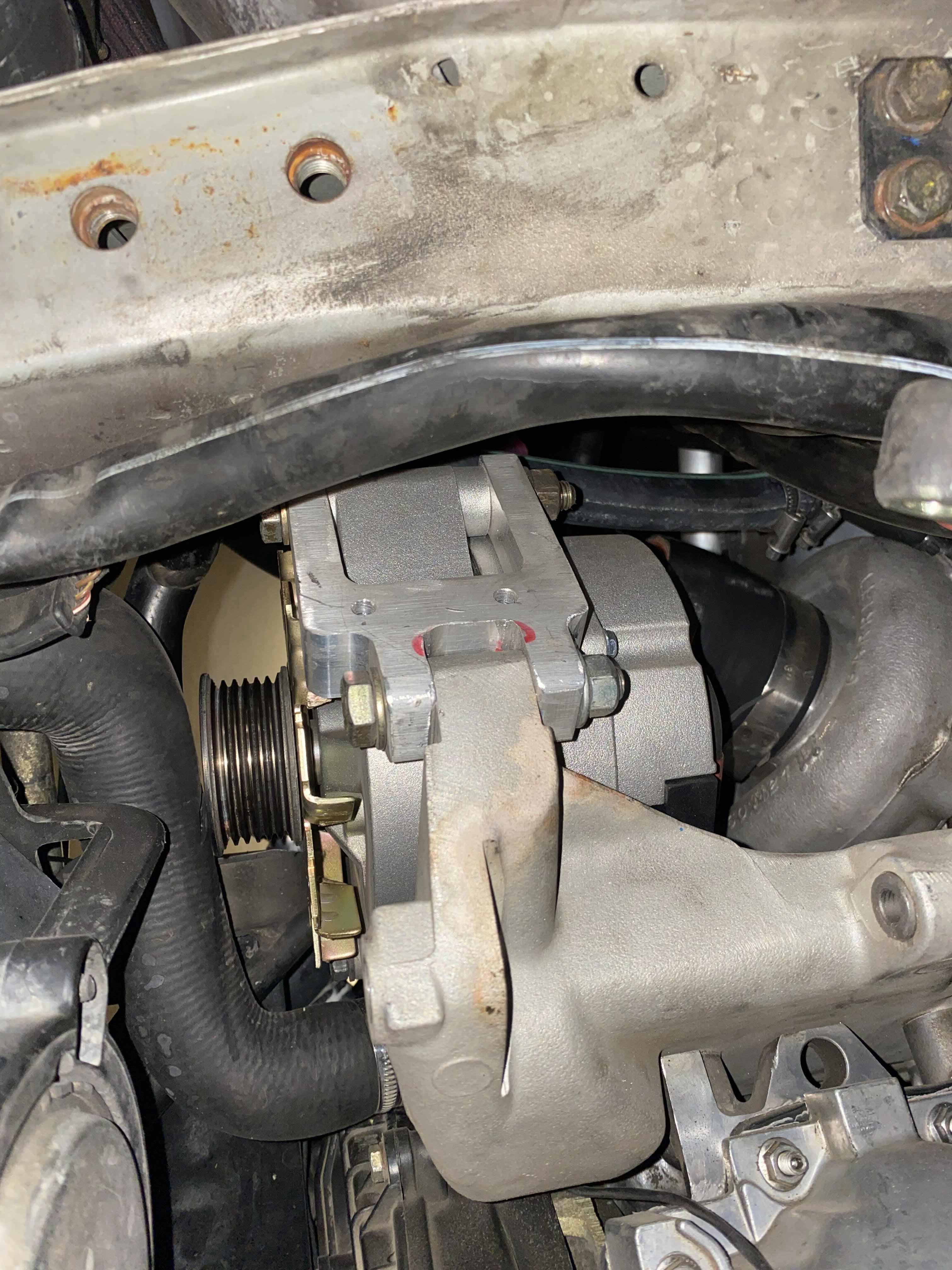

Finally had time to order a better quality remanufactured unit and install.
However, of course....the replacement alternator didn't fit my previously modified alternator/AC bracket so I had to pull the bracket back out and take more material off. The new one which was an OEM remanufactured part had slightly larger bosses around the alternator case as well as a beefier and slightly larger case casting in general. What a pain in the a$$ this "mod" is.
Regardless, finally I'm up and running again and I can get back to road tuning before that stupid white stuff starts falling from the sky again here in a couple months.
