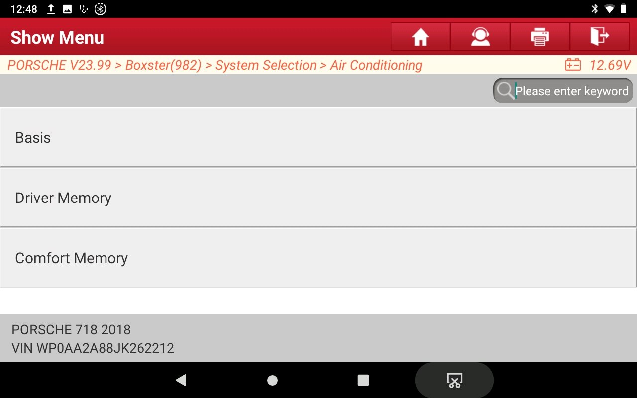

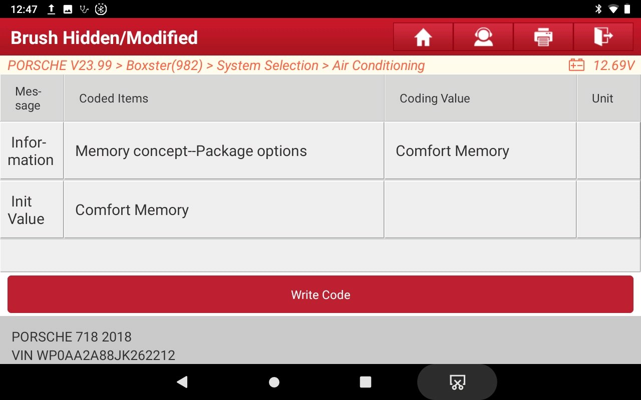

The climate control startup parameters can also be edited, if you have seat memory. Default is for the HVAC setting to start with the settings that have been saved to memory, per key. So if you save the seat settings with the HVAC set to "SYNC, 74°, A/C off" that is what it will be on startup regardless of what you had it set for when you last shut off the car.
I found this to be a pain on an August trip through California's Central Valley in 105-115°F heat. I obviously had the A/C cranking, but after every stop (fuel, food, rest area) the car started with A/C off. Not great.
There are 3 possible settings for cars with seat memory — Basis, Driver Memory, Comfort Memory. Comfort Memory is tied to the seat memory, and is the default for cars with seat memory. Driver Memory remembers the last setting that was used with whichever key was used. And Basis apparently just remembers the last setting regardless of key.
HVAC startup memory
  • System Selection > Air Conditioning > Memory concept--Package options = [Comfort Memory, Driver Memory, Basis]
    {Default: Comfort Memory}

Arne2 wrote: Wed Apr 12, 2023 10:00 pm The climate control startup parameters can also be edited, if you have seat memory. Default is for the HVAC setting to start with the settings that have been saved to memory, per key. So if you save the seat settings with the HVAC set to "SYNC, 74°, A/C off" that is what it will be on startup regardless of what you had it set for when you last shut off the car.
HVAC startup memory
This is technically not accurate the Basis setting remembers your AC temperature but not when it's turned off. The Comfort setting will remember your settings with AC ON or OFF.
