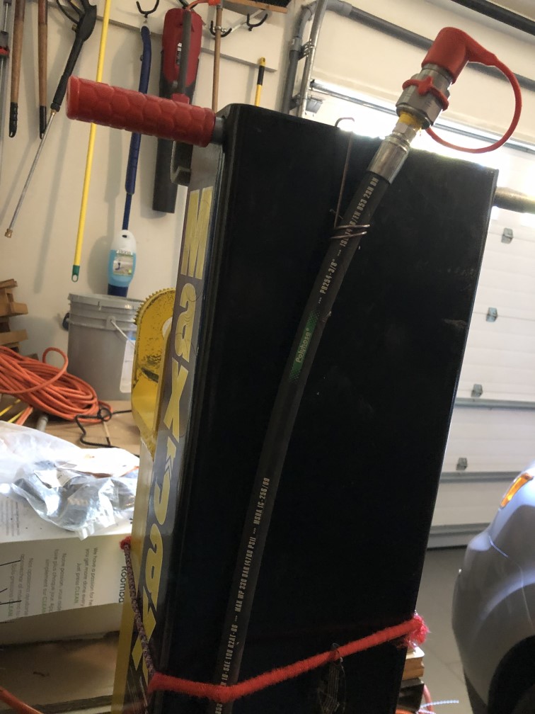

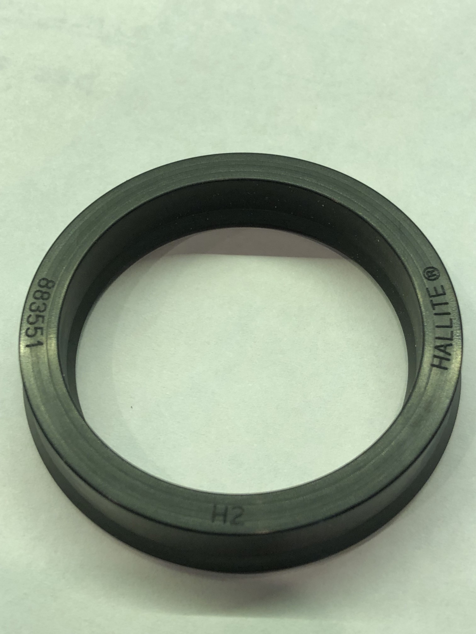

I had some weeping-cylinder syndrome on one column since new. I was living in Glendale, about 45 mins from their location near the far end of the San Fernando Valley, but the weepage wasn't enough to get me to over there. Fast forward a dozen years, and I was getting tired of the mess. Looked around for cylinders, but they were on infinite backorder as they were absorbed by BendPak. Ended up pulling and disassembling the cylinders for a look. Leaking piston seals. Shop for them online by application and they are rare and expensive. So I took them to the local hydraulics shop. Ended up with 2"ODx1.625"IDx0.375" seal, a common size used on Bobcat accessories per the shop. The seals are cheap, like a few dollars each. They put them on the pistons for me no-charge, and I left a $20 tip for the instant and courteous service.
Use hydraulic oil (2 gal "farm oil" at WalMart) instead of ATF. Your description of one side higher than the other might be mismatched cylinders, or as easily could be air in one side. The hoses MUST slope up continuously from cylinder to pump while you purge air out, so bubbles will float back to the reservoir as you raise/lower the columns and bleed the tops of the cylinders. I have the pump wall-mounted and extended the hoses over the door and along the wall on the far side. I ended up pulling the hose out of its conduit sleeve and laying it on the floor to purge air out after I swapped the repaired cylinders back in. Once everything was completely hydraulic again, I put the long hose back in the sleeve and all is well again.
My early-model MaxJax came with cheap couplings, and every connect/disconnect left a dribble of fluid. Some folks on Garage Journal recommended some better couplings available on Amazon. These: https://smile.amazon.com/Hydraulic-Quic ... ast_sto_dp Or search "3/8" Flat Face Hydraulic Quick Connect Coupler Set w/Dust Caps, 3/8" NPT Thread" and look for Summit hydraulics couplings.
I also added 3/8" hose pigtails directly from the cylinder and got rid of the mess of angle adapters and extensions. The hose gets tied up with the same bungie cords I use to hold the arms when the columns are hanging in "storage position". Those hooks are a mix of cheap rope hooks and hangers from Home Depot. The hook on the hose end is a bit of sculpted steel gas-welding rod with a copper coating on it, so it hangs on the top of the lift column while stored.
The seal:
The seal:
- MaxJax Seal.jpg (332.55 KiB) Viewed 2450 times

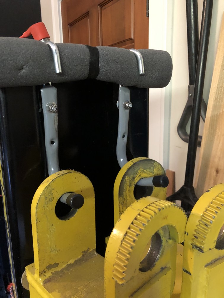

The hose support and the arm hangers:
- Arm Support.jpg (140.11 KiB) Viewed 2450 times

Good info, thanks for your reply. Yes, I replaced my quick couplings and the supplied fittings with better quality hardware early on. The arm hangers are neat, I'll have to get some if I can't find my old bike hangers.

Disassembling the cylinders is pretty easy. Secure the cylinder body so it won't turn, tilted with the open end down a little with a catch bucket under the end. My tool collection has a ring spanner with the right size pin for the nut on the end of the cylinder, but that nut isn't super tight. You could do it with the right pin punch in a hole to get it started. Then it comes off by hand. Don't risk scratching the piston end by using a pipe wrench or Channellocks on the nut. Slide the piston out carefully, and capture the oil. Once the piston is out, wipe it and wrap it in cardboard, take it to the hydraulic shop and let them replace the seal on the piston. They have tools and much better techniques than I do apparently, and will get the new seal on there with no damage to either the seal or the groove in the piston. Get it home, lubricate the seal, and slide it back into the cylinder. Slide the nut back on while you hold the rod centered in the bore. Tighten it enough that it won't fall off. Good to go...
