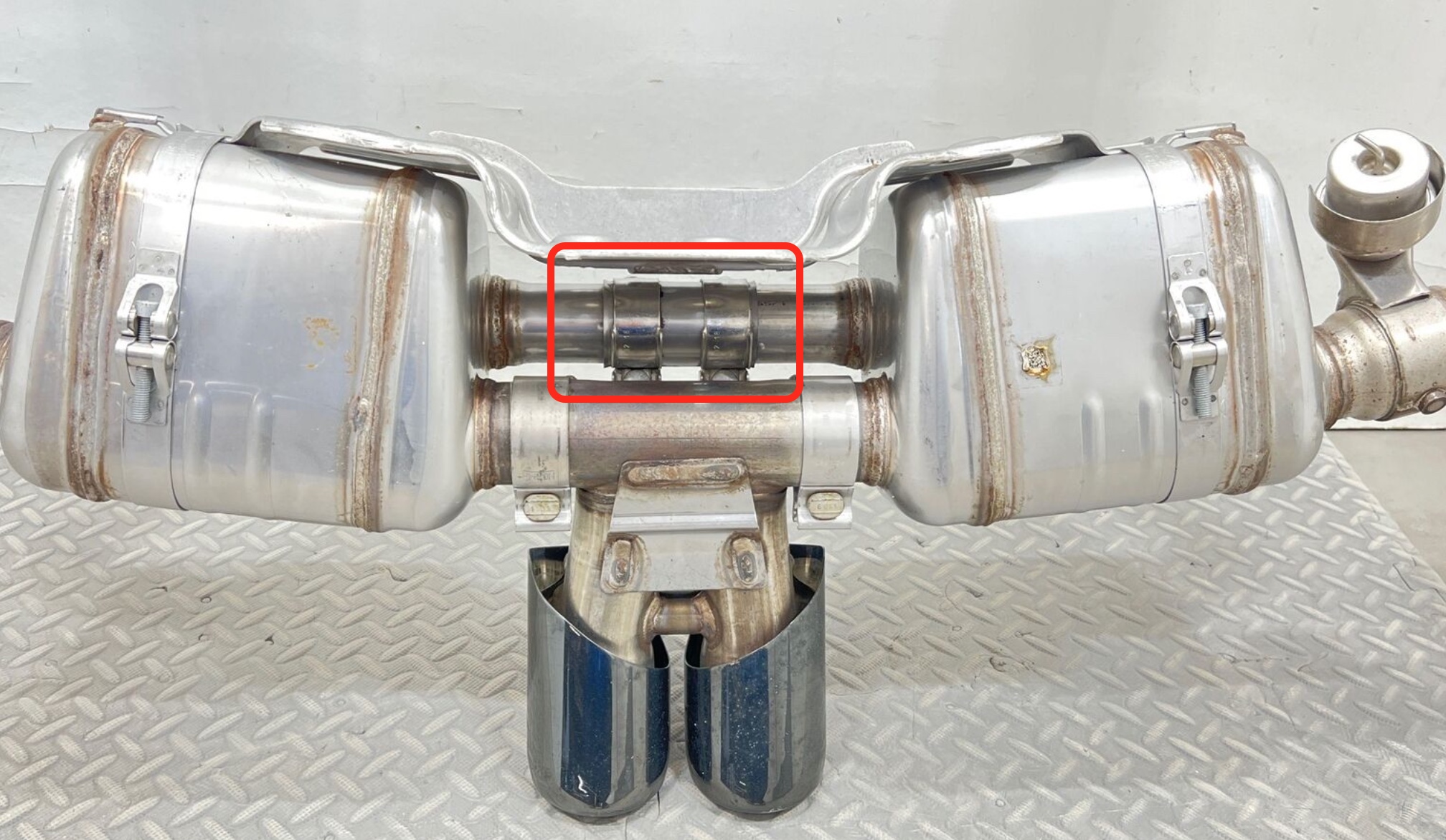

I've been recommended on a different forum to try the "exhaust sleeve hack" to give the exhaust note more character. Apparently this is a common thing for both 981 and 718. The idea is the loosen the two clamps on the connector sleeve I highlighted below, and slide the sleeve sideways far enough to leave a small gap between the pipes. About 5-8 mm gap is generally recommended. Then tighten the clamps back up. Seems not that different than the high schoolers were doing...

Different joint, but exactly the same idea. Pretty funny even fancy new Porsche owners do it. :lol: Sounded a lot like a rusted-out muffler to me, at least on a Nissan.

I've heard a 4 cylinder 718 with this done. Not nearly as obnoxious as the straight pipe bit. A bit deeper note, with a little more of the flat-4 character (but not like a WRX with coffee can muffler). Seems a little bit wrong to me, intentionally causing an exhaust leak...

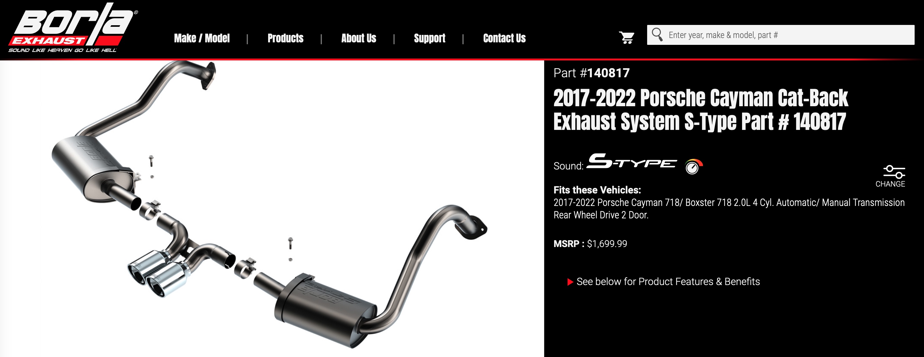

Well, my thinking on all this was that factory PSE would be a good fit for me, as I would like it a bit louder when mauling the back roads, but stock volume is good for touring, commuting and not annoying the neighbors. And most aftermarket exhausts that I've heard are much louder, all the time. I kinda like the looks of the Borla systems for the little 2.0L 718, but they rate it at their middle volume level, and I fear that would be too loud for daily use.
