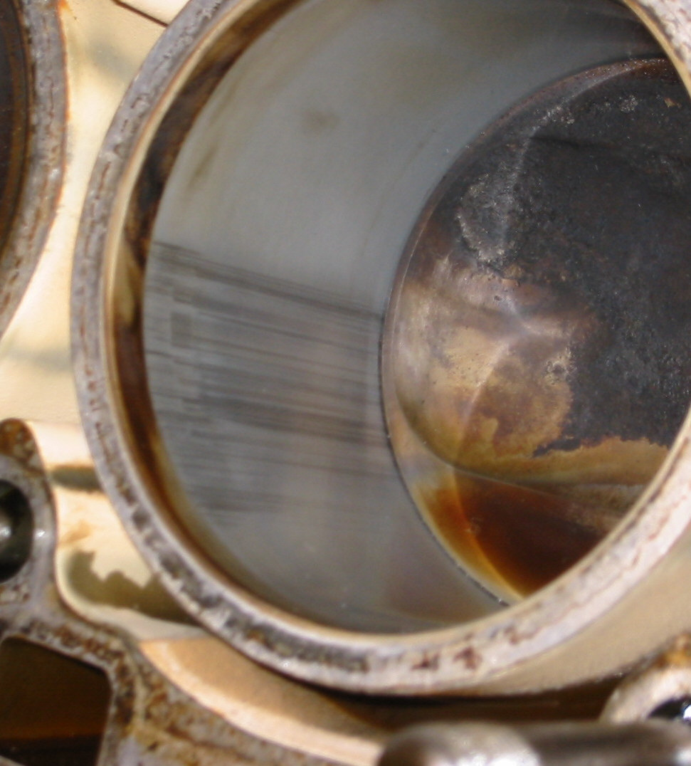

Can't agree more on load discipline from cold.
Beyond oil temp and flow, I try and keep the pistons smaller than the bores they ride in. Pistons sit amazingly close to combustion heat source, and are very low mass compared with the barrels and coolant circulating through them. Keeping the differential piston to bore temp low is key. RPM management is part of this, but load (and the thermal effects) are critical in my experience. I have a loose theory about a relationship to bore scuffing, unproven at this point. Bottom line for me anyway is that load discipline with cold metal dramatically improves your piston and bore life chances.

Thanks for putting words to the primordial thought-soup in my head. I don't have all your engineering book learn'n and experience (or any of it for that matter ;) ), but I came to essentially the same conclusion after realizing a block just can't expand fast enough (if ever) to remain bigger than pistons when running way too much boost.
score marks.jpg (181.38 KiB) Viewed 835 times
