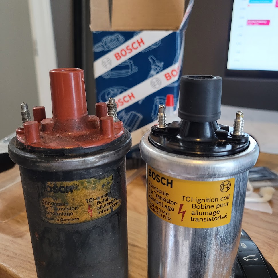

Here's the new one compared to an old one. The old one here looks exactly like the one in my car. The new one is narrower and has a smaller + post so I can't install it without a trip to the hardware store to look for an M5 nut. It came out of a Bosch box, from Pelican parts so I have to assume it's legit.

As for different coils, I plugged the PET part number into the Porsche parts database (via Sunset) and see that the coil was officially superseded to that smaller diameter version. Not sure how I feel about using foam tape to make it fit in the bracket.
Looking forward to seeing if the new ones charge any differently...

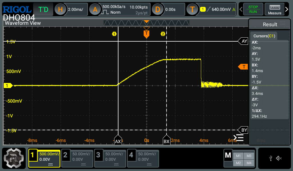

OK, here's my result with the new coil:
Exactly the same, ~3.5ms or so.

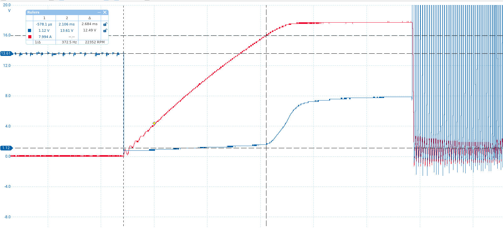

I tried to measure the inductance of the coil using a few approaches with pulse generators and signal generators but it was hard to get values I could trust. I was able to reproduce known measurements of small PCB mount inductors with these techniques but it seems that the physical size of ignition coils and their capacitance makes it trickier.
So I decided to try a different approach - why not just try to measure all the voltage drops and see what the formula I used originally says? It should be ok once I know all the voltage drops right?
Here's what I came up with:
The red trace is obviously the coil current, and the blue trace is DME pin 1 (with the probe ground lead on pin 16 or 17, one of the DME grounds). So blue measures the voltage drop across all the coil driving circuitry.
The initial ramp up of the blue trace is (I presume) the voltage drop caused by the coil current. The sudden jump just before peak current is obviously the DME's current limiting kicking in. So I limited my measurement to the linear part of the voltage drop, and just took the middle value, which is a drop of around 1.2v.
I also separately measured the drop between the battery and the positive side of the coil during charging and it's much less, just a couple of hundred mv over the same interval. The drop between the DME ground and battery ground is even less still.
So ultimately using the formula I used originally this suggests the coil inductance is in the order of 3.2 - 3.3 mH.

@johnb -- you are one scary-smart dude...
Lol well in fairness Rogue called it as 3 - 3.5 a page or so back without the benefit of a scope trace to see the voltage drop!Tom wrote: Tue Oct 14, 2025 2:38 pmjohnb wrote: Mon Oct 13, 2025 5:36 pm I tried to measure the inductance of the coil using a few approaches with pulse generators and signal generators but it was hard to get values I could trust. I was able to reproduce known measurements of small PCB mount inductors with these techniques but it seems that the physical size of ignition coils and their capacitance makes it trickier.

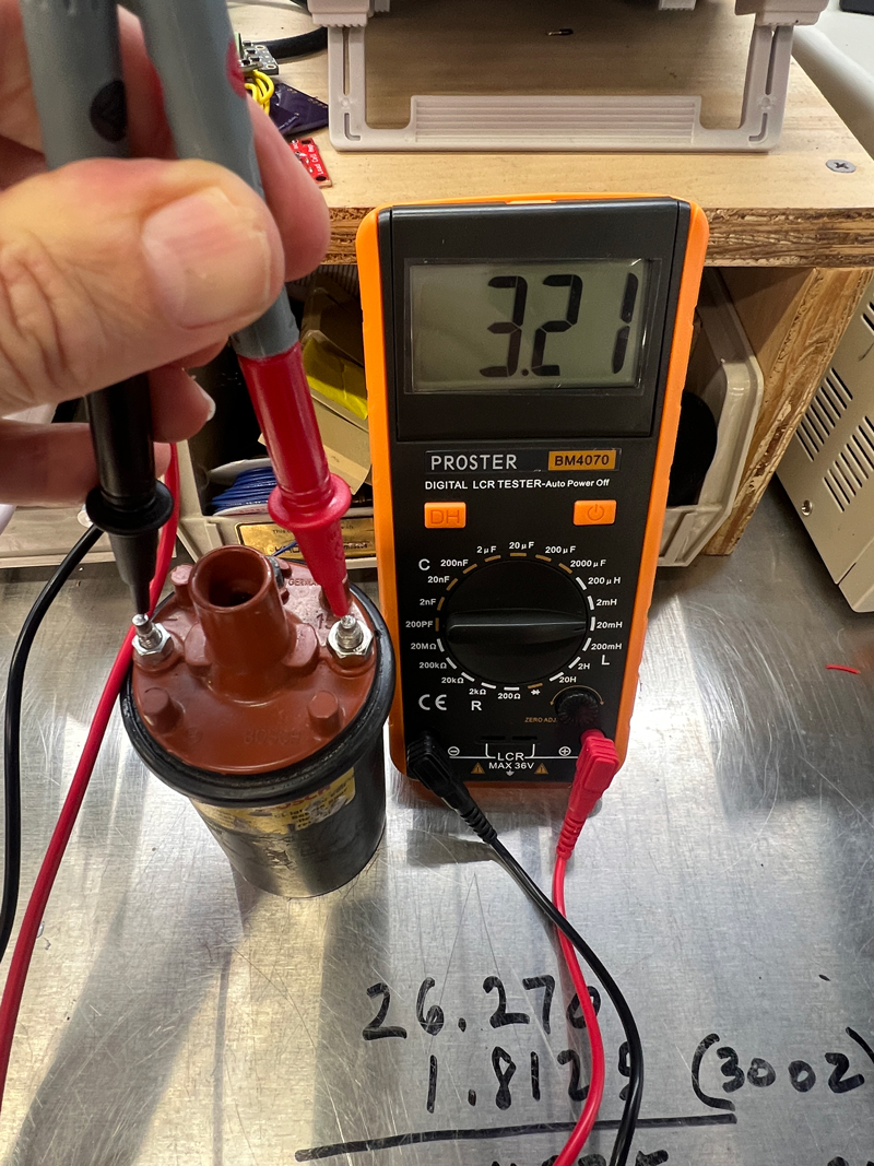

Using my BK Precision 879B LCR Meter...
I just measured four 944 coils, they were all right around the average of 3.6mH.
There is close to enough time to charge the coil at 6500 rpm & 13.8 volts (coil energy starts dropping around 6320rpm, but it doesn't drop by much, about 3%).
