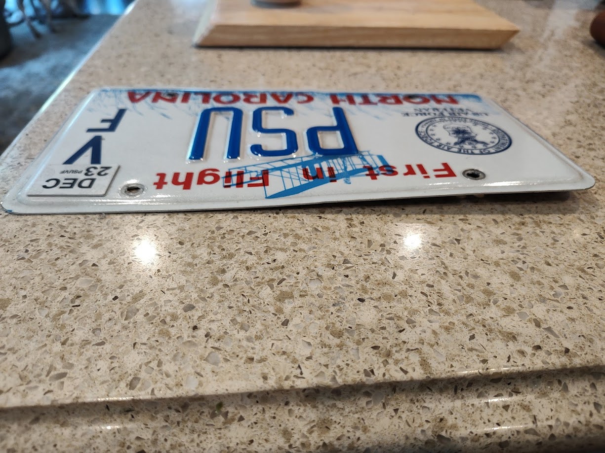

The problem is not the tape. When I worked in the automotive industry we stuck everything on with that tape (always with promoter though). The problem is the twisted NC plates. I can't figure out how to straighten it. I tried weights and trying to bend it in the opposite direction but I probably just made it worse. Any tips on how to straighten a plate would be helpful.larry wrote: Mon Sep 11, 2023 9:00 amMike, I've had 2 sets of these and never had any issues with them detaching. I do clean the adhesion areas with an appropriate cleaner and I have used 3M adhesion promoter in some cases. But I can assure you that the tape being used will work reliably. We even use the same tape to attach our dive planes. The only time those come loose is when someone decides to remove a cone from the track.maddmike wrote: Mon Sep 11, 2023 8:51 am I am about to give up on mine and drill my bumper. One or two corners constantly come off. I have tried washers, additional layers of tape to add thickness, and may try 3M adhesive but don't want to mess up my paint. I hate to drill my bumper but at this point every time I drive I'm afraid that I am going to lose my plate.![]()

maddmike wrote: Mon Sep 11, 2023 9:05 amThe problem is not the tape. When I worked in the automotive industry we stuck everything on with that tape (always with promoter though). The problem is the twisted NC plates. I can't figure out how to straighten it. I tried weights and trying to bend it in the opposite direction but I probably just made it worse. Any tips on how to straighten a plate would be helpful.larry wrote: Mon Sep 11, 2023 9:00 amMike, I've had 2 sets of these and never had any issues with them detaching. I do clean the adhesion areas with an appropriate cleaner and I have used 3M adhesion promoter in some cases. But I can assure you that the tape being used will work reliably. We even use the same tape to attach our dive planes. The only time those come loose is when someone decides to remove a cone from the track.maddmike wrote: Mon Sep 11, 2023 8:51 am I am about to give up on mine and drill my bumper. One or two corners constantly come off. I have tried washers, additional layers of tape to add thickness, and may try 3M adhesive but don't want to mess up my paint. I hate to drill my bumper but at this point every time I drive I'm afraid that I am going to lose my plate.![]()

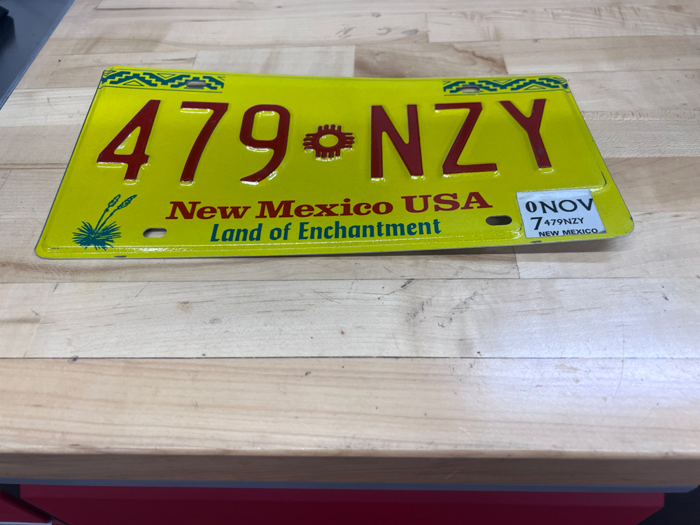

Thanks for clarifying that Mike! I ran out and snapped a picture of a twisted plate and was going to suggest you check yours on a table for flatness. I've had a few people report the mounts coming loose over the years and I think in every single case it is because the plate isn't flat. You can see in the picture how the plate warps up in one or two corners, which creates a constant pull on that mount. The tape is interesting. If you try to pull it off all at once, it will practically pull the bumper off before coming loose. If the plate pulls on it gently for months, combined with the vibrations of driving, it will eventually pull apart.
I'd say use heat on it, but enough heat to break down the metal memory would burn the painted side I assume. Hammering strategically can break the metal memory, but that's a skill metal workers spend years mastering. I'd sit at the kitchen table and keep twisting and bending until all 4 corners sit flat. The problem with giving up is that the same twist/pull will now be working to strip the holes you drill. What would happen if you turned yours in as damaged or lost it outright and asked for a replacement? Any change you have a flat front plate you could repurpose to the rear?

That's bizarre that NC plates are so twisted but it's probably not all that uncommon elsewhere too. I've certainly seen twisted plates.maddmike wrote: Mon Sep 11, 2023 9:05 amThe problem is not the tape. When I worked in the automotive industry we stuck everything on with that tape (always with promoter though). The problem is the twisted NC plates. I can't figure out how to straighten it. I tried weights and trying to bend it in the opposite direction but I probably just made it worse. Any tips on how to straighten a plate would be helpful.larry wrote: Mon Sep 11, 2023 9:00 amMike, I've had 2 sets of these and never had any issues with them detaching. I do clean the adhesion areas with an appropriate cleaner and I have used 3M adhesion promoter in some cases. But I can assure you that the tape being used will work reliably. We even use the same tape to attach our dive planes. The only time those come loose is when someone decides to remove a cone from the track.maddmike wrote: Mon Sep 11, 2023 8:51 am I am about to give up on mine and drill my bumper. One or two corners constantly come off. I have tried washers, additional layers of tape to add thickness, and may try 3M adhesive but don't want to mess up my paint. I hate to drill my bumper but at this point every time I drive I'm afraid that I am going to lose my plate.![]()

It is no way as warped as that plate and almost sits flat on the table. However, one corner comes up immediately as in 20 minutes after I apply it.blueline wrote: Mon Sep 11, 2023 9:35 amThat's bizarre that NC plates are so twisted but it's probably not all that uncommon elsewhere too. I've certainly seen twisted plates.maddmike wrote: Mon Sep 11, 2023 9:05 amThe problem is not the tape. When I worked in the automotive industry we stuck everything on with that tape (always with promoter though). The problem is the twisted NC plates. I can't figure out how to straighten it. I tried weights and trying to bend it in the opposite direction but I probably just made it worse. Any tips on how to straighten a plate would be helpful.larry wrote: Mon Sep 11, 2023 9:00 am

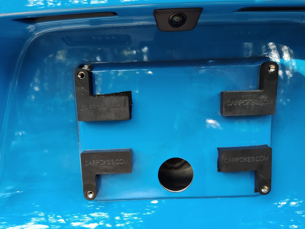

Here you can see where I doubled up the tape to try to help alleviate the stress since the washer trick didn't work and I figured that was adding more weight to the plate. I know my taping is sloppy, it was neater before but I got tired.

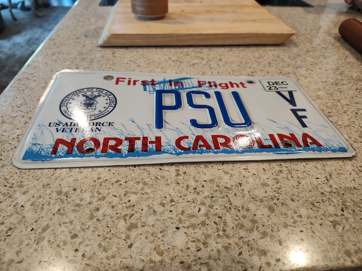

Here is my plate. Try as I might, the upper left and lower right corners will twist opposite of each other. I'm thinking that maybe the fact that it only has three letters may have made the stamping pressure uneven and caused the plate to twist the way it did.
