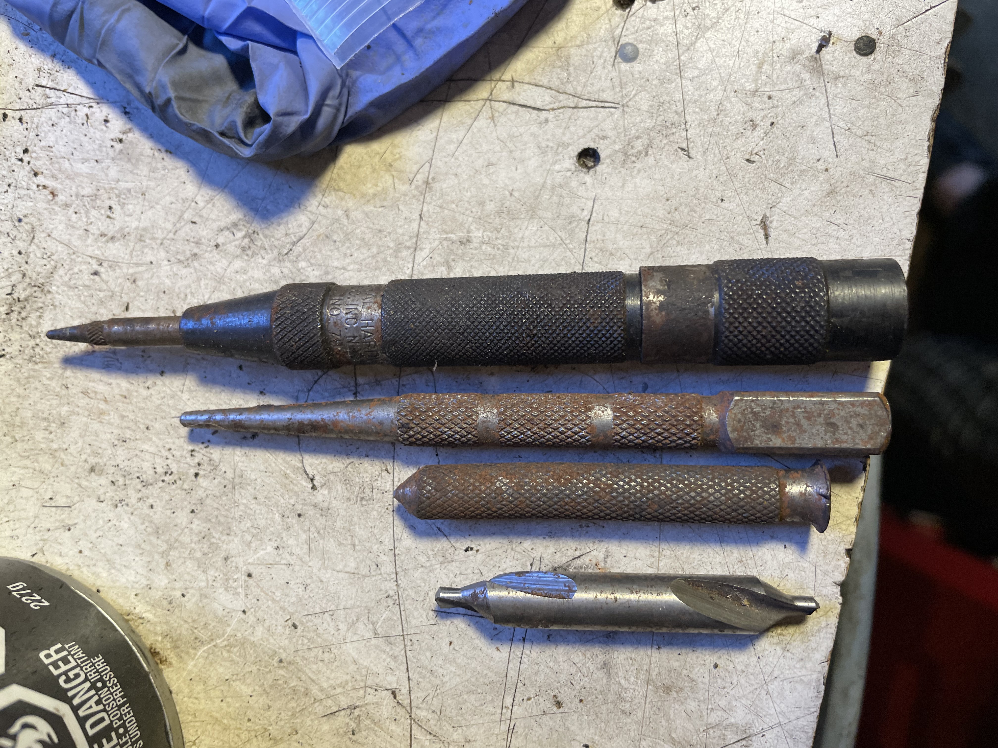

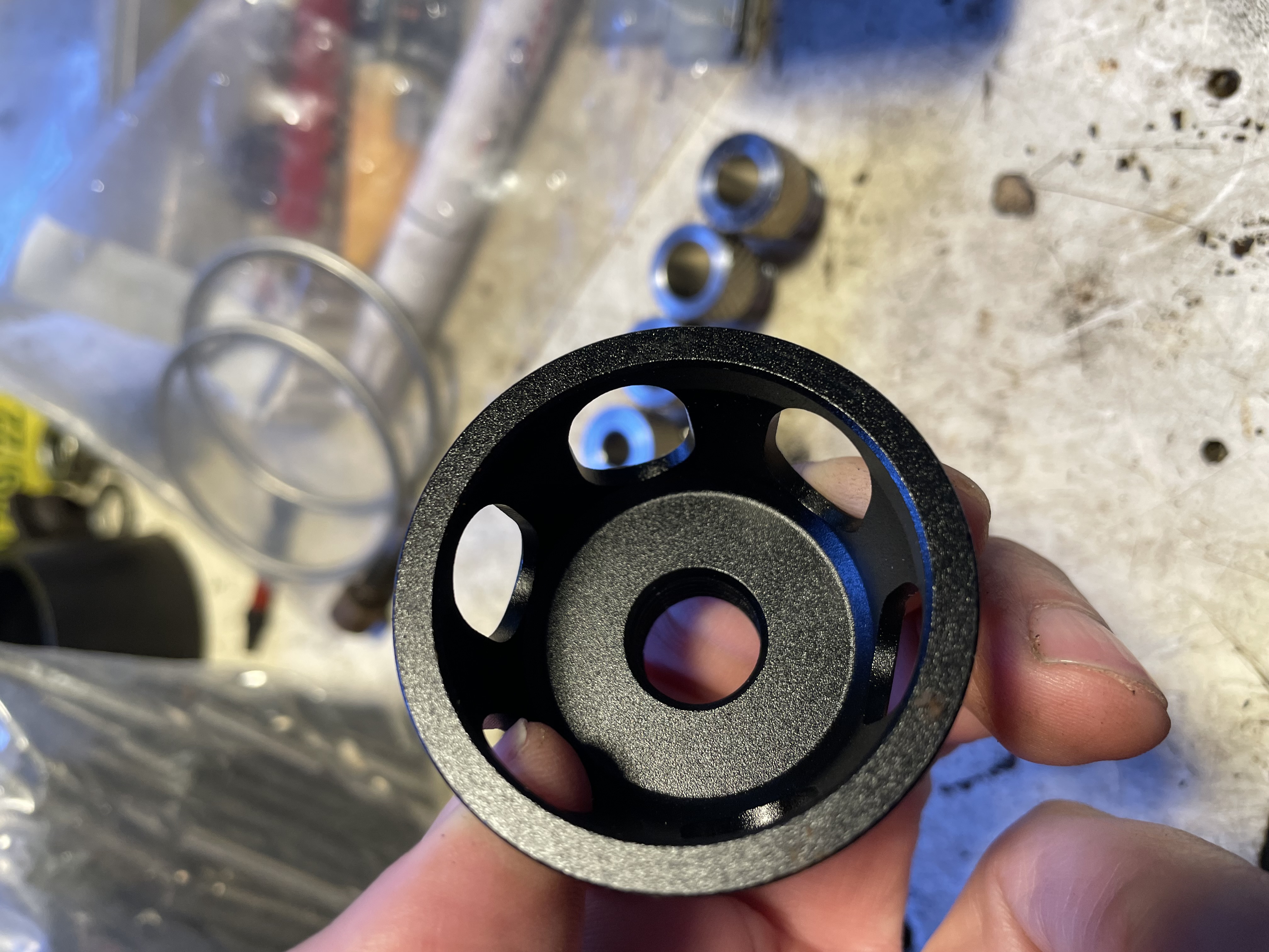

These are my punches and pilot bit.. not sure if any of these are what is referred to above?

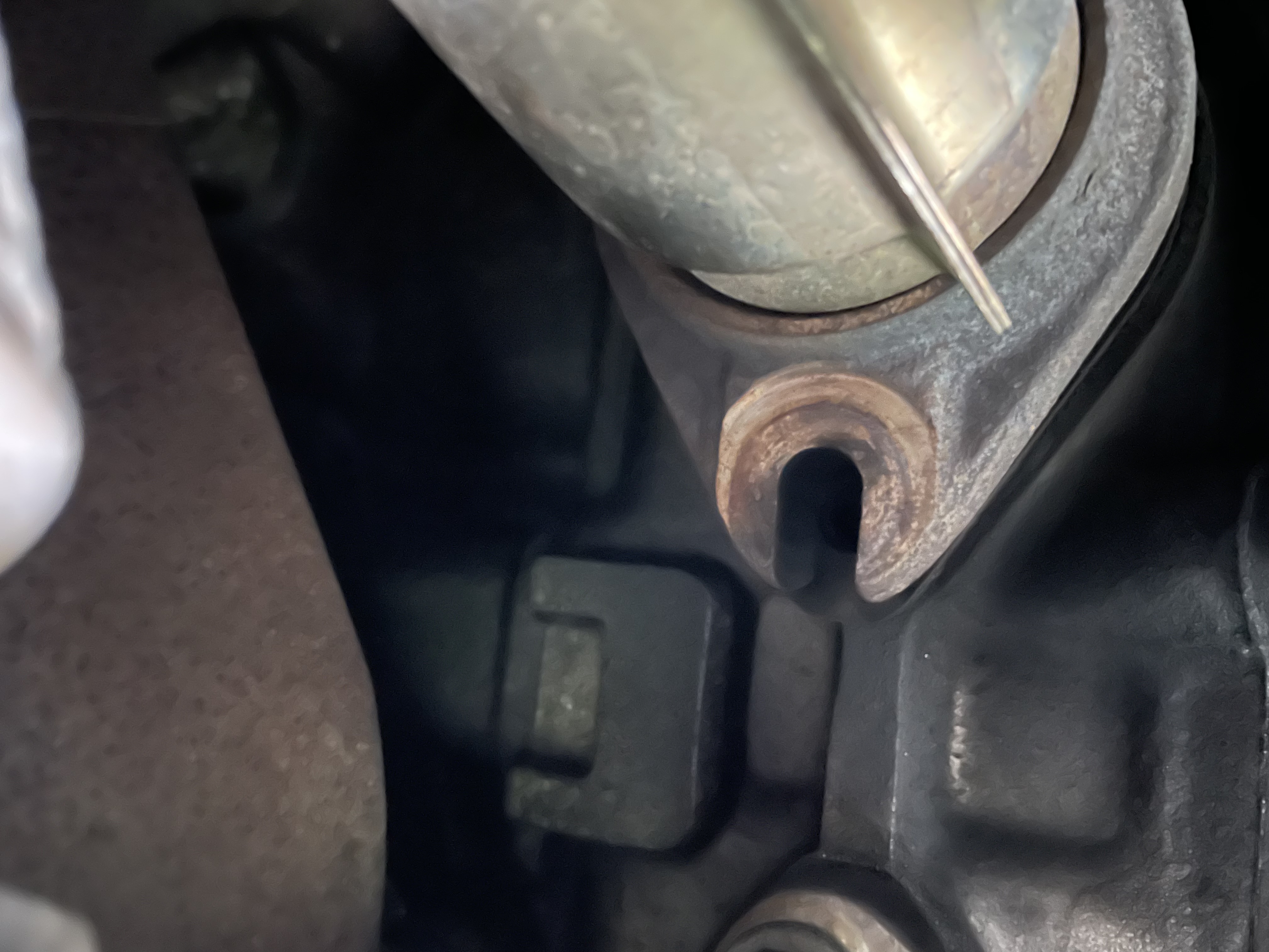

Tom, the stud in question would be #3
I thought maybe I could just use the manifold as a guide somehow but this one is a slot not a hole

Got it, will post a drill jig soon. I'll get the measurements and such off my spares. :) Given the challenge of your situation, I'm thinking the jig should accommodate steel drill bushing of at least a couple of sizes, so you can start by trying a smaller reverse bit to see if the remaining stud will break free and turn out. But you may need to install a helicoil -- some broken studs make preserving the original aluminum thread virtually impossible.

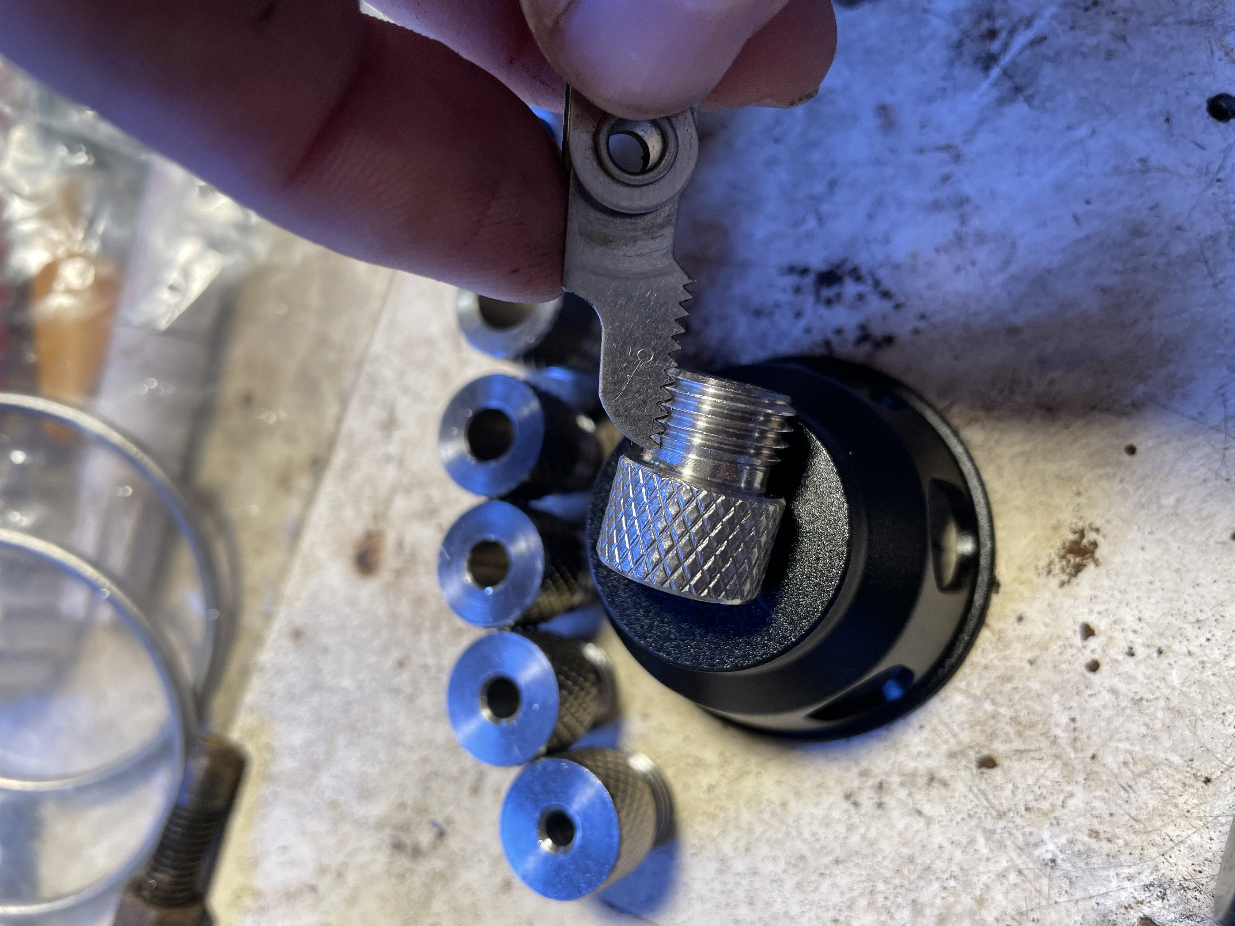

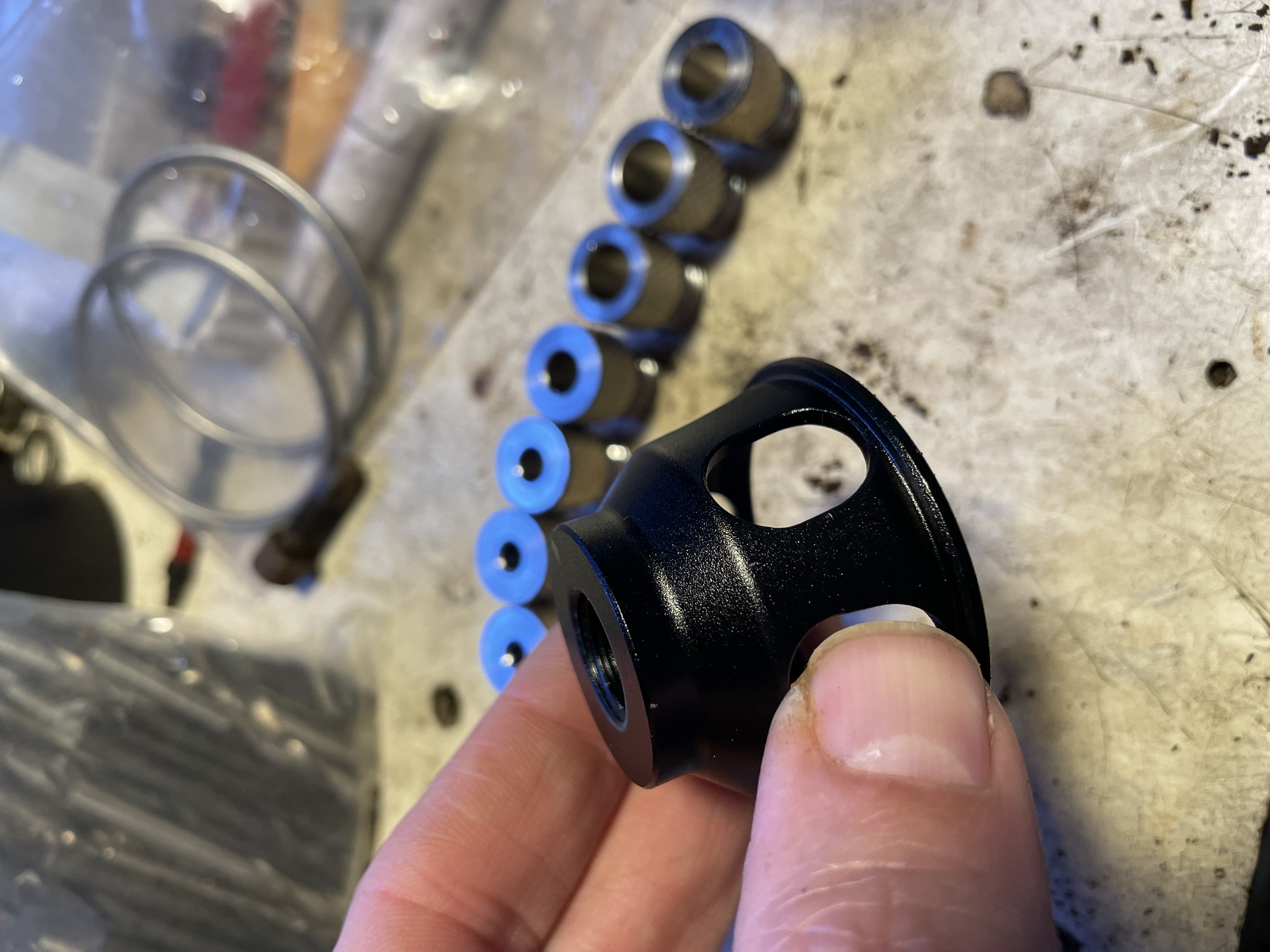

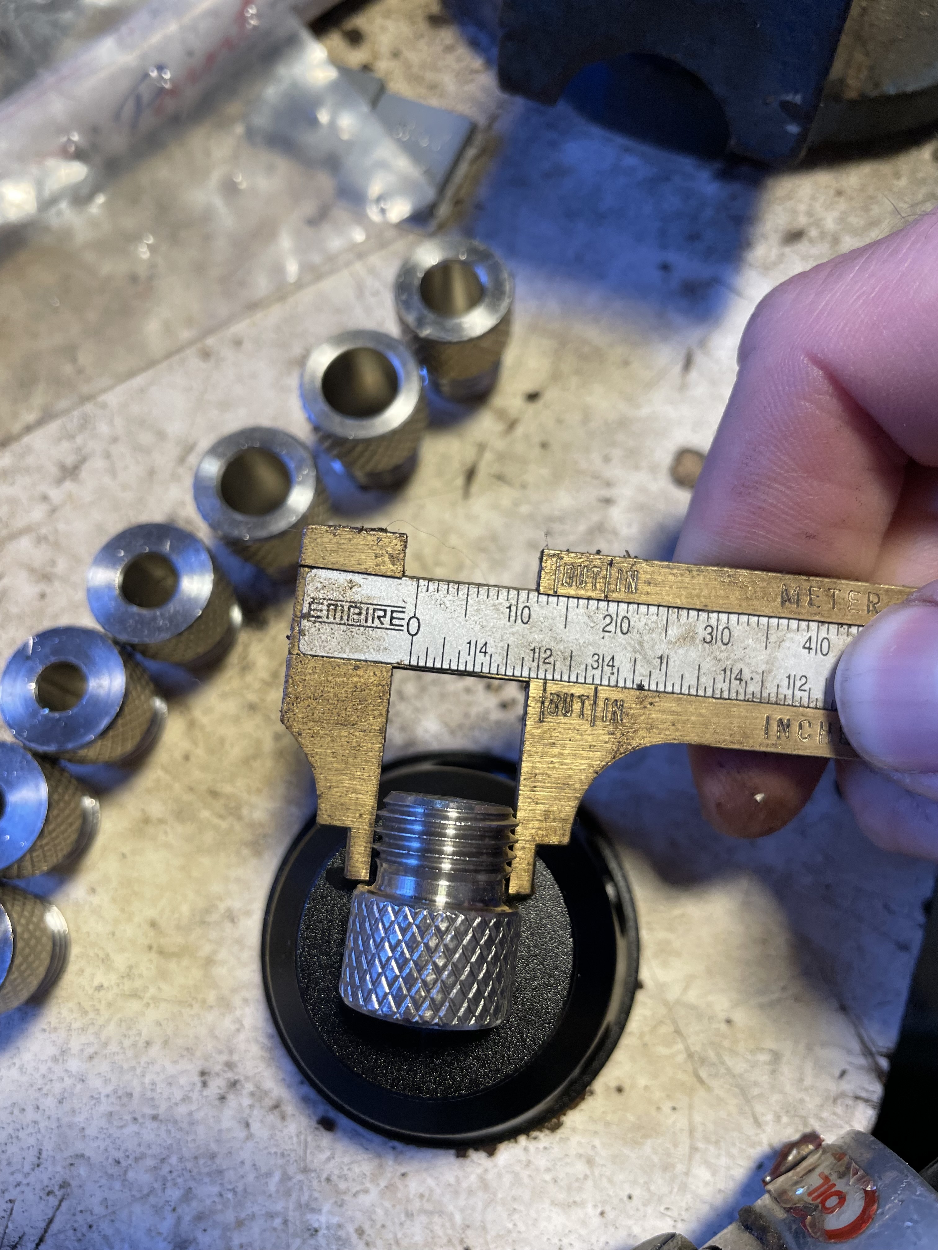

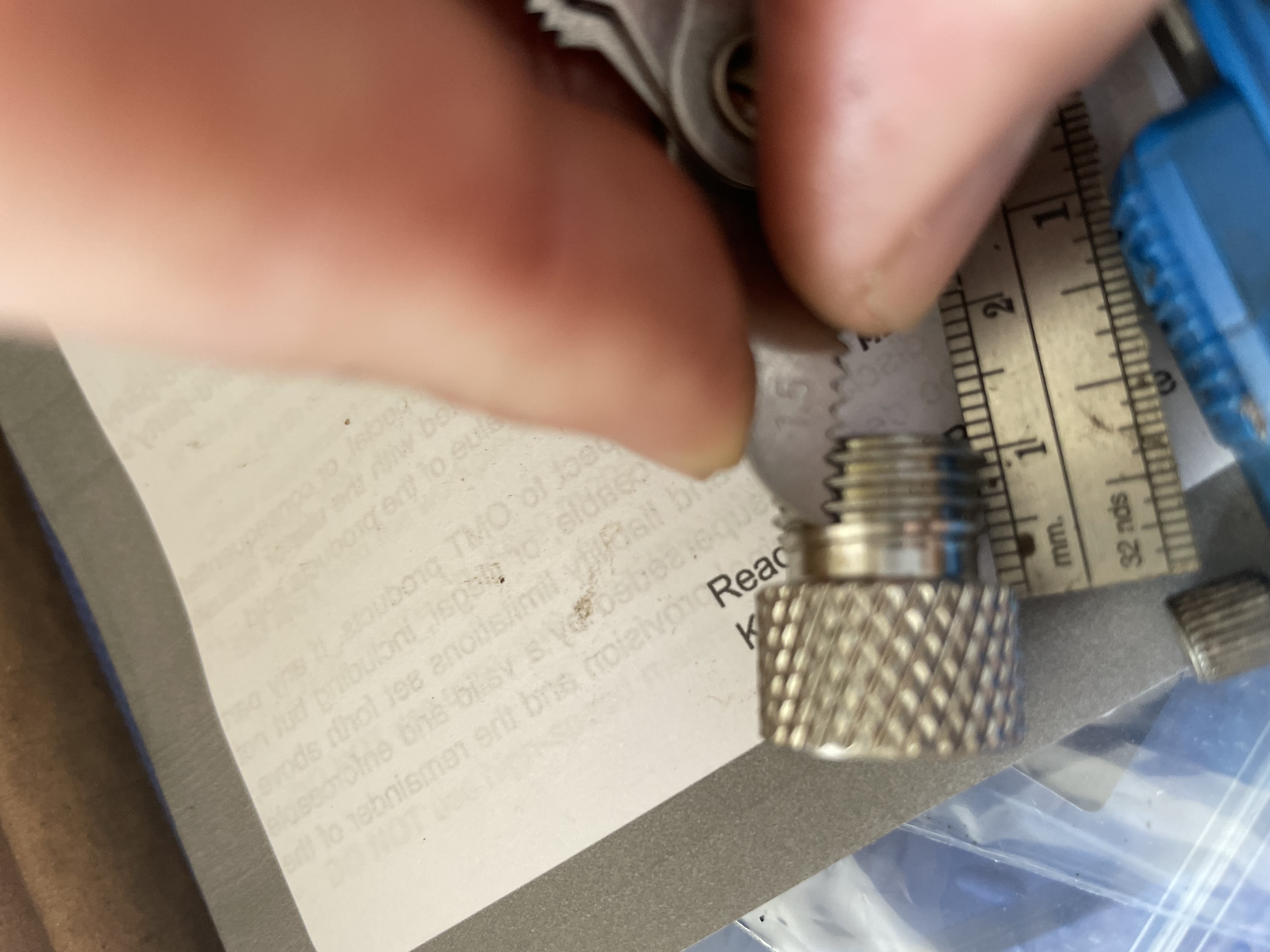

I'm not good at reading these things.. the threaded bit guides are 1/2"? The pitch is definitely 1.5
Not sure if the jig they fit into is of any use

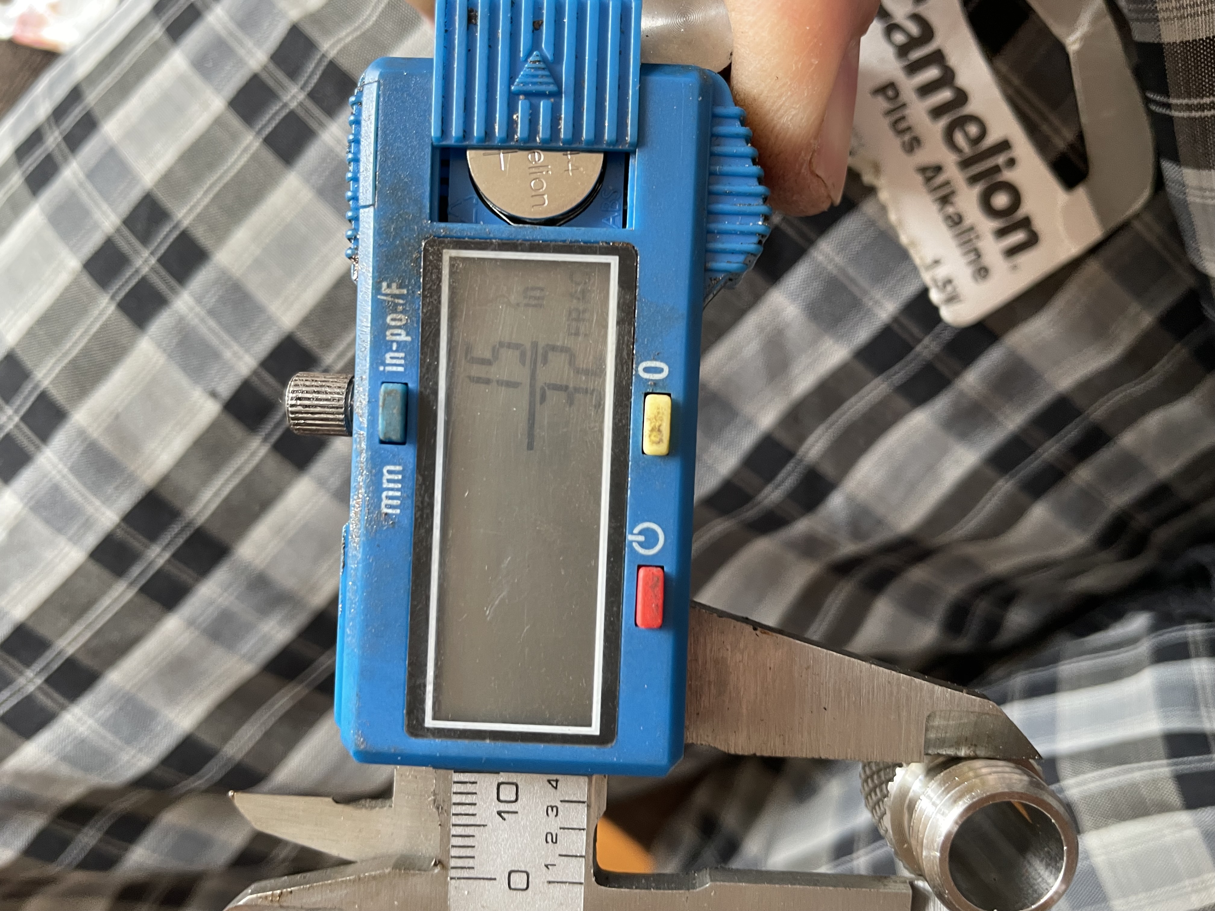

Your calliper is reading 17/32" (13.5mm), which doesn't make much sense.
Are the bit guides metric or SAE?

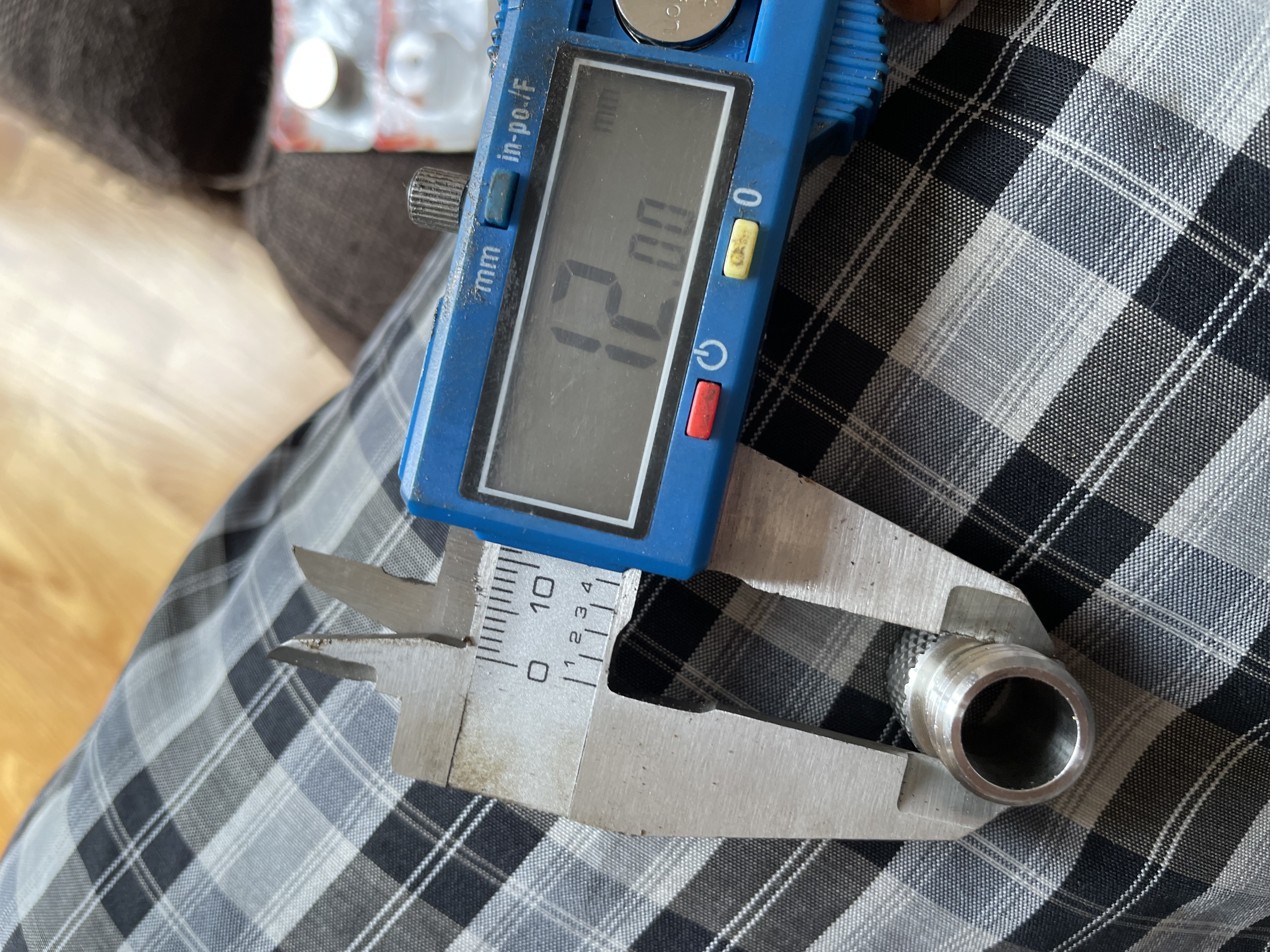

I pulled out the digital caliper with a fresh battery... makes more sense now
Looks like M14
On imperial setting...
Above are both 'shaft' and thread measurements
As for pitch... both 1.5 and SAE 18 fit nicely
I feel M14 x 1.5 will suffice
Just came from two hardware stores where M14 only comes in 2.00 pitch
#25

9/16"-18 is UNF. M14 does have a fine-pitch spec (at 1.5mm), but it's not very common.
My bet would be on 9/16" UNF.

Try screwing one into a 944 lug nut. They happen to be M14 x 1.5 :shifty:
#27
danmartinic
Posts: 293
Has thanked: 24 times
Been thanked: 42 times
Bingo
