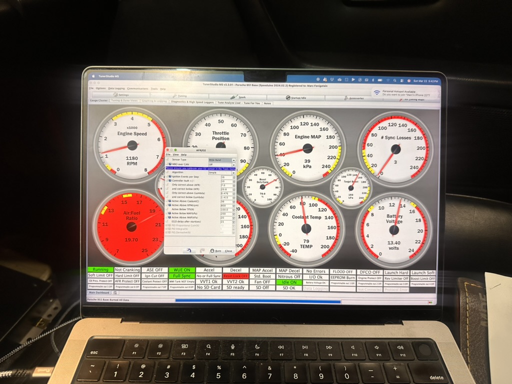

Thanks for the tip. So far everything I can verify reads appropriately, except for the WB 02.
- TPS calibrated and shows 0 - 100 through pedal travel
- IAT (still the AFM integrated unit) reads correct ambient at engine off. Don't have a way to to verify across it's range, but am using the BMW E30 325 preset calibration per ClassicECUs instruction.
- MAP is reading about 100kpa at engine off, ~20kPa (edit: 40kPa) at idle, and tables have been factored up to 200kpa (100kpa) though I've still not run the engine off idle.
- Timing at 10 deg (current idle setting) verified
Got the WB and IAT bungs welded in on Saturday, and wired in the WB via the 14point7 Spartan 2 Lite v3. And I was getting readings of max lean, so tested my signal lead coming from the Spartan and it reads over 8V! It should signal 5V at max lean / engine off and 0V at max rich (linear in between). I tested it with the sensor unplugged per troubleshooting to confirm and got the same 8V - so sent a note to Spartan to see if I got a faulty unit. Everything else will have to wait until that's resolved. Internet search didn't turn up anyone else having this problem, so stay tuned, I guess...
I believe I wired it properly, but could use an error check:
Engine Harness <--> Spartan
NB power (switched, engine running) <---> Power (red)
NB ground <---> Electronics Ground (black)
NB signal <---> Linear Output (green)
Chassis ground <---> heater ground (white)
Other wires unused (Sim NB Output, LED Output, RX/TX interface)

“- MAP is reading about 100kpa at engine off, ~20kPa”
This caught my attention. My car idles at ~40 kpa. From what I’ve read seems my idle kpa (vacuum) is a little on the high side which might indicate a vacuum leak. I’ll need to investigate.
Your ~20 kpa idle is very good. I’m curious what others are seeing for their idle MAP?
Edit: I have a cone filter after deleting the AFM and stock airbox. Would that account for the higher MAP idle reading?

944m3 wrote: Tue Mar 24, 2026 6:48 am “- MAP is reading about 100kpa at engine off, ~20kPa”
Sorry, you're correct. Brainfart on my part - it's idling at 40kPa on the nose. You can see in my earlier screenshot, 3rd gauge in top row.
