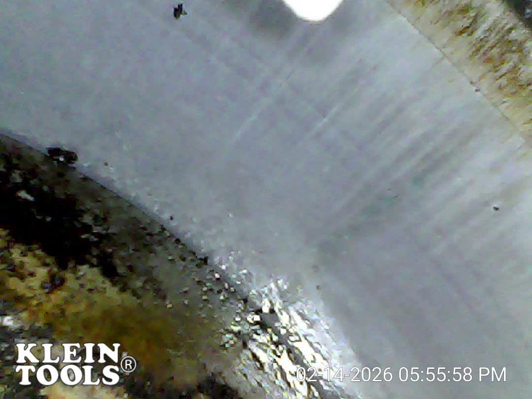

Well I took a look into my cylinders to find this
That streak down the cylinder wall is coolant puddling on top of the piston, there’s my smoking gun.

Poorsche44 wrote: Sat Feb 14, 2026 8:21 pm Well I took a look into my cylinders to find this8647468375765905512.jpeg
Well, shoot. At least now you know. :(

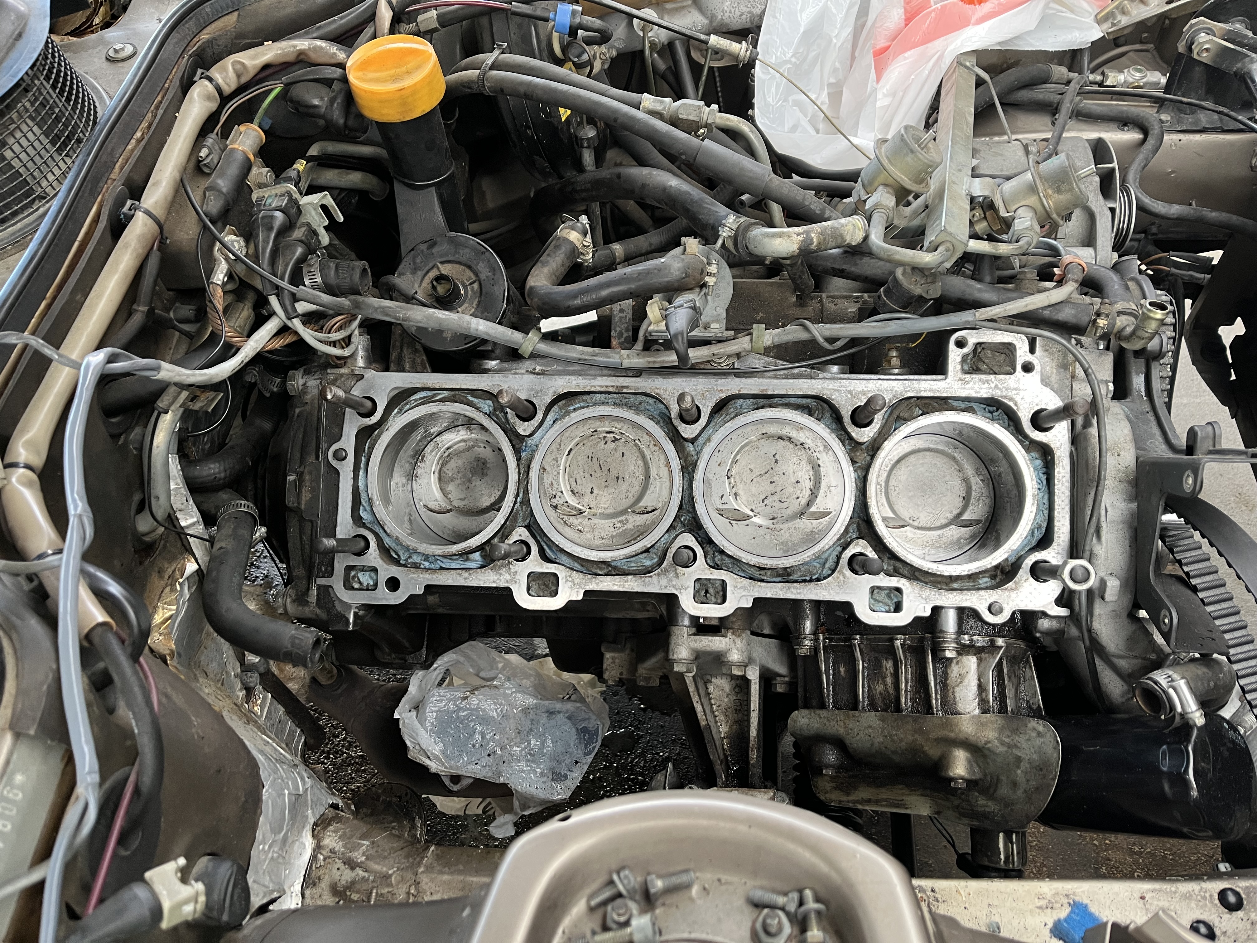

I’m going to look into with a scope today while having the coolant pressure tested hooked up to see. Since mine is an early model I followed the 15-37-66 lbft torque spec waiting 15 minutes between each stage. I didnt inspect the block for flatness and noticed some discolored/slighty rusty parts of the block, but I had no way of cleaning it without removing metal. I started with blue scotchbrite and eventually used a brass brush but some visual defects remained. I know this isn’t a scientific method but I did feel the entire surface and it was smooth. I’m also fairly confident the issue isn’t with my thermoswitch as I replaced it a few months ago. Here’s a photo of what the block looked like before I bolted everything back together

Do you motorsports the car? You wont really need something better than stock for everyday driving. Better fans go a long way too- but I would definitely start by figuring out if the radiator less efficient than it should be. Are your fans operating correctly? I don't have an early car, but the fan speed resistor wiring is ALWAYS trash and you may just be running on low speed fan and not getting the high speed fans.

Poorsche44 wrote: Sun Mar 08, 2026 11:12 am I’m going to look into with a scope today while having the coolant pressure tested hooked up to see. Since mine is an early model I followed the 15-37-66 lbft torque spec waiting 15 minutes between each stage. I didnt inspect the block for flatness and noticed some discolored/slighty rusty parts of the block, but I had no way of cleaning it without removing metal. I started with blue scotchbrite and eventually used a brass brush but some visual defects remained. I know this isn’t a scientific method but I did feel the entire surface and it was smooth. I’m also fairly confident the issue isn’t with my thermoswitch as I replaced it a few months ago. Here’s a photo of what the block looked like before I bolted everything back together
Emory cloth and a brick next time :)
