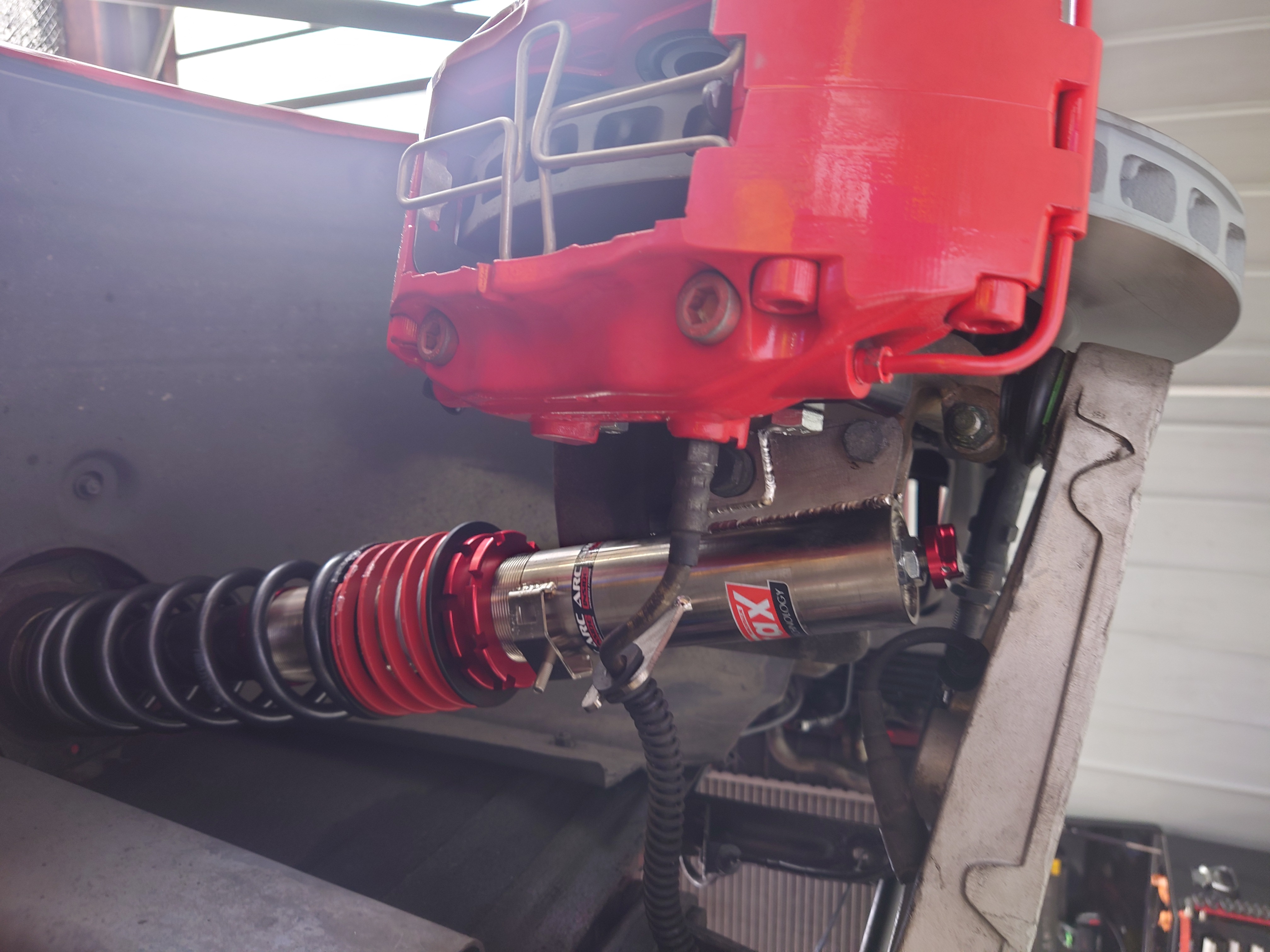

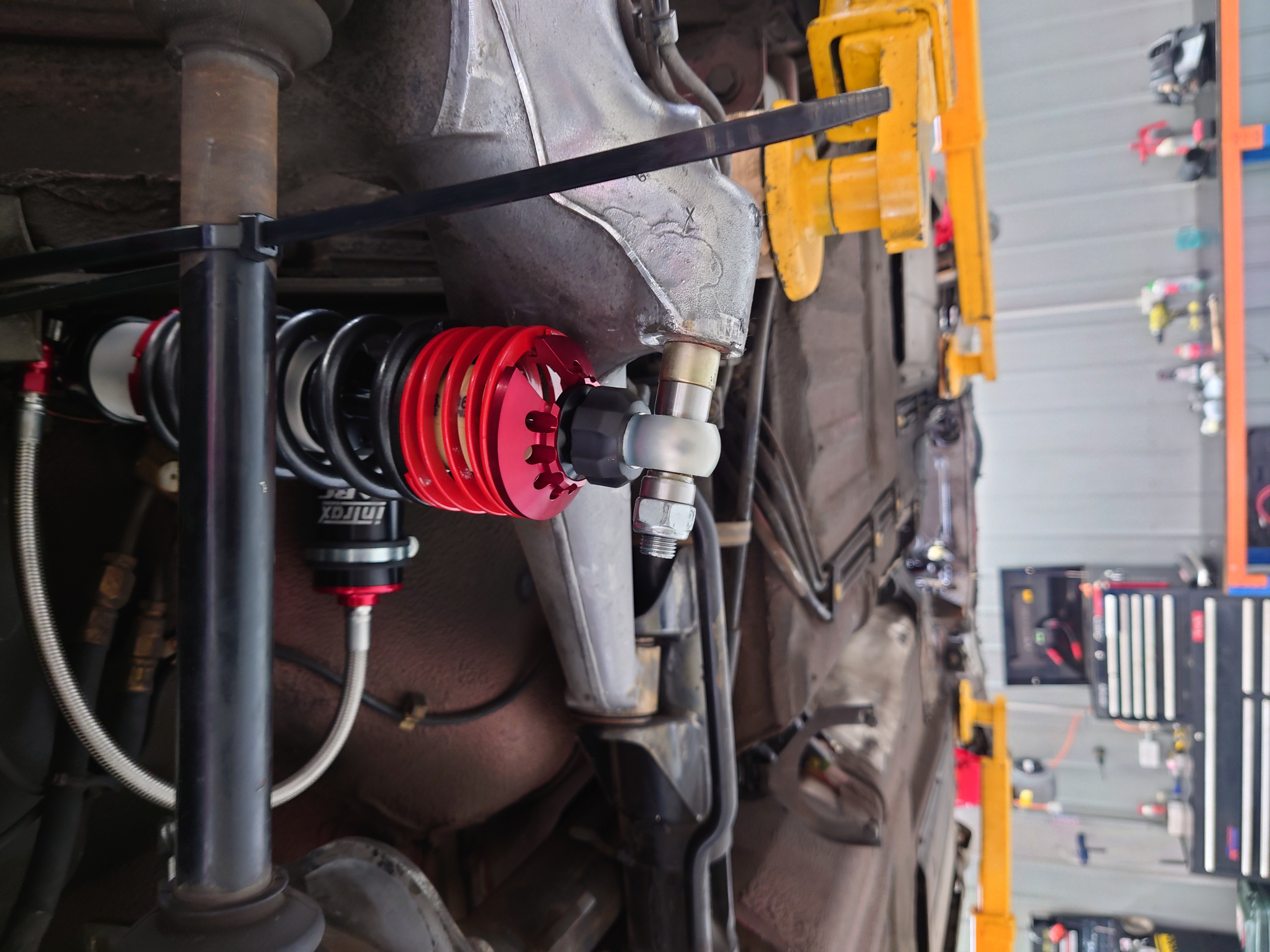

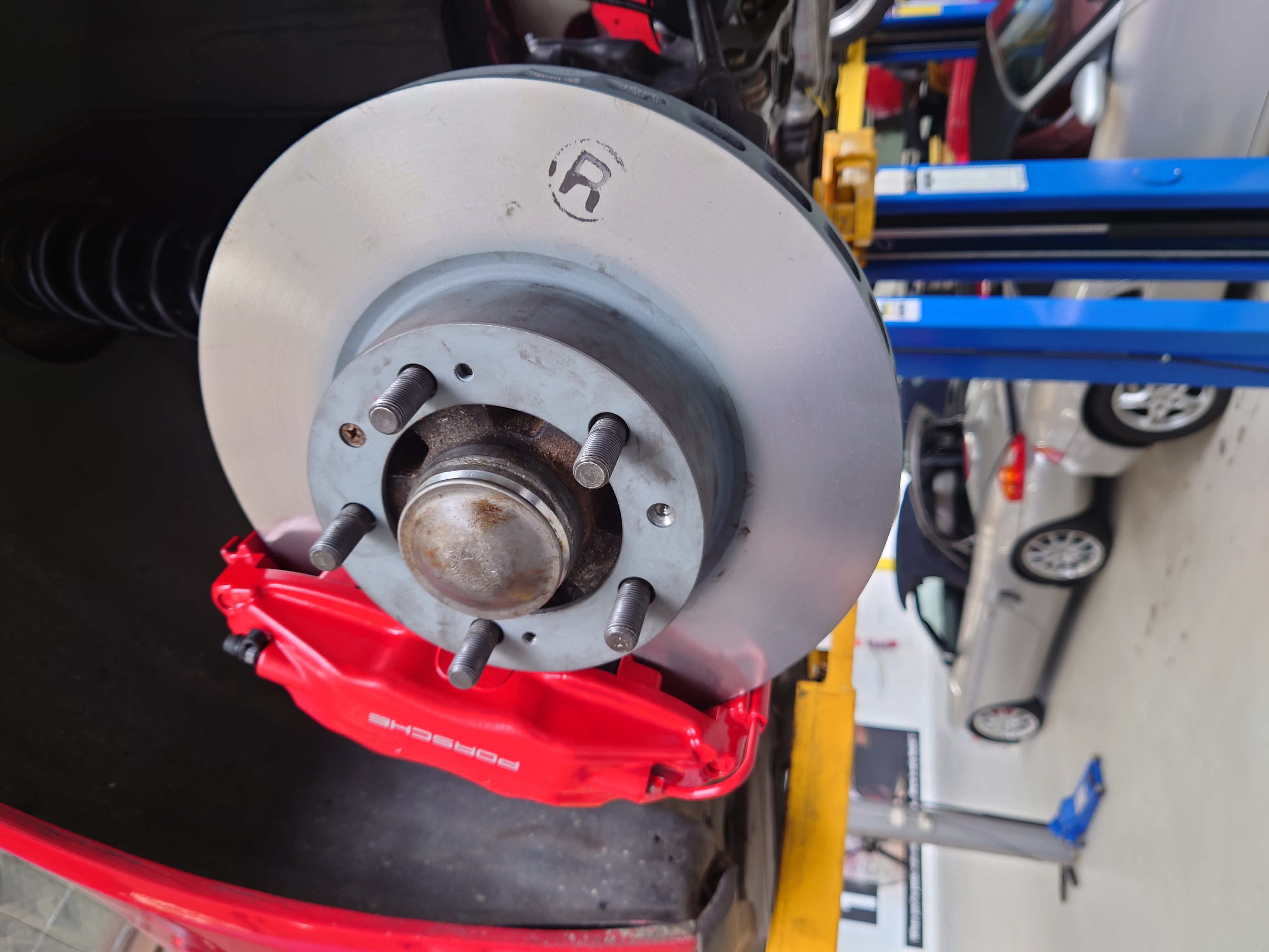

Intrax custom suspension(K2 with ARC and Black Titan finish) and big reds fitted

That's a very nice-looking setup. The lower rear stud/nut attachment is interesting. I assume those are 928 GTS rotors? If you need brake pads for DE I have a new set of Pagid Orange.Cyberpunky wrote: Sun Jun 19, 2022 11:41 pm Intrax custom suspension(K2 with ARC and Black Titan finish) and big reds fitted

Agreed -- looks great and interesting rear mounting hardware. Seems to extend it out a bit? I love my KW's but they supply a pretty cheap looking bolt for the bottom of the rear shocks -- so much so that I (and others) tend to replace them with 12.9 bolts from Bell Metric.... Can I ask what these cost? My only other 'con' about the KW's was the cost....Latitude48 wrote: Mon Jun 20, 2022 6:47 pmThat's a very nice-looking setup. The lower rear stud/nut attachment is interesting. I assume those are 928 GTS rotors? If you need brake pads for DE I have a new set of Pagid Orange.Cyberpunky wrote: Sun Jun 19, 2022 11:41 pm Intrax custom suspension(K2 with ARC and Black Titan finish) and big reds fitted

Yes 928 GTS rotors. I am down under Tom, so shipping is brutal but thanks for the offerLatitude48 wrote: Mon Jun 20, 2022 6:47 pmThat's a very nice-looking setup. The lower rear stud/nut attachment is interesting. I assume those are 928 GTS rotors? If you need brake pads for DE I have a new set of Pagid Orange.Cyberpunky wrote: Sun Jun 19, 2022 11:41 pm Intrax custom suspension(K2 with ARC and Black Titan finish) and big reds fitted

I ticked all the option box's so it ended up about 4990 euro(trying to forgetTom wrote: Mon Jun 20, 2022 7:50 pmAgreed -- looks great and interesting rear mounting hardware. Seems to extend it out a bit? I love my KW's but they supply a pretty cheap looking bolt for the bottom of the rear shocks -- so much so that I (and others) tend to replace them with 12.9 bolts from Bell Metric.... Can I ask what these cost? My only other 'con' about the KW's was the cost....Latitude48 wrote: Mon Jun 20, 2022 6:47 pmThat's a very nice-looking setup. The lower rear stud/nut attachment is interesting. I assume those are 928 GTS rotors? If you need brake pads for DE I have a new set of Pagid Orange.Cyberpunky wrote: Sun Jun 19, 2022 11:41 pm Intrax custom suspension(K2 with ARC and Black Titan finish) and big reds fitted

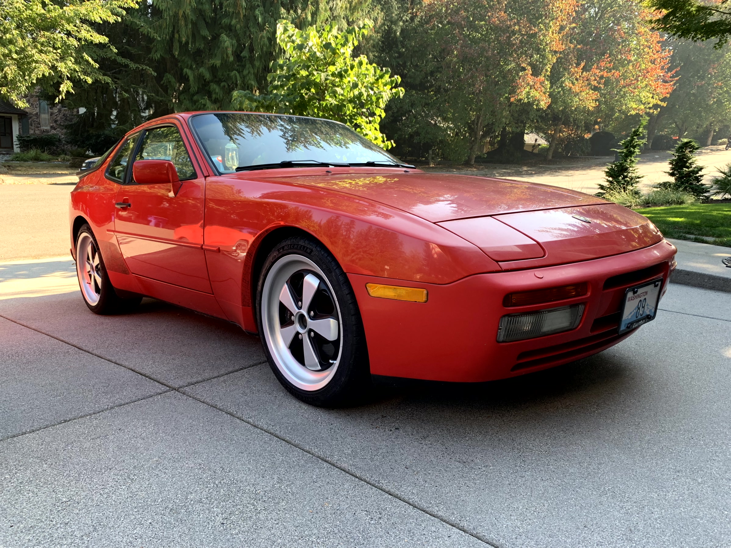

Here's a quick pic of the 18x8, ET52 and 18x10, ET65 Fuchs forged wheels with Michelin PIlot Sport 4S tires, 225/40 and 265/35. Not sure what center caps I'll be using. I have a set of really nice silver painted metal Porsche caps with large colored Porsche crest, but the color may not look right since it's darker than the anodized finish. For now I may get the black set sold by Fuchs as shown below.

Didn't I buy those from you?Latitude48 wrote: Thu Oct 13, 2022 5:37 pm I have a set of really nice silver painted metal Porsche caps with large colored Porsche crest, but the color may not look right since it's darker than the anodized finish.
edit: wheels look awesome by the way!

Yes Tom, they are the same as the set you purchased. I bought these for my son when he owned the 951. They were on some 17" 996 twist wheels that I'm selling to my local shop.Tom wrote: Thu Oct 13, 2022 7:26 pmDidn't I buy those from you?Latitude48 wrote: Thu Oct 13, 2022 5:37 pm I have a set of really nice silver painted metal Porsche caps with large colored Porsche crest, but the color may not look right since it's darker than the anodized finish.
