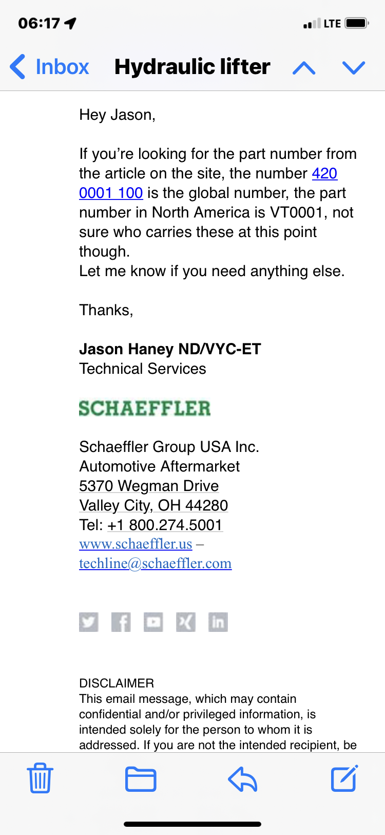

Here is some info that will help people track down lifters.
The VT0001 part number for North America.
