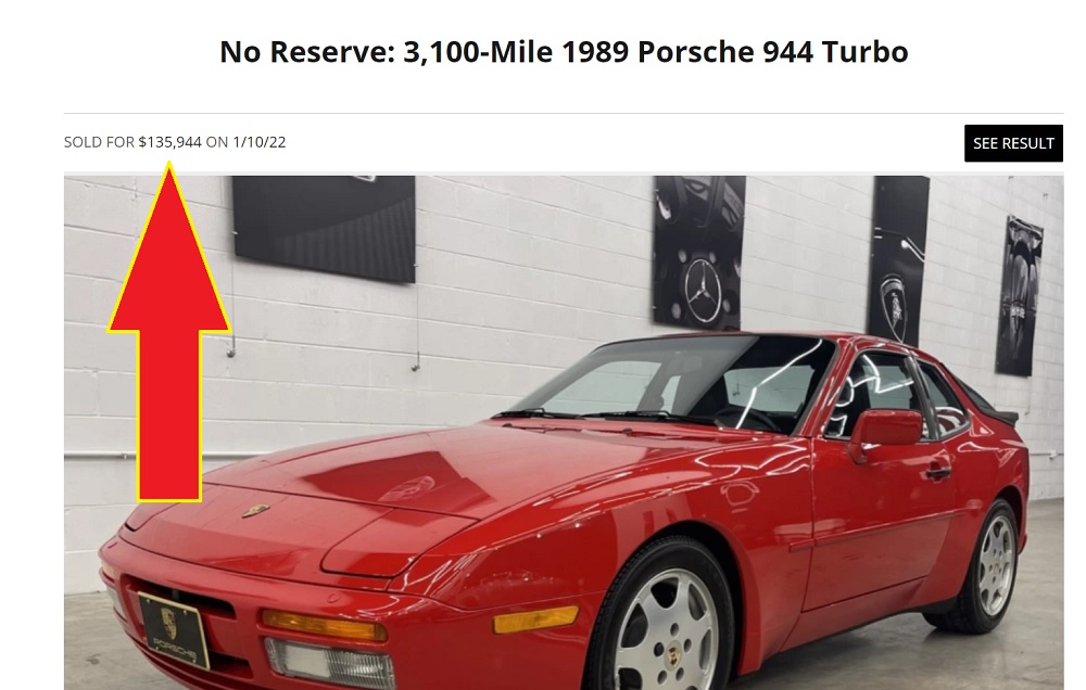

So... this just happened.
I have a feeling we're not in Kansas anymore. :clap: :crazy: :shock:

Yes nice bid amount "944" (though the earlier 12x,951 was savvier)

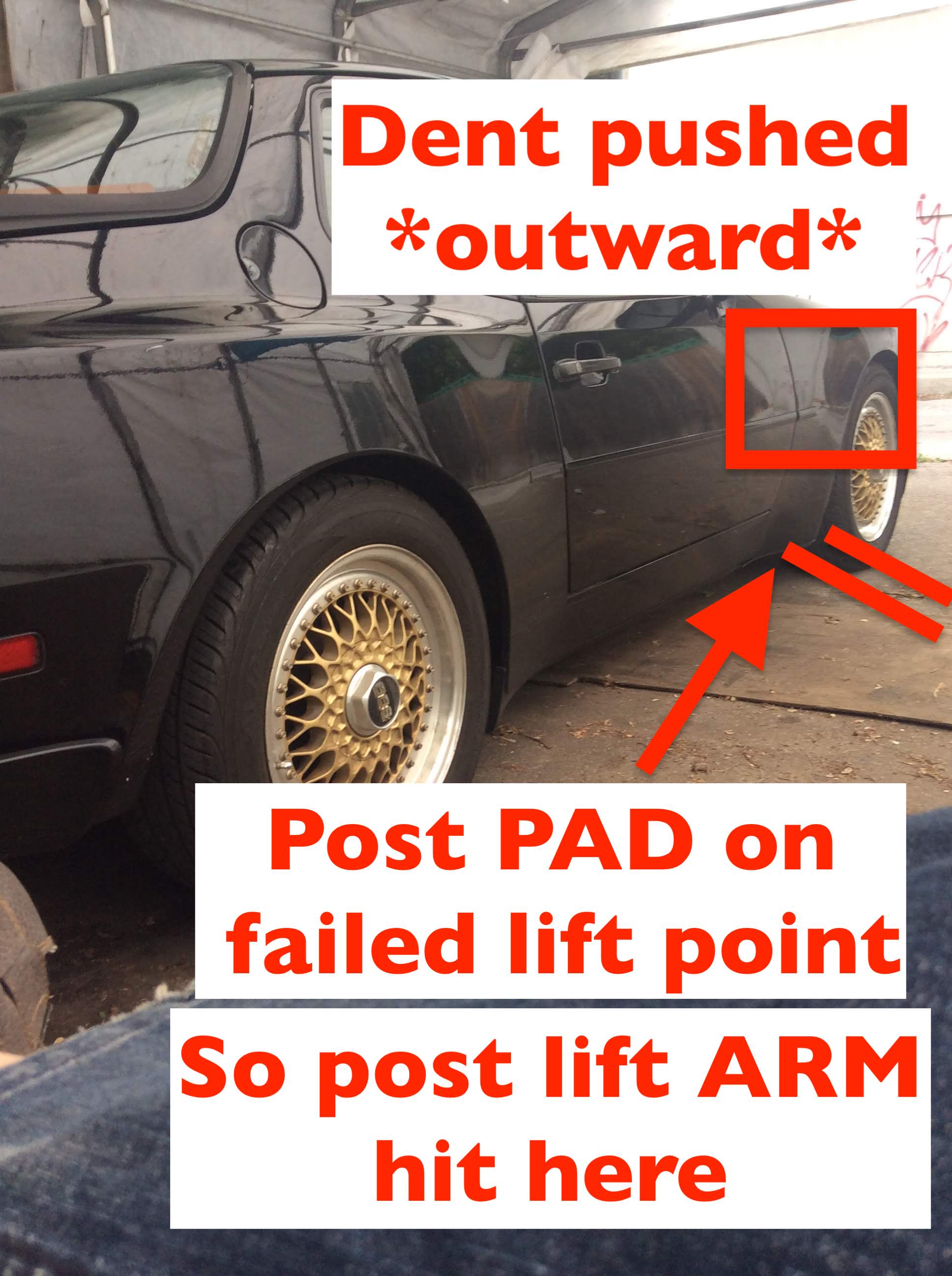

FYI my front round "lift spots" are both equally bent up and the shop lift arms were clearly placed there as their arms as the car was left supported by the actual arms lifting on the bottom of the fender
It's very frustrating lifting the 944 up front

On my car, it's clear a pervious garage used a post lift on the round "lift points" in front. They failed and the post arm ended up supporting the car--causing a bulging dent (pushed outward) on the fender. Both sides are identical
I would imagine a QuickJack could do the same (damage the lift point but not necessarily the fender :) )

Nasty pics though. I hope the shop paid for that!!! I'm guessing they did not use rubber lifting block and just put steel on steel, with predicable results. I once had a smog guy roll a steel floor jack under my car because he wanted to see the catalytic converter. I stopped him before he could dent the floor and got into an argument with him over it -- 99% sure he was trying to shake me down. I had to threaten to turn him in to get him to back off. Grr...
And yes by Rails I mean the rectangular unibody frame rails. Never used a quickjack so can't really comment. They work well for jack stands and my rolling bridge jack, when used with wood or rubber. On a car like the BAT car, I'm guessing they wanted to protect the plastic liner under the car, so loaded up on rubber pads using the collapsible lift spots.
