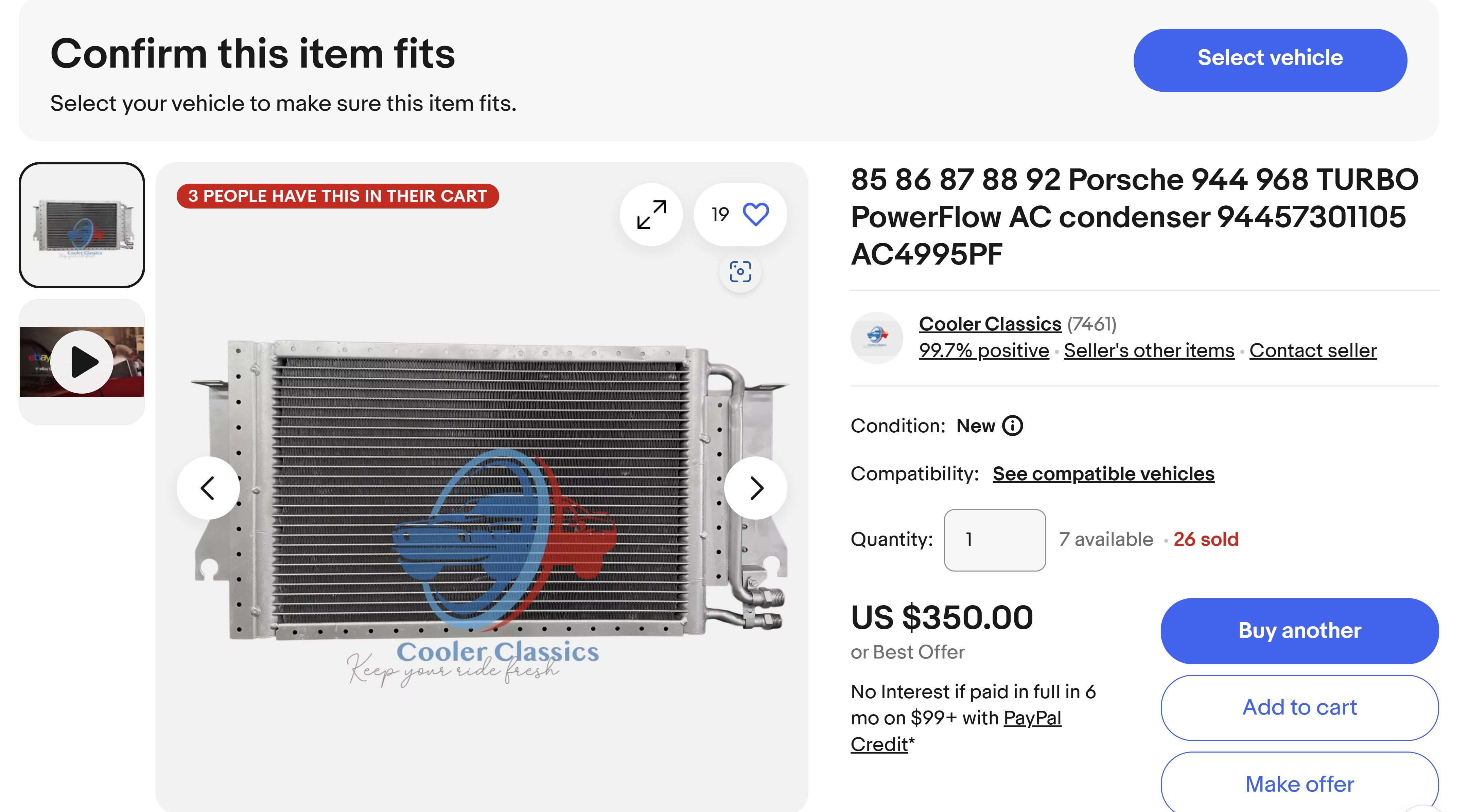

Hey Tom, your comment about how cold your vent temps are now made me look this condenser up in ebay. I was pretty surprised to see a picture of a fin and tube, and not a modern micro-channel condenser. Is this really what you received, a new fin and tube type condenser?
- Posts: 9090
- Has thanked: 952 times
- Been thanked: 4078 times
No, you can see it in post #7 above. Cooler Classics makes lots of coolers, so maybe you were looking at a different one? This is the one I got -- parallel flow...icb wrote: Sun Sep 15, 2024 9:12 am Hey Tom, your comment about how cold your vent temps are now made me look this condenser up in ebay. I was pretty surprised to see a picture of a fin and tube, and not a modern micro-channel condenser. Is this really what you received, a new fin and tube type condenser?
https://www.ebay.com/itm/266678393896?_ ... -ZA&edge=0

OK I see it now, Tom, thanks.

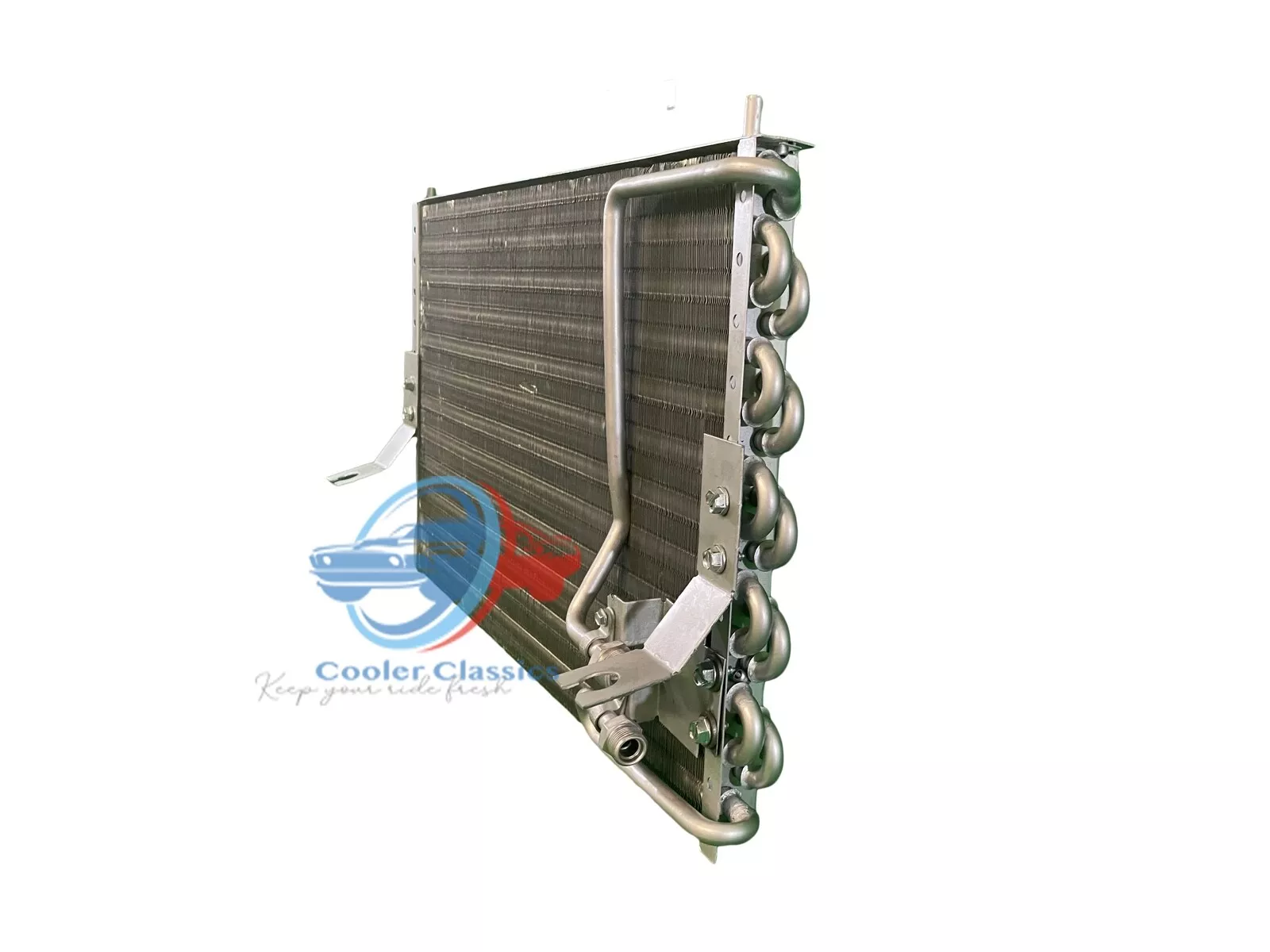

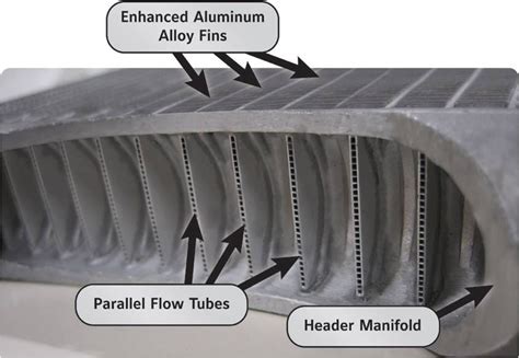

Very important for anyone else who wants to go this route - Be aware that there are three or four 944 type condensers available from this eBay store. You will want the one with "Powerflow" in the title. That is the parallel flow condenser. The other ones appear to be the older (R-12 era) tube & fin design. They won't be any more effective with R-134A as the OEM Porsche one is, which is not to say they're no good and won't work well, but it is a fact that the newer style of micro-channel parallel-flow condenser is just more efficient and will yield better results in terms of system efficiency, and will give you lower vent temperatures than a fin & tube design, given the exact same system otherwise. If you want the very best results, go with the parallel flow design. It was/is used by most OEM's for R134A, and now 1234-yf mobile AC systems.
This is the fin & tube model pictured below: And this is a cutaway view of a parallel flow, micro-channel condenser: As a side-note, the micro-channel construction is why most AC shops and technicians will tell you that it's pointless to try to flush one of these. Looking at the picture, it should be pretty obvious why that is so.

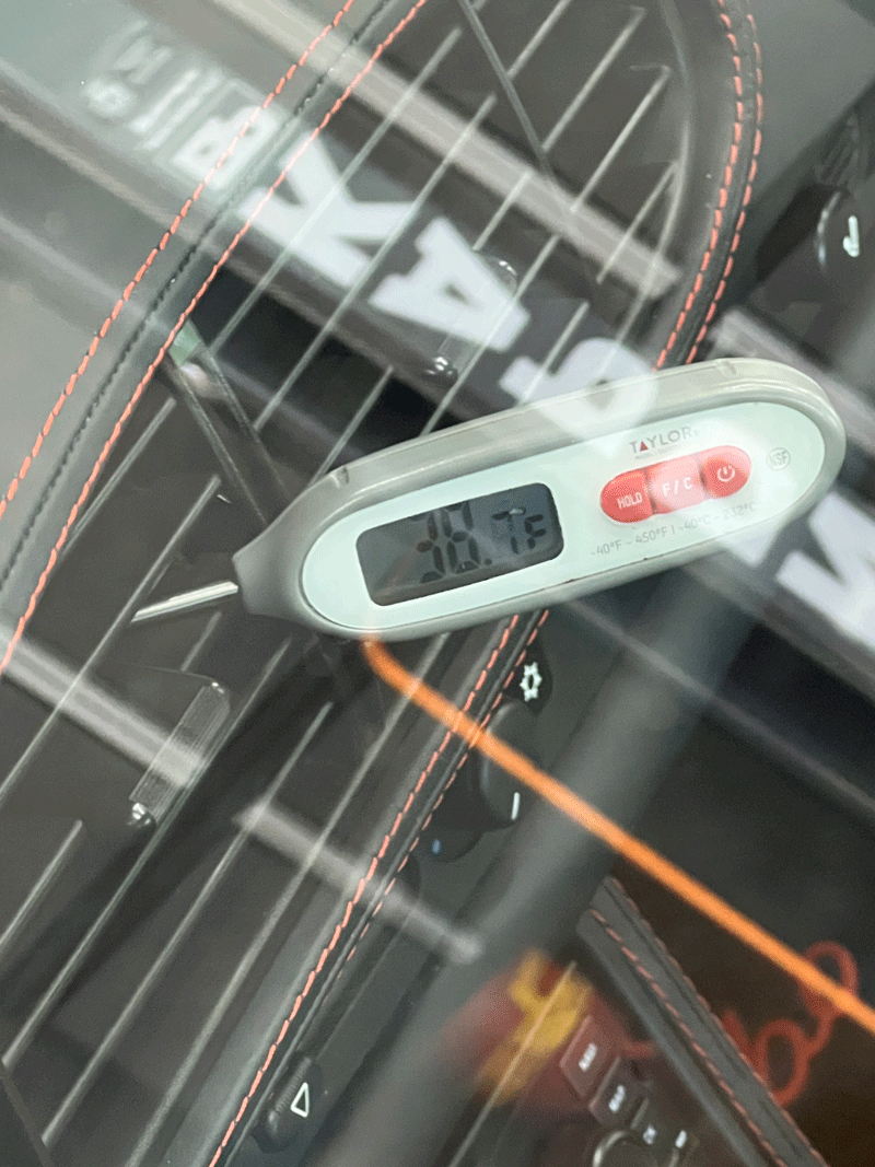

Great post, thanks Ian. The 944 does pretty well with the old tube and fin condenser. As best I can tell, Porsche kept that old condenser when they switched the late 968's to r134a. That said, the parallel flow condensers produce lower vents temps on r134a for sure -- every bit as low as I ever got with r12. Measured it at 38F just now. I had to get out of the car and take the pic from outside -- too chilly to sit there in shorts.
Hopefully, we'll have some more 90F+ days before the summer/fall is over, so I can test it in hotter whether, as the compressor was cycling off when it got down to 38 or less (which I'm hoping means it has cooling capacity to spare in this weather).
