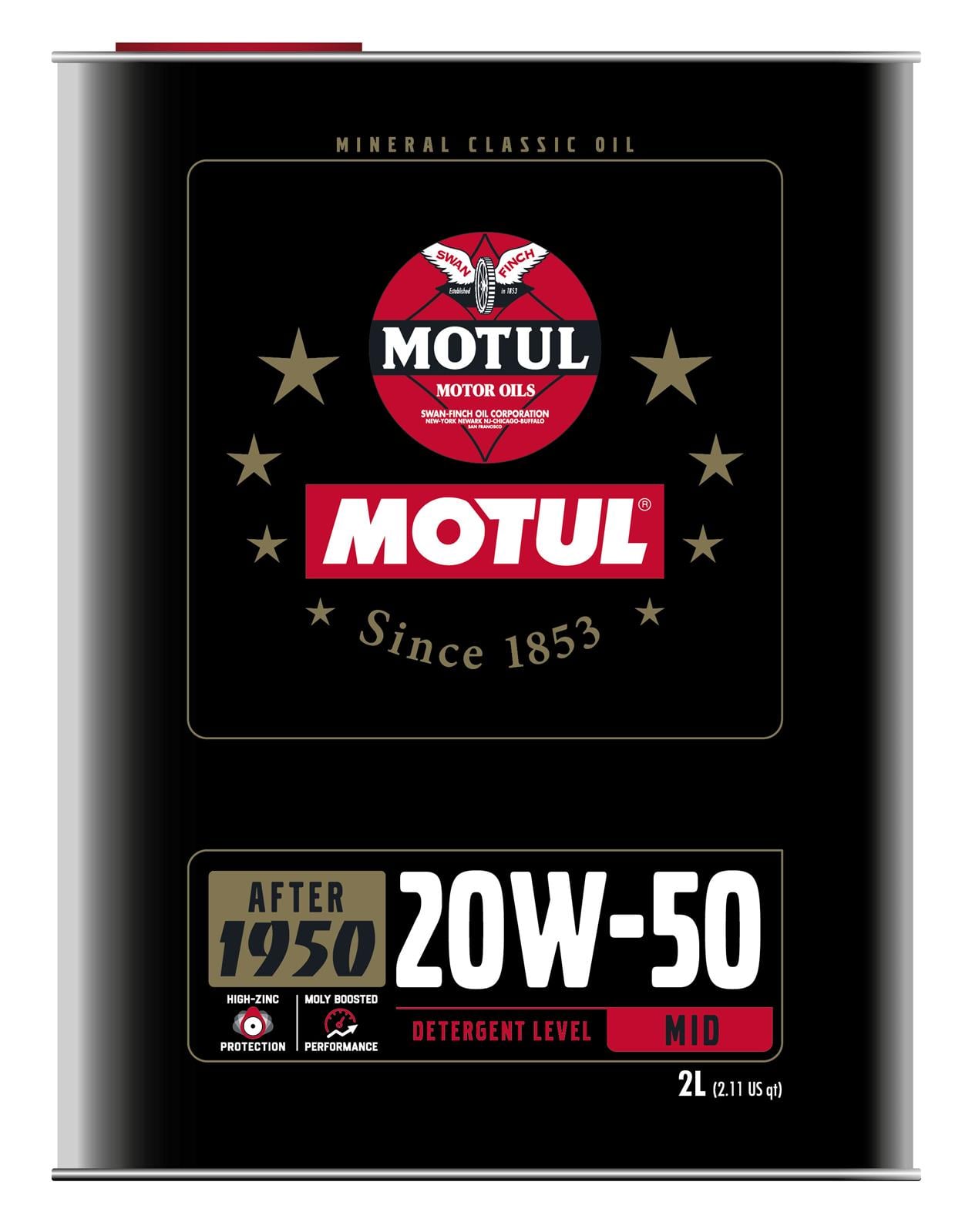

This is a timely discussion for me as it is oil change time. I've been using Castrol GTX for a long time but do occasionally get lifter tick. I lean toward convention oil just because I change it overly often and synthetic seems to produce leaks that just aren't there with convention oil... I'm thinking about trying this Motul conventional oil. Anyone try it yet?

I ordered it. What the heck. Will do an oil analysis with my current oil and with this Motul, and will report back :) I wanted to try their 'Eighties' oil, but they only sell it in 10-40 and I really wanted to see if the higher zddp would allow me to run 20-50 without the lifters ticking. We shall see.

Posted: Thu Aug 07, 2025 11:11 am
