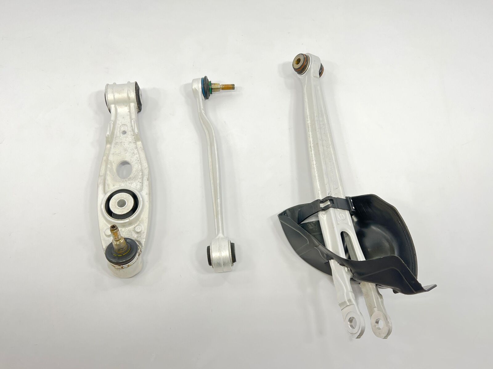

These are for 718 GT4 rear LCA's. They consist of two halves that clamp onto the LCA and screw together. These DO NOT fit the 718, 718S, 718T, 718GTS. Different LCA's.
What will fit the rear tension links on non-GT4 718 are these:
982-505-569
982-505-570
911T rear.JPG (73.54 KiB) Viewed 5484 times
The tension link will need to be removed and the air scoop slid onto it, then strapped in place. The plastic strap is built in.

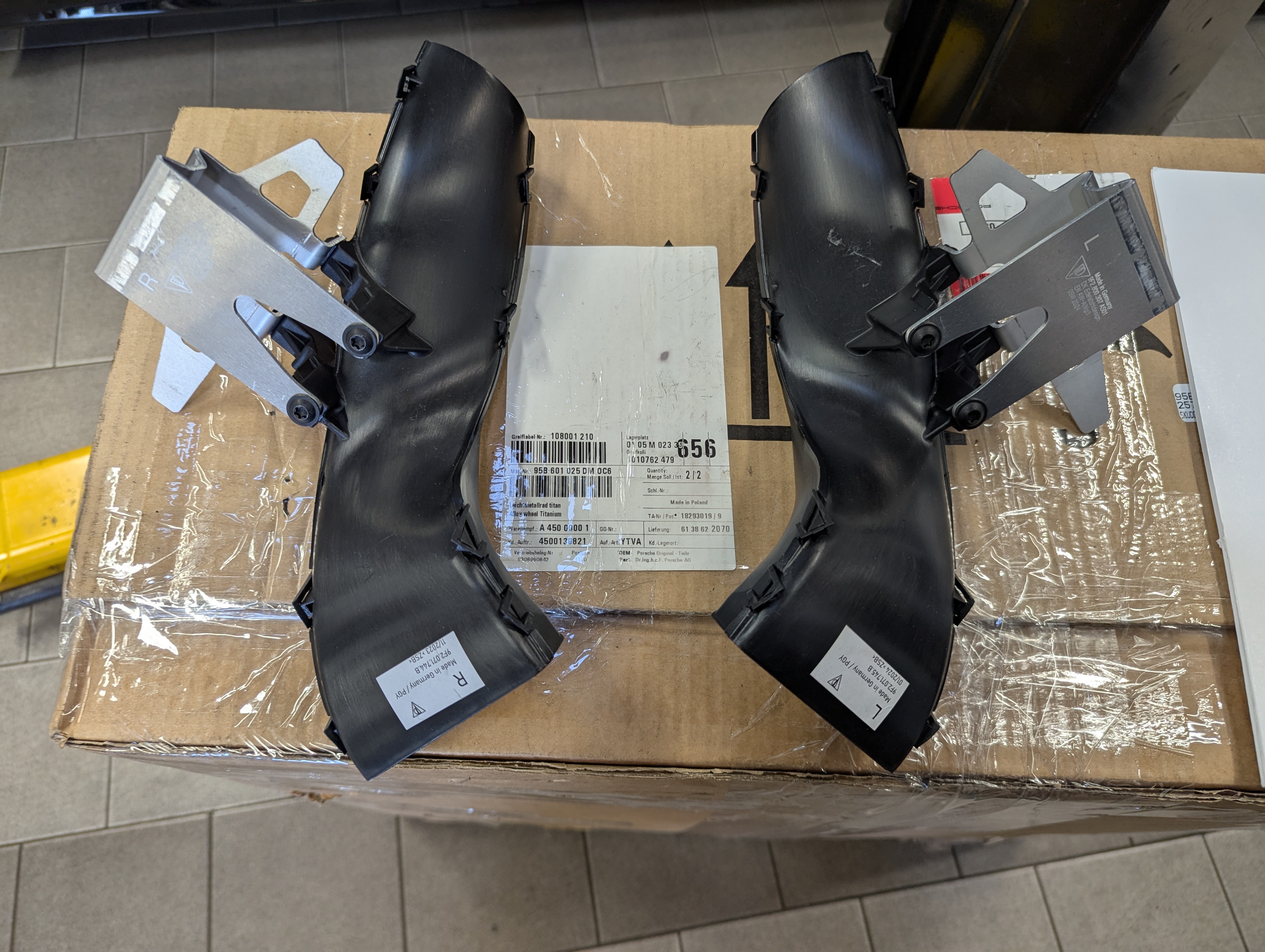

And for what it's worth to anyone contemplating changes, I just had the Porsche Motorsports rear axle air ducts installed on the GT4. (Part numbers for the GT4 & GT4RS: Right: 9F2.071.744.B, Left: 9F2,071.745.B)
In addition and in reference to the very helpful post by @Ix_ regarding the 2-piece brake ducts, installing the Porsche Mtrsprts rear axle ducts required the removal of the top half of each of the 2-piece brake ducts. The top halves do nothing but secure the vents to the control arm, so removing them was not an issue. They are now secured using special zip-tie-like connectors and are better secured than they were with the factory brackets.

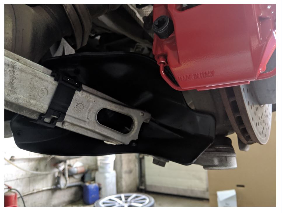

I took inspiration from the other thread where Tim showed his lower ducts fastened to the control arm with Zip ties and did the same thing. I had to trim them slightly to fit the GTS rear due to the previously mentioned, these are not the same as the GT4 arms. The top of the clam shell wont fit due to the ride height sensor so I did not install those, not sure I love the snap clips anyway.
982-505-569-A Brake duct, bottom half, LH rear
982-505-570-A Brake duct, bottom half, RH rear
