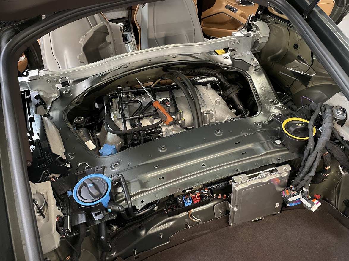

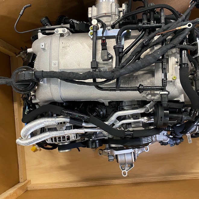

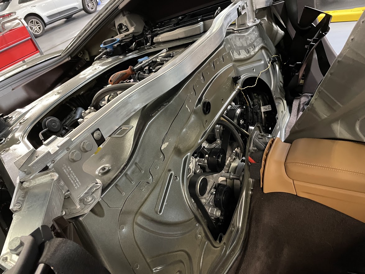

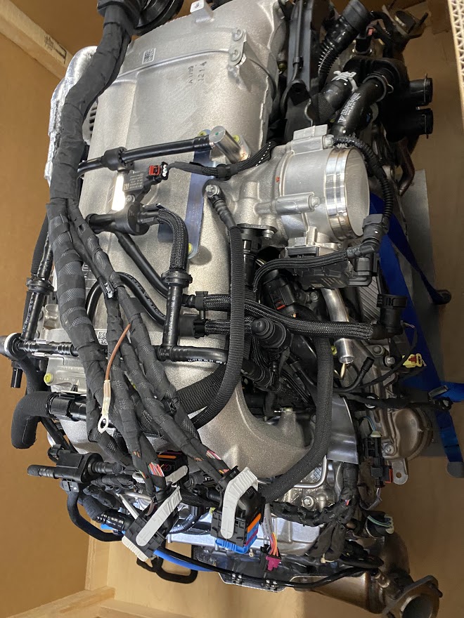

To update, my SA called today to tell me I should be able to pick up my car tomorrow. They were supposed to call me when the engine came in so I could come look at it but they dropped the ball, but they took pics before and during the installation. It came with everything attached, they just basically had to bolt it in and plug in all the cables, plus attach the exhaust, transaxle, etc.
'84 944, my first Porsche DBM
- Bill in Bama
- Posts: 517
- Location: Fort Payne, AL
- Has thanked: 16 times
- Been thanked: 155 times
The dealer's shop finished my car Saturday morning, the engine arrived there early last week but my salesman was off and no one notified me. The did take pics of it for me which is fine, I might not have been able to go up and view it anyway. So yesterday morning we drove up to Chattanooga to get the car. I returned on a longer than usual route avoiding the interstate so as to vary the engine speed and avoid using the cruise control. The normally 60 mile trip took more like 80-85 total and we avoided most of the rain but got hit with a light shower right after leaving the dealer. So far so good, although the exhaust sounds somewhat different if my memory is correct(that is always in question these days). Also, I seem to detect a bit of squirrely twitching from the rear end on throttle lift occasionally. I don't know what they could be, maybe they didn't get the half shafts tight, but why would those even be removed? I'm calling them to discuss. Overall, they had the car for 29 days and I think that is pretty good since the original replacement engine was condemned when it was found to have the same oil pump as my old one, and the new one had to be shipped from Germany. With all the delays in shipping, port issues, trucking issues, etc. that is remarkable.
