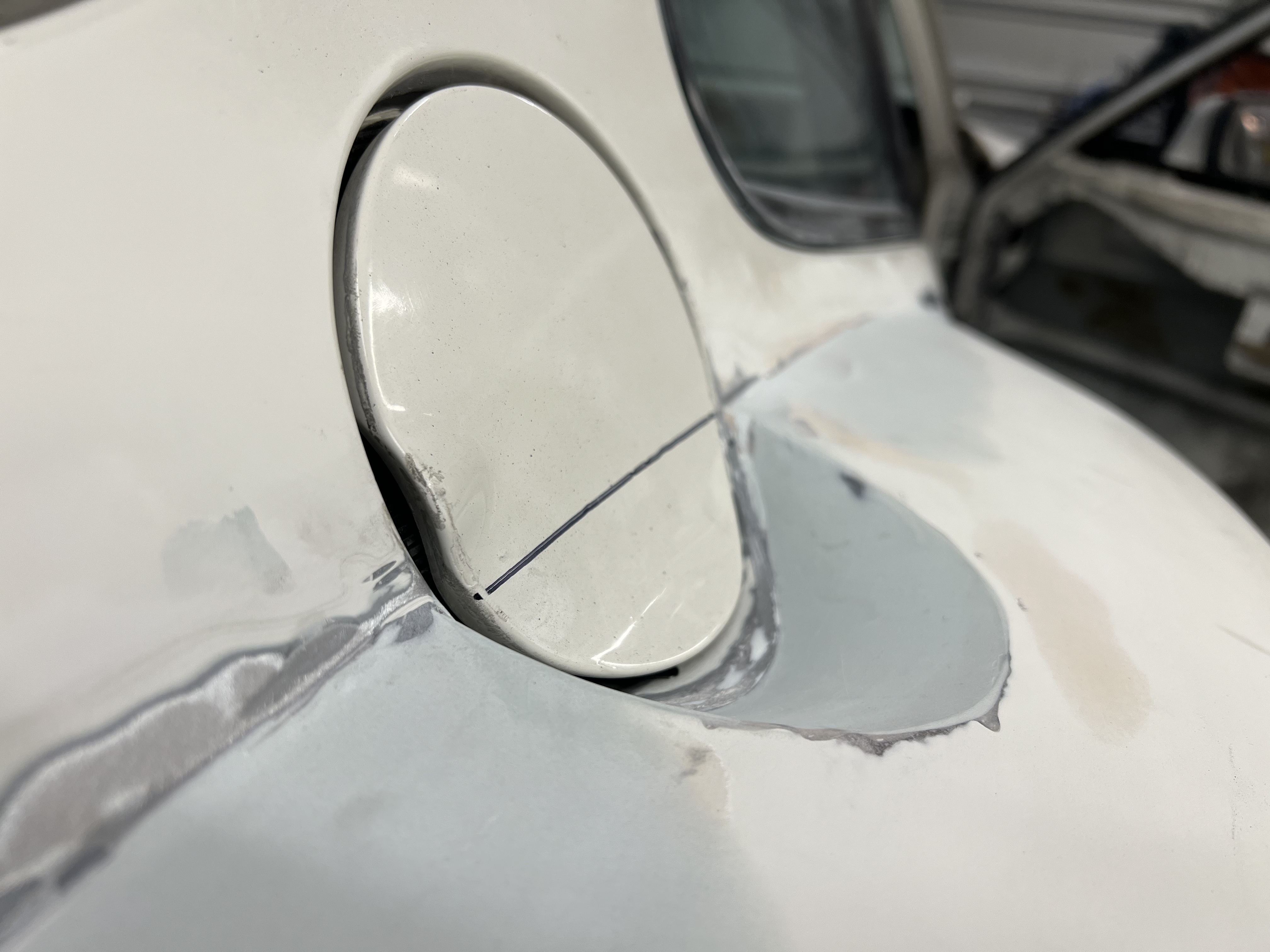

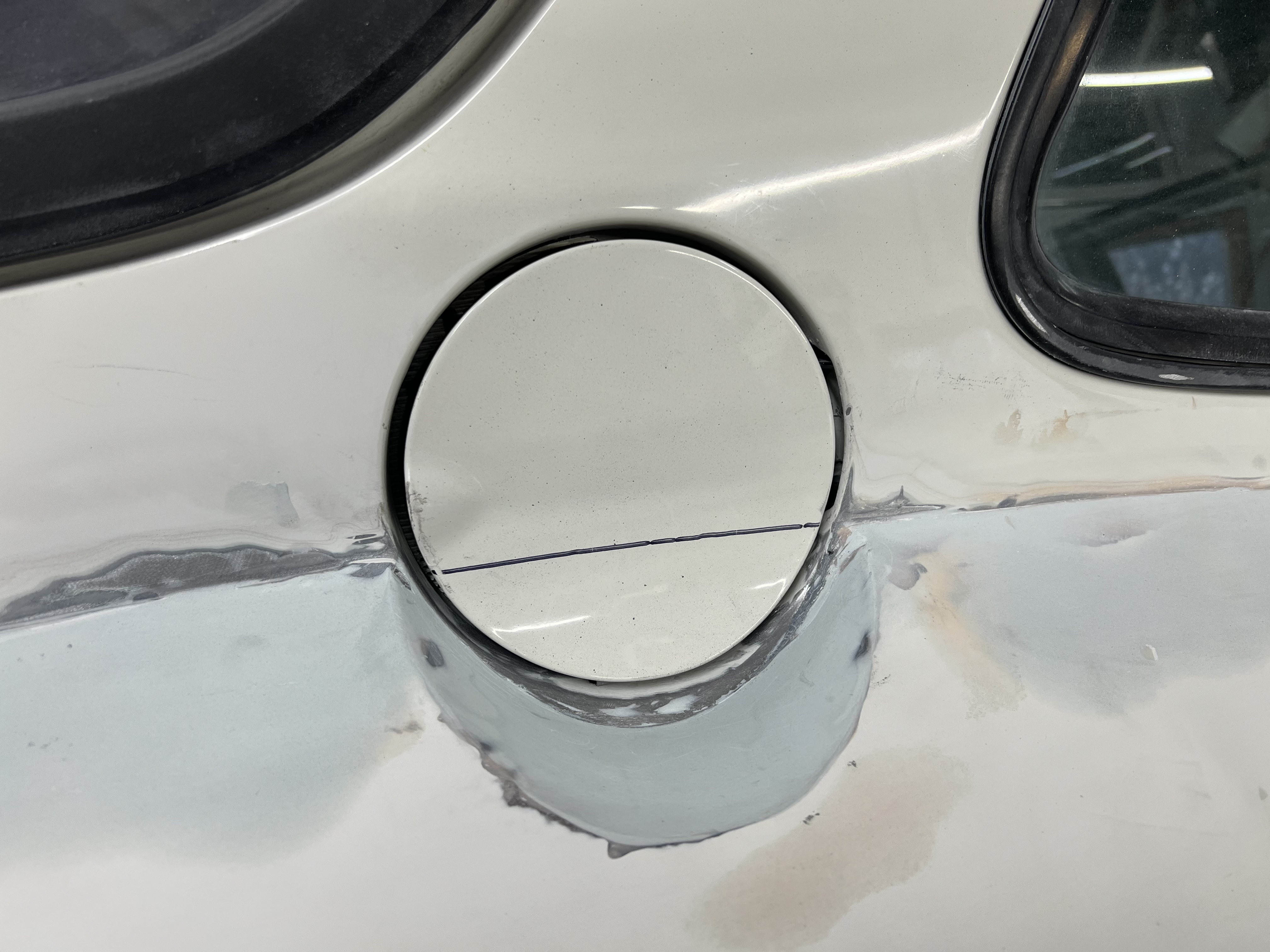

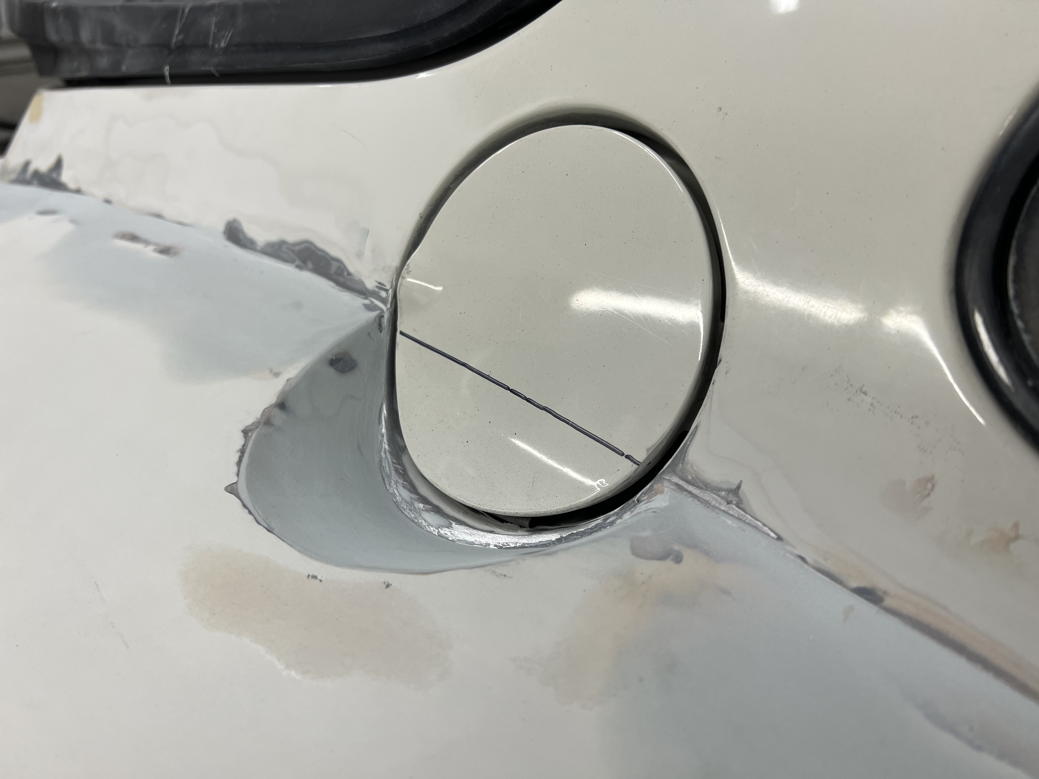

Some fun details that had to be fabricated!
